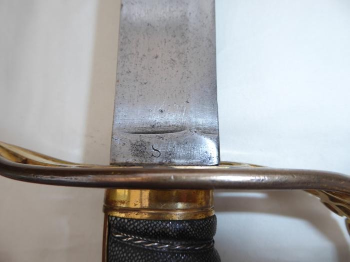

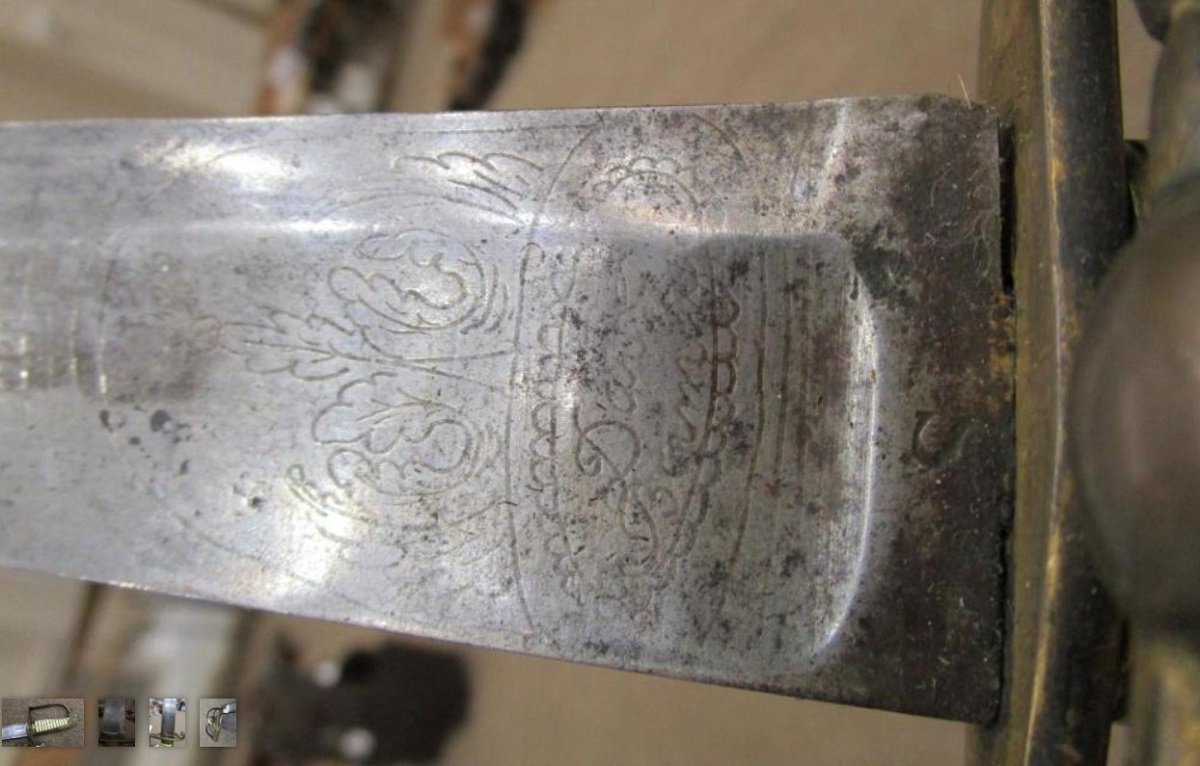

I have come across several examples of British officers' swords from around 1800 that have an "S" stamp on their ricasso, in a similar way that Osborn marked swords have a "G" stamp. Most aren't maker marked, but a couple have Prosser marked scabbards and three have blades marked to Dawes. A search of the internet hasn't produced very many examples of Dawes marked officer quality swords. Dawes seems to have been a prolific producer of troopers' swords. I am wondering if the S stamp may have been an inspection stamp used by Dawes?
Does anybody have a Dawes marked officer sword they can check for S stamps?

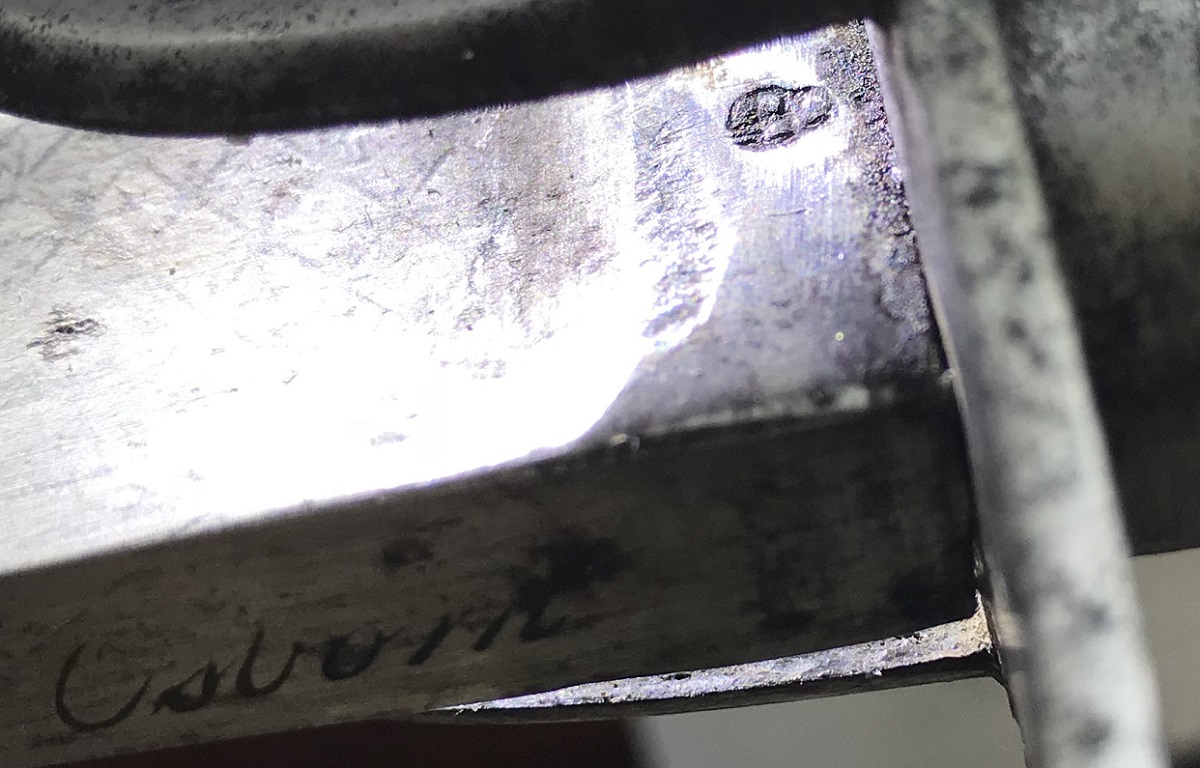

Henry Osborn was using the G and also GG long before he partnered with John Gunby. Recently I have become aware that earlier (possibly 1780's) Henry Osborn had been marking his swords with a Crown over HO stamp. I have an early (probably circa 1796) 1796 light cavalry sabre marked to Osborn, which I believed had a corroded G stamp on the ricasso. Now I think the mark may actually be a crown with the HO hidden beneath the guard? I have seen on the internet another 1796 sabre with what looks to be a crown over HO stamp.

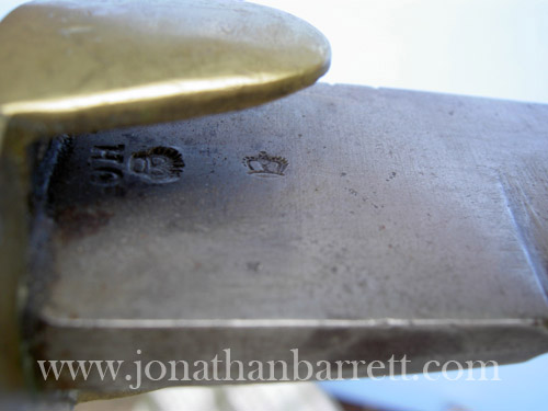

Henry Yallop from the Royal Armouries confirmed that a sword like the one shown below from Jonathan Barrett's website, with the crown over HO stamp, was also stamped H.OSBORN on the tang.
