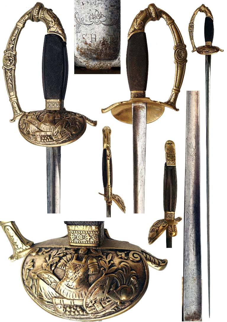

I picked up this sword recently and it was described to me as a 1780 pattern French General Officers sword. I can’t find it in the books I have on French swords and believe it to be later in any case. Can anyone shed some light on what this one actually is?
PS the sword has the letters S H . T at the top of the 32 5/16" blade.
Cheers Cathey

Hi Cathey,
the model was in use during the French first Empire period but still in use during the restoration period.
So its a French Officers dress sword between 1800 and 1820, because there are no lilies on the guard plate this on is probably First Empire = Napoleonic.

Your sword has been made by Samuel Hoppe Frères à Solingen and was in use during the French July monarchy and Second Republic 1830-1852.

The blade yes , the Guard is older.

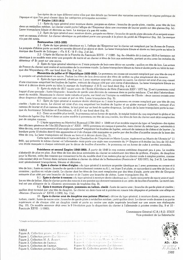

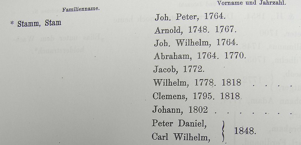

More food for thought. A 2007 thread discussing the possibility of Knecht & Stamm
Cheers
GC

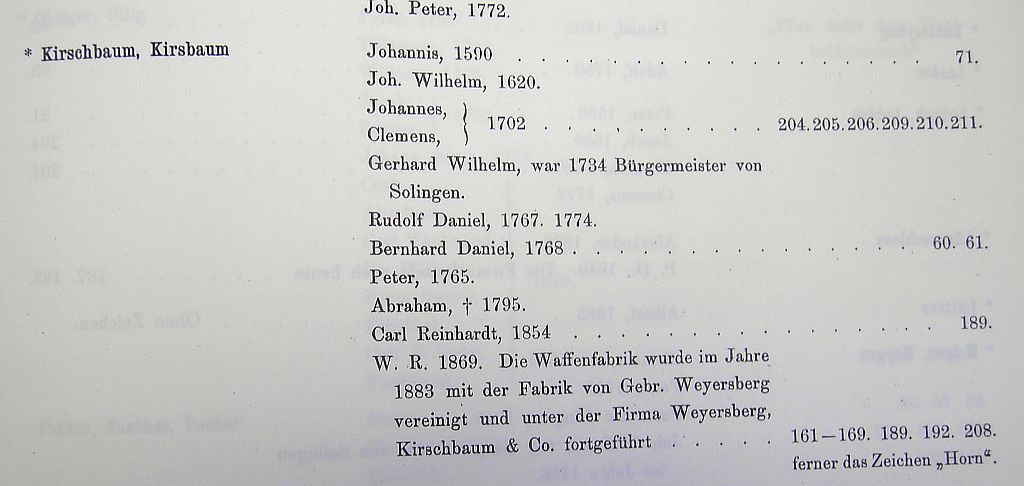

Kirschbaum & Schnitzler existed since 1790 and was still working at least in 1883. In this year Kirschbaum was united with the firm of the Brothers Weyersberg = Weyersberg, Kirschbaum & Co.
This you can find in the book shown here.

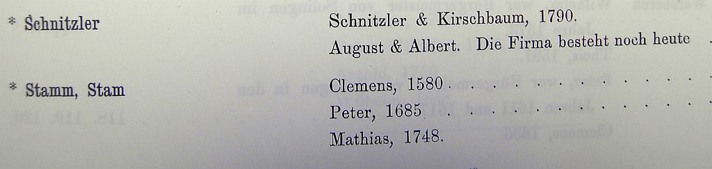

Yes, I am aware. However even your last reference lists them as Schnitzler&Kirschbaum (imo both of whom were agents, not makers/smiths), and not listed as K&S aside from that one source.
At any rate, have you any reference books listing Helvig at all?
I have only Bezdek, Wagner and the various fora for German marks, let alone much regarding Alsace.
