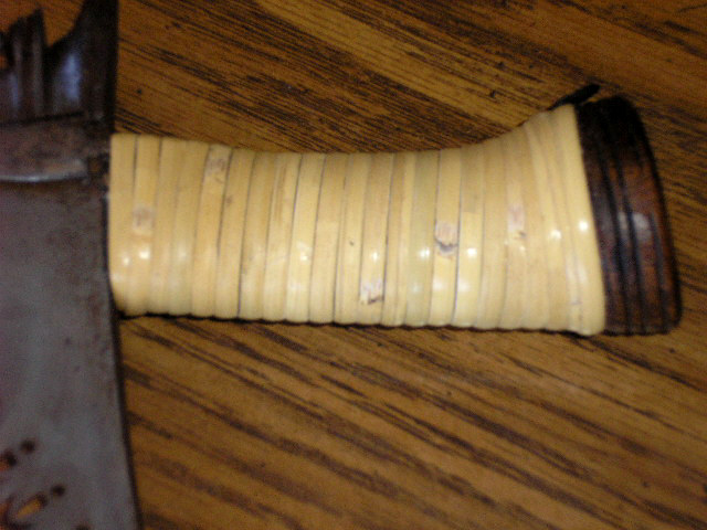

found a dealer that carry rattan strips, which is real nice and pliable. well, i had a kris handle that restored using twine, but i was wondering how it would look with rattan strips (there's one on cato's book). so here's the kris when i acquired it:

the thread on the handle was very fragile and it was coming off, so i decided to redo it.

well, like i said, with this rattan strips, i think i can even make it look more bootyful. this is preliminary since i just wanna see how it looks. without stain, it looks pretty cool already. my question is, does anyone owns a kris with rattan strip handle and could you please kindly post it so i can see the patterns invlove? i think those type of kris handle is nort as common; either that or it came off a while back and rewrapped with cord instead. the rattan stripp handle on this type of kris i believe, matches better, IMHO...
thanks in advance,
ron

Spunjer
I would have just applied some pitch to the cord wrap that would have done the trick. You wrapped it ok but you should try using thinner strips of rattan. The wide stuff seems a bit much for a 5" grip.

thanks for the suggestion, lew. the cord does look nice, with pitch even, but most of my krises has cord grips and zero rattan grips. yeah it kinda look plain. i do have a thinner rattan strip which i used to work on my pira scabbard (to be stained later). like i said i'm just experimenting on this type of grip...

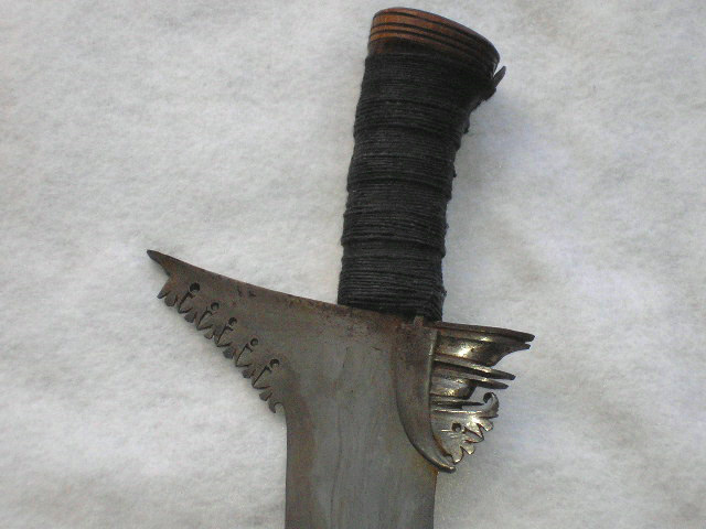

d're, two krises of mine w/ rattan strip handles. the kris w/ ball pommel has a thicker rattan strips(original wrap) while the ingraved kris has thinner strips. the ingraved krises hilt was missing a wrap exposing the iron clamp so i decided to do it my self /4th grade p.i practical arts comes handly (making broom sticks rattan rings). let me know if you needed the thinner rattan strips, i got lots of 'em.

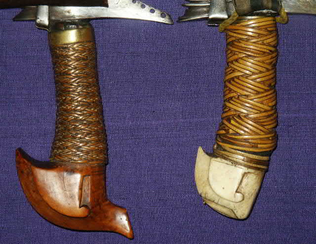

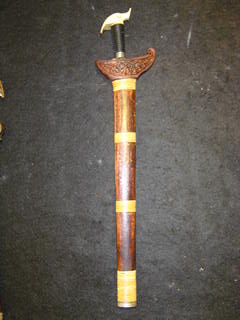

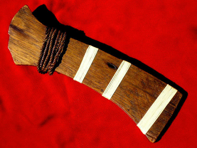

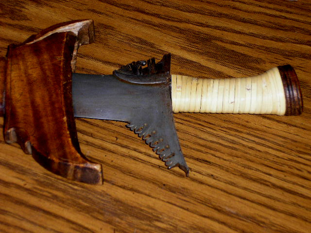

Old 6th June 2006, 04:15 PM   #7
punal
punal's Avatar
Join Date: Aug 2005
Posts: 91

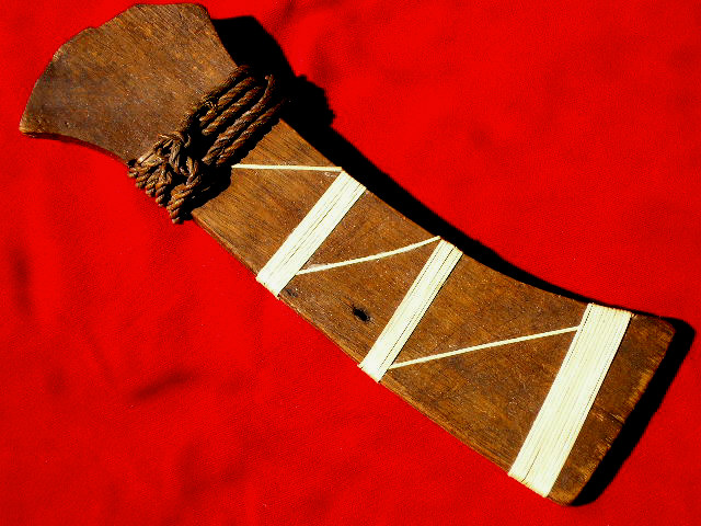

this scabbards had electric wire wraps on 'em, i had it replaced w/ rattan strips.
punal is offline   Reply With Quote

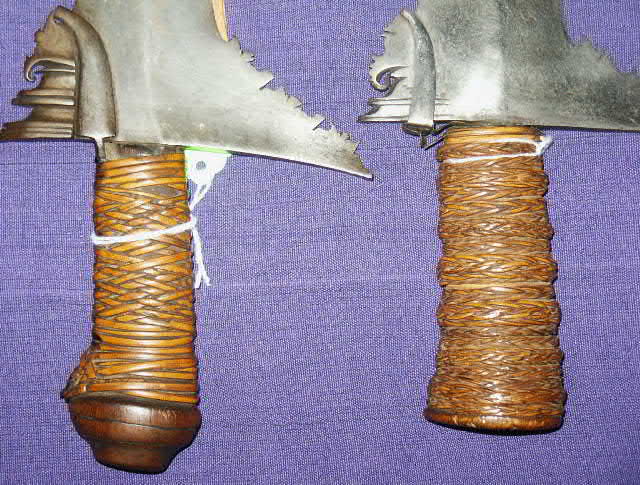

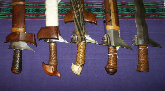

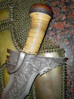

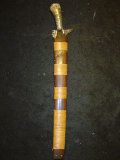

Old 7th June 2006, 01:57 PM   #9
kino
kino's Avatar
Posts: 1,038
Spunger, Here are a few photos of rattan wrapped hilts. AFAIK, these are original to the swords. Each of them wrapped differently, all intricate. I have shown some wrapping to basket weavers, to see if they could copy it, I haven't found one that could, one came close. Good luck in your project.
Old 7th June 2006, 03:17 PM   #10
MABAGANI
MABAGANI's Avatar
Posts: 221
Nice set, the double pattern is often found using wire brass, copper or silver.

kino,
thanks for the pics. i like the one with MOP(?) handle weave. that's what i've been thinking of doing...

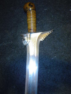

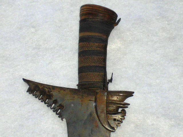

Old 11th June 2006, 09:55 PM   #13
Spunjer
Spunjer's Avatar
Posts: 1,730
kino,
would you mind posting both sides of the bone pommel miniature kakatua handle? just wanna see how it looks like on the other side. thanks in advance..

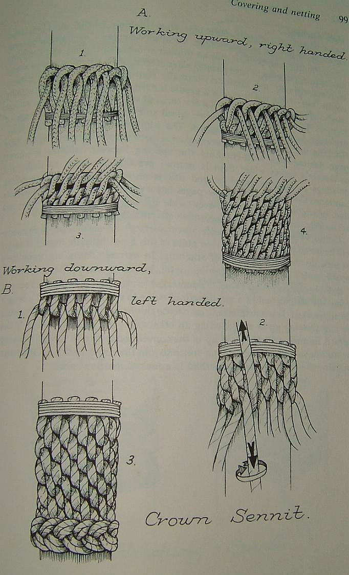

Old 11th June 2006, 10:47 PM   #14

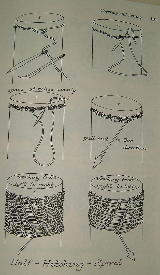

Posts: 6,436

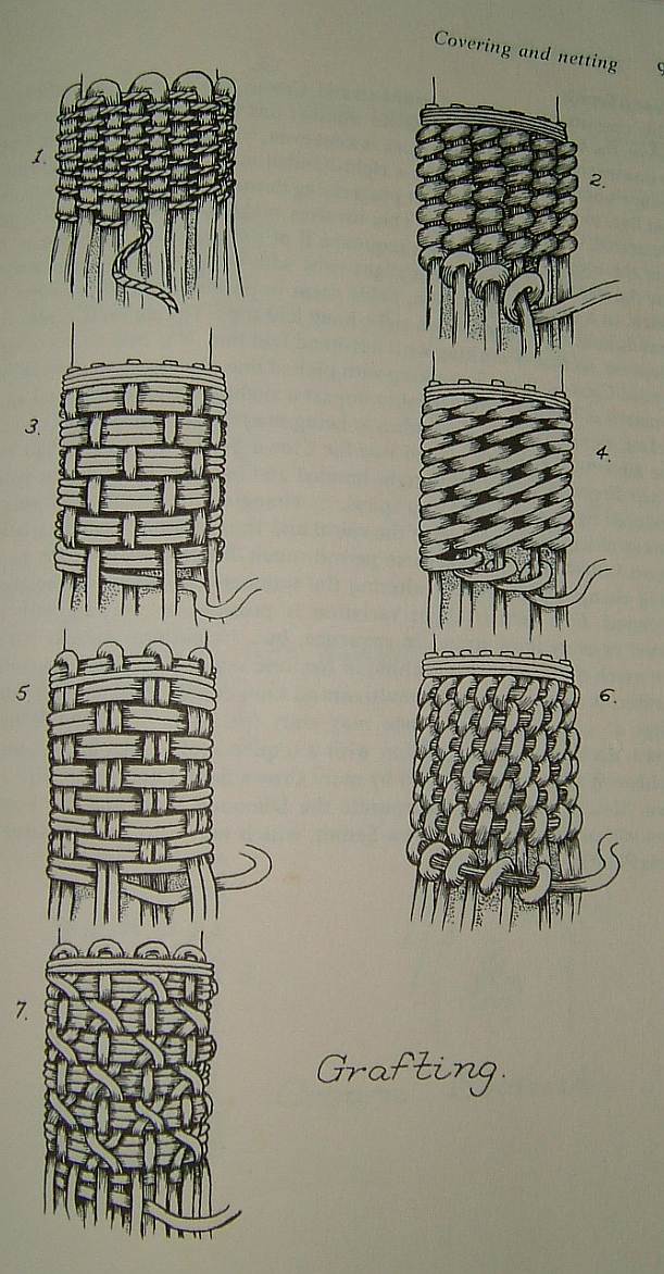

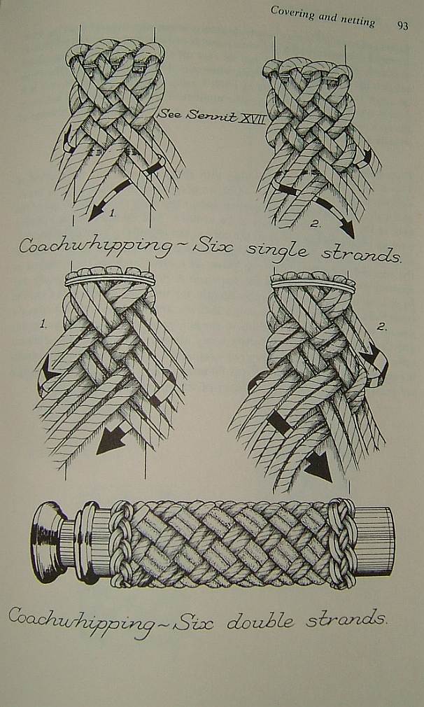

Default Possibly .....
Some of these techniques could be adapted to rattan .
Old 12th June 2006, 03:47 PM   #15
Spunjer
Spunjer's Avatar
Posts: 1,730
thanks for the the pics, rick! that's gonna be a lot of help...
btw, what book is that???
Old 12th June 2006, 05:07 PM   #16
kino
kino's Avatar
Posts: 1,038
Spunger, I think the weave is, 2 sets of 3 strands of rattan(totaling 6), opposite each other. As they go around the hilt, one set goes up on one side the other goes down the opposite side, you need four sets of hands totaling 8. Don't get them tangled up (the hands), if it doesn't work try again. It's very easy, anyone can do it, except me.
Old 12th June 2006, 06:16 PM   #17
Posts: 6,436
Ron ,
Creative Ropecraft
Stuart E. Grainger
Published by W. W. Norton
isbn 0 393 08746 8
Of course the bible is Ashley's Book of Knots .
You work the rattan wet or dry ?
