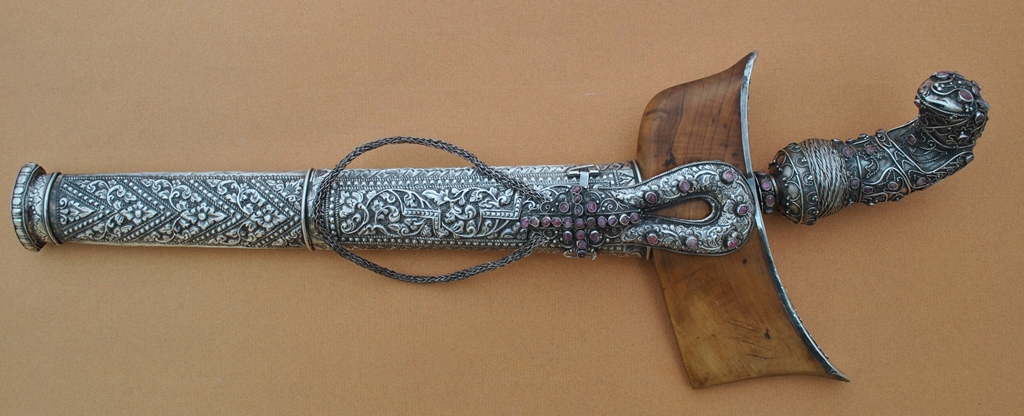

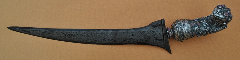

I am curious to understand the connection between Sumbawa and Banjarmasin. I have recently acquired a Sumbawa keris, with a Banjarmasin hilt, which is not unsual, and looking on the forum, I have found this Benjarmasin keris http://www.vikingsword.com/vb/showthread.php?t=7840 , which has a blade very similar to mine.
I know there were a lot of exchanges by sea through the Bugis, but why this special connexion, since these two places are pretty remote?

Sorry Dominique but IMO also the handle is a Sumbawa hilt

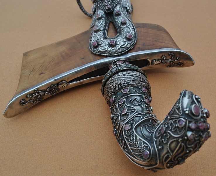

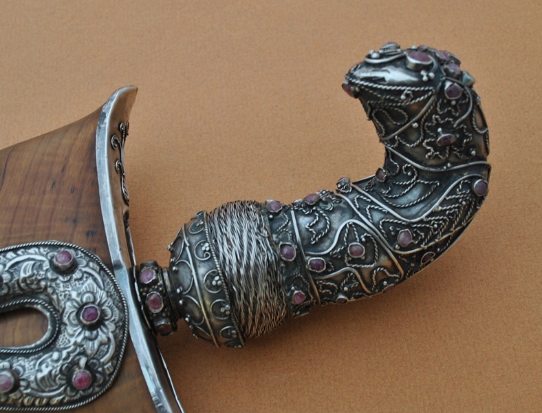

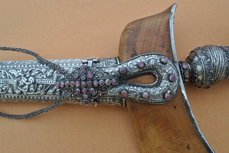

Hello Dominique,
All the silver work on this keris that you are showing looks brand new.
Í assume we are discussing the old keris from the other thread ?
Willem

Originally Posted by asomotif
Hello Dominique,
Willem
I tend to agree Willem. This dress is well executed and tasteful. I really like it. But i don't believe it is very old.
I don't know how old it is, but I can tell you it is not brand new, it has just been cleaned. The decoration is made of pure silver wire, this is why it might look new.
No, not brand new. I could be wrong, but this looks very much like a style of passio sumange (toli toli) in high quality silver work being done in the late 20th century, so i would say contemporary. The blade is much older.

Dominique
Dominique's Avatar
Join Date: Sep 2005
Location: Paris
Posts: 21
It is probably from the 20th century, but it has been worn since it has signs of wear.
