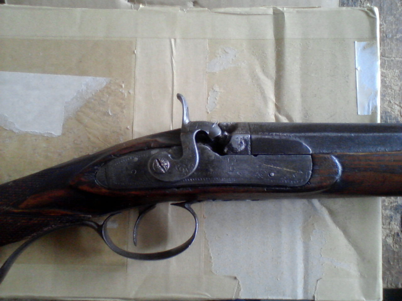

Default Miquelet Percussion Pistol for ID and Comment
Just acquired this nice little pistol. Barrel length approx 5" (13cm) with a smooth bore of approx 17mm. Overall approx 25cm.
There are no proof marks of any sort, but 17 is stamped on the underside of the barrel. The barrel bore has a definite chamber for powder and a "flange" above that, which would seat the ball. The miquelet lock is in good functioning order.
I am leaning towards Spanish origin but could be quite wrong.
All comments welcome.
Stu

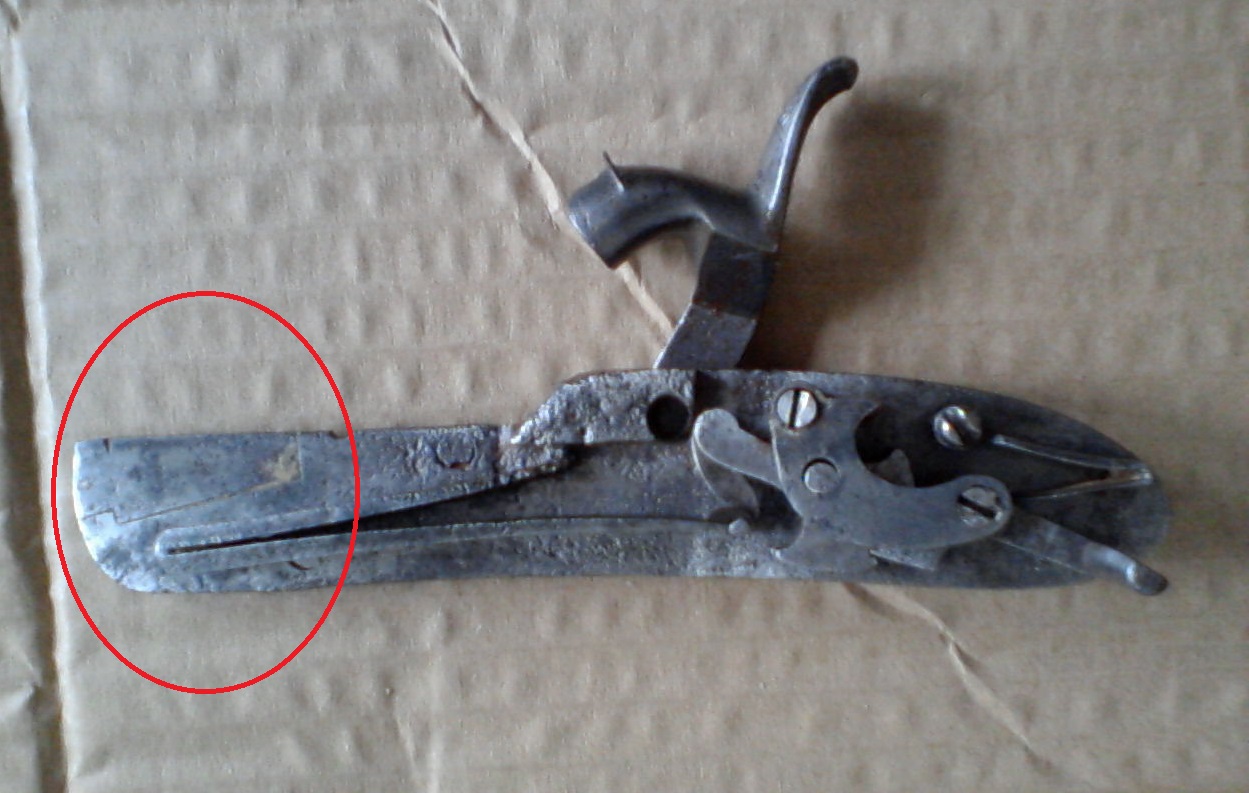

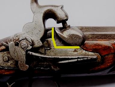

Old 15th September 2019, 05:01 PM   #2
Fernando K
Join Date: Apr 2010
Posts: 672
Hello
The third screw on the counter plate suggests that you must have had a belt hook. We would have to disassemble the counter plate and look where it threads and what sense it has. Is spanish

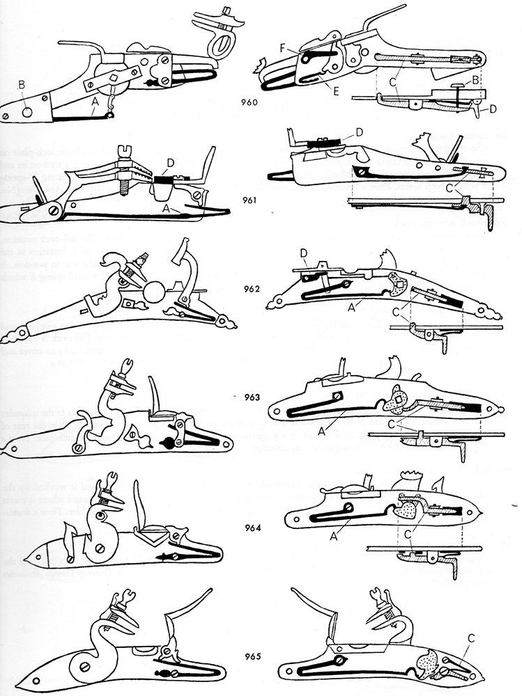

Hi Jim,
Miquelet refers to the style of lock and can be found in either flint or percussion.

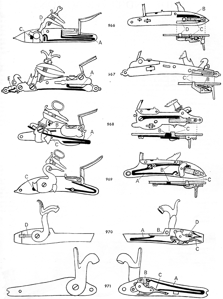

Here is some info for you on various types/styles of locks.
Stu

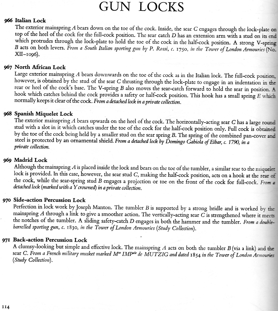

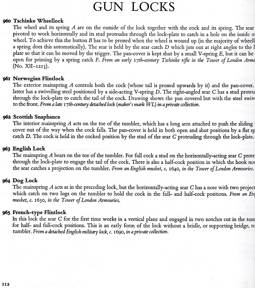

Old 15th September 2019, 11:22 PM   #5
David R
David R's Avatar
Join Date: Jan 2011
Posts: 1,164
Thank you for this excellent explanation of the different gun lock types. Which has cleared up a detail that was bothering me about the gun at the top of the thread.
Old 15th September 2019, 11:40 PM   #6
Fernando K
Join Date: Apr 2010
Posts: 672
Hello
In the description of the "fashionable Madrid" miquetete there are several errors. The chock C is not half-cock, but is for full-cock, and conversely, the front chock is the one that acts in half-cock. In addition, the firing is not achieved by means of the spring appendix, but by means of a bar
Affectionately
