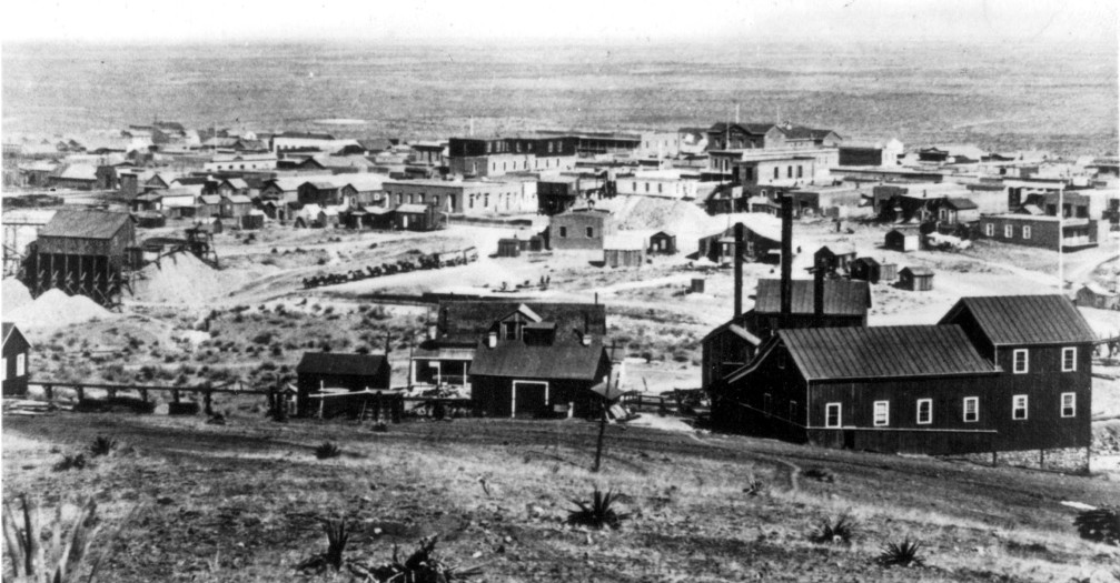

On this date in a small town in Arizona named Tombstone, in a 30 second shootout, mysteries of the Wild West unfolded in an otherwise insignificant event becoming one of the most heralded in that history.
It was called the gunfight at the OK Corral, even though it was not even in that nearby location, it lasted only seconds, and it has never been clear who fired the first shot, nor how it all took place. Yet there have been so many books, movies, articles on this event and its characters than most other of those times.

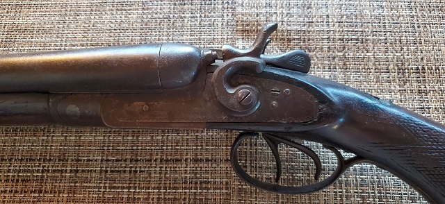

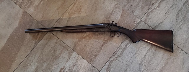

I acquired an old coach gun years ago, 12 guage, and has markings
W.RICHARDS NORWICH CONN.
This name is not an actual maker but a spurious name (alluding to the famed Westley Richards in England) often used as a 'brand' in Liege, who made many guns for the American west.
The barrel is 18" so within the 'coach' specifications.
This is probably about an 1890s version produced in Connecticut by the Crescent Firearms Co.. This firm was taken over by H.D. Folsome in 1893, and they imported many weapons from Liege, so that would account for the W. Richards name.
By this time, these 'coach' guns were still used by guards, but mostly with shipments on train cars.
Just an example, but of 'the type' we are seeking for Doc Holliday in 1881.
Photos are : Tombstone in 1881; Doc Holiday; the W. Richards coach gun; and Wells Fargo shipment (in wagon, many did not ride in coaches) with the men all 'shotgun messengers'.

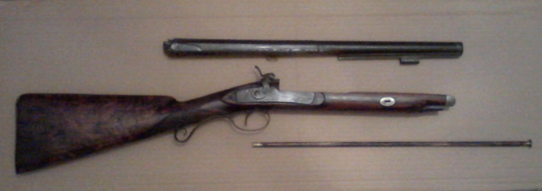

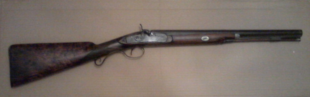

Old 2nd September 2019, 08:19 PM   #13
David R
David R's Avatar
Join Date: Jan 2011
Posts: 1,162
I would have posted a photo earlier, but had to wait for this to come back from the Gunsmith. A muzzle loading percussion Coaching Gun in my collection. The barrel checks out as having been made at that length, 18 inches, rather than sawn down from longer. The lock started life as a flintlock, and was than made into a percussion. The bore is at least 12 bore, hard to tell with these old barrels. Lots of wear and repair, but I like it.
Old 3rd September 2019, 11:40 PM   #14
Posts: 10,857
Default !
David, thank you so much for posting this!
This is a fantastic gun, and all the more so having been converted from flintlock suggesting it early use indeed on coaches. While the Doc Holiday shotgun was of course from a later time in the 'wild west', the early coach guns have amazing history of their own.
Thank you for posting it on its own thread as the old coach guns are a story in themselves from 18th century into 19th with the highwayman tales of England and the Continent. This shotgun type evolved in such use from the blunderbusses it would seem, but that's for the new thread.
