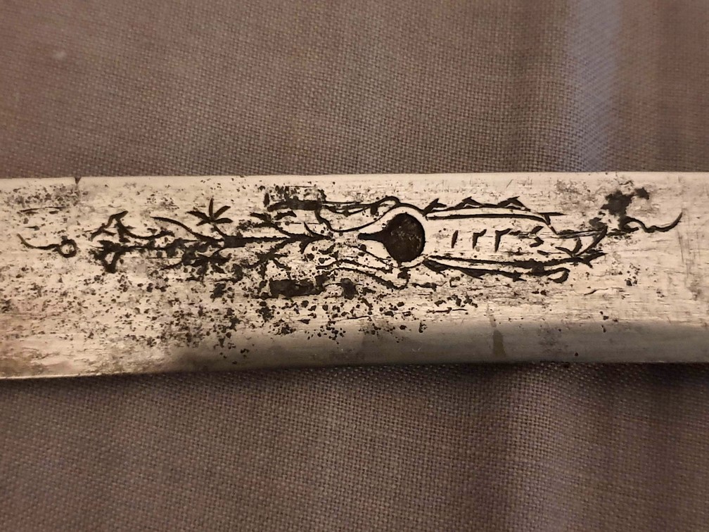

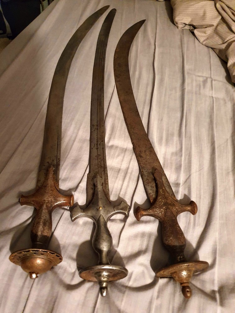

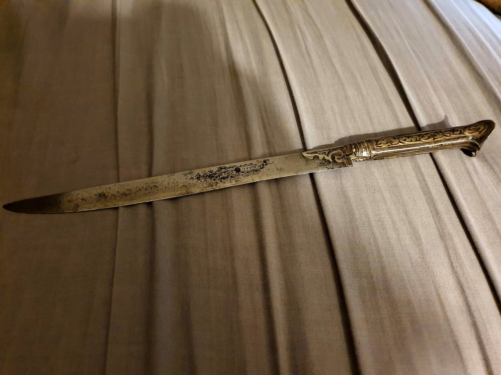

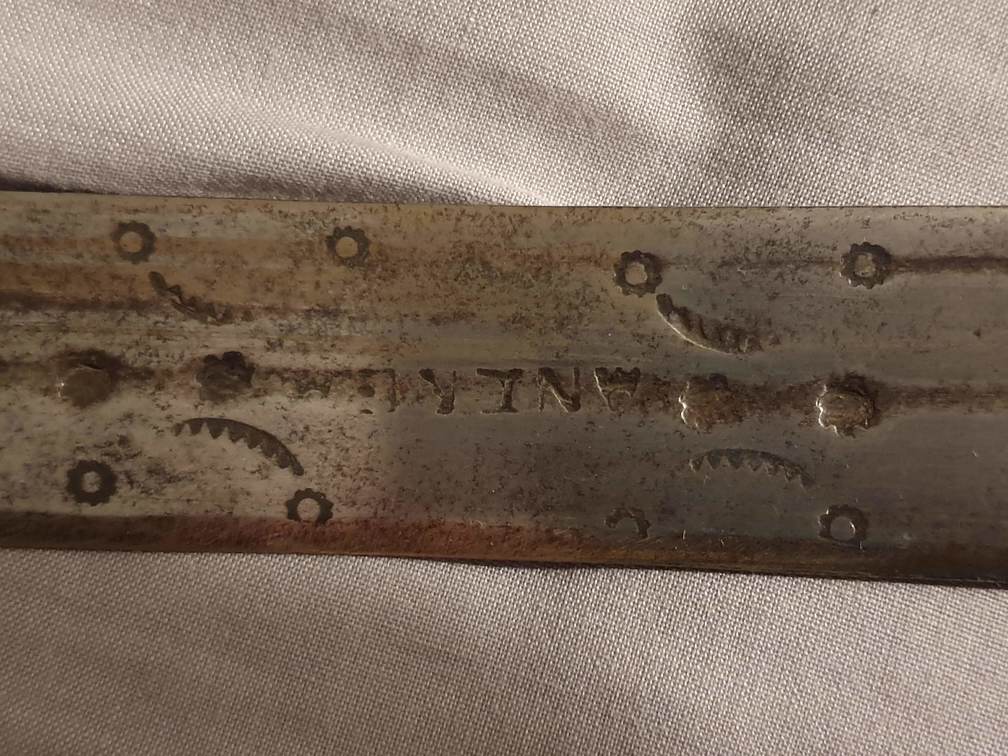

Hi everyone,

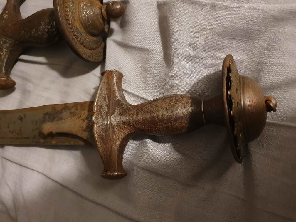

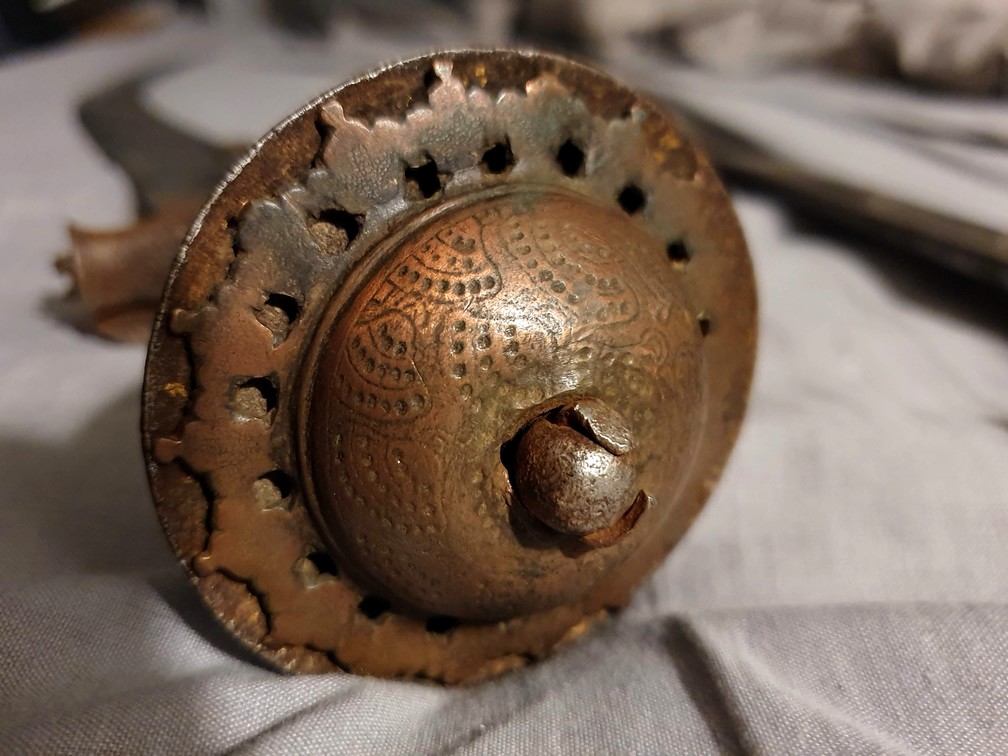

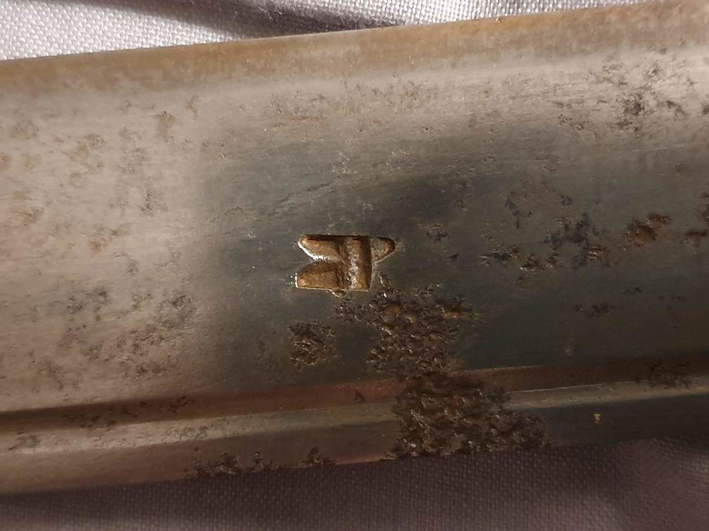

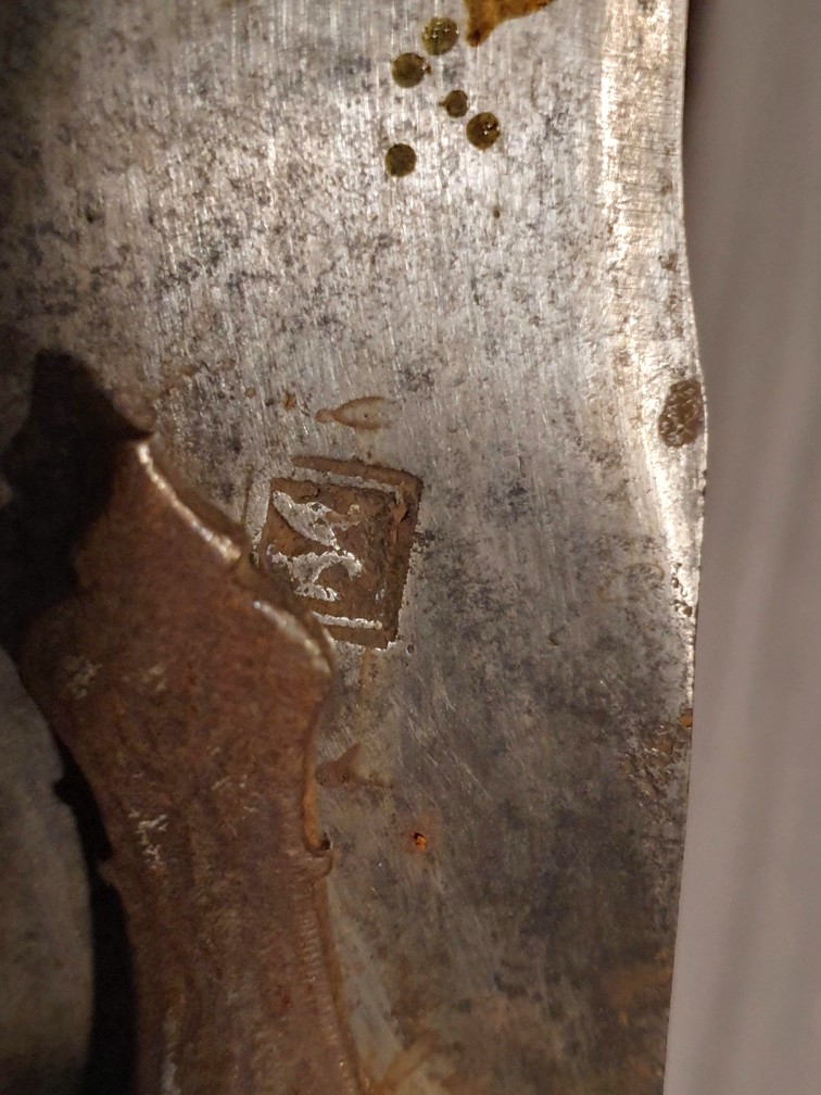

This is my first post so I wanted to kick it off with a number of stamps that I can't identify and would love some input! I firstly have two on what I think are 18th Century India tulwar and Tegha, another on a 19th Century Indian Tulwar and finally one on a 19th Century? Balkans Bichaq. If anyone has an ideas on the province of the tulwars and tegha that would be great! Also the semi basket hilt tulwar is very strange. It has a copper dome on the disc hilt with remains of gold koftghari within the gaps, has anyone ever seen something similar before? Thanks guys!

Hi,

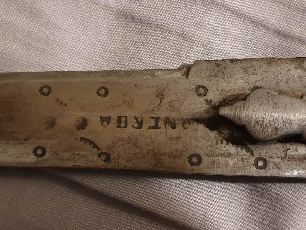

I don't know anything about Indian swords, but your bichaq looks like second half 19th c to me, and Greek, because this type decorative engravings on the blade is a Greek thing (also on Cretan daggers). However, nobody can provide further information without enlarged pic of the blade.

I dont know much about the bichaq but the numbers seem to be arabic.
1224(?) if this is correct it should be AD 1809.
From what I can see from your pictures, the markings seem at be copies of European marks, giving the blades a 'quality' stamp so to say.
yes on Indian shields
unfortunately for you, your talwar ou tulwar was restored with bits from an Indian shield...

Posts: 10,865
It would appear these tulwars are assemblages of components from old Indian armouries which may have been put together some time ago. The blades are Indian (having the distinct blunted edge near the hilt) and the markings are somewhat impressively executed versions of well known Styrian blade marks.
There is a great deal of consternation and debate over the meaning of the FRINGIA word and its variations, however it is generally found on sword blades through East Europe.
It would appear that the 'sickle marks' (dentated arcs) and 'cogwheel' arrangements with what appears to be perhaps 'ANDREA' (Ferara) may reflect same usage on Solingen blades.
These kinds of blades were well known in the trade entrepots in India, and the marks were widely copied, and impressively done often (as seen here) to assert 'quality' as Jens has noted.
It is interesting to see the shield disc, or what appears to be one, on the tulwar pommel. Similar radiating designs are well known inside the pommel disc, but the dome is atypical, and incongruent with the securing nut.
I would agree with the latter 19th c. on the bichaq, but can only presume the inscribed panel on the blade is in the manner of many Ottoman blades including yataghans of various forms.

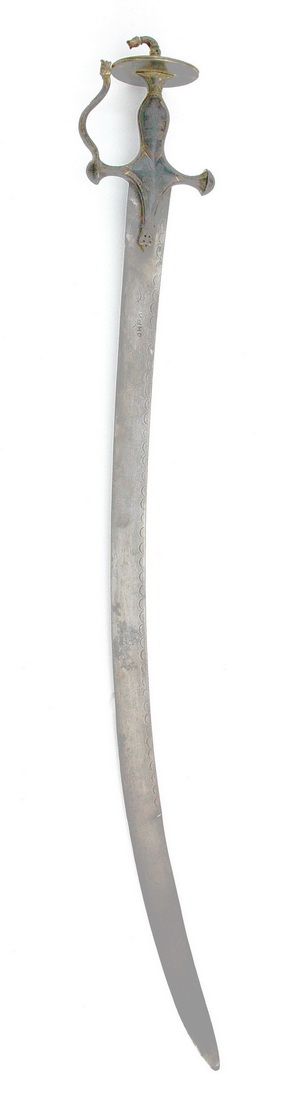

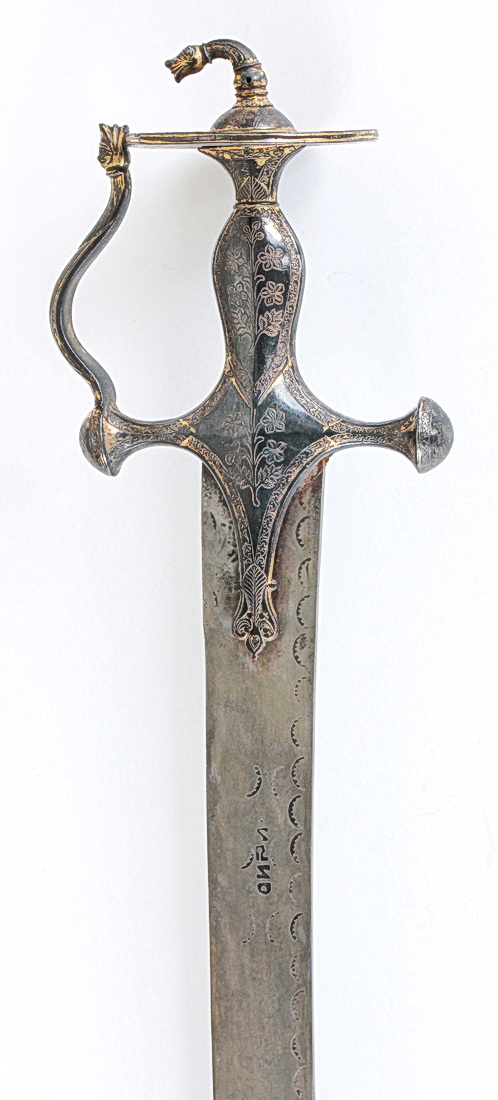

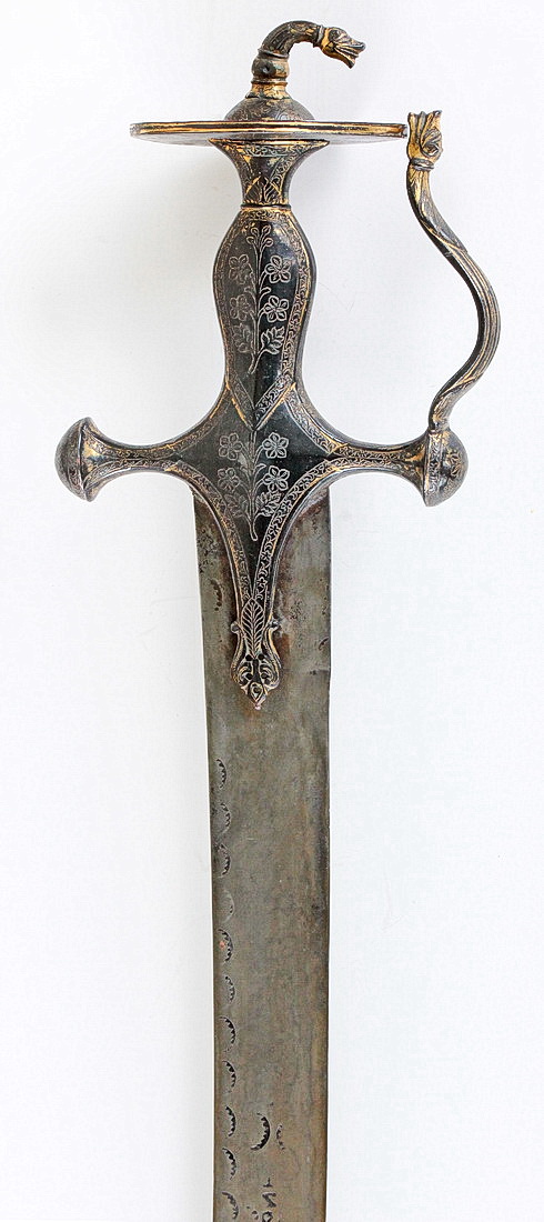

Attached is an example of an Indian blade with copied European stamps.
Notice how uneven the stamps have been made, on one side the letters start 20 cm from the quillon block, and on the other side only 12 cm from the block.
Hilt made of copper with remnants of its original gilding. Mughal 17th century.

In the case of the Bichaq; the dating from Jens translation is 1809 but the stamp doesn't indicate a specific bladesmith and is more just a general stamp you would expect to see from an ottoman, in this case greek blade? Surely the type of marking indicate some significance? There are many similar yet different types of markings on yataghans and bichaqs but do they have any relation to anything apart from "Ottoman markings ", perhaps even religious?
The Tulwars are interesting in the sense that they have Indian ricassos but european blades, were the blades forged then shipped to India or were ingots of steel shipped where they would then be forged in India? I've heard that due to European blades being cheaper but still high quality they were bulk traded into India. The tulwar which had the sickle markings is also a pattern welded blade. Were europeans able to forge high quality pattern welded blades (I've had people state that shear steel was more common place in european blades)? The sickle markings are also, as Jen mentions in the example he posted, higher on one side than the other. Is there any reason for the asymmetry of the stamps? Surely if you want to convey quality of a blade (or even counterfeiting) you would make them as true to an example as possible? I will retake some images for clarity and showing the asymmetry of the stamps. Is there any reference sources that you could suggest which markings indicate region, manufacturer, date? Also, why is it that Indians had steels such as wootz yet they insisted that european metal was better than the standard metals?
