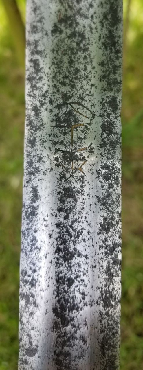

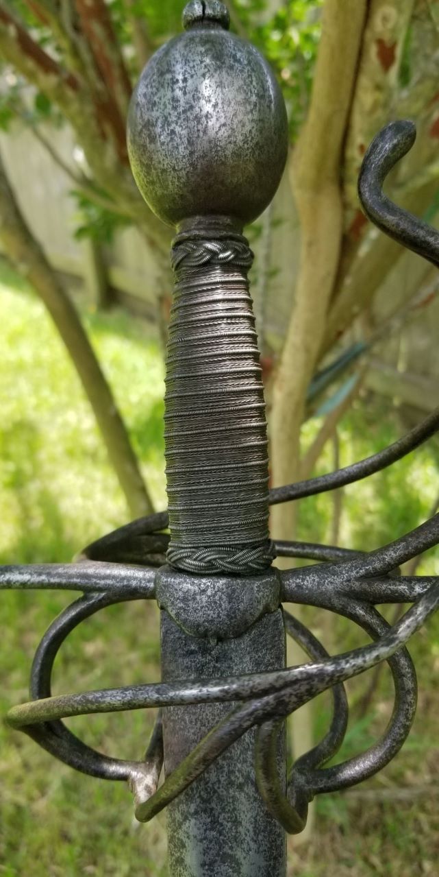

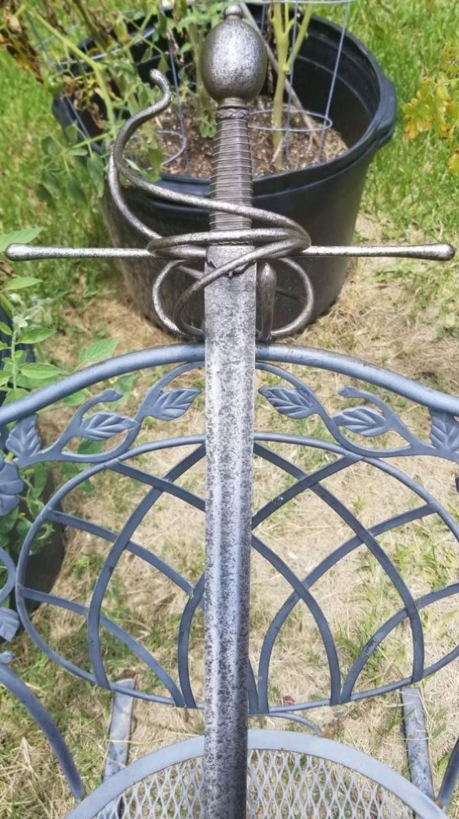

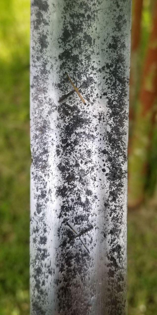

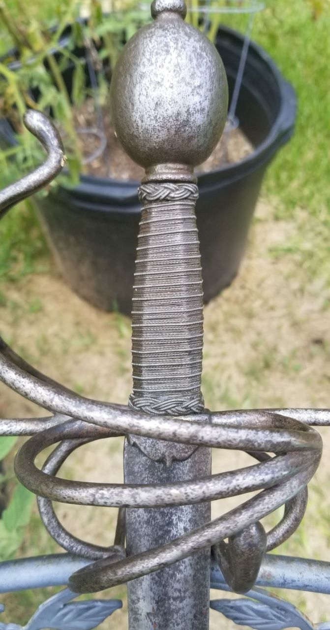

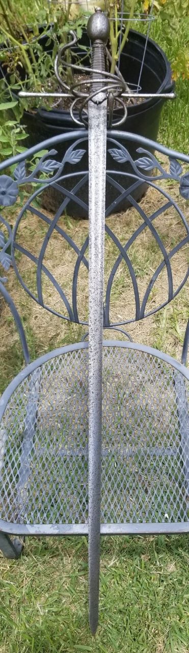

Does anyone recognize the copper inlaid X's in the blade? Thoughts on age, origin, other similar examples, etc? Measures 118cm. It's heavy but balances very well in the hand.

Because, precisely as you say, being a 'heavy' piece, i would (personally) call it a (swept hilt) sword, not a rapier. Can you tell the blade width at its base ?

I don't know about the single cross but the more elaborate mark on the first detail photograph is the reichsapfel, an imperial mark of a large cross fourche' surmounted on a girdled sphere, found very often on southern German blades of the 16th and 17th centuries.

Nando, the proportions of the blade do indeed suggest a cut-and-thrust weapon more properly termed a riding-sword, or spada da cavallo. Let's wait for the width measurement to come in, to be sure.

Yes, Nando, it definitely looks equine to me. Come to think of it, the verbal description provided a big hint because a true rapier, being a thrusting weapon should have a livelier more responsive balance without the greater mass that is desirable in a sword that would also be usable for cutting.
