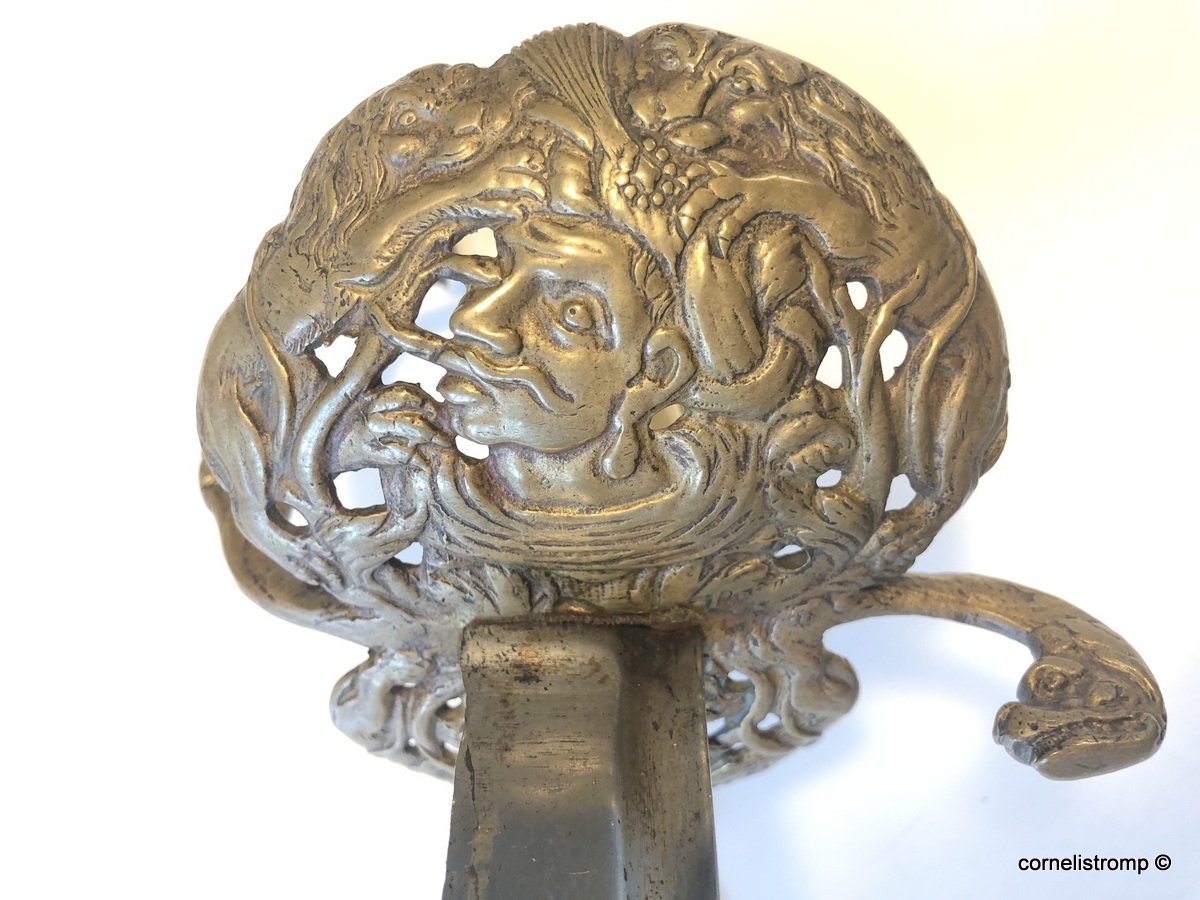

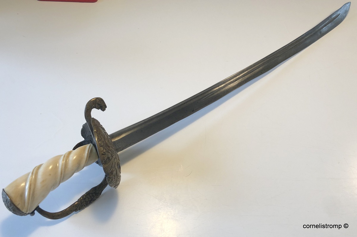

I recently purchased this hanger at an auction. The cutlass is of a very large proportion, almost 90 cm long, with big brass cast shells of unequal dimensions, an ivory carved grip and a cast pommel cap. the sharp blade has a slight bow and a 20 cm sharpened clip-point.
Weapons of this type, construction and material were made in the Netherlands in the second half of the 17th century, mainly in silver and brass.
My theory is that this weapon was also made in the Netherlands for the export market, probably Russia, given the design of the pommel cap.
The image of the Sultan on the shells, attacked by two hungry lions is probably Mustafa 2, an Ottoman sultan who reigned at the end of the 17th century.

An excellent sword indeed; and with such a powerful blade for a hanger .

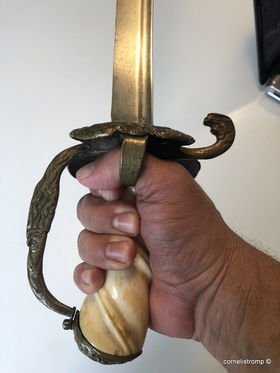

That’s a lovely sword, Jasper. Congratulations. I like the honest signs of wear and the historic decorations which you commented on.
Do you think the sword originally had a tang nut which was removed to rehilt it, and replaced with a peened tang?

hard to tell if there had been a tang button, see fe examples on
