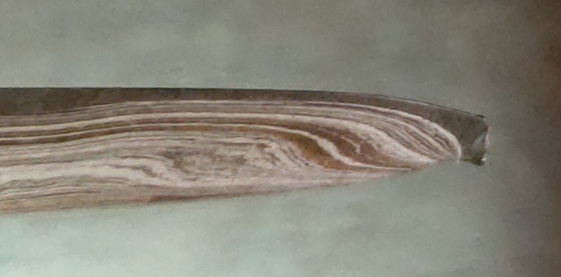

My keris tip is somehow damage by the courier company during inspection. The tip is no longer sharp but there is a small 'flat' tip. Anyone can advises should I leave it or try to fix it using a soft rubber hammer etc?

I straightened many kris blades damaged at the tip by means of small pliers first, then careful hammer blows on an anvil if required. I never faced any breakage of the tip but it can happpen....
The shape of your kris tip looks very rounded and the flat tip is very small?

That won't be easy to correct Anthony. If it was bent one way or another you might be able to straighten that out; but with it flattened like it is that will be a real challenge.
You would have to cold forge a new tip from the flattened area then dress it to a point with a file of some sort.

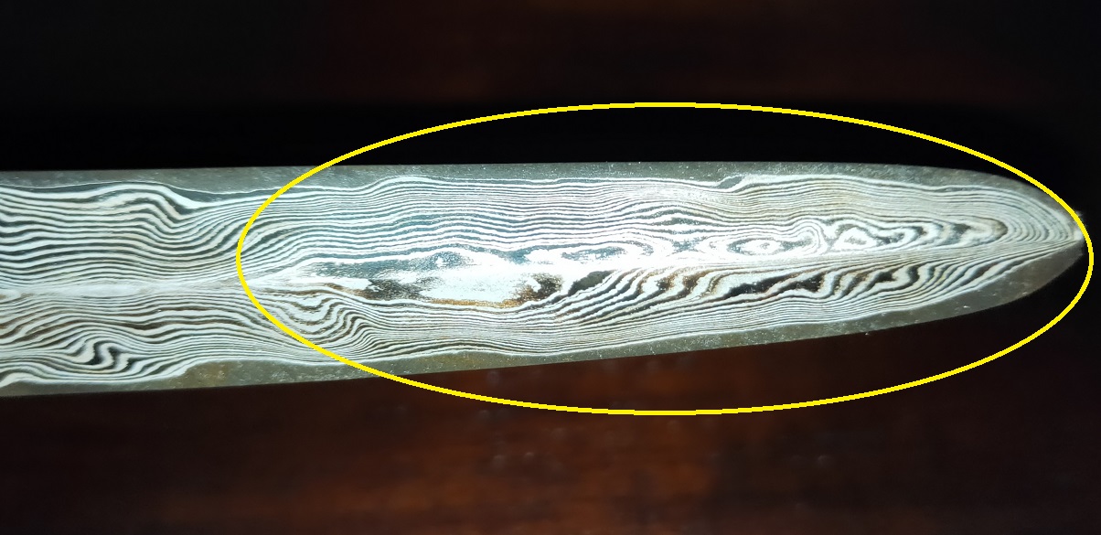

Hopefully these photo can tell more about the condition. The circled part has been heat treated.

Hello Anthony,
the hardening doesn’t seem to have been really effective - this can be straightened out.
If there was no damage to the parcel, the blade got dropped during the inspection. If so, you really should place a complaint with your customs and follow up on it; IMHO they need some feedback on handling the property of others!

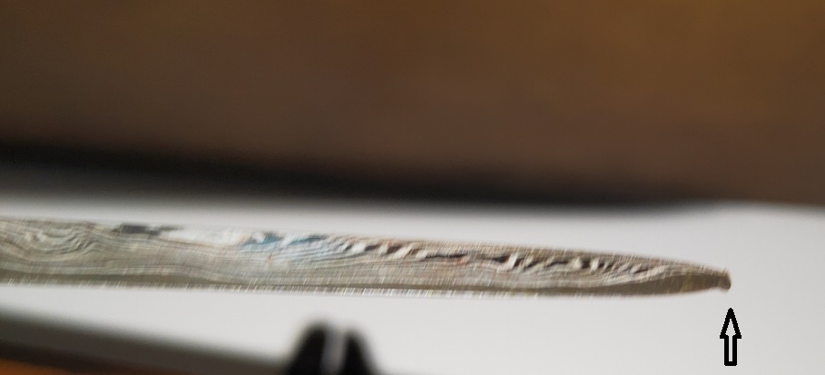

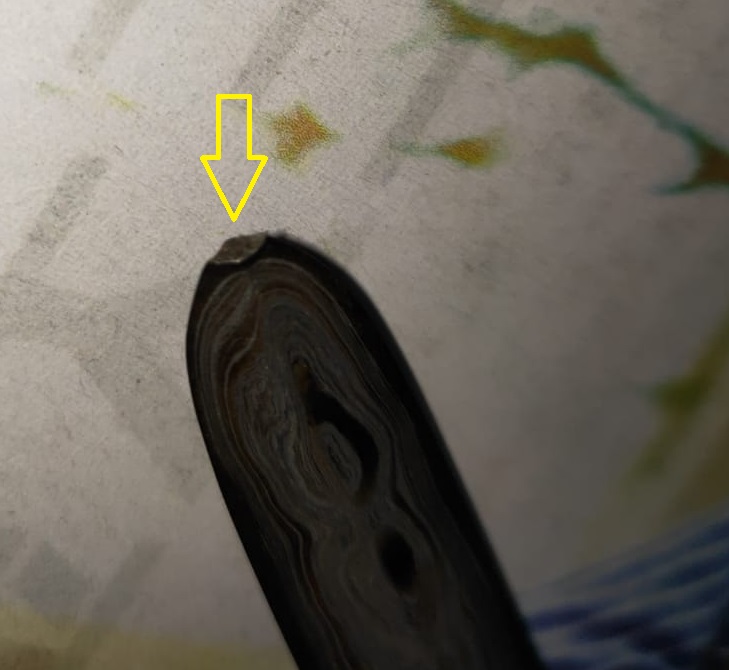

I'm sorry Anthony, but the tip picture is very unclear, I need to be able to see clearly the degree that this tip is bent, and how it is bent.
However, like Kai, I doubt that this blade has been hardened, if it was hard, the point should have broken off; if it was hardened there should be a reasonably obvious colour change that would be visible in the projecting edge of the core. I can see no colour difference at all.
See if you can do a better close up photo, I cannot see enough in this one.
I need to see the blade from the edge and I need to confirm that there is in fact no metal missing from the tip.
i tried to take many photo but results are bad. I took this photo which slightly tilted. hope it helps.

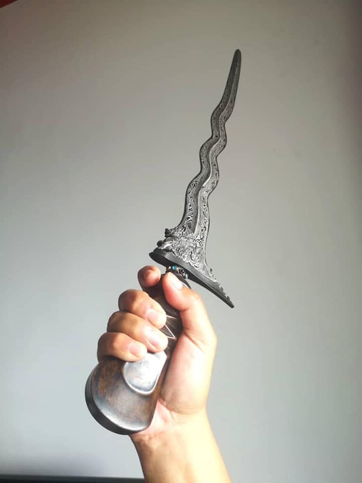

PPS: Very beautiful pamor. Why don't you show us the whole blade?
The brownish patination near the tip is not very visible and I wouldn't bother, but if you are bothered you can try and clean it with WD40, applied stricly there with a toothpick and some wrapped cotton. My two cents.
Thank you for your kind words.

Thank you for the photo!
I love to see beautiful blades, so more photos... please!
Lovely pamor!
Old 11th July 2019, 01:41 AM   #15
Anthony G.
Join Date: Mar 2018
Posts: 471
Lovely pamor!
Here you go.
http://www.vikingsword.com/vb/showthread.php?t=24903
Anthony G. is offline   Reply With Quote
And from the other side of the blade ?
I am interested to know what Alan will advise when we have the complete picture.
The other side of the bilah is the same. I will have to take the photo during weekend where it is better to take the photo during normal daytime. The photo will be clearer.
