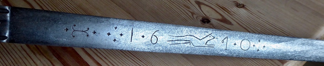

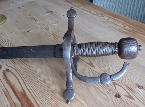

A possible 17thC sword for your opinions. O.A. 37 1/2 inches, blade 31 1/2 inches, lenticular cross-section blade, weight 1 lb 15 3/4 oz.
Some things seem o.k. to me. Patina, no modern welding, chisel engraved decoration, running wolf suits time period, numeral font, springy blade, handles like a sword intended for use, blade still quite sharp with nicks where one would expect, tang peen and general feel. Cons, the date, although I have seen this on genuine pieces, the crisp engraving although again I have seen this on genuine pieces. Looking forward to your ideas.

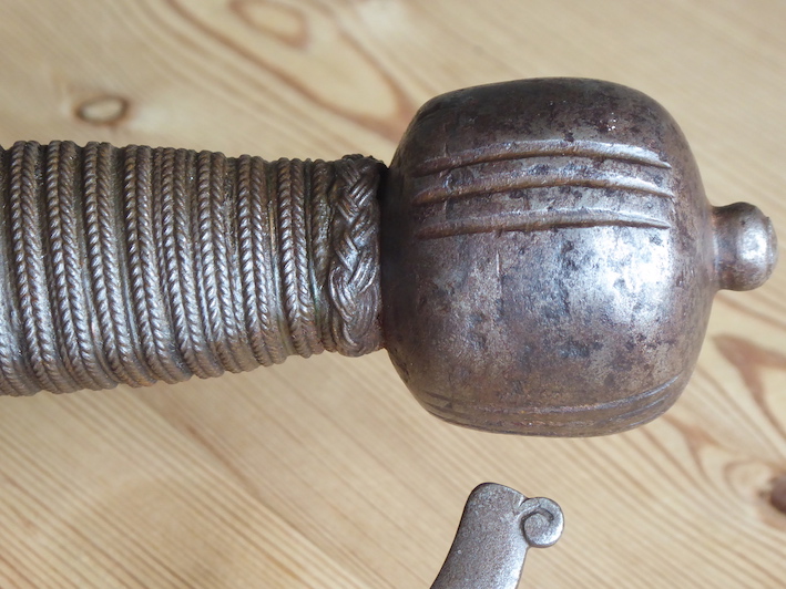

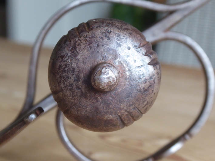

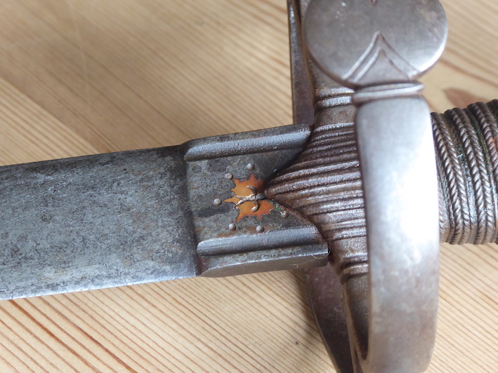

More Photos.

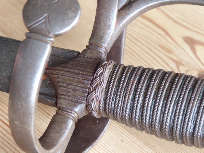

Another photo.

Norman, Im no expert on these things, I agree with you on the general crisp feel of the engraved numbers and wolf.
For me there is a crispness which seems to characterize the sword overall, which though very attractive, seems to have curiously combined elements.

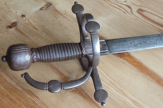

These discs in the hilt guard remind me of similar seen on some Spanish, Italian and even Portuguese 'navigator' swords of 16th into early 17th c.

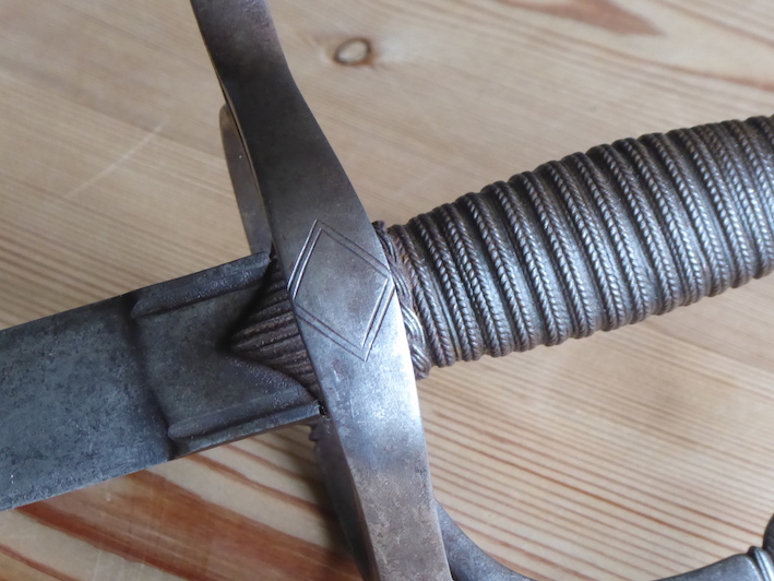

The striated escutcheon on the crossguard reminds me of similar features on some 18th c. smallswords. However all of these elements I cannot locate presently, it just seems I have seen them.
In the same way this resembles a mid 17th c. spadroon/rapier (plate VI, #22, "Schools and Masters of Fence", Egerton Castle, 1885) with simple guard system though not quite same, but pommel seems similar.
Returning to the engraved numbers etc. these seem inconsistent with these 'magical' themes which were popular in early to mid 17th c. These were not dates, but numbers with magic properties. It seems to me the '1' should be with serifs, and the other '1' seems intended to resemble a magic glyph or sigil which were often interpolated into inscriptions and sometimes numbers.
The 'anchor' seems unusually simple and atypical.
The wolf is of course similar to most examples seen and configured OK, but as these were freely chiseled rather than stamped, variation is expected.
The lenticular blade seems unusual, with blocked ricasso, for 17th c.
The wrap is remarkably crisp and sound, the turks heads seem cast?
Wire wrap of these periods seldom survives intact, examples I have had and seen almost always have this at least somewhat unraveled.

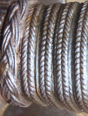

Many thanks for your comments. A few further points, the Turks Head is made from individual strands, see photo, the crud of ages is giving the illusion of a homogeneous casting. The decoration on the blade and hilt all appears to be hand chiseled. As far as condition goes it does seem pretty good but I think we always need to be cautious re condition as some items do survive in very good order and although wear and tear can be a good indicator of age it is not a given. If indeed it proves to be a 19thC piece, which it may very well be, someone has gone to a lot of trouble to make a sharp flexible sword with very good handling characteristics and not a 'brick on a stick' as someone to aptly described a lot of the Victorian wall hangers.
Thanks again for your interest.
My Regards,
Norman.
P.S. My Elmar lens seems to be adding a little enhancement to the images. It's a bit muckier than the photographs would suggest. I also gave it a good wipe down with an oily rag to remove the surface muck.

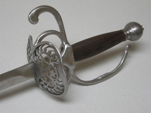

The example of 'spadroon' sword (pictured below)is a modern reproduction but with a shell and obviously of loosely similar structure as this, and accordingly light blade.

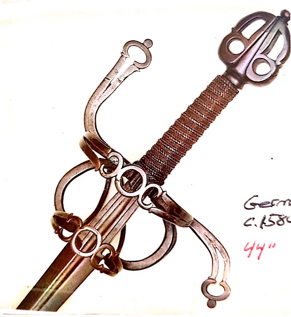

With the discoid elements noted throughout the hilt elements, I found in old notes a German ('fighting sword' as described) of late 16th-early 17th) which has these type roundels, though pierced. I thought them pertinent and posted the picture below.

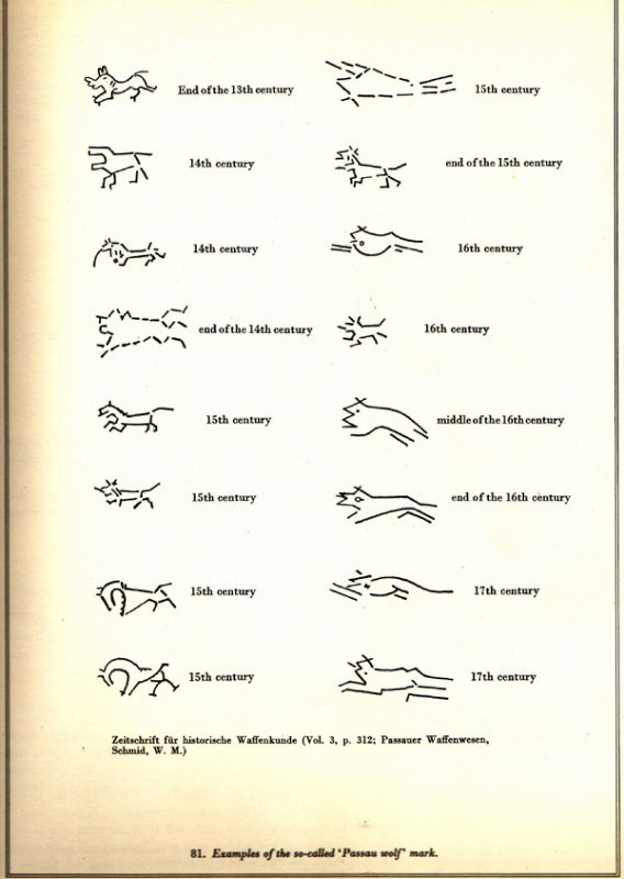

Getting to the inscriptions, which as I mentioned seem crisp, and uncharacteristic of the talismanic inscriptions based often on magical glyphs, symbols interspersed with key numbers which were popular in first half of 17th c. These were often contrived with what appear Glagolitic, and even runic alphabet characters or interpretations of them.
The running wolf is placed as often characteristic within the numbers, which seem in most cases variations of 4's and '1' s but others do exist.
The wolf however, seems to be placed facing the reverse of most examples I am aware of....this of course is nothing conclusive but worthy of note.
(see plate from Wagner, 1967, below).
