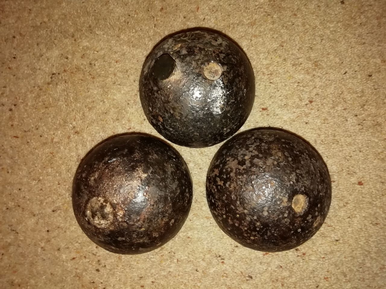

Hi,
Are these cannonballs? They are cast iron. I initially thought they were ball grenades, but they are completely solid. I haven't seen a cannonball with what looks like a bronze stud in it before.
Each are just under 3.5” in diameter making them 6 pounders.
Can anyone shed some light on these?
Thanks

Hmm. Those are interesting. My initial thought was that they might be one of the many cannonball look-alikes (shot puts, counter weights, etc), but then I wasn't so sure. Could these be coehorn shells filled with metal? I've seen this before. I once had a Confederate shell filled completely with lead. The protruding bronze could be sprue? Or were they bar or chain shot, but cut down over time? Or are they just the top of a flagpole? Hopefully those more knowledgeable on ordnance will chime in-

If as you say this 'thing' has circa 3 1/2 " as for a 6 pounder solid shot, it should weigh circa 2 600 grams (5 3/4 pounds).
If it were a howitzer ammo (bomb=grenade) should be much lighter, even if fully loaded with explosives.

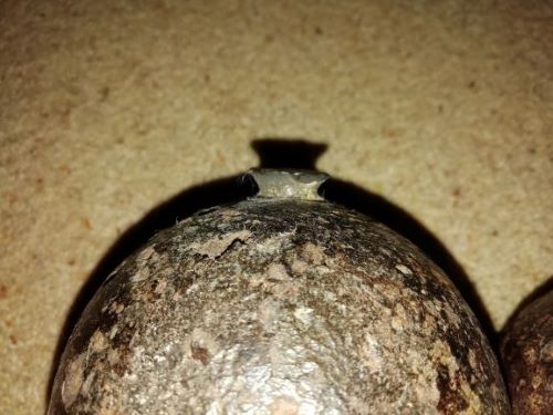

But then, being a solid shot, it should (could) have a visible seam mark from the casting and, what looks to be a fuse plug ... is not.
Could you tell us more about the 'bronze' studs ? Do they appear to be 'unpluggable', or do they look definitely fixed ?
You know there are iron balls out there made for purposes other than ammo ... like windmill vane counterweights and other.

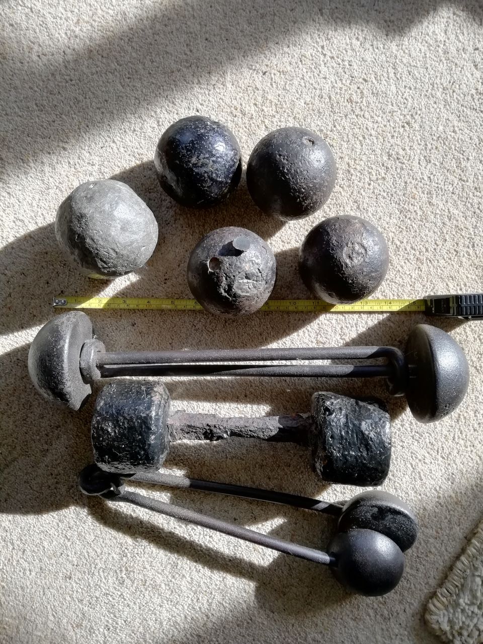

I got a chance to have a look in an old museum collection today and found another 6 pounder and a 24 pounder, each ball with a similar stud (1st attached image of the museum’s 6 pounder, 2nd the 24 Pounder). Sadly, no further info available. What are the odds of the museum also having such similar balls?
Fernando, thank you for the image. The studs must be part of the manufacture process. It vaguely looks like the mould seam runs around the balls’ circumference, 90 from the stud but it’s hard to tell. The stud is very solid and sprue-like, roughly 1/2" wide. M ELEY, all of those are ideas seem quite plausible the 3 1/2 ”-ish ball with the stud weighs 2707g, I also have a known 6-Pdr wreck recovered ball which weighs roughly 2300g so maybe the stud one is filled with bronze? There is only 1 stud, same with the examples in the museum.
Also attached is an image of some bar shots acquired at a similar time.

the bronze plug would not spark while inserting it. Should be hollow for a charge.
Pre 1800 British cannon balls have a broad arrow mark deeply in them.

... Also attached is an image of some bar shots acquired at a similar time.
How i envy those. Still missing one in my ammo collection. If you happen to have one too many for spare, just let me know .

If it is filled with lead grape shot leaving some void area, the resulting density might be similar to if it were solid steel. Or maybe it is a cannon ball but a replica just made to look like it is hollow.
Google images ,cannon ball plug hole, cannon ball wooden fuse, etc and you'll see other examples that look like yours. Click the images and many will lead to further discussion. Apparently one hole was a fill hole and one hole was a fuse hole that was kept plugged until use.

As CSinTX suggests is spherical shrapnel, cannon balls with smaller balls inside with a charge to burst. http://thepirateking.com/historical/...rojectiles.htm
Old 6th April 2019, 03:29 PM   #12
I see the point, Will.
In this case the improved shrapnel version, the so called Boxer's diaphragm shell, with an opening for the explosive load and another for the fuse, as also approached by CSinTX. This would date the discussed examples from around mid XIX century.
One way or another, considering their weight and the looks that their plugs are still sealed, could they still be loaded ?

Unlikely the cannon ball is still with a charge but you cannot know without disassembly. Being so old any powder should have degraded.
With guidelines of the day followed these type cannon balls should not have a charge.

These are, I think you will find, the expanding rivets which were placed there to attach wood bottoms to the projectiles. The wood bottoms have, on projectiles that still have a rivet affixed, either split or rotted away. The use of expanding rivets replaced the use of tin straps, on British ordnance, in the 1860s. Wood bottoms were required with fuzed spherical projectiles, to keep the fuze pointed forward. There were also used with solid shot in brass guns to prevent bore damage. A single rivet in large natures indicates Land Service whilst two smaller rivets meant Sea Service. Below is an extract from an unpublished work, it relates to British artillery Circa 1865:
Common wood bottoms were a disc of wood and the sides were shaped to be either conical, for Gomer chambered ordnance, hemispherical for cylindrical chambers or were left cylindrical for all other ordnance. The nature for which the bottom was intended was stamped on the underside of it. They were hollowed out to accommodate the base of the projectile and common bottoms were fixed with a single central rivet of gun metal. Wood bottoms for naval use were in only 32pr and 8 inch, or 68 pr, size and were all conical shaped. The hollow went completely through the wood bottom, leaving the underside of the shell flush with the lower surface of the bottom. This was necessary to enable the projectiles to be in actual contact with each other when double shotted, it also meant that a single central rivet could not be used to fasten the bottom and so two rivets were instead used, inclined towards the center. Refer also Commentary on page 78.
The navy’s use of wood bottoms in bronze 6 prs with the 4 ounce charge for drill purposes was prohibited because it was found that firing a loose ball with such a small charge did not harm the bore and so wood bottoms were unnecessary.

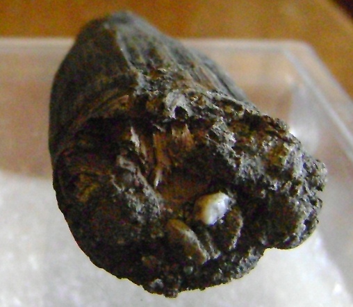

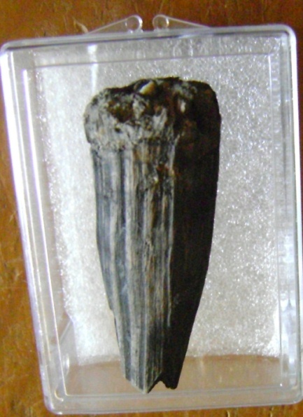

... Fernando, what is your fuse in the acrylic box made of? Is it like hemp match, the sort used for matchlock musket?
I wasn't clear enough. The clay grenade wooden fuse was shown in the bottom of post #7.
The item shown in recent post #23 is in fact a portion of XV-XVI century haquebut matchcord 'Luntenstrick', also offered by the late Michael Trömner (deceased illustreous member 'Matchlock').
