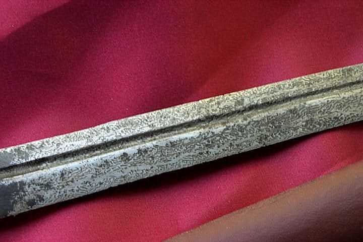

Default kindjal - what kind of technique is it ?

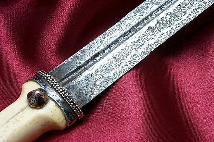

Dear All,
Very unusual kindjal. I alway wondered what is it - damascus, sophisticated etching or something else.
Thank you very much in advance.
Rivkin is offline   Reply With Quote
Old 17th May 2006, 04:13 PM   #2
ham
Posts: 190
Hello Rivkin,
This is acid etching to simulate a damask, it was probably done in Tiflis.
Sincerely,
Ham
ham is offline   Reply With Quote
Old 17th May 2006, 07:10 PM   #3
Very nice job. It has certain chaos in it, as opposed to the "fuller job" that is so often seen, and it imitates damascus so well that even Kirill was uncertain
Could we see the rest of this Kindjal?

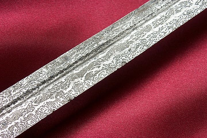

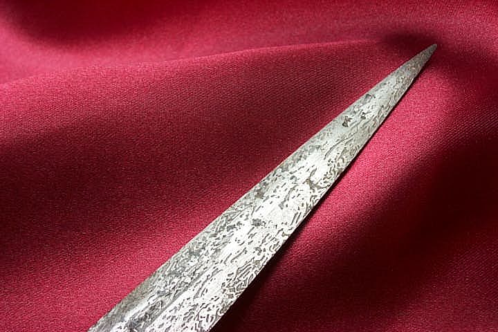

Old 29th May 2006, 09:47 PM   #4
Rivkin
Posts: 655
Ham - excellent, right on target. Kindjal is indeed from Georgia, but I was truly puzzled by the technique. Thank you very much.

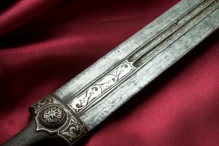

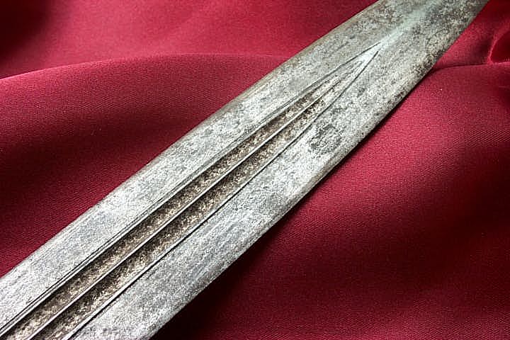

Ariel - well, not all of us are senseis , plus I really suck in understanding the metalwork.
Attached are kindjal's pictures.

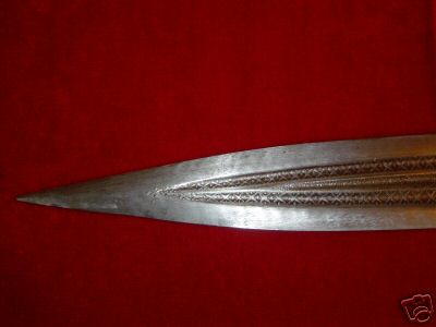

Old 29th May 2006, 09:51 PM   #5
Rivkin
Posts: 655

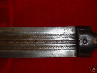

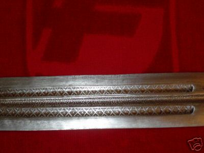

To continue our kindjal's discussion - the first is an interesting georgian (?), even more precisely imeretian (??) speciman. The most interesting are the fullers - inside them one can see a set of extemely small dots, creating a highly unusual pattern. I have no idea what it is, it is far smaller and spatially irregular, i.e. the dots are very small, than any etching I have seen.

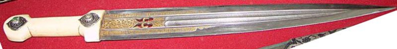

Old 29th May 2006, 09:55 PM   #6
Rivkin
Posts: 655
And finally - sorry, these are the only pictures I have on this one. Sort of way too expensive for me. My take would be that it is something from eastern, probably south-eastern caucases, seen many of them with similar motiffs.

Old 30th May 2006, 04:01 AM   #7
Acid-etching within the fullers is esthetically appealing and structurally safe.
But the more I look at the first one (total blade etching), the less I like the potential effects on the edge: seems to me that acid ate through quite a lot of steel and some areas of the edge became thin and prone to breaking. This is likely the cause of many "non-traumatic" nicks.
Old 30th May 2006, 04:48 AM   #8
Rivkin
Posts: 655
Oh, I believe this kindjal is not for real use, sort of late XIXth century art-nuovo poking stick.
I really like the second one nevertheless - truly beutiful, like starry night. Can it be formed by etching or something more complex was used.

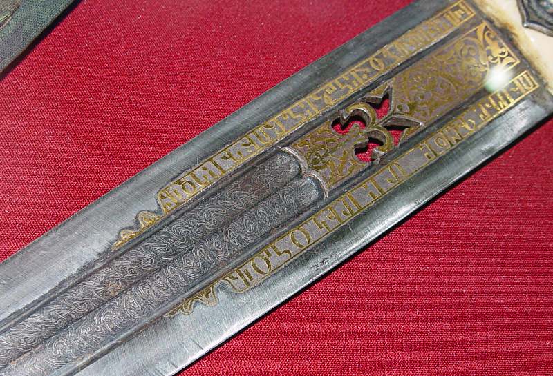

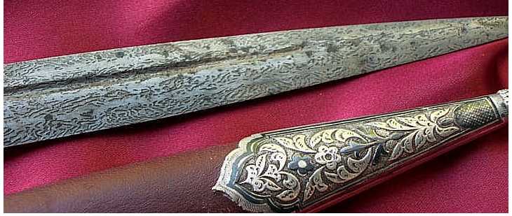

Old 2nd June 2006, 01:03 AM   #9
Rivkin
Posts: 655
I almost cried. Kindjal, I would say Tbilisi, armenian work, 1800-1830.

Old 2nd June 2006, 05:41 PM   #12
It is also etching.
Can you read the inscription?
I wonder why all the pieces with Armenian inscriptions come from Georgia. Sure, I know that there were many Armenians living there. But, why nobody, to my knowledge, refers to any centers of swordmaking in Armenia proper?
Old 2nd June 2006, 06:05 PM   #13
RSWORD
RSWORD's Avatar
Location: Greensboro, NC
Posts: 1,099
In my opinion, the last Kindjal posted with the walrus ivory grips, the pattern in the fullers is the result of twist core pattern welding and not an acid resisted etch. You can clearly see the line of demarcation down the center(albeit, it is not perfectly straight, nor should it be) in both fullers. The pattern is a classic "Turkish Ribbon" style of pattern. You see this particular starry night pattern as Ariel put it on some Yataghans, some Chinese blades, some Moro stuff and if you go far enough back, you see it in some Viking blades as well.
