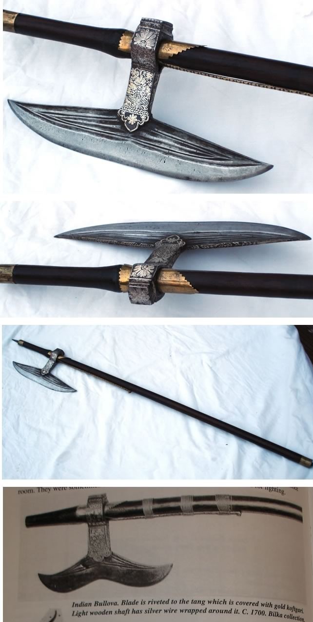

Another one scored on ebay, what do you think about that piece?
66320147726632014772
I'm fascinated by bullovas and I do not even know whay. Another tremendous piece... what do you think?

Valjhun: I am no expert on bullovas, all I have is my rather plain example, but I can confidently agree with you that the one that closed earlier today on eBay was a gorgeous piece. Of course, it also has its original haft with brass mountings and I especially like the small spike on top.

Now here is another bulova that closed on eBay recently, but for some reason I did not quite like it. I cannot explain it but something about it feels wrong. What do you guys think?
http://cgi.ebay.com/ws/eBayISAPI.dll...tem=6631832279

It looks verry strange, like most of other things he was selling. Casting perhaps?

I also noticed that most of the items offered by this seller looked as coming from the same shop and were all of very poor workmanship. This, combined with the sudden abundance of such items in his or her inventory cannot help but raise suspicions. Not to mention that despite their diversity - axes, lances, daggers, katars, from Persia to Chota Nagpur - they all looked very similar in terms of materials and finishing. I have a feeling we are about to see a lot more of them in the future. Unfortunately.
Of course, I am not stating anything, but just expressing a suspicion.
