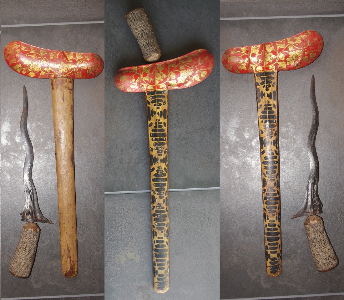

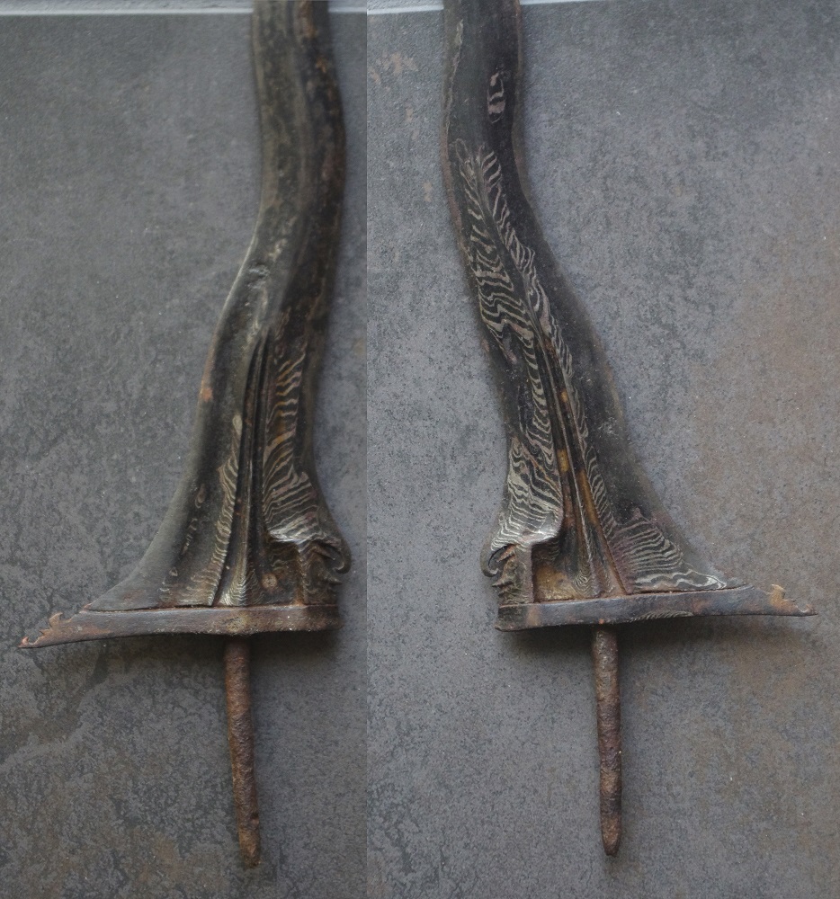

Here is my only Keris with a painted scabbard.
The old blade presents a very original pamor, even if it has largely disappeared.
The scabbard is made of a light painted wood except on the back of the Gandar.
I have the impression that it should originally be covered with a pendok.

Nice old kris, congratulations!
The blade is very short as compared to the scabbard and has a worn leaf pamor (Blarak Ngirid or similar?). I am curious to know the opinions from the members about its origin (Bali/ Lombok or Java?)

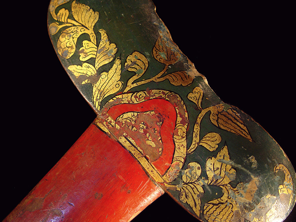

An interesting keris Athanase. Can you tell us how long the blade is as it looks shorter than the norm for Bali blades? I also have a similar keris in that it is Bali/Lombok with old sunggingan (painted sheath) and the blade is particularly short for a Bali keris though the sarong is normal size just like this one seems to be. I agree that this, just like my own, once had a form of pendok, the Balinese type that covers just the back and sides and leaves the front open to expose the wood.
Mine also has a Tapukan style hilt like yours with a hair wrapping and has red paint on the wood as well to match the painted sheath.
My feeling is that these shorter keris are in normal large size Bali sheaths to accommodate the normal method of wearing the keris. I'm not sure about the significance of the shorter blades. They do not seem like patrems, but there must be some significance to the shorter lengths i would imagine. It does seem the the larger lengths on Bali keris is more of a later development though, so maybe these are older blades being fitted for the normal customs of wear over time.

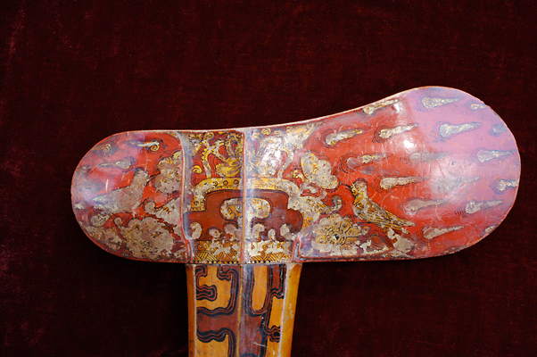

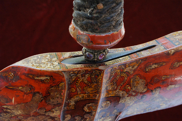

I am afraid that i do not have too may photos of mine currently, but here are a couple of shots i have for comparison.

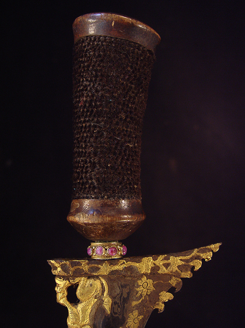

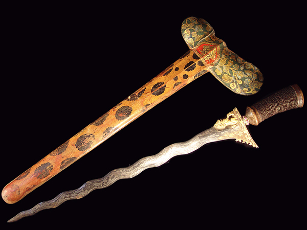

Here is another similar dress combo of sunggingan sheath and Tapukan hilt, though the blade seems a more standard size.

Few observations & questions but not conclusions about Athanase's kris:
. The sunggingan sampir appears quite recently painted?
. Yes, the blade has some Bali/ Lombok features such as the twin lambe gajah, groove on the front of the ganja, ganja wulung, etc. but what about the pamor pattern and blade surface?
. Any reason for such a short blade size? (it does not seem to have been significantly shortened). How does it fit into the scabbard slot?
. Since at least the 1990's, the krisses from Bali/ Lombok fetch much higher prices than the Javanese ones for the tourists so it is common to fit Javanese blades into Balinese scabbards for increasing their market value.
. Are the Sasak from Lombok wearing the kris high in the back like the Balinese?

Originally Posted by David
Here is another similar dress combo of suggingan sheath and Tapukan hilt, though the blade seems a more standard size.
Mismatched blade and scabbard?
Old 25th February 2019, 02:19 PM   #10
Posts: 7,303
I have no idea judging solely by these photos. Why do you suspect so?

Yes, the blade certainly has Bali/Lombok indicators. As i said earlier, i would more suspect Lombok. The keris is old, but from what i can see in the photos it still looks like a it once had a polished Bali surface. And the way the gonjo is cut and the quality/look of the iron reminds me very much of an old (and short) Lombok keris i once owned.
The sampir is designed for a ganja kelap lintah...
Old 25th February 2019, 03:44 PM   #13
Posts: 7,303
Well, you might be correct there. Not something i really noticed from these photos. However, my purpose in posting was to show similar dress to both Athanase and mine. Whether or not the blade was re-fitted to this dress was not really important.

The fitting of my keris in the wrangka is near perfect.
The wood of scabbard is light and less quality than my non-painted balineses Keris.

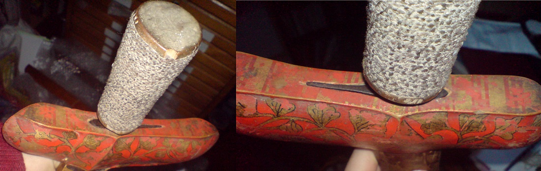

The pictures.

Thanks Athanase. Given the small size of this keris and the lack of visible fillers it would seem that like my example your sheath was made specifically for this blade.
