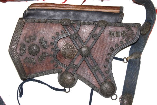

Hi everybody
Need your help with this one: A short quiver with its belt, which I believe may be Manchu-Chinese from 19th century with some Tibetan influence (the cross straps on the front). It has bronze fittings and leather cover. Samples with pierced gilded fittings and velvet cover are often described as being used by the Imperial Guard in Beijing. What do you think, who may have used it, where, and when?
Are you aware of any pictures/paintings/lithographs etc of Chinese soldiers from the 19th century that use this type of quiver? I have only found a painting of Prince Yunli bye Giuseppe Castiglione from about 1730, and that is about 100 years too early, I guess.
Looking forward to your comments,

While apparently the reference to Peter Dekker was well placed and seems to have satisfied the OP, as the thread has stopped here, but I wanted to add some information for those readers who might have interest in knowing more on this topic. Indeed, Peter Dekker is an outstanding reference as what I was able to find was from his work, and I will try to add a synopsis here.
This very interesting quiver is as noted, a Manchu form, but distinctly with Tibetan influence. According to LaRocca (2006, p.172) this crossed strap form quiver was earliest known as Tibetan/Mongolian of 15th-17th c. Mongolia had profound presence in Tibet until 1720s when driven out with Qing assistance.
(to clarify Qing and Manchu refer to the same dynasty).
The Qianlong Emperor (1736-96) of the Qing dynasty was apparently a devout Tibetan Buddist, and was profoundly influenced by Tibetan arms forms, often having his forces using weapons with this influence. It appears these style quivers were of a form used by his bodyguards and probably in the famed troops known as Bannermen.
As I understand some of the devices seen on this example, the 'vase' with halberds indicates a level of high rank, three the highest attainable.
The 'five bats' represent the five blessings.
These Manchu style arms were likely continued with the succeeding Jiaqing emperor (r. 1796-1820) and Daoguang emperor (1820-1850).
While this example quiver appears to be with the potential for courtly use with the Emperors guards, it seems possible that similar types might have been used by other elite Manchu forces.
As I had mentioned there were Manchu garrisons in border regions of China adjacent to Tibet; Sichuan, Yunnan and Qinghai during the 18th c.
I hope this might simply add some information to this thread before it goes into the archives.

Hi guys! Thanks for the endorsements.

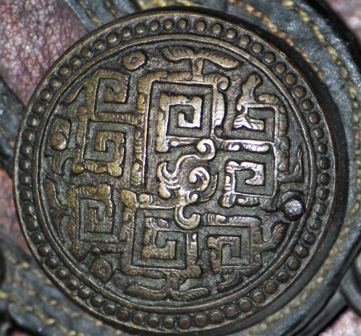

This is a very interesting quiver. It is of a type worn primarily in the capital for court assemblies. Imperial guards had several sets, with a different color for each occasion. These imperial guard bow cases and quivers all had gilt mounts, and the piece was either black leather or a color of silk velvet.
The tooled leather and brass mounts on this set indicate it was not an imperial guardsman's quiver, but a soldier's piece. But not just any soldier had quivers quite this fancy, he must have been among the troops that participated in military parades.
The decor is interesting in that it diverges from the norm somewhat. Most imperial guard and soldier's quivers of this type have exactly the same mounts, with the difference that the imperial guard pieces have gilt mounts. I've found the exact same imperfections on many of them, indicating they were all from the same mold.
This piece is decorated not with the usual design of dragons among pierced work, but with archaic kui dragons that were inspired on the work on ancient Chinese bronze vessels that were popular among the elites. Many late Qing saber mounts and belt hooks were decorated in exactly this manner, but it's the first time I see it on a quiver like this.
Great piece, also nice to see the belt is en suite.
As for the cross straps, they are first seen on Persian quivers and probably made their way to Tibet and Mongolia through the silk road / Mongol expansion. Qianlong probably was inspired by the Tibetans, as the guards on some instances also wore Tibetan style swords.
