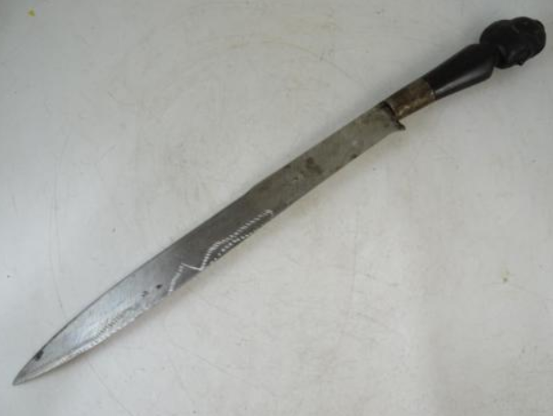

I do not know much about Philippine weapons, but am sure I have never seen anything like that.
Doesn't the blade look yataghan-ish?
Had it not been for the pommel, I would have thought it was a late 19th century yataghan.
Am I imagining?
Old 11th January 2019, 12:35 AM   #2
Posts: 4,747
Hi Ariel:
This appears to be an Ilokano piece from N. Luzon. It probably falls into the general category of a dahong palay, a well recognized Ilokano blade form that has been discussed on this forum a number of times. Perhaps it is the angle of the picture that gives it a somewhat yataghan shape, but usually the width of the blade is uniform up to the area where it narrows to a central point.
Ian.
Old 11th January 2019, 02:31 AM   #3
Thanks Ian.
Now I am content: no yataghans in Luzon.

Originally Posted by Ian
Hi Ariel:
Ian.
Strongly agree, definitely a dahongpalay (or dinahong-palay, depends on which area classifies it). And yes, agree that it's from Ilocos, most likely Santa, Ilocos Sur.

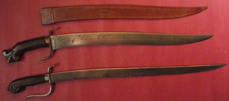

Old 14th January 2019, 06:19 PM   #5
RobT
RobT's Avatar
Join Date: Mar 2005
Posts: 653
Default Philippine Yataghans?
Hi All,
Would these two Philippine short swords qualify as having yataghan blades?
Sincerely,
RobT
Old 14th January 2019, 10:34 PM   #6
Posts: 4,747
Hi Rob:
These are two recurved knives/swords, and resemble a yataghan in that way, but I think that is where the similarity ends. Recurved blades are found in many cultures, probably reflecting parallel development. The yataghan is one of many examples.
Ian.
