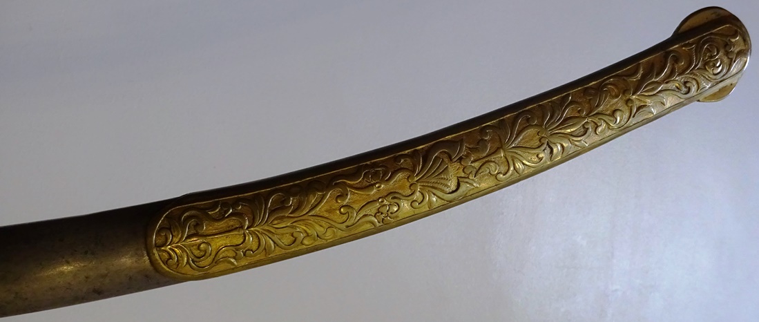

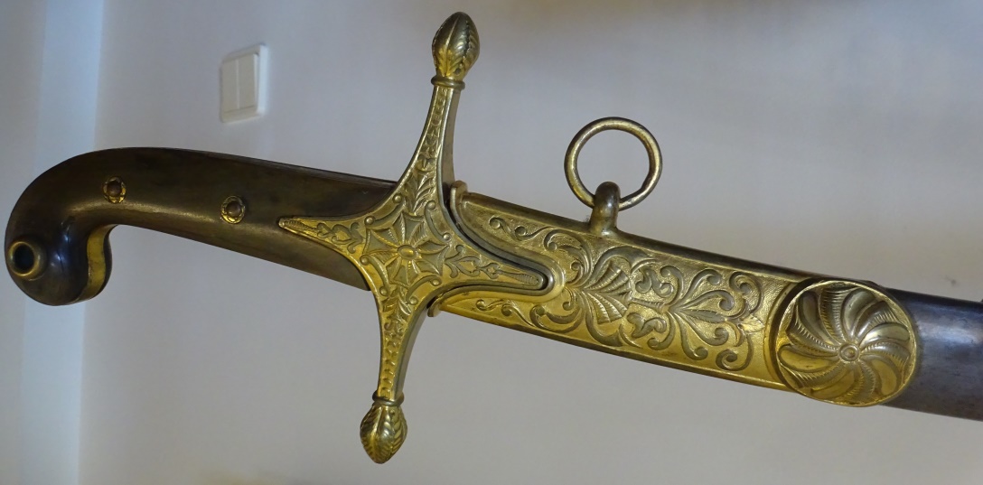

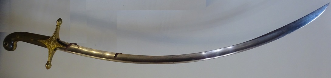

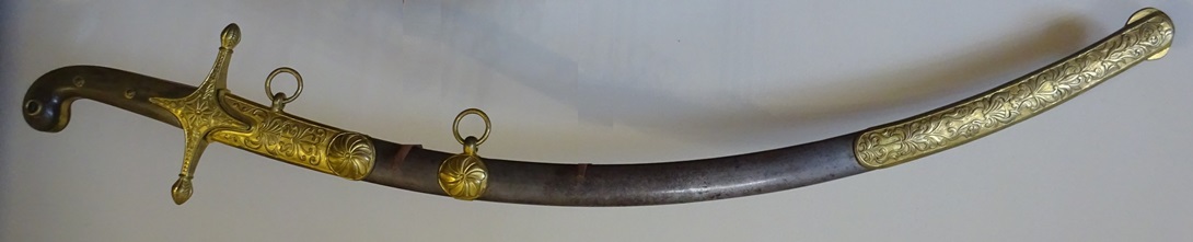

This appears to be a French light Cavalry saber à la Mameluke, for a superior officer of the First Empire.
With a blade length of 72 cms. (measured around) and a bow of 83 m/m. Total length 83 cms. (in a straight line) Sword weight 715 grams. The 'dark' steel scabbard weighs 511 grams. All other (visual) details need not to be mentioned, as pictures speak for themselves.

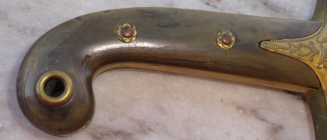

Could you guys confirm this identification and are able to discern if the grip is rhino horn ?

After having consulted the book "Les Sabres portés par l'armée Francaise" de Lhoste/Resek I tend to say that this sabre is a "sabre d'officier supérieur de Cavalerie légère, modèle à l'orientale vers 1830. Are there any signatures or marks on the blade? By the way, all the similar sabres of this type shown in the book mentioned above have no rhino grips. They all have grips of corn, ivory, ebony or nacre.

Thank you so much for your comments, corrado.
The rhino grip was only a guess. I thought of that, both because of its unusual (to me) color and also influenced by a an extremely expensive example from the same period that i saw in the Web, with a finger ridged rhino grip .
No, unfortunately after turning it around and around i found no marks or signatures.

We'd need to see a close-up of the end grain of the horn for any identification.
http://www.vikingsword.com/vb/showthread.php?t=6162
From general appearance, I'd tend towards it possibly being some blonde variety (probably from cattle; rams also often exhibit lighter colored horn).

Thanks much for caring Kai but, no need to browse further.
That was me giving wings to my imagination. After looking to the description and pictures of other examples, i am now certain this is some sort of "corne blonde" , as you suggested.

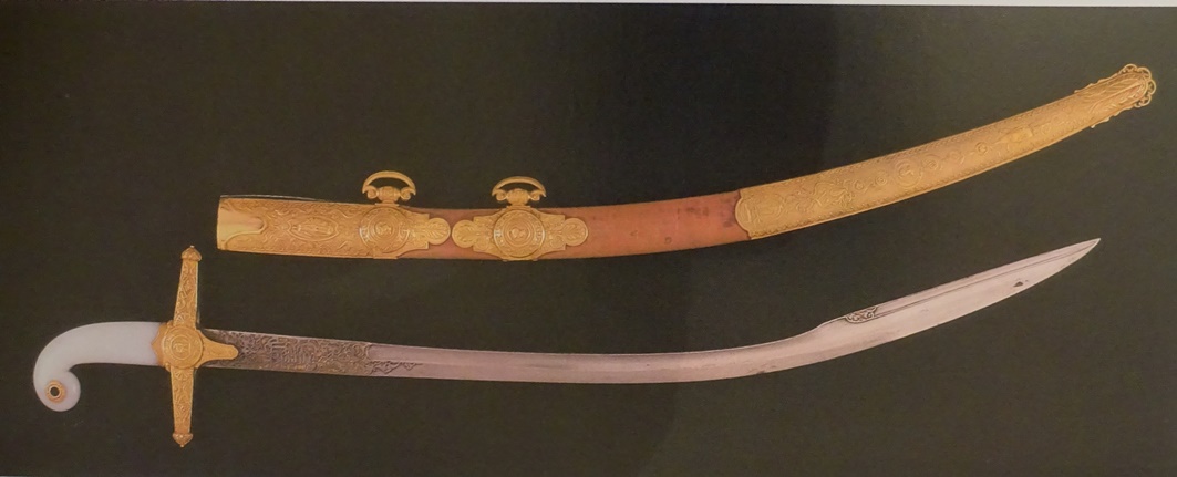

It is amazing how these Mameluke style swords 'digressed' into a path of luxury, their ostentation attempts reaching exponential limits. Some examples are so breathtaking that it hurts to watch them.
This 'specimen' from the Royal collection kept in the Armoury of the Ducal Palace of Vila Viçosa may not the be an extreme achievement, but certainly mid way to it. All parts are gold (not golden), with the Paris proof house hallmark circa 1809; except for the grip, which is jade.
Such a pity that the picture in the catalog is rather small and the details can not be clearly appreciated. Just for perusal (all) chiselled motifs include Hercules fighting the lion, chariots pulled by oxen and deer carrying persons, a knight protected by a buckler, the head of Minerva, a woman figure, man and woman heads, volutes, palmettes, lyres, amphors, horses, arabescs.
This certainly is not a fighting sword but, surely a sword i would fight for
