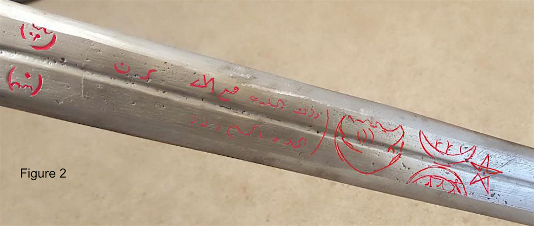

It's interesting to note that the scratch-engraved half-moon and star designs on the center blade of Figure 1 (see Figure 2 for its enhanced engraving) is almost a duplicate of the blade in Reed's Plate LVb (Figure 3). While Reed's Darfur blade has only a single narrow fuller, it was likely made and engraved in Kassala by the same hands as the example in Figure 1. This Kassala example was purported to have been “a Mahdi sword” supported by the talismanic moons and text engraving suggesting a high level of religious devotion.

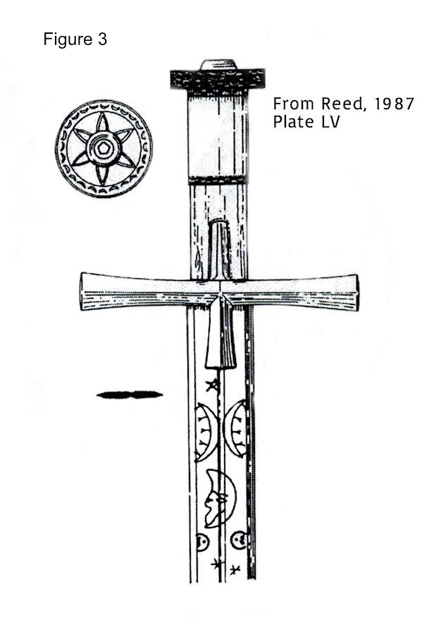

Similar to the Daud but the part of the blade near the handle is decorated with engraved scrollings.
Abu means “Father of” in Arabic, but not always in biological terms. No translation of shabeish was available, so I have no idea what this name means. The notion of “engraved scrollings” is vague.

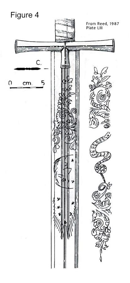

One example of this type is depicted in Reed (1987) Plate LIII. The scroll work is of a flowing design and well executed. Reed estimates that the sword was “probably German, Spanish or Italian manufacture, dating from the seventeenth or eighteenth centuries” (p. 169). His attribution suggests that Kassala smiths used an early imported blade as a model for their work shown in Figure 1 above. Also, no known native-made example of this type of sophisticated scrolling technique has yet come to light. I think it is significant that the abu Shabeish design and name persisted perhaps for centuries even without local interpretation.

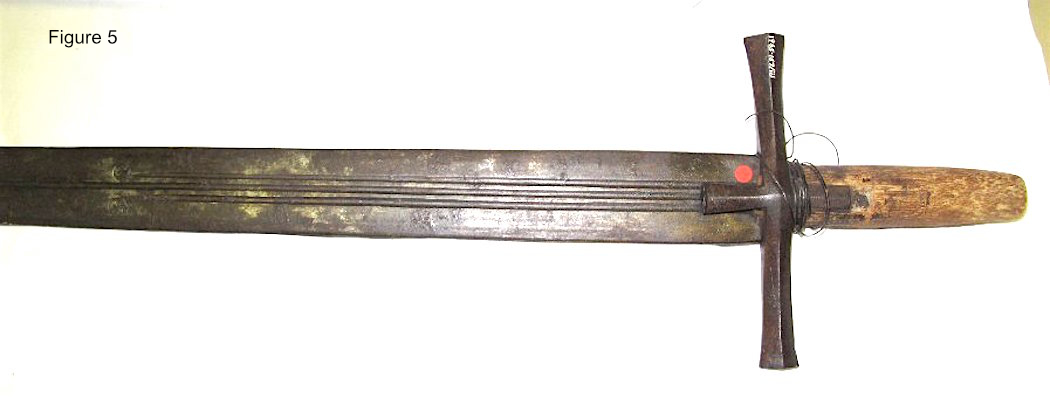

There apparently was a consolidation in the Sulimani-type fullers. A member from the Royal Dragoon Guard's Regiment Museum, RDGAC, presented a description of fullers:
It exhibits three fullers, the outer two extending a little less than 11.4in (29cm) from the cross guard, while the innermost runs some 17.25in (43cm) down the blade. To either side of this central fuller sits what appears to be a depiction of a crescent moon, but with an unusually jagged "cut" to its crescent; it may be Arabic text, or perhaps a depiction of something else entirely (sunrise over mountains?).
See Figure 5 [image posted by Katana (David)].
This depiction would fit the Solingen munitions grade trade blades with three short fullers imported during the late 19th Century and replicated by Sudanese smiths. Its reasonable to assume that as market conditions changed sword merchants ordered blades with shortened center fullers and those devoid of scroll engraving. Also, it is not clear that the extension of the central fuller beyond the forte actually has structural benefit. Thus, labor saving/pricing demands and losses in popularity may have caused the Daud, abu Shabeis and Mukhammas variations to collapse into a more basic, Sulimani form.

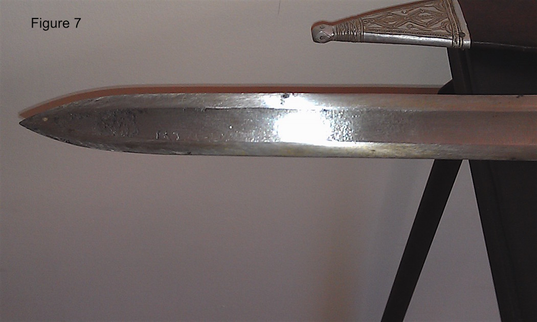

This style presents a fuller with a larger channel than the Suliman type. An informant in 1984 Kassala called it a Khar (channel) Hongoog (straw) for straw channel, “a wider line than Suliman.” The informant said that Ethiopian swords were blank (no lines), but had a mark. A contemporaneous blade smith, Fateh Hallak, made swords with a scooped-out blade called Khar (canal or channel)) for lighter weight and used the Ethiopian style mark. I have not seen one of his blades, but assume they are heavily fullered.

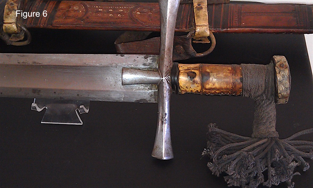

Lew had one of the few in this style that I have seen (Figures 6,7). Note the Hadendawa tassel at the top of the hilt. These blades seldom, if ever, have European makers' marks—I know of none—although others contain inscriptions.

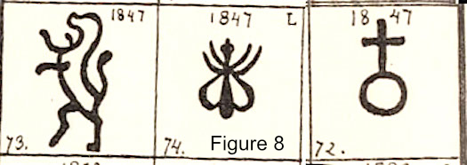

The blade has a short central groove and carries three marks known as dubbana, nugara, and 'asad.
The interpretation of this style addresses several issues we have long debated. Its name and descriptions correspond to the Solingen maker's marks for Peter Kull's Standing Cat, Orb & Cross (1830–1870, Bezdek) and Samuel Kulls' Fly (1847–1860, Bezdek) (Figure 8). The Dukkeri abu Dubban incorporates these three symbols (Cronau, 1885) and may suggest a mid-19th C origin of the type. Cronau's work, in German, can be accessed from this link: http://libmma.contentdm.oclc.org/cdm...coll4/id/29401
An example is shown in Figure 8.
Dukkeri. This may be Brigg's dukeri for crescent moon with man's face in profile. A Kassala informant said it meant “for men”. Swordsmiths there describe a sword called a duk'ri (my transliteration) and is decorated with an Orb & Cross and a Rampant Cat/Lion.
Dubbana or Duban. Fly. Likely signifies the biting fly that appears with the rains and is very harmful to camels. It's arrival prompts camel herding pastorialists to take their animals north out of its range. Dubban also means “thousands” in Hausa, maybe signifying the number of flies that swarm about. It also may indicate Hausa smiths possible role in applying this fuller type to Sudanese blades. The informant said it encourages “jumping like a fly when fighting.” (See fly symbol on Jeff D's sword, Figure 9. His sword also has a lion and orb & cross on it.)
Nugara means “drumming”. Informants used daluka for drum and (perhaps hearing the drum beat) say that it “builds courage”. The drum symbol they presented was the famous Orb & Cross. Among most northern Sudanese ethnicities the large copper kettle drum is central to their culture. According to Clark, p.13, it may only be beaten in mourning of a death in the chief's family, to summon the tribe to war, and at a festive occasion for the tribe. The tribal drum also is used in Darfur, of the Medieval Funj Kingdom, and may be universal in Northern Sudanese culture.

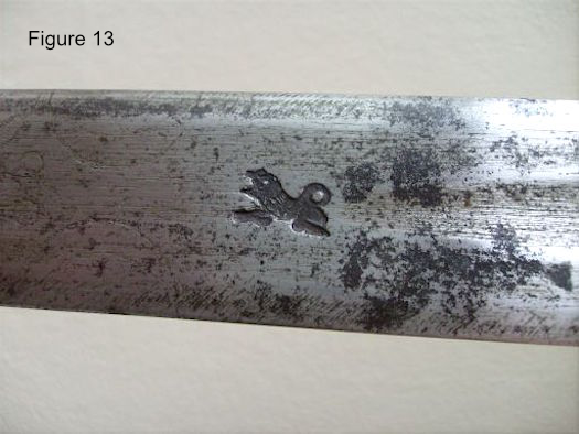

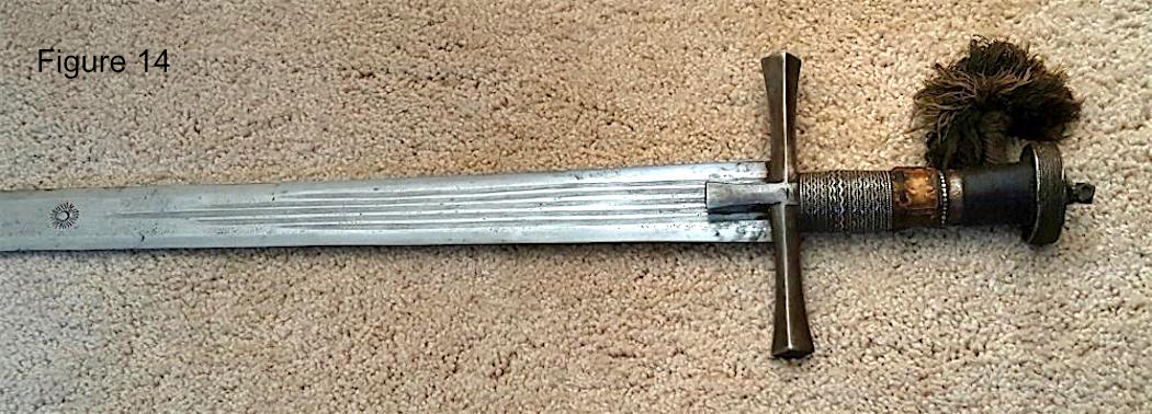

Steven Wood has a single fuller sword with a Lion mark on a single groove blade (Figure 13). It looks more European than native-made and does not resemble the Kull mark to me.
The Metropolitan Museum of Art has a kaskara (Cat. No. 1977.162.4) with a Dukkeri fuller. It is classified as late 19th C Sudanese with a late 15th–16th C Italian or South German blade. They show a Passaua wolf and a maker's mark of a seven-pointed star. If the attribution is accurate, this blade would date the fuller from a century earlier than Reed's LII.
Unfortunately, the MMA web site does not have a photo of this sword. However, it can be viewed via an illustration in an article available through JSTOR: Author(s): Helmut Nickel and Stuart W. Pyhrr, Source: Notable Acquisitions (Metropolitan Museum of Art), No. 1975/1979 (1975 - 1979), pp. 27–29.

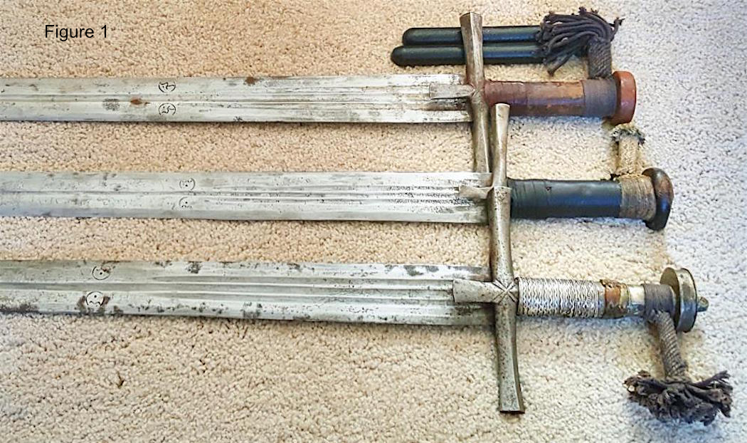

There are great relevant discussions on the following thread by Jim McDougall, Iain Norman and Chris Topping: http://www.vikingsword.com/vb/showthread.php?t=14806
Chris' first image on Post # 20 summarizes the major contemporary types, top to bottom, first three: Dukkeri, El Kar, and Sulimani (Figure 15). We also can name and better understand the range of historic types we are likely to encounter. No doubt I have probably made errors and omissions in this discussion. I would appreciate readers’ inputs and comments.

I own a Kaskara very similar to fig.1 lower sword. What I find interesting is the two indents in the blade nearest the cross guard. They are only on the one side opposite each other and remind me of blacksmiths tong marks.
The blade is fairly thin and tapers evenly in thickness. Moon faces on both sides of blade appear to be stamped in. A very narrow leather strip like a thread or thin string winds over the grip.
