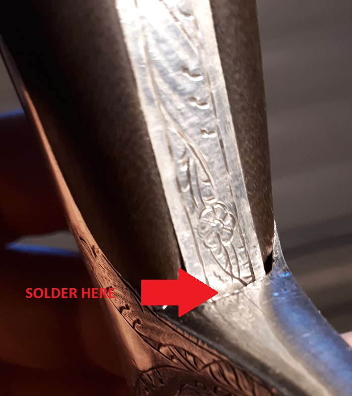

I need to re-attach a silver crossguard on a shamshir. I have decided that i want to solder it to the grip straps. I have seen it done that way on other similar swords. Fell free to speak up if you think that there is a better way.

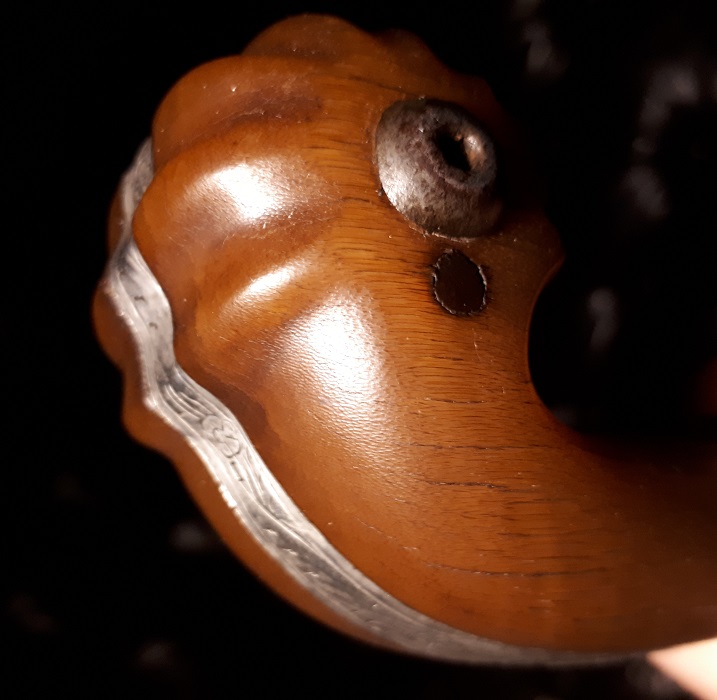

A professional golsmith that I talked to said, no problem he can do that. But, he also asked how much heat the horn can handle, since the solder will reach 800 degree celsius. I have no idea, anyone that knows or can point me to a source that has that information? Also, im like 90%, sure its rhino horn, but could you look at the pictures and confirm?
Many thanks for your time.

Was not soldered to the cross guard with any original

Rhino horn is a lump of congealed hair. Doubt it will not be damaged.
Why wouldn't you try
https://www.walmart.com/ip/6X-DEVCON...5-ML/111524404
or something from the family, such as
https://www.walmart.com/ip/10240-Pla...vcon/700864821
It is used in metal industry, holds like nothing else.

You will ruin that horn if a jeweler puts heat to it

The steel stuff will be safer... Heat will melt it like butter... It is Rhino

You can NEVER silver solder onto horn or any organic matter. Even soft solder is too hot (and is much lower in temperature).
No offense, but your jeweler friend is nuts! (I too make jewelry and so lots of silver soldering).

OK. The hilt is rhino. Heat will not MELT it, just BURN IT. I have broken bits and pieces of rhino horn from messed up Ethiopian swords, so I decided to try. If you try to burn one of your own fingernail (after you clip it.....) you will get the same result. It chars more than burns. You can scrape off the charred surface and re-polish it. This is not what one wants to do to a good piece of rhino horn. A good epoxy will do a better job. By the way, there are epoxies designed for jewellery making. Cheers, Ron

Any horn will burn. If he knows nothing at all about horn, then I guess that might be forgivable. But that would also mean that he was somewhat narrow in his scope of experience. At that type of heat, anything organic would burn.
I do apologize if I came across caustic.

Ideally I guess you would want to restore the item using historically correct methods if possible? I think I have read posts here about using traditional resins to re-attach grips etc.
You may want to check out Paraloid B-72 (http://www.conservation-resources.co...roducts_id=600) which is supposedly used by professionals at museums to restore antiques. It’s favoured as it’s less visible, degrades less, and is supposedly reversible. I have found it more difficult than expected to work with myself. I would try buying the glue tube version rather than the pellets.
