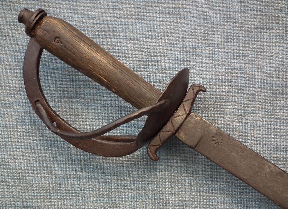

M ELEY
Location: NC, U.S.A.
Posts: 2,229
Default Spanish colonial

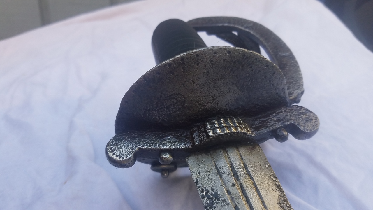

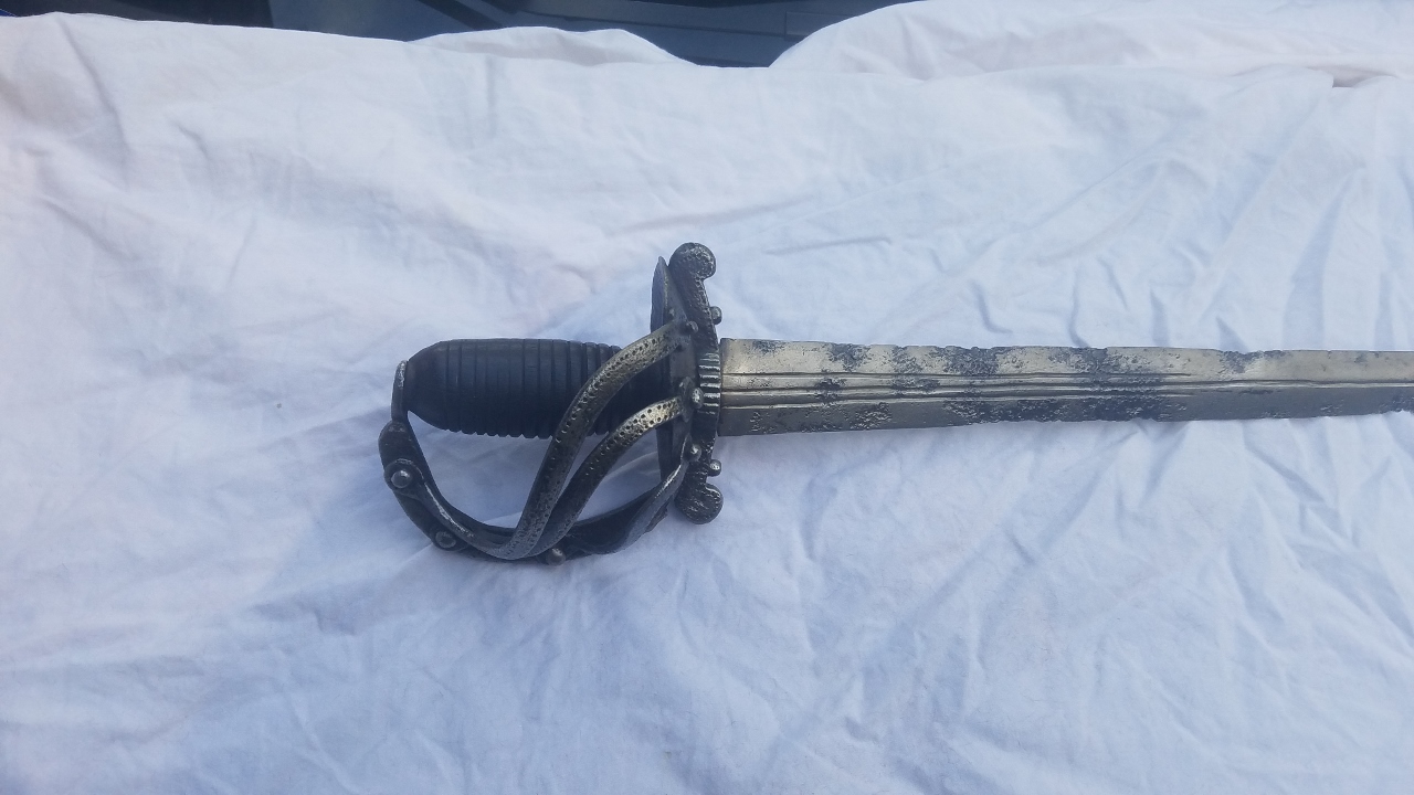

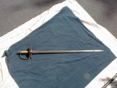

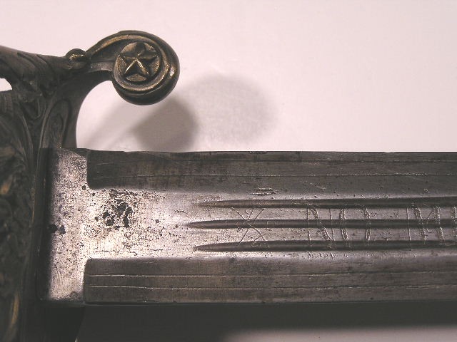

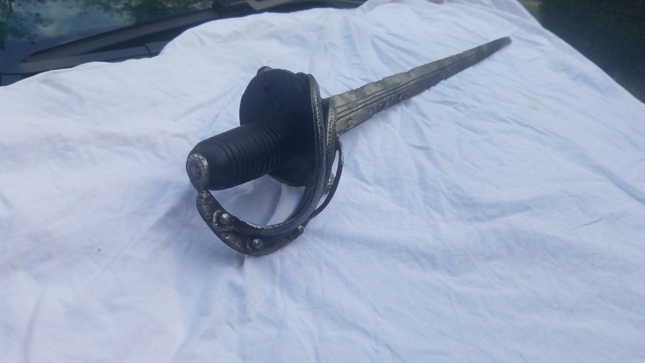

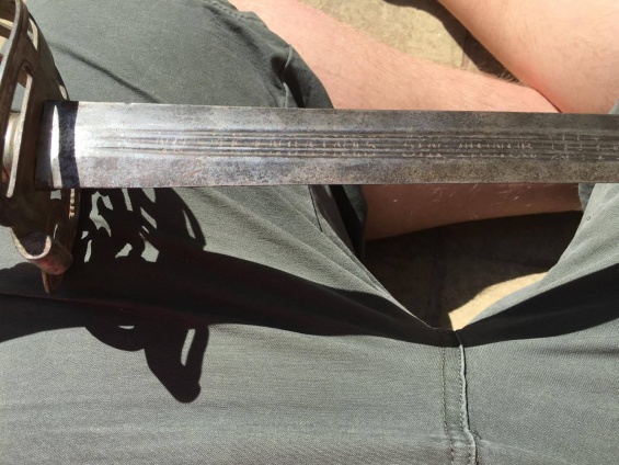

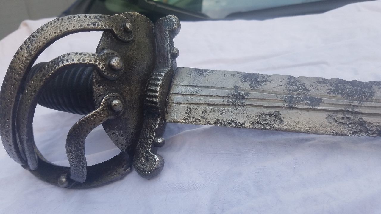

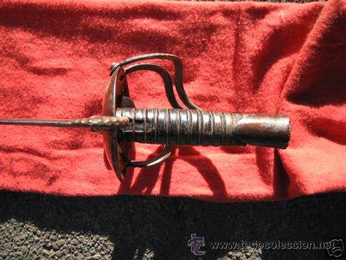

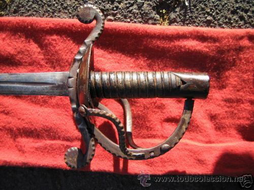

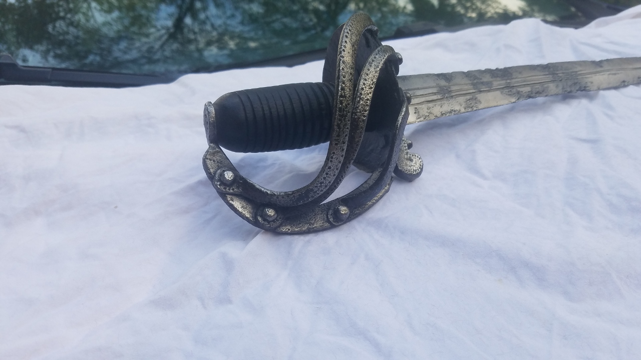

Here we have a Spanish broadsword or cutlass from the first quarter of the 19th century. This distinctive hilt form is discussed in 'Spanish Military Weapons in Colonial America:1700-1821' (Brinckerhoff & Chamberlain). See plates 174 175,176.
This form of hilt consists of a small shallow cup with a curved cross guard, flattened quillons, a three branch guard with screws or rivets securing them to the knucklebow. Grips on these colonial pieces are bone or horn, often scored and sometimes of a 'plump' swollen form such as this example.

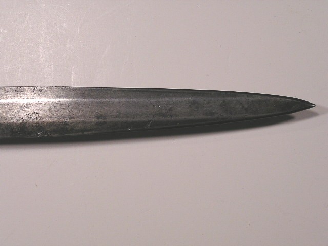

This sword stands out in that it doesn't have a curved saber blade. Instead it has a much older straight broadsword blade, probably German made with rounded tip and three line fullers. The old corrosion on the edge is a testimony to age and possibly from salt exposure.

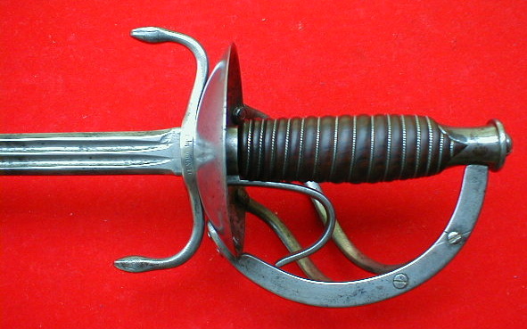

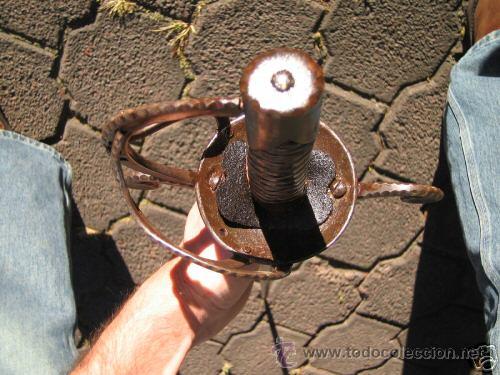

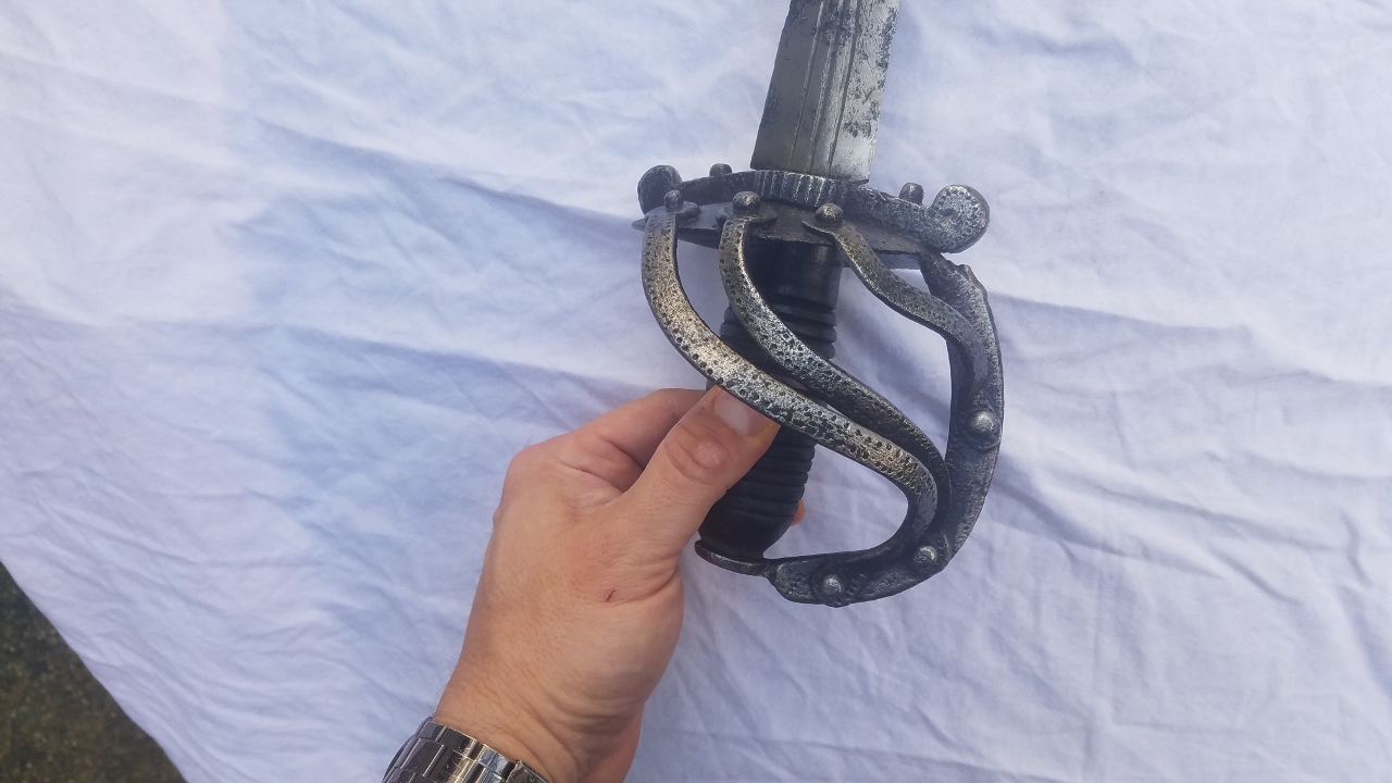

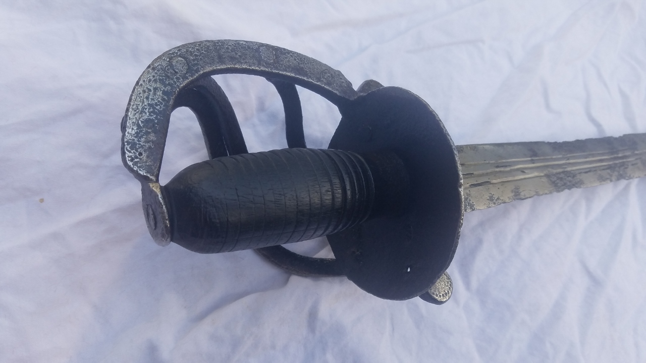

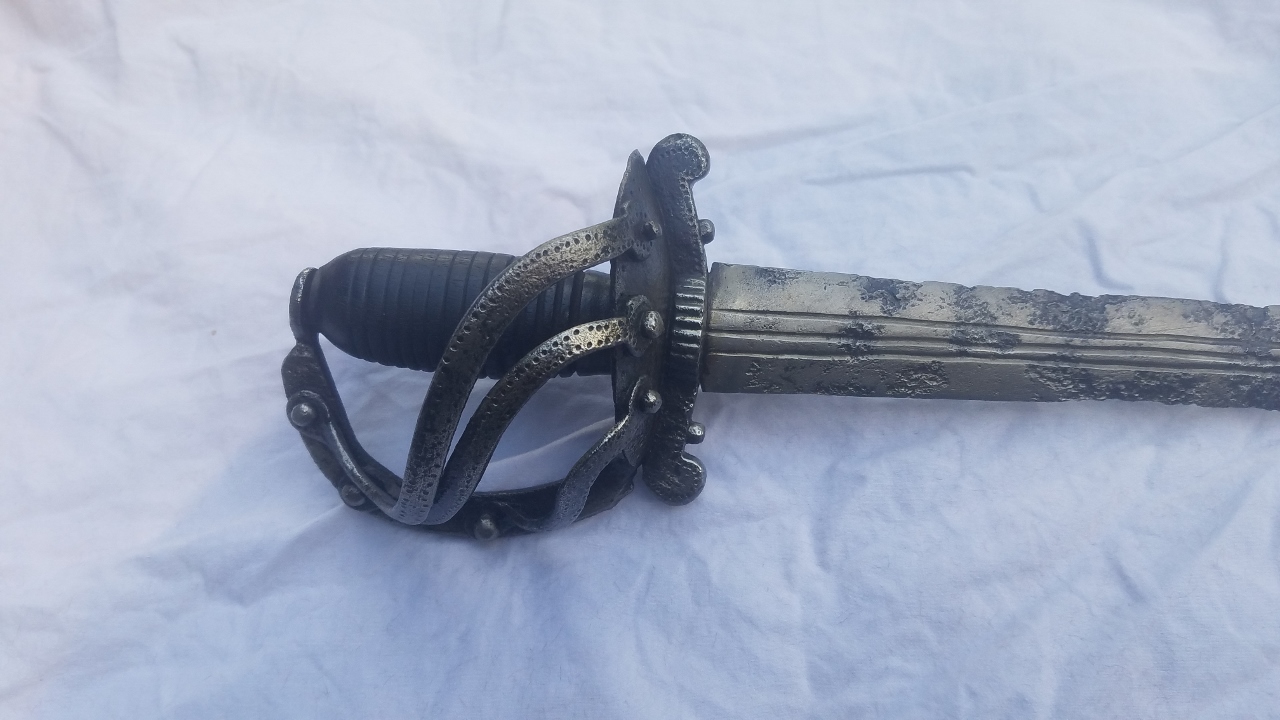

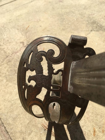

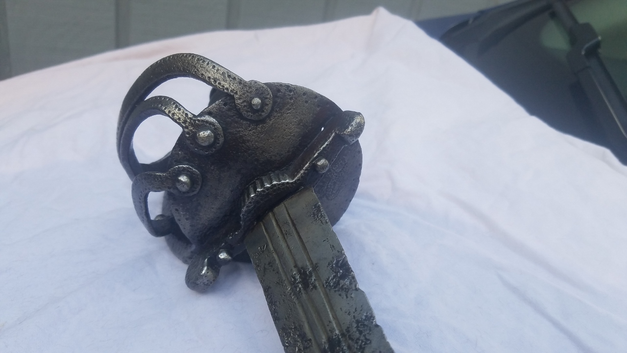

The interesting dot pattern decoration and small design on the cup ( a pic of a bird? Snake?) is commonly seen on these colonial pieces. The riveted branches of the guard always reminded me of later Mexican spurs and iron work. Note the 'fat' horn grip...

Posts: 298

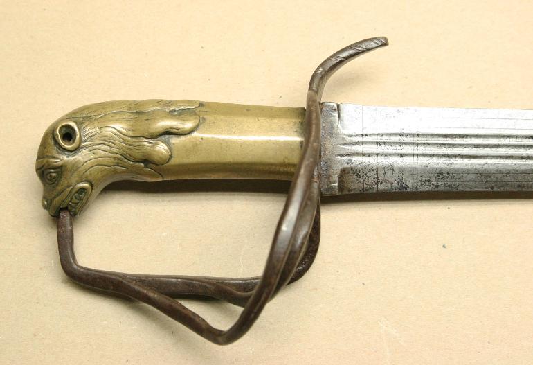

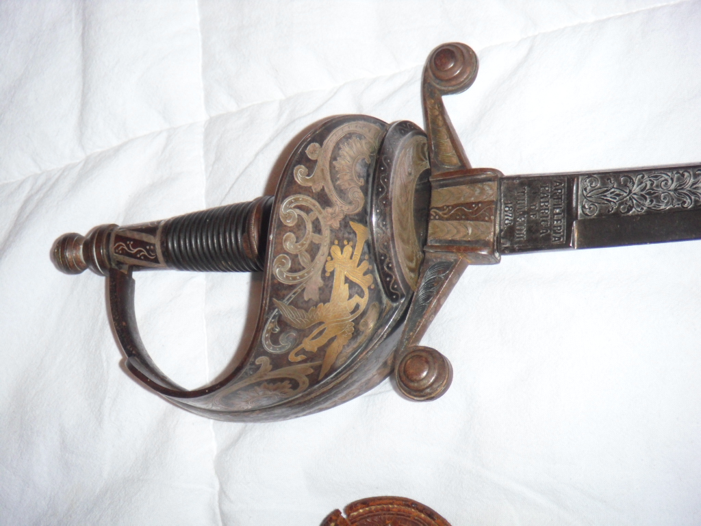

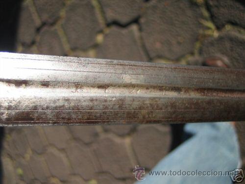

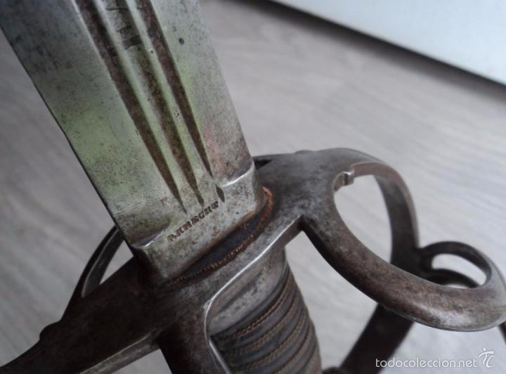

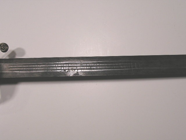

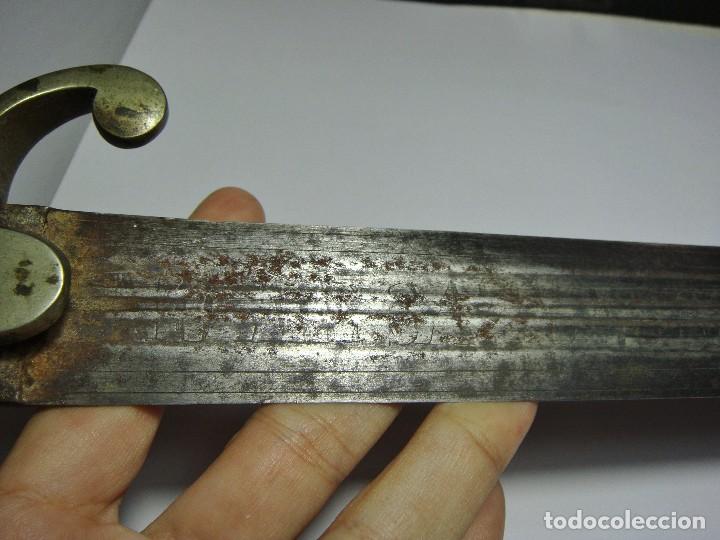

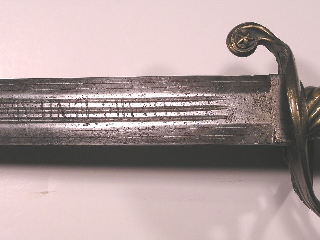

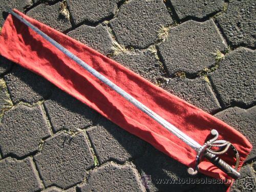

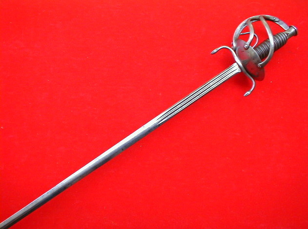

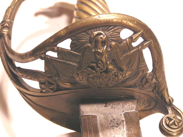

I believe these swords are rather from the 1850s. They have usually Solingen export blades from that time, made expressly for the South American market, and therefore marked as Toledo and spurious dates (made in the 1840s but dated in the 1820s).
Possibly they are contemporary of the Chinaco sabers of the rebellion against Maximilian.
This one is marked as Toledo 1827.

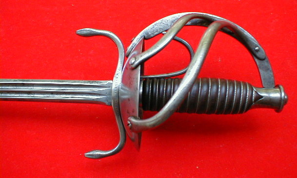

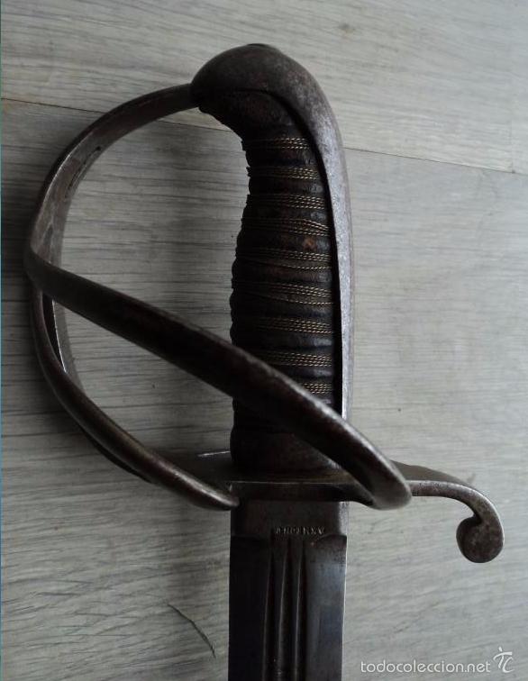

They are another step towards the Guerrilla Commander swords of Porfirio times (last picture).

Posts: 10,860
This type of Spanish colonial espada is most interesting as in form it leans more toward more traditional sword forms, but its primary curiosity is that these carry elements put together in a redundant fashion. The crossguard with its usually flattened quillons placed vestigially under the shallow cup is clearly unnecessary , but reflects Spanish adherence to tradition over practicality.
Brinckerhoff & Chamberlain (1972, p.93, plates 174-76) note that .."...the origin of this style cannot be determined precisely, but it may have evolved in the colonies".
While these interesting amalgams in style of course are more interpretive in local examples occurring outside records, regulations or precise provenance in most cases, it seems they began around the early part of the 19th c.
Adams (1985) refers to these as 'round tang espadas' but offers no further insight. I have seen reference to these guard bars as 'gavilan' it seems, having to do with sheaves of wheat.Also, I have seen later examples with this structure which were clearly worn as 'court' type swords by officials or perhaps officers in probably remote settings. Midelburgo has well noted these from latter 19th c. termed 'chinano' but that is the first I have heard of that term, or definitive note of the period.

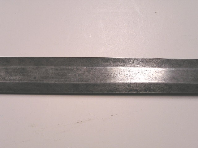

The blade is of seemingly Solingen form but unusual as most of these blades were the hexagonal section 'dragoon' type. In the times when references were written on Spanish Colonial (1972 and previous) it was typically thought that these blades were from Toledo, however research done in recent years have revealed these blades were invariably from Solingen...and the misperceptions derived from the spurious use of Spanish marks and names.
