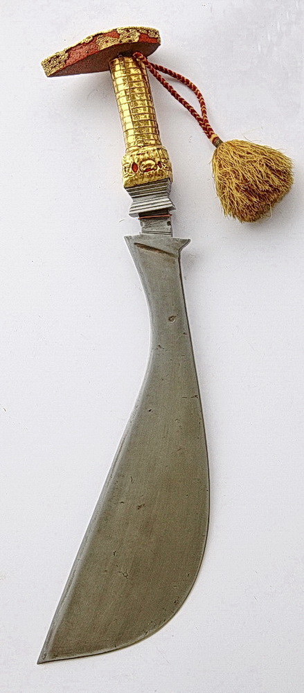

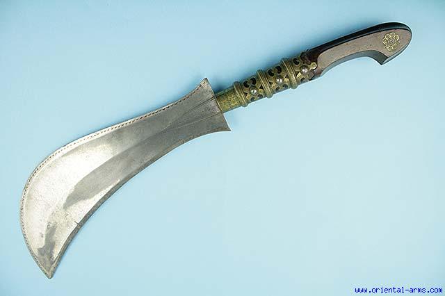

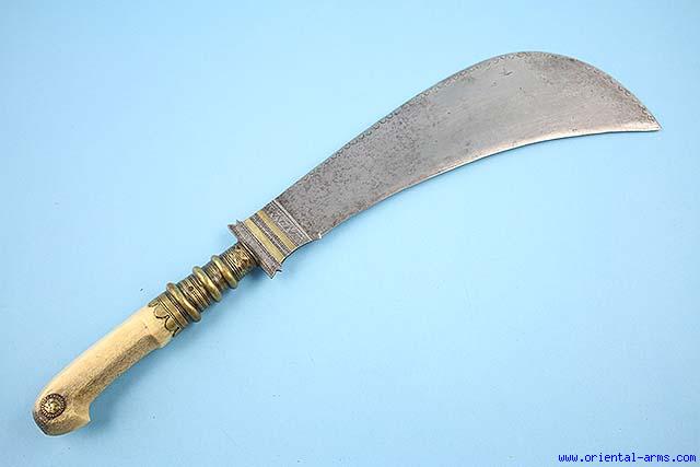

The two picture from Oriental Arms with a blue background are Moplahs.

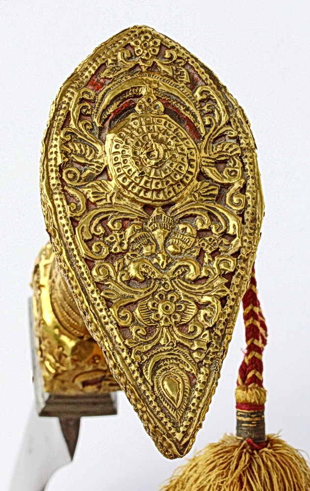

The two picture with a grey background are Aydha Katthis. Notice espacially the kite shaped pommel on the Aydha Katthis.

So the main difference is the pommel.
