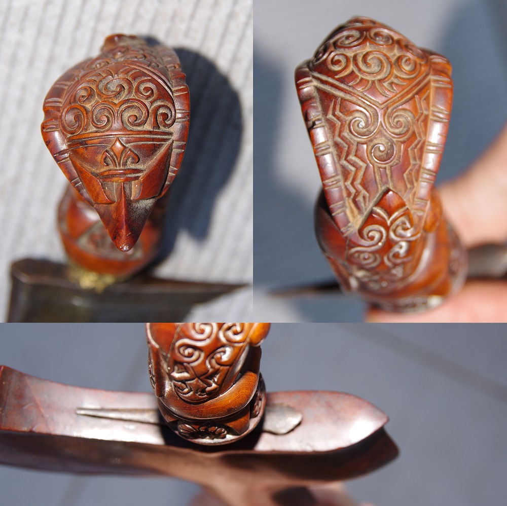

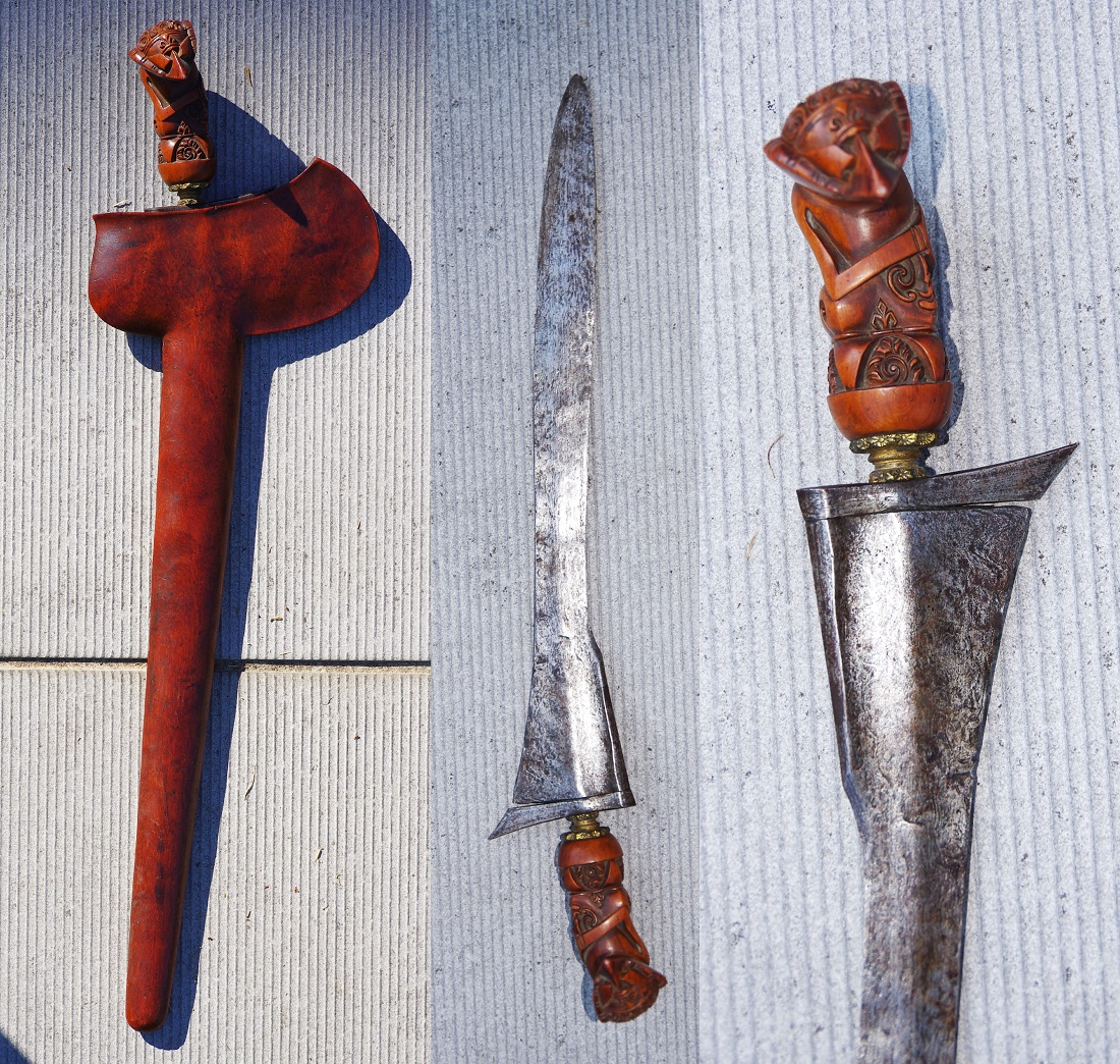

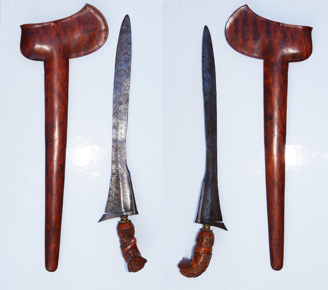

This is my last acquisition. As often, I like objects that show a bit of originality.

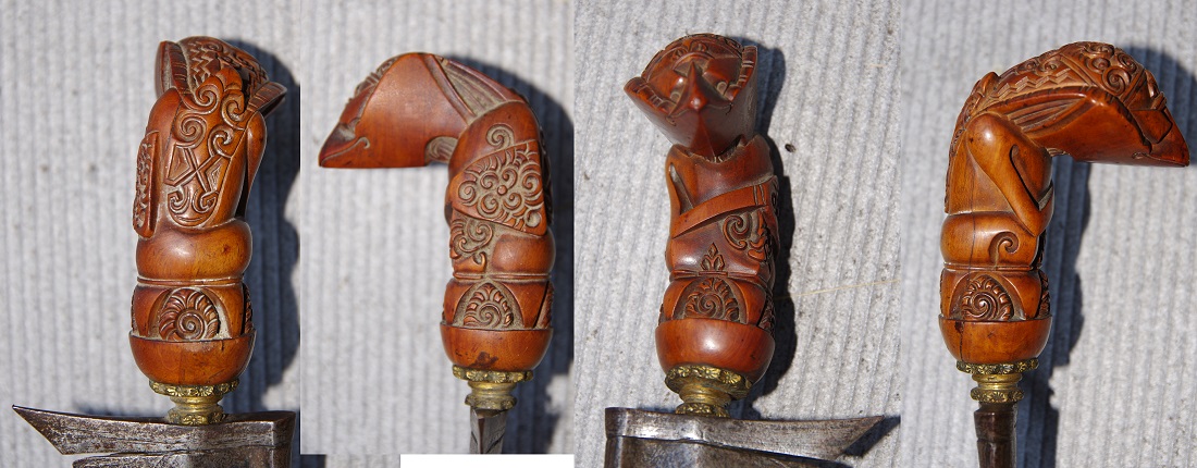

I find this keris very strange because the wrangka iras sheath is Javanese (West Java?) But the handle is rather in the style of Sumatra.
The blade looks very old and measures 32.5cm.
What do you think?

I like this keris very much.

Well, firstly i would agree with Rick that i also like this keris a lot. I'm not sure why i have always been so attracted to these kebo keris. I am the furthest thing from an agriculturalist, but i have always been fond of these elongated gandik blades for some reason.
I also love the subtle beauty of this sheath. If the color balance of your photographs is correct that red color is just marvelous and the darker marking beautiful. The sheath seems either made for specially adjusted for this blade as it seems to have a nice fit.
I like the hilt a lot as well, which has some very nice motifs that are well carved. I am not sure it is quite appropriate for the rest of this ensemble, but it is a nice hilt nonetheless.

The hilt is in Jawa demam style from Sumatra.

Might it not be a possibility that the hilt was carved in the very west of Sunda or in the very south of Sumatra?
There should be some overlap between those two areas considering the proximity.
Perhaps someone can recognize the style of the carvings to determine with a greater degree of accuracy from which region this jejeran hails.

It looks like Palembang style to me.

Hello Bjorn,
The Sundanese were very active in southern Sumatra - thus, no surprise that Sumatran pieces might have ended up there.
With keris hilts it is almost always risky to assume that any combination really is original though...
