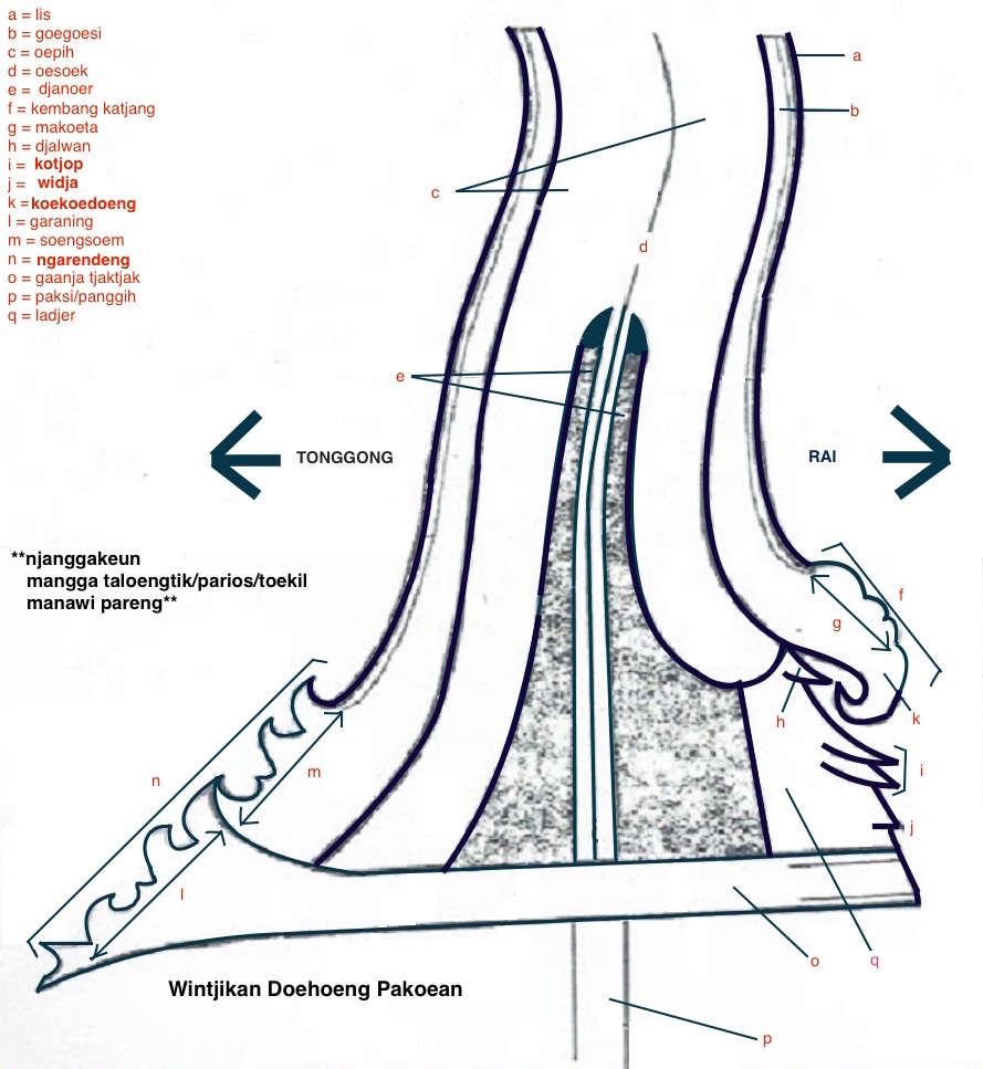

I just thought that I’d drop you the following diagram of blade details (the details are in their simple/basic forms).
Perhaps you may wish to consider it. (It may point/spur you in a particular direction.)

Amuk Murugul, the diagram with Sundanese terms is much appreciated! Did you label this yourself? I am interested to know why the author would use the Dutch / pre reform orthography.
