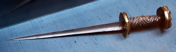

In the 12-13th century, a type of thrusting dagger known as a 'rondel (for dual discs at pommel and guard) was used by knights, with the discs securing the grip of the hand in a thrusting stab. It would seem that the later 'eared' dagger with slightly canted discs on either side of the pommel was intended to secure the thumb over the pommel in again, a thrusting stab.

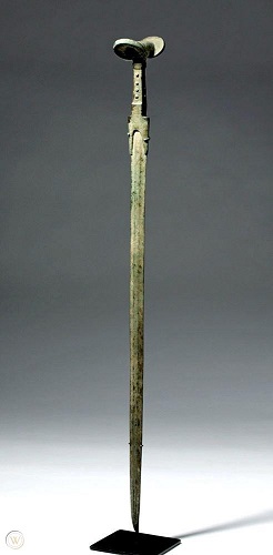

Upper left images : Persian dagger c. 1000BC assoc. with the 'Luristan' eared form. This is termed 'bearded' .

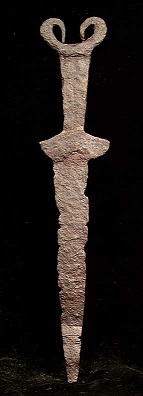

3: the Scythian 'akinakes' (forms varied) with paired scrolls.

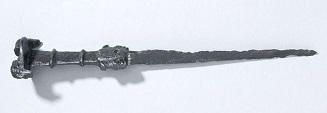

4: The 'rondel' dagger

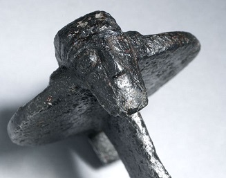

5: the European eared dagger

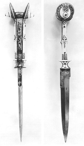

6: same

Attached image of the 'eared' form of these Bronze Age daggers with the paired discs.
While bronze daggers from regions in S.Azerbijian, Talish, Dailaman, Geoy Tepe, Hasanlu have been found in graves and finds they are not all of this form. There seem to have been varying hilts, but these discoid or 'ear' shaped pommels are most notable.
It is suggested they may have been status oriented or votive and have to do with religious situations (one was found in the Caspian Sea and thought to perhaps have been thrown in). There are scenes of gods of the Hittite pantheon c. 1300 BCE with daggers and similar hilts according to one reference.
In another case a miniature of one of these with paired disc pommel is noted as 'votive' further suggesting that attribution.
