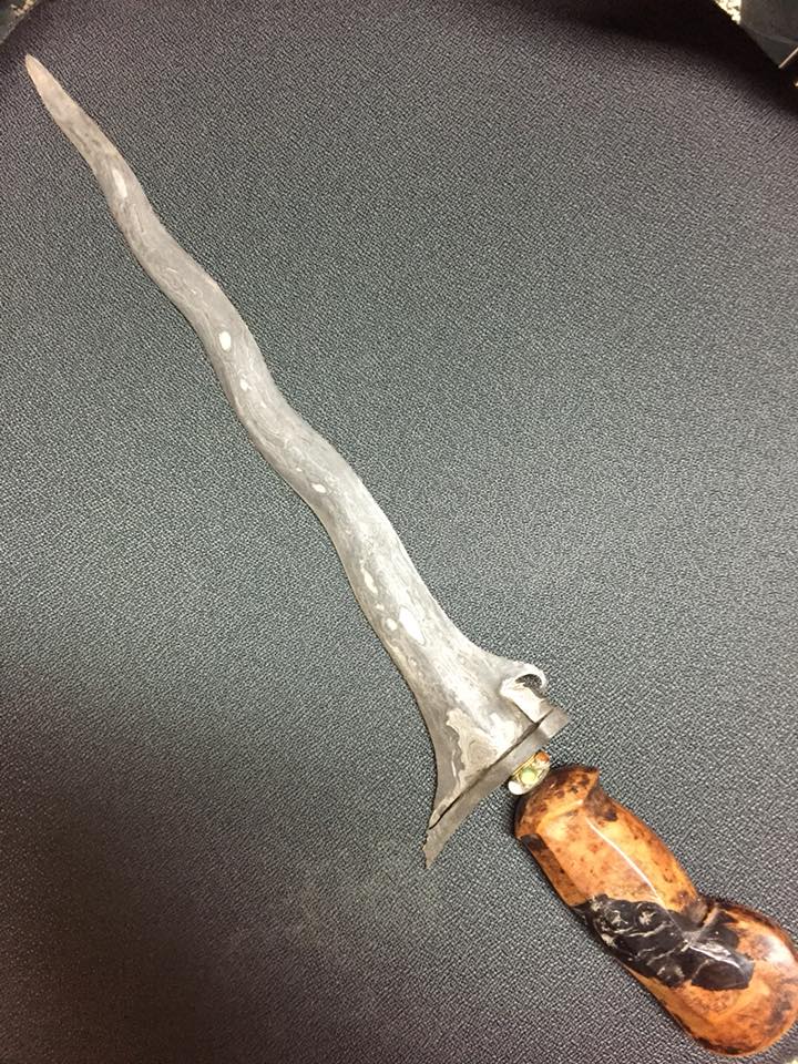

Hi

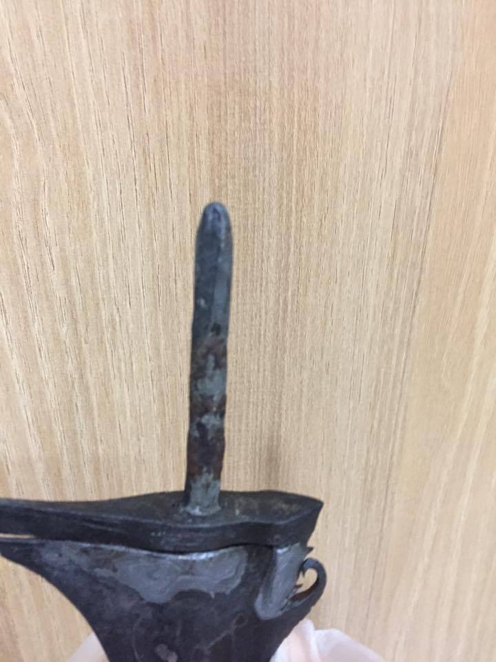

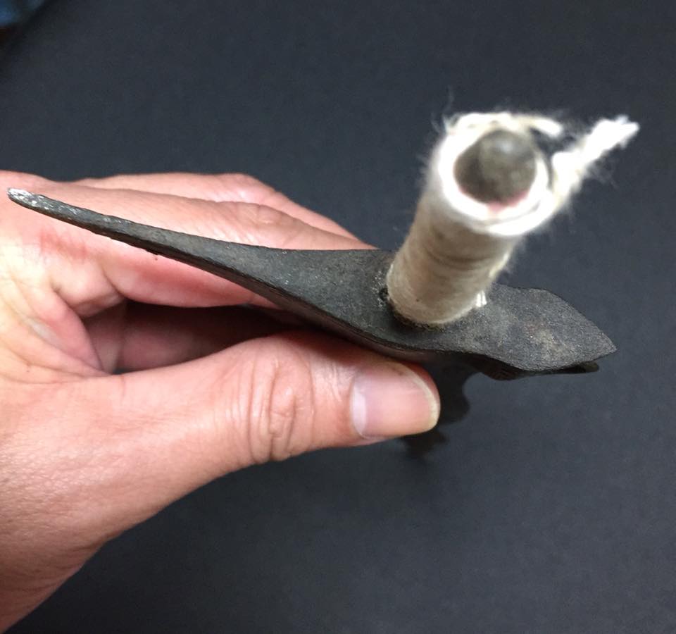

Do you think this is a Majapahit keris? Many folks told me it is so but I have doubt as the pesi is thick. Anyone knows how does the pesi of Majapahit keris looks like? I cannot much convincing info on the net.

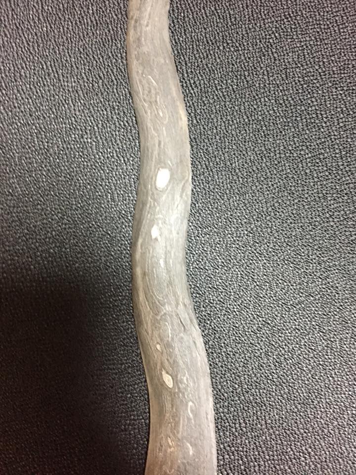

In addition, can you tell what kind of pamour? It is quite 'washed out' for identification.

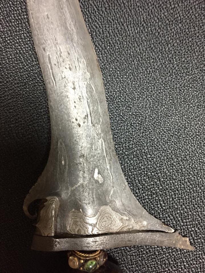

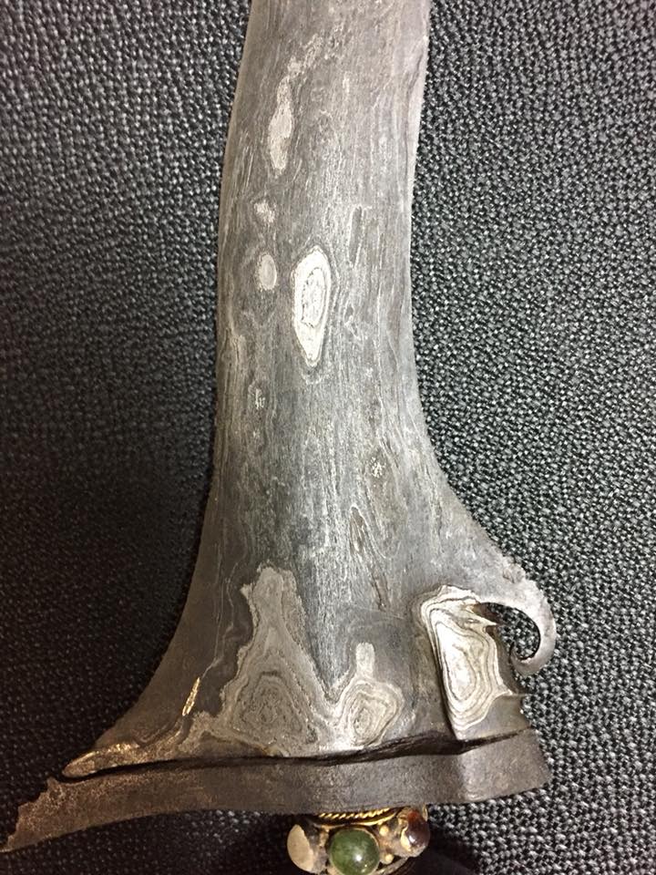

Hello Anthony,
May we know why your friends believe that this is a Majapahit kris? From the pics the ganja wulung seems to have been replaced and the tip is broken.
What is the size of the blade?

Hello Anthony,
The pamor pattern is too worn-out to be properly identified and your pics of the full blade are not very clear; some people would call it Pulo Tirto (islands in the ocean) but it was probably Beras Wutah originally from what I can see. Was the pesi damaged and repaired at mid-length? The kembang kacang is bungkem (touching the gandik) which is a peculiar feature.
The dapur type is Sempana bungkem but with one exception: it should not include greneng (the ganja was replaced).
I would love to know the answer to this as well. If you are going to give such an assessment on a blade that assessment should be defendable with good reason. Does the blade show specific indicators that would allow us to place it as a Mojopahit blade. To my eye it seems to fail on a few key points. If the gonjo has been replaced we can't tell much there, but that very pronounced pesi is the first red flag for me. Also, as Jean has pointed out, i am not sure i have ever seen a kembang kacang that is bungkem in a Mojo keris before. These days folks with very little real background just want to place any old blade in the Mojopahit category. It's a great selling point if you can convince your buying it is true.

Actually Anthony, this is a very difficult question, and any answer to it could argued ad infinitum.
However, your response to my question is simple and straightforward, as is my response to you:-
absolutely, definitely not.
