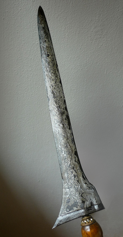

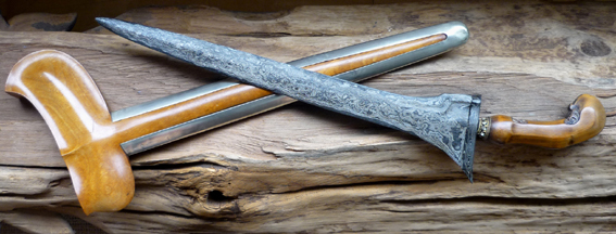

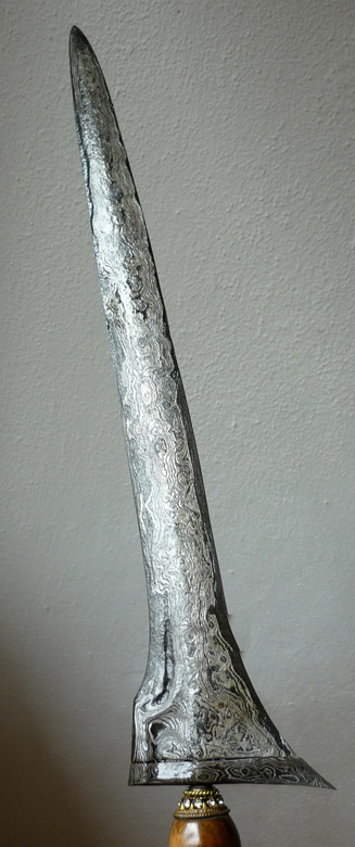

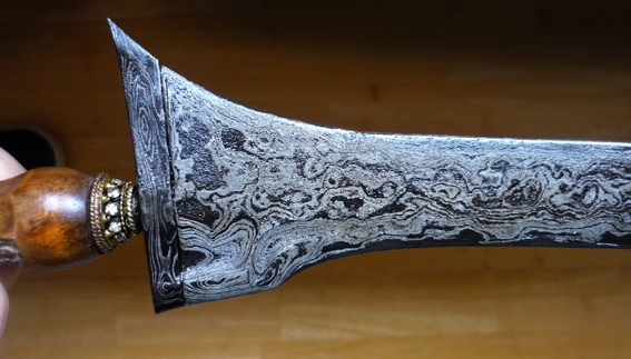

Here is a recent purchase of a keris from Solo.
The blade is strikingly wide with fine Pedaringan Kebak pamor and interesting pamor at ganja sides.
This could be a Tuban blade from Pajajaran era?
Gandar iras dress (it may look pretty young but it isn't) Cendana kayu?
Anybody interested to chime in?

I like the blade. It's sturdy and shows character.

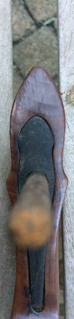

If possible, post a photo of the top of the gonjo (like shown on the below illustration). Tuban blades have a very specific style of gonjo, so such a photo could help in identifying if the blade has a Tuban style (which is not to say it would originate from the Tuban era).

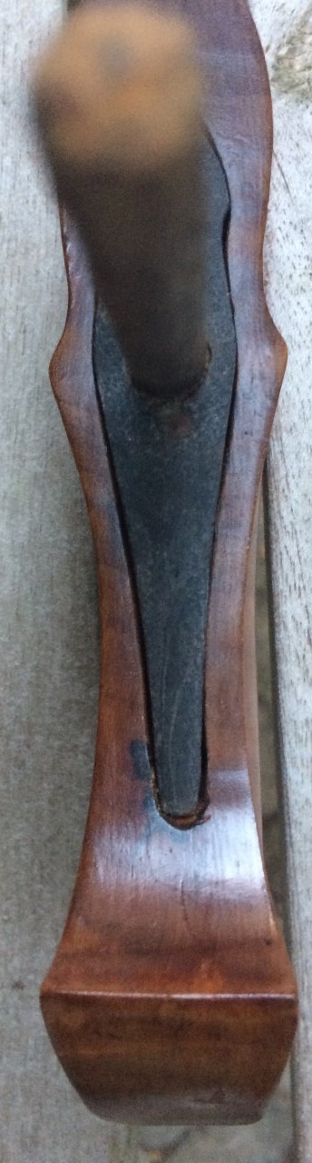

Here is a pic and it looks quite the same to me.

Paul, I'm afraid you've read too much into the illustration I provided. The illustration I added was only to show from what angle to take the photo, it does not show a Tuban gonjo.
As your photo is taken from an angle, it is difficult to see, but from what I can glance I'd say the gonjo is not Tuban.
In this thread you can read more about what a Tuban gonjo looks like.

Maybe it isn't the original ganja.

Based upon what I believe I can see in the photos, the gonjo might be a replacement, I cannot tell from the photo, and the blade classification is moving towards Tuban, but I would hesitate to give it as Tuban.
However, this brings us back to a continual problem with the Tangguh system of classification:- if it is not Tuban, what is it?
Is it in fact classifiable at all?
Well, I think it probably is classifiable but I'd need it in my hand to give any opinion, and that opinion would be based upon a balance of the indicators.
But is it Tuban Pajajaran?
No, sorry we cannot go there. As with just about all tangguhs, there are definite indicators that you can home in on as soon as you look at a blade, and then you try to confirm or discard those indicators by putting the other indicators on one side or the other of the balance.
In Tuban Pajajaran the lower gonjo tail below the buntut urang,that is, the area where we would look for a tungkakan if there was one, declines as it joins the wadidang. On Paul's keris the gonjo is straight, thus it cannot be classified as Tuban Pajajaran.
There are multiple other indicators that would need to be assessed in the hand, but that single "tungkakan" indicator disallows Tuban Pajajaran.
If we classify a blade as Tuban-Pajajaran, that does not necessarily mean that it originated in the Pajajaran era. The Pajajaran era ended in 1579.
The pamor at the gonjo sides is simply a random pamor that has had its appearance altered by forging to elongate the pattern, the wrongko is probably Cendana Jawa, that is unscented sandalwood.The jejeran is less than good,as also is the mendak, in fact these two items spoil the entire ensemble, which is actually pretty nice.

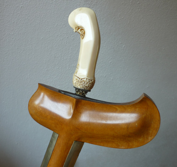

Thanks Alan for your insight and I have replaced both mendak and handle as I fully agree these are 'disturbing' elements.
The ivory handle has an integrated selut that is a decoratively carved bases. Quite unusual.

Very nice Paul, very nice indeed, but if you have one, I'd change that very nice ivory hilt for a dark wood hilt, possibly a yudowinatan?
It is deemed to be good taste to have a hilt that is darker than the wrongko.
Really as it is now it looks wonderful, its just that the darker hilt is more in line with conformity.

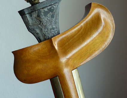

Rick, I'm talking top level kraton taste. The elite in the Surakarta Kraton tend towards restraint. Its a case of "less is more". Rolls Royce type class, where you do it rather plain but top quality X 200%.
One of the established standards for top class dress combination is that the hilt should be at least a little bit darker than the atasan of the wrongko. Yeah, at night-time functions you'll see the diamond seluts come out, and sometimes diamonds on the pendok. But plain high quality is more or less the benchmark of good taste.
So just where does a brand new, dead white ivory jejeran belong? Frankly, I cannot see it in a kraton setting. Maybe in a non-kraton setting, plenty of opportunity there I guess. I've got several planar hilts in ivory, only one is new and white, that is mated to a wrongko that is also dead white.
This wrongko of Paul's is a real classic, nice old mamas pendok, its a terusan, or iras gandar, should this sort of wrongko be mated to new ivory hilt that has been made as a display piece? I think not. I'd like to see it with a good, old tayuman yudowinatan.
There is no doubt that this keris looks nice as it is, but it is a classic, in my opinion it would look better presented as a classic. In a kraton setting I cannot imagine who might be able to wear it the way it is.

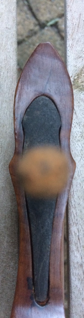

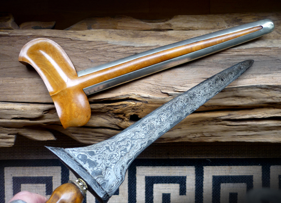

Any clue why there is a kind of kendit in the scabbard depicted below? It is not a scratch.

The "kendit" is possibly because the carving needed to go close to the skin of the ivory.

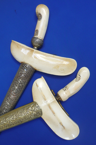

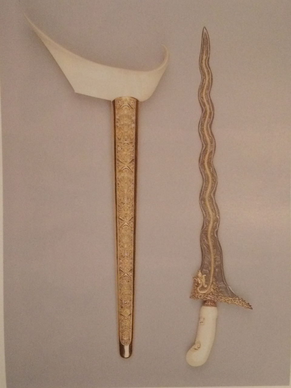

On the topic of ivory dress, I happened to come across the below ensemble in a book I was browsing through.
According to the caption it was a gift from Hamengkubuwono VIII to Queen Wilhelmina in 1923.
No doubt this piece was meant for display only, as there would have been absolutely no occasion for this keris to be worn in any setting.

What we are looking at here Bjorn has not the smallest thing to do with the keris as an item of dress.
Javanese people, commoners as well as kings, were and are in the habit of gifting a keris to a person with whom they desire to form a strong bond. The gift of a keris forms that bond and encapsulates the binding power of the Naga Basuki (Vasuki).
I guess that Queen Wilhelmina might not have been aware of the implications from a Javanese point of view when she accepted the gift.
The pendok is reversed? What a shame for a royal kris!
Yes

Alan, I very much doubt that any of the Dutch sovereigns who were gifted a keris had any real understanding of either the keris or Javanese culture.
Jean and Marco, the above seems to apply to the caretakers of the keris as well!

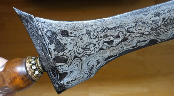

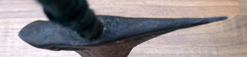

Hello all,
Would the below be considered to be a type of Tuban gonjo?

Posts: 7,255
"--- a type of ---"?
yes, very probably.

I actually only just realized I have a blade that may well have a type of Tuban gonjo, and I deliberately wrote "a type of" as there seem to be numerous sub-classifications, and I don't believe I'm aware of all of them.
Tuban-Pajajaran and Tuban-Mataram are the two I've seen bandied about.
I don't think my blade qualifies as either as the gonjo is straight and the blumbangan is not Mataram.
