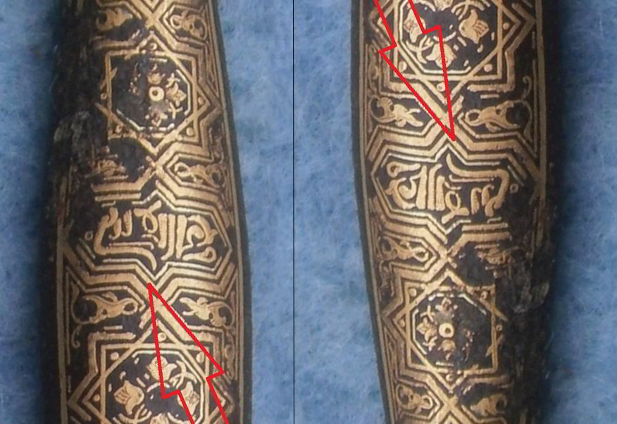

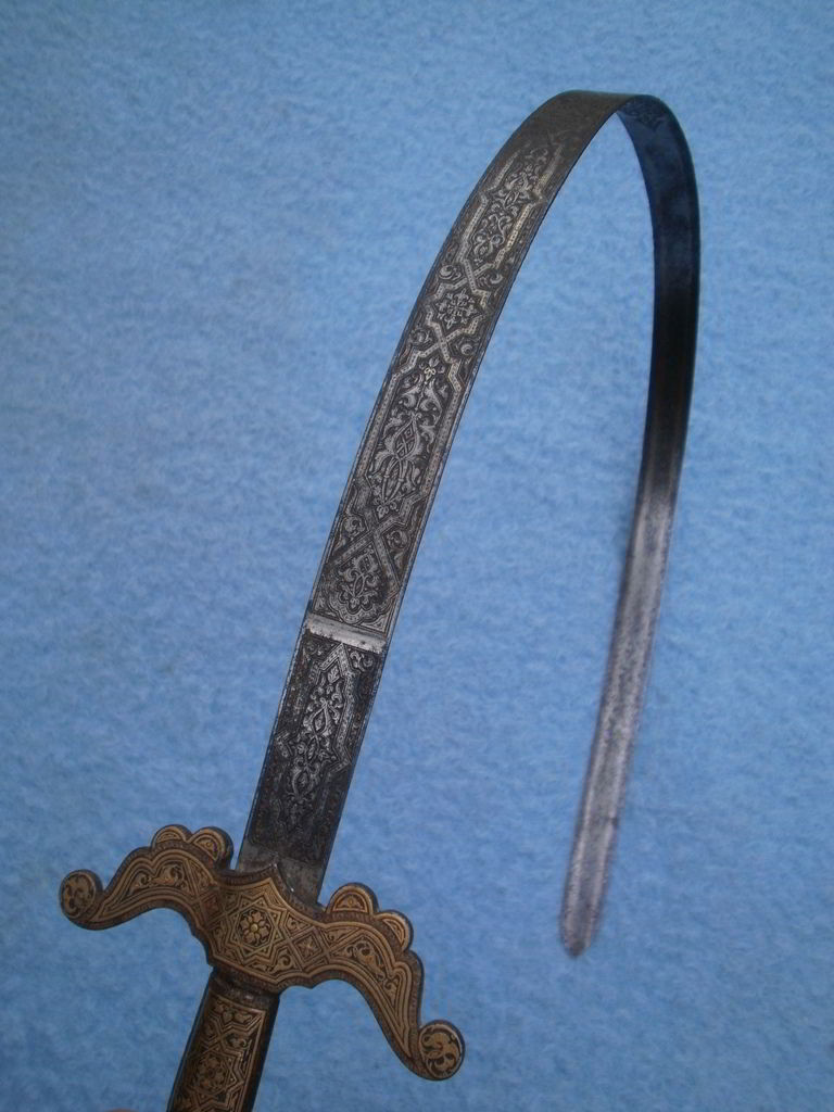

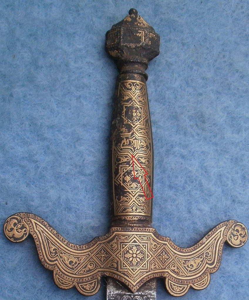

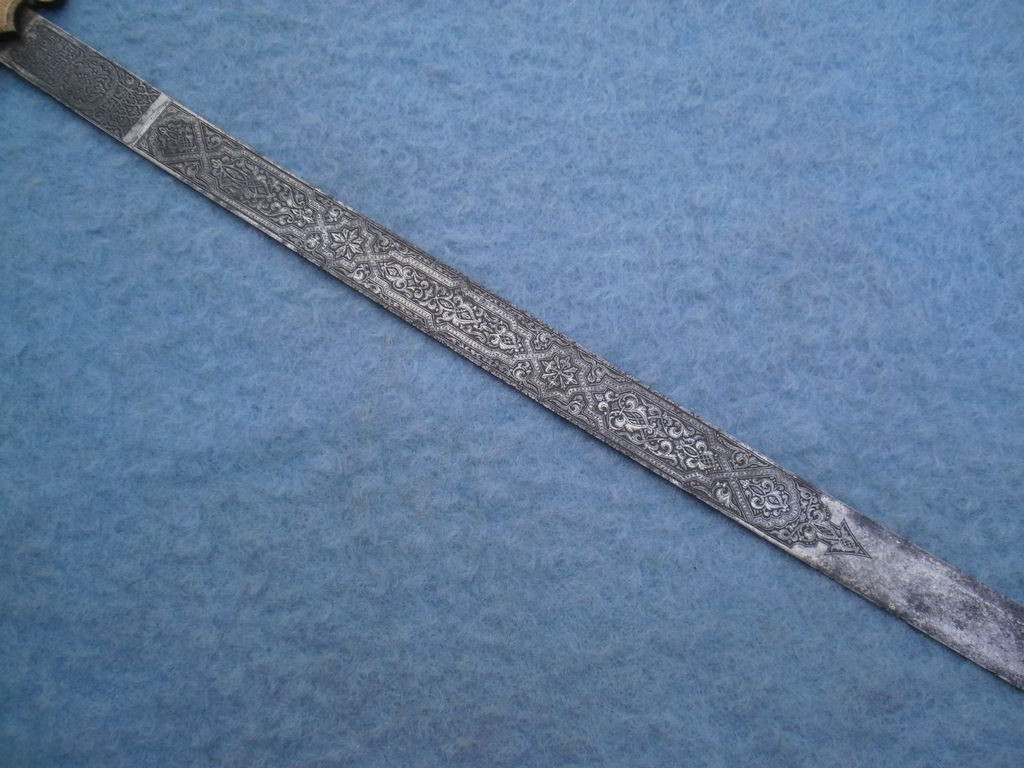

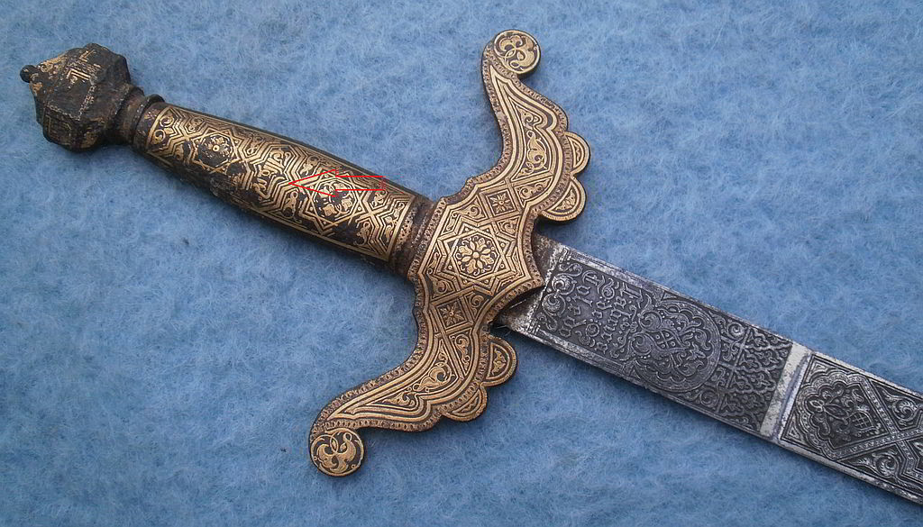

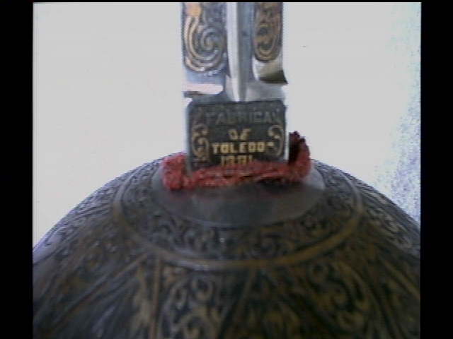

Saw this on a toledo made sword from around the mid 19c. appears to be arabic in a cartouche on the grip. can anyone tell what it says? I'm not sure which way is up, I do not recognise if the writing is actually arabic or the artisan's impression. blade is quite flexible and razor sharp. appears to be real gold inlays.

Can you please show us the whole sword?

It's not Arabic

Siamese? Tibetan? Bhutan?
Old 8th March 2018, 11:50 AM   #5
I think it's mock/ersatz arabic, for decorative purposes by someone illiterate in arabic calligraphy.

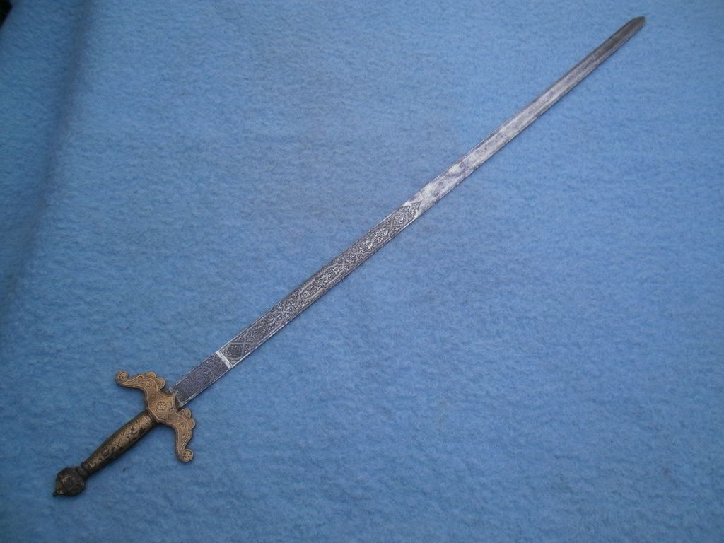

Old 8th March 2018, 12:16 PM   #6
Marius
Attached note the reinforced forte/ricasso area.
Old 8th March 2018, 12:31 PM   #7

The work in handle is typical from Toledo and is known as Damasquinado. I think this piece could be from 1920 more or leas. Is a beatiful sword. The Fábrica de Toledo made some copies of swords from different ages.
I love this sword! If some day you want send me ...😀😀
Carlos
What a beautiful sword! These Arabesques are among the best I ever saw!
I tend to date the sword back to the 19th ct..
Roland
Old 8th March 2018, 06:23 PM   #10
mariusgmioc
mariusgmioc's Avatar
Join Date: Sep 2014
Location: Austria
Posts: 1,918
Beautiful it is but unfortunately it is just a purely decorative piece not even a reproduction of a hystorical sword... at least none I can recognize.

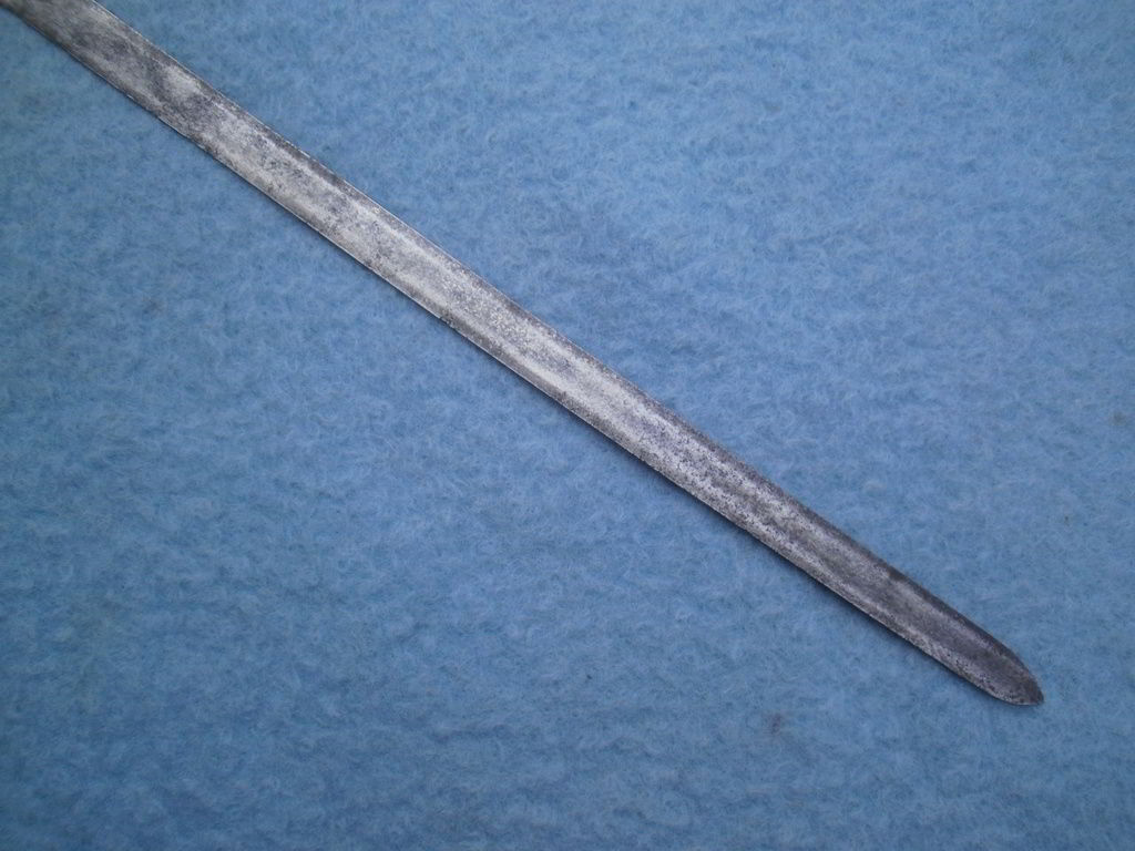

My first thought was an artificially aged copy. Then the blade bending -
Old 9th March 2018, 09:33 AM   #12
Originally Posted by Battara
... My first thought was an artificially aged copy...
Mine as well.
... Then the blade bending -
More of an Indian trick, right ?

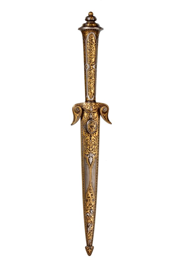

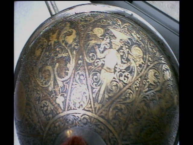

These were from the 1870s to 1880s. There was a workshop at the Toledo Factory working with silver and gold inlays. The main artisan was Zuloaga, a brother to the famous painter, although I think he was more often at Eibar.
There is another piece from this workshop in this thread:
http://www.vikingsword.com/vb/showthread.php?t=21551
Often they are idealized weapons with a now absurd romantic or oriental-like aspect.
There is a book on this:
https://www.khalilicollections.org/p...li-collection/

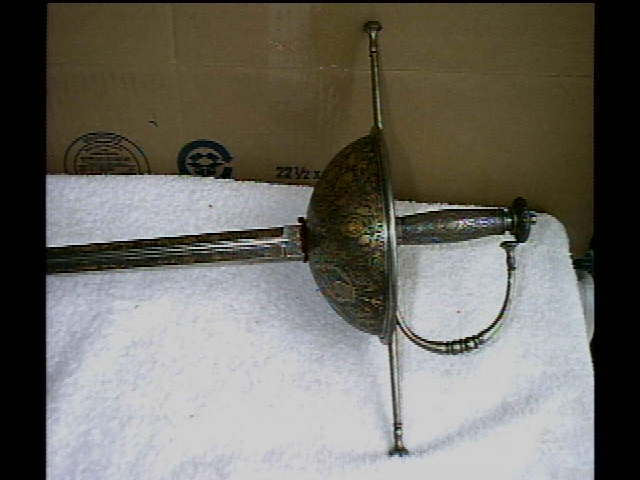

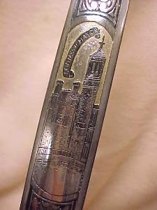

I have myself a cup hilt rapier dated 1881. I do not think from Zuloagas himself. The piece is hopeless as a weapon, too heavy, wrong balance, too stiff, too long (1.25m plus). It has three different gold tones (out of reach now). Main gauches are often seen in this style.

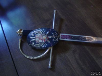

The horrors you can see in Toledo tourist pieces, mainly from the 1950s to 1970s are trying to imitate with acid etching and red and gold paint the old workshop. Last two pictures.

Since the thread was started the sword has gone back to Spain to be restored by its new owner who works for that Toledo works as his father and his father also did as a damascener, he confirmed it's provenance. He suspects his family likely did the original work back then. He is happy to have recovered a bit of his family's past.
