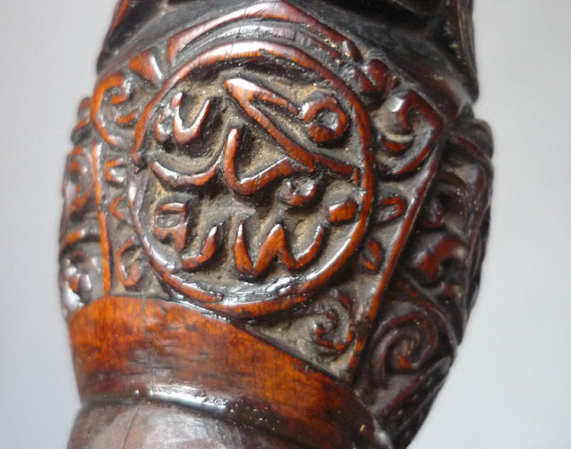

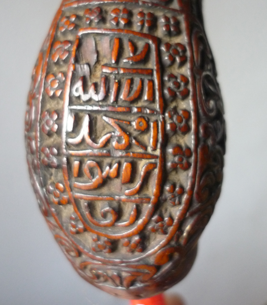

Is there anybody who can help me translate this script?
On back of the base ( one character missing) and breast part there is a Quran verse texting? Handle probably coming from Celebes.

Posts: 328
It is Islamic profession of faith "Laillahaillallah Muhammadurrasulullah"... there is no god but Allah and Muhammad is the prophet of Allah

Posts: 205
Thanks! So that's the script on the back and what about the one in the circle?
I thought there was a date involved starting with 19...

Posts: 328
The one in the circle is Muhammad on top and rasullullah in a rather abbreviated jumbled up arrangement... muhammad rasullullah...

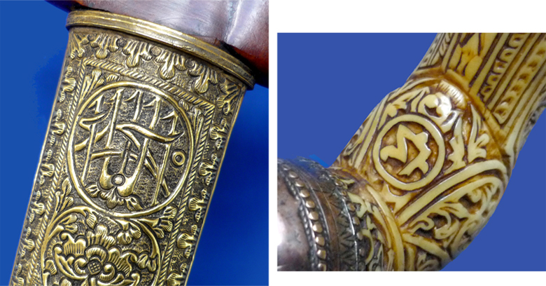

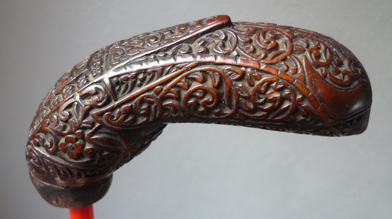

Thanks! Could you solve these signs as well Mr. Green?
Three more with a 'simple' script.
One Celebes ivory handle.
One gilded Bugis pendok.
One wooden Madura handle.

Old 20th March 2018, 03:53 PM   #6
Green
Green's Avatar
Join Date: Apr 2015
Location: Malaysia
Posts: 328
The one on the pendok is a calligraphy of Allah and muhammad written inside it
the one on ivory handle is muhammad (in upside down position)
the one on madura handle I can not make it... will try to get arabic speaking people to decipher it..
Old 20th March 2018, 04:08 PM   #7
Paul B.
Paul B.'s Avatar
Join Date: Nov 2017
Posts: 205
Thank you and I would be delighted to find out the last one. The script is very well cut so hope there is anyone who can decipher it.

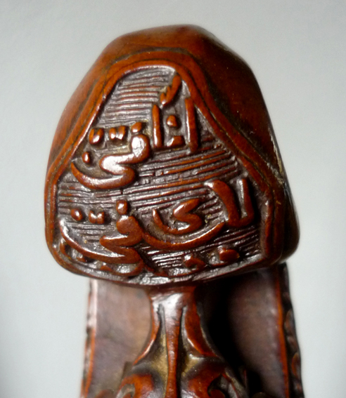

Old 20th March 2018, 06:38 PM   #8
Green
Green's Avatar
Join Date: Apr 2015
Location: Malaysia
Posts: 328
You're in luck..
Just got the translation from one arabic speaker..
the madurese one according to him is as follows: (loosely translated)
An Nafiy = The one who gives benefits
Al Kafiy = the one who complete your needs

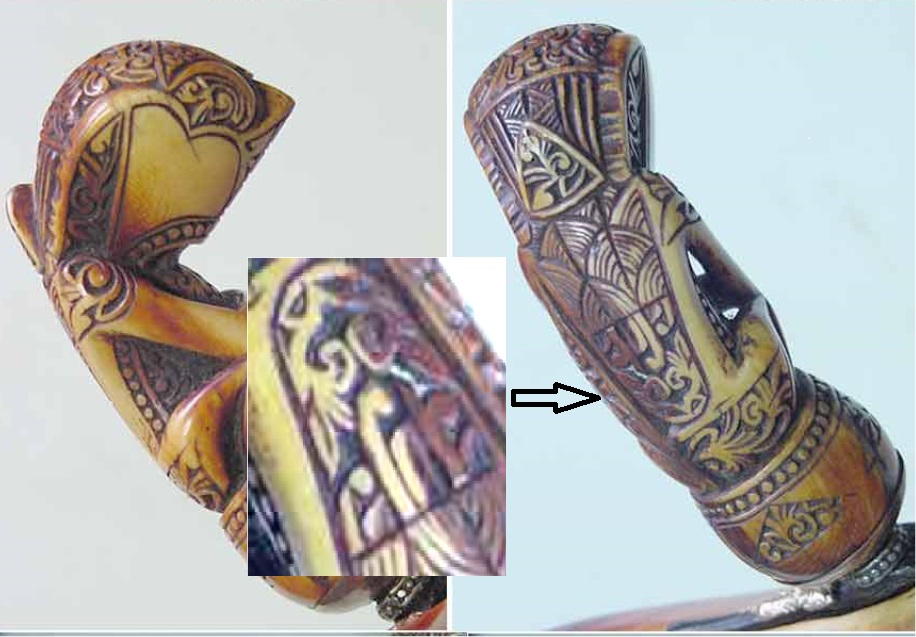

Dear collectors,
Can you help me translate what appears to look like Arabic script on an ivory Minangkabau keris handle?

looks like 'Allah' in arabic script

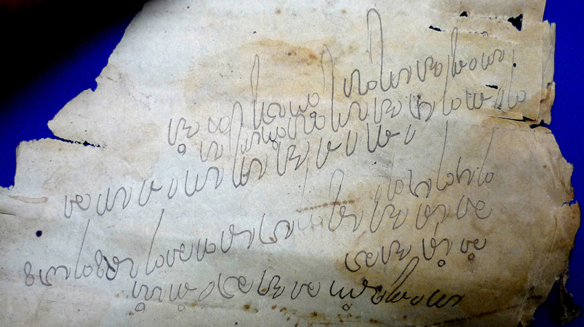

To add on to Green's translation / transliteration of the first handle, it is the Shahada as he has said, but it is truncated. Instead of "...Muhammad ar-rasoolallah" (Muhammad is the Prophet of Allah) it is shortened to just "Muhammad ar-rasoolu" (.. is The Prophet).
I don't recognise what's on the Celebes ivory handle. It kinda looks like Sanskrit, or a script derived from it.
I also don't recognise the last photo as any script at all.

Personally, even if I cannot translate Arab language, I have doubts about the scipt of Alexis handle.

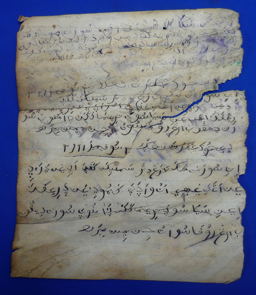

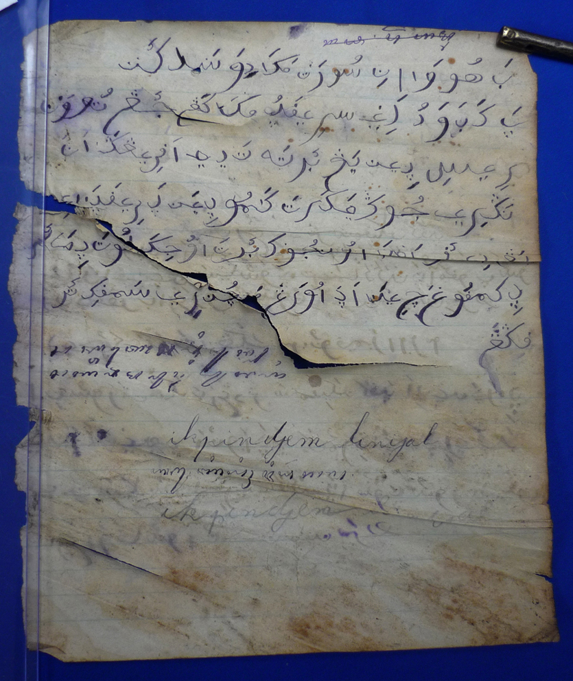

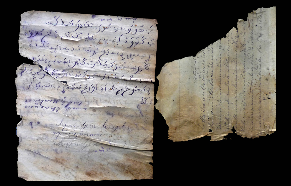

Herewith I add two worn papers with texting which I found inserted in a pendok of a Djogja keris. It seems like a mantra and different scripts like Arab, old Javanese and sanskrit are involved ?
Hope anyone can be of any help.

Old 29th March 2018, 04:50 PM   #14
Green
Green's Avatar
Join Date: Apr 2015
Location: Malaysia
Posts: 328
interesting... it is arabic alphabets written in bahasa melayu (malay) with arabic signs which is not normally used in malay words written in arabic script.
Also, the alphabets are writen separately which is not the usual case where certain alphabets can be connected.
From the rather poorly written alphabets I guess it is written by someone not very adept in writing arabic script and the use of signs above and below each alphabet is either to make it simpler for readers to read or the writer wants to make it look like quranic verses?
The first few words read
Bahawa ini surat maka di wasilkan(?) nya ke bawah duli ...
Here is a letter ??? to his highness... ???
I can't read many of the writings but it would be interesting to get some one to translate it fully.
Old 29th March 2018, 07:03 PM   #15
Paul B.
Paul B.'s Avatar
Join Date: Nov 2017
Posts: 205
Thanks again!
Do you think these sheets are related to the kris? Nowadays people use any kind of paper incl. the newspaper to fill the gap between a pendok and the gandar.

Old 30th March 2018, 01:22 AM   #16
Green
Green's Avatar
Join Date: Apr 2015
Location: Malaysia
Posts: 328
i have no idea... but this paper does not look like random scraps to pad the pendok to me... i may be wrong though...
Old 30th March 2018, 06:45 AM   #17
jagabuwana
jagabuwana's Avatar
Join Date: Jan 2018
Location: Sydney, Australia
Posts: 295
I agree with Green - it doesn't seem like the writer had a great command of written Arabic script. There are also some characters used fairly often that aren't in the Arabic alphabet. The character looks like a an inverted c with three dots under it, in an upside-down orientation to how they are normally used, as in for the letters "thaa" and "sheen". Nor do I think this is present in Jawi.
As Green mentioned it is also interesting that they've added tashkil / harakat (accents and symbols to guide pronunciation). The impression that I get is that this person doesn't speak Arabic or knows how to deploy it, but has learned how to read and write it (or at least the letters) in the context of learning the Qur'an when they were younger.
Still, this doesn't seem like random packing paper to me. It'd be really interesting to find out what the letter is. And it is indeed a letter because it says many times "ini surat" or "surat ini", meaning "this letter". It's hard for me to make out anything after that.

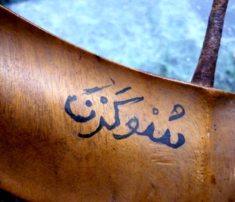

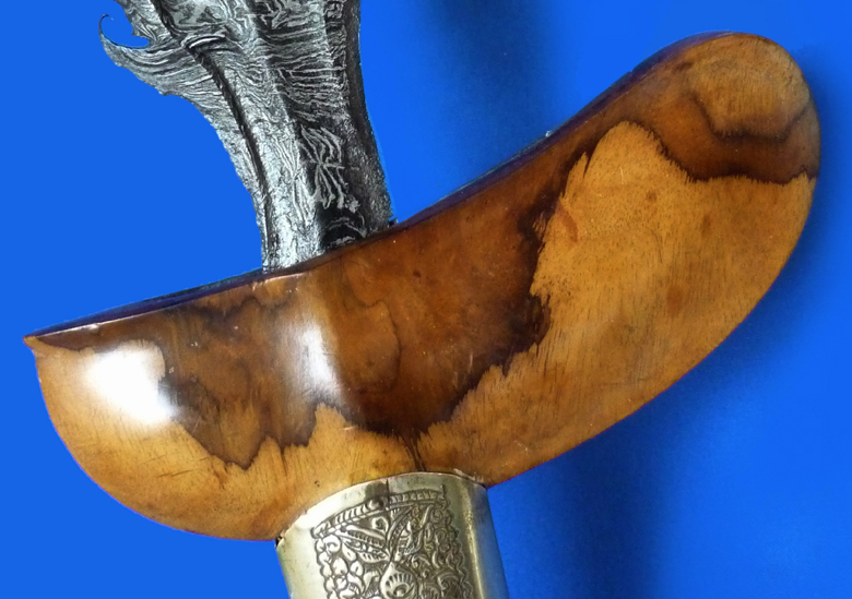

I would like to show a script on the warangka of a Djogja keris to be translated. Could anyone be of help again?
Paul B. is offline   Reply With Quote
Old 22nd May 2018, 03:52 PM   #19
Green
Green's Avatar
Join Date: Apr 2015
Location: Malaysia
Posts: 328
it is arabic "shukran"... meaning thank you
Old 22nd May 2018, 06:38 PM   #20
Paul B.
Paul B.'s Avatar
Join Date: Nov 2017
Posts: 205
"shukran" Green!
Script seen at the back of this Djogja scabbard but vanished after repolishing as it was not an intrinsic part of the kris.

Old 30th May 2018, 11:45 PM   #22
Hartadi
Hartadi's Avatar
Join Date: Sep 2009
Posts: 56
This is Arabic text for “Sukarna” I guess the writer try to write “Sukarno” instead of “sukarna” because of letter “ ن" read as “Nun” there is no “Harkah/text sign to read it for “no” but “na-nu-ni”
