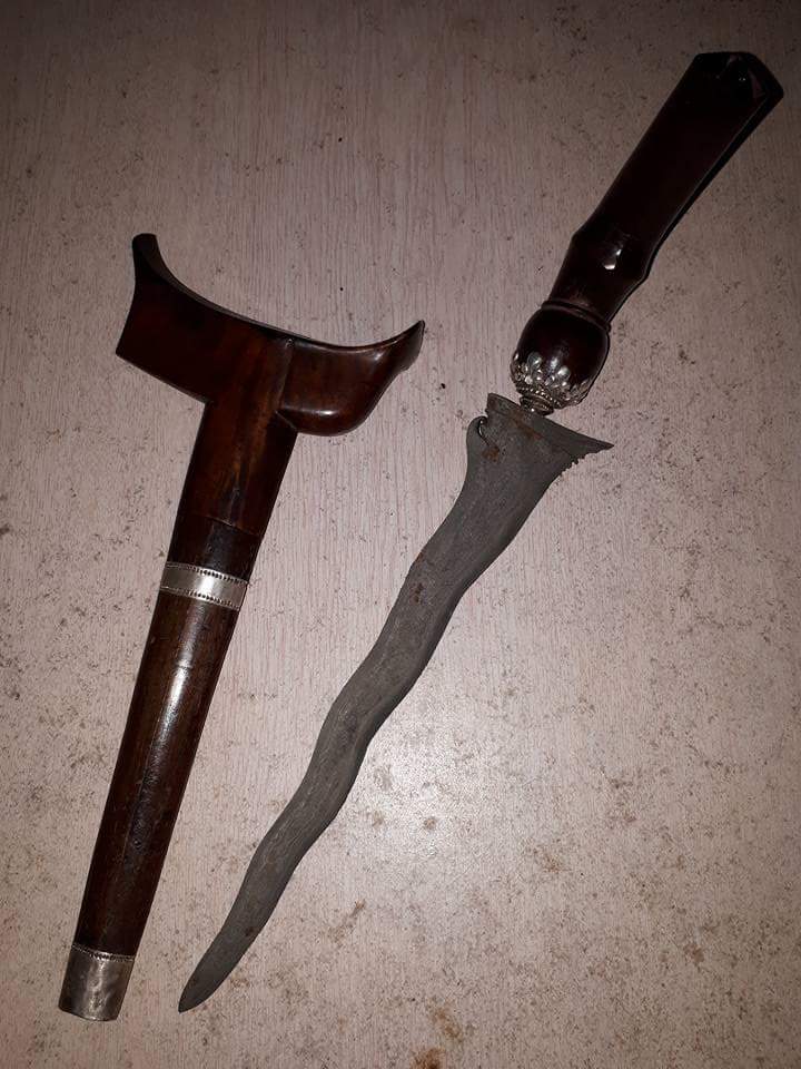

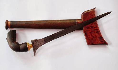

There are some variations in regards to applying sepuhan/ipuh in a keris blade. The most common sepuhan usually done from above the sor-soran to the tip of the keris which resulted in blackish coloration along the sepuhan part of the blade (as shown in the keris Bugis picture here). But there are also keris which are given sepuhan only on the tip (as shown in the keris Minang picture here). However, the common sepuhan which is done from above the sor-soran to the top can sometimes also bear different characteristic of coloration on the blade (as shown in the keris Pagaralam picture here: ribbon like pattern from above the sor-soran to the middle of the blade and blackish from the middle to the tip).

As i understand it sepuhan, when the word is applied to the keris forging process, it is the method of harding the blade to make it usable as a real weapon. Quenching would be the first part of that. Then the blade would be tempered, reheated at a somewhat lower themperature, to soften the hardening a little so that the steel is not so brittle and doesn't just crack in use.
These are different blades done by different smiths from somewhat different cultures at different times so it is not surprising that each smith applied this process to different degrees. Some may have felt that just hardening the tip was enough while others went further down the blade. Most keris smiths these days don't bother with this hardening process at all since there is always the risk of cracking and failing welds when to is applied. Since most modern keris are made to be seen for their artistry, not used as weapons, the hardening process becomes a risky and unnecessary step.

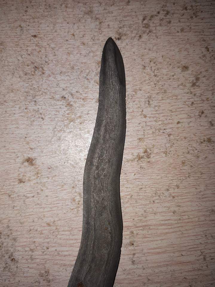

By the way, the keris Minang pictured here is actually small one (the blade is less than 25 cm in length) and it got sepuhan on the tip part of the blade.
I have seen the previous thread which discuss the small keris or called keris selit in the Malay culture which is functioned as dressing companion. But judging from the sepuhan exist on the keris that I've shown you, is it possible that these small keris may have practical function (eg: as a weapon)?

Hi Oracle. AFAIK Keris selit is specific certain areas of Malay culture. Minangkabau culture is distinctly different from the Malay cultures of the Peninsula as well as other cultures on Sumatra. I do not believe they have a tradition of keris selit as a dress function. From my understanding Minang keris tend towards the shorter side.
Keris are stabbing weapons so the most important area of the blade for harding would be the tip.
