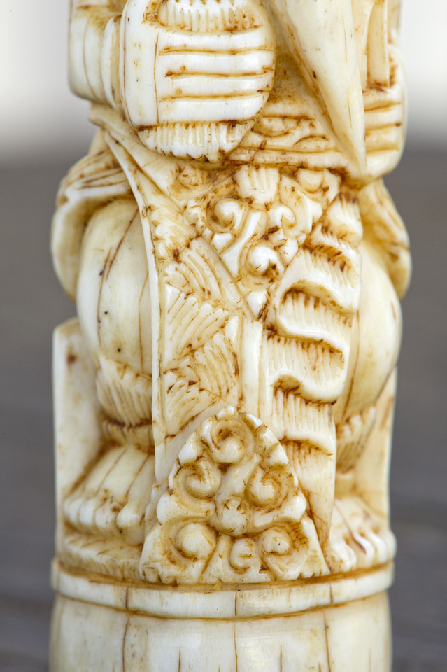

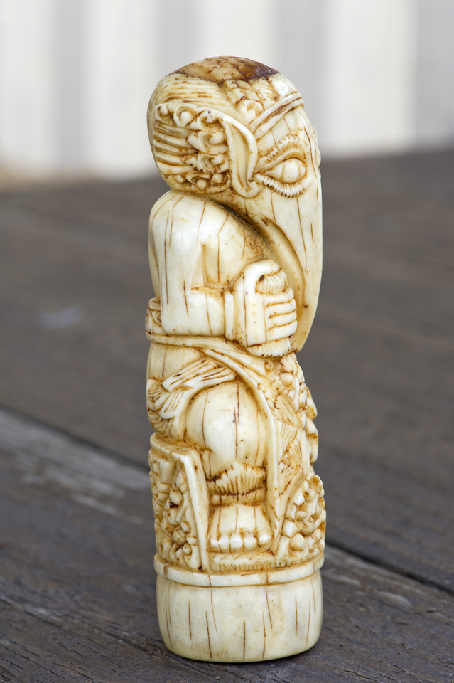

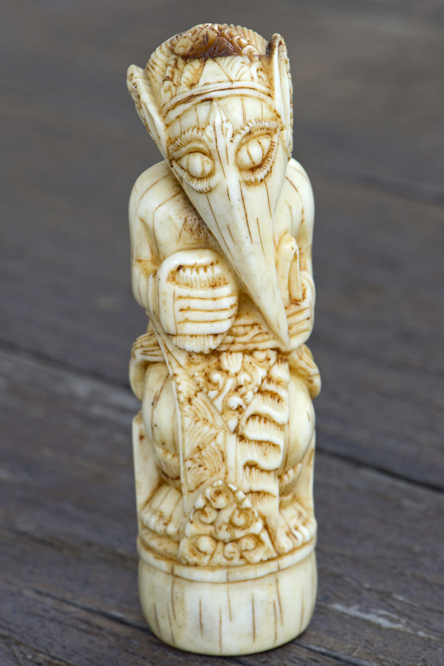

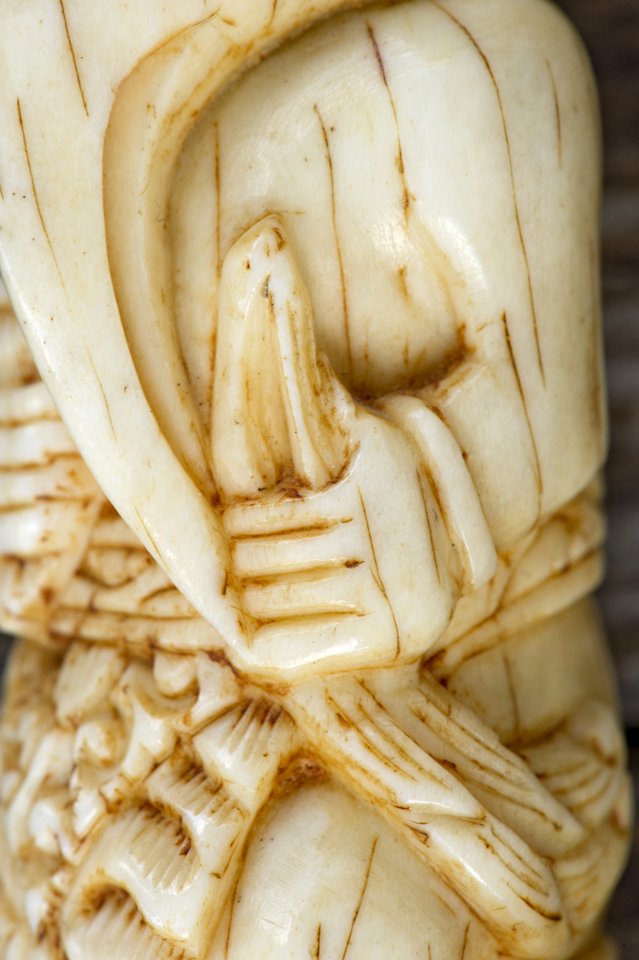

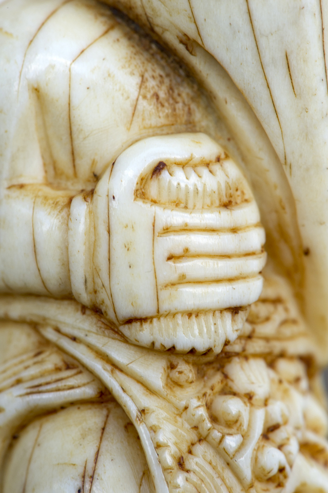

I acquired this hilt on an old Javanese keris really early in my keris collecting "career". It shows some age, but i have always assumed it was at least post WWII and possibly from sometime around the 1960-70. Iy has a nice color and patina. While no great work of figurative art i have always thought it had a certain charm (a bit like Art Naïve). I have wondered if it might be of Madurese origin, but i have never been sure. It seems like it might be Ganesha, but maybe not. You know how it is with later figurative hilts. It's intentions are not clear IMO. I did once see another hilt of the same exact design which very possibly may have come from the same carver for sale online some time ago, but i never downloaded the images and can't remember the site.
So what i'd like to know where folks think this originated? Do you think it is bone or antler? I kind of lean towards bone (note that the head has a plugged piece inserted). What type/origin of keris would this hilt be appropriate for? All comments appreciated. Thanks!

Hi David, not much to contribute but I think your call that this is Lord Ganesha is probably correct, both hands are holding something, ? the left hand a conch, no idea what is in the other hand

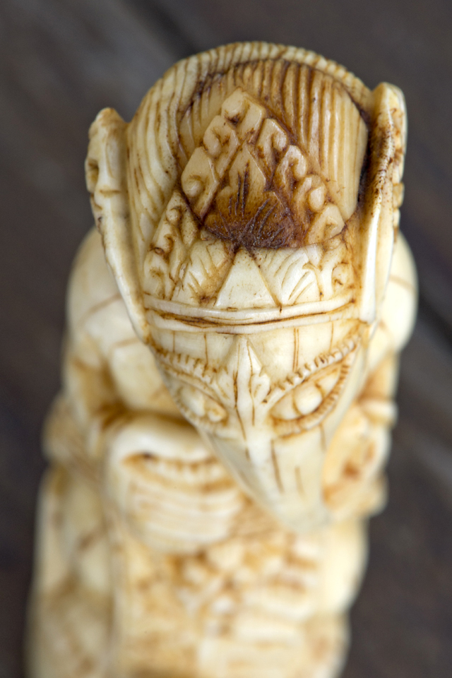

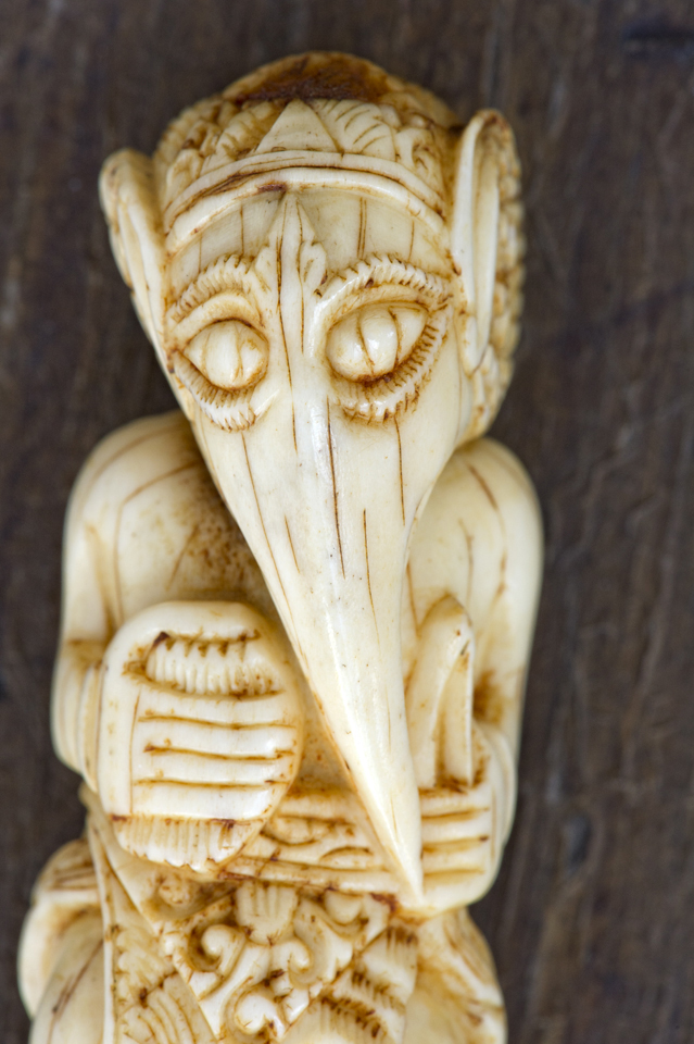

No, this is not Ganesha, it is most probably intended as a representation of Jentayu (Jatayu).
I always thought the long face looked more beak than trunk.
Any thoughts on origins Alan, or what, if any, dress this hilt would best serve?

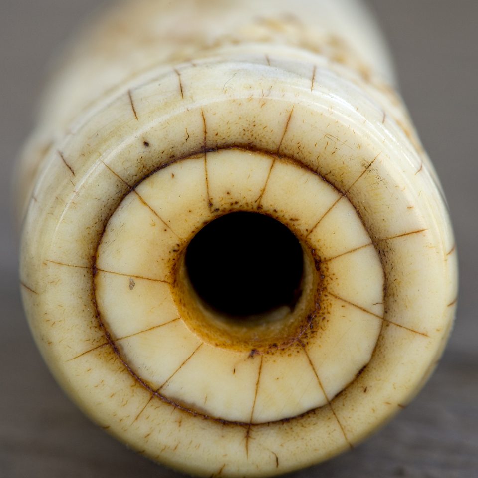

No one has commented on the material yet. What do you think, bone or antler?
Old 3rd May 2018, 05:53 AM   #7
Posts: 6,436

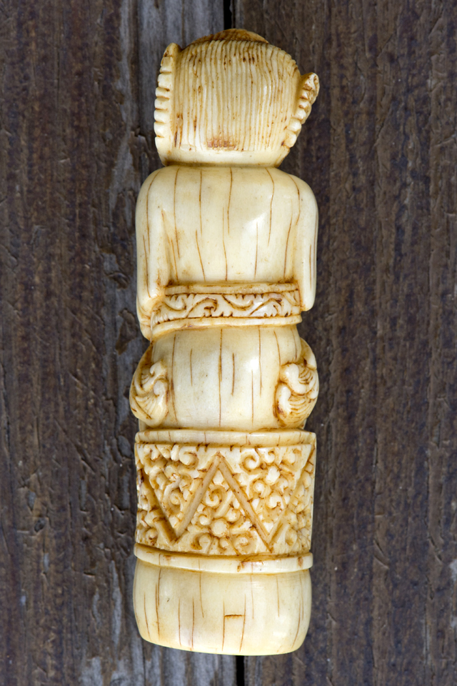

I'll guess bone David. At the bottom of the handle is a ring which I think covers the marrow area.

Looks like bone to me.
My guess is Madura, Sumenep work, and 1980's --- but if you say you got it previous to this David, well, just take it back to where you think reasonable.
It would perhaps sit best on something East Jawa/North Coast/Madura.
Yes, certainly Jentayu is Hindu, but the East Jawa/Madura carvers draw on all societies, cultures, periods for inspiration.

For me, it's interesting to see the engraved "cracks", which imitate older ivory.
A good lesson.

Yes it would from about ten feet away, or to the novice collector.

nice hilt also when not antique. Another vote for bone and Jentayu. And I also think that it is from Madura.
