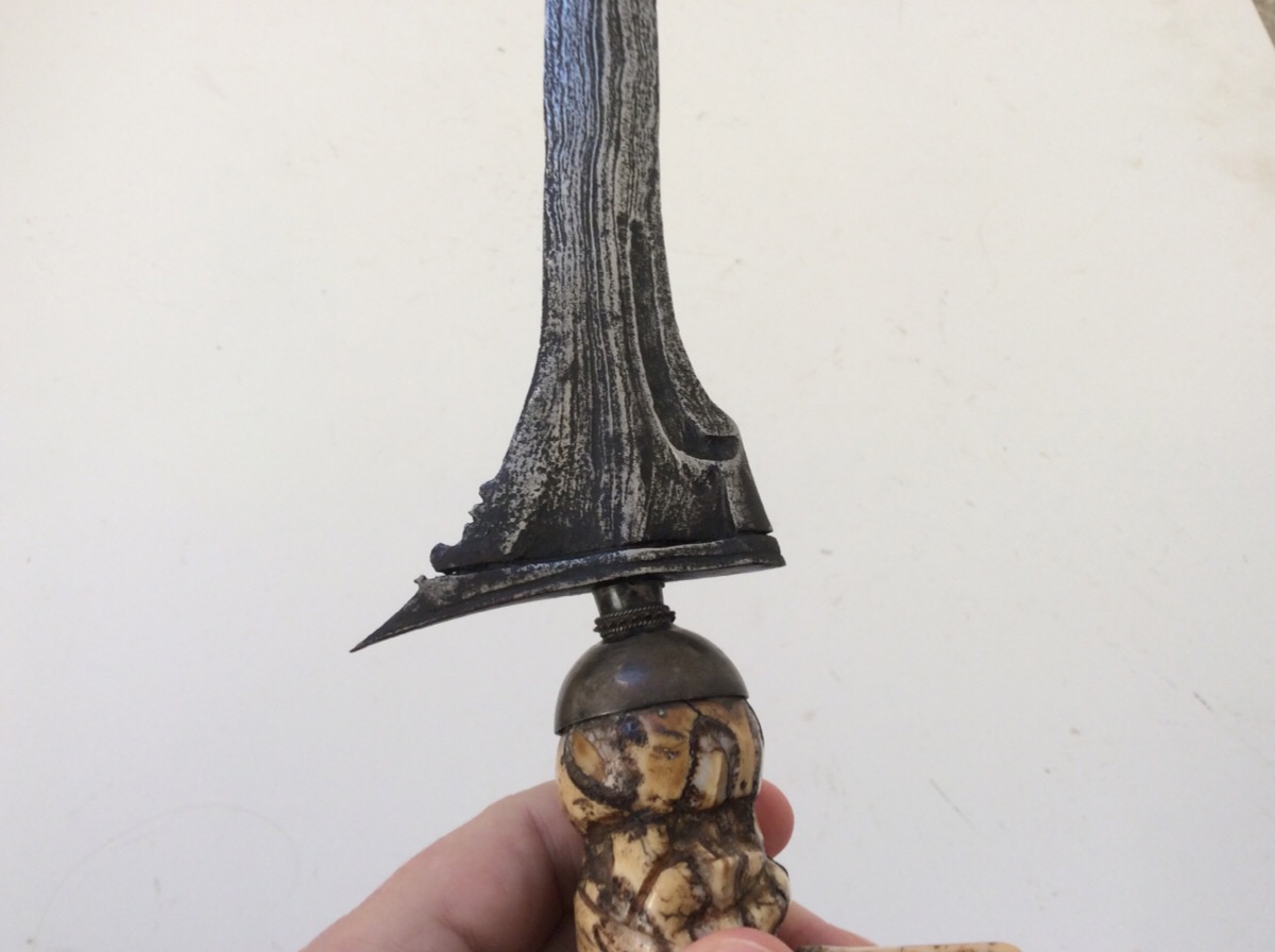

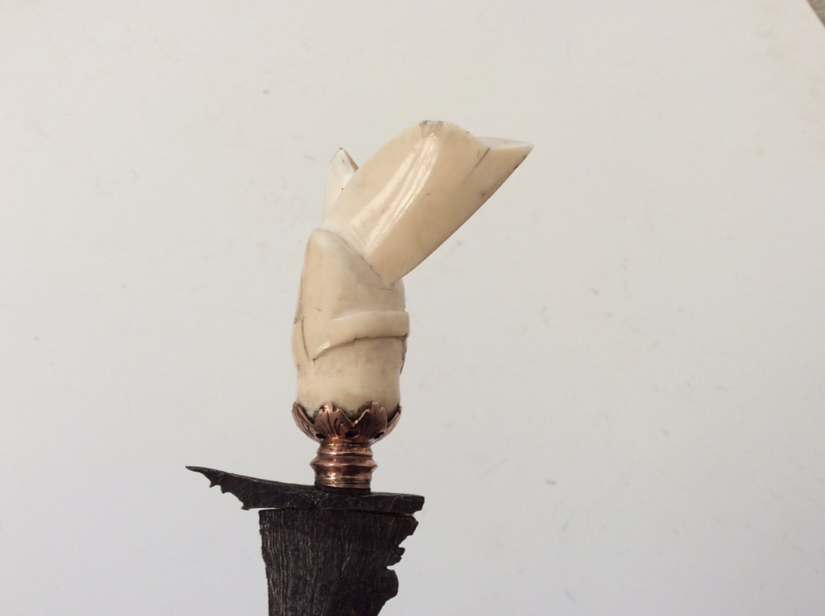

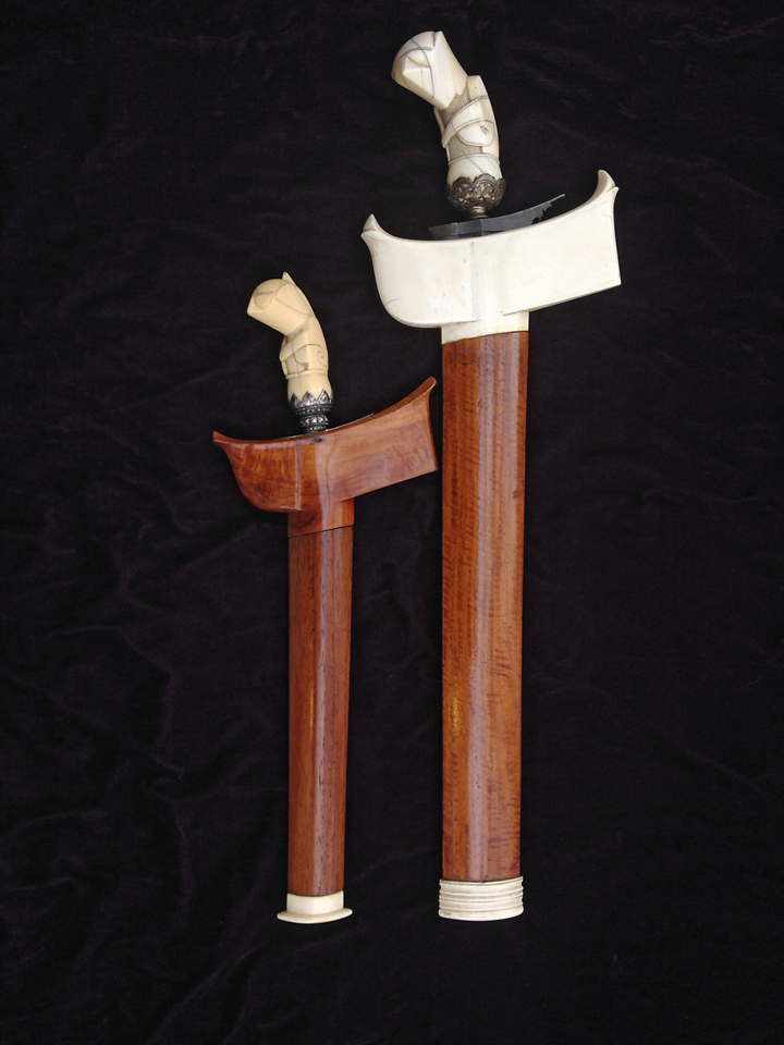

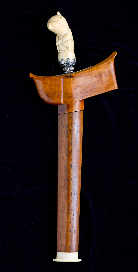

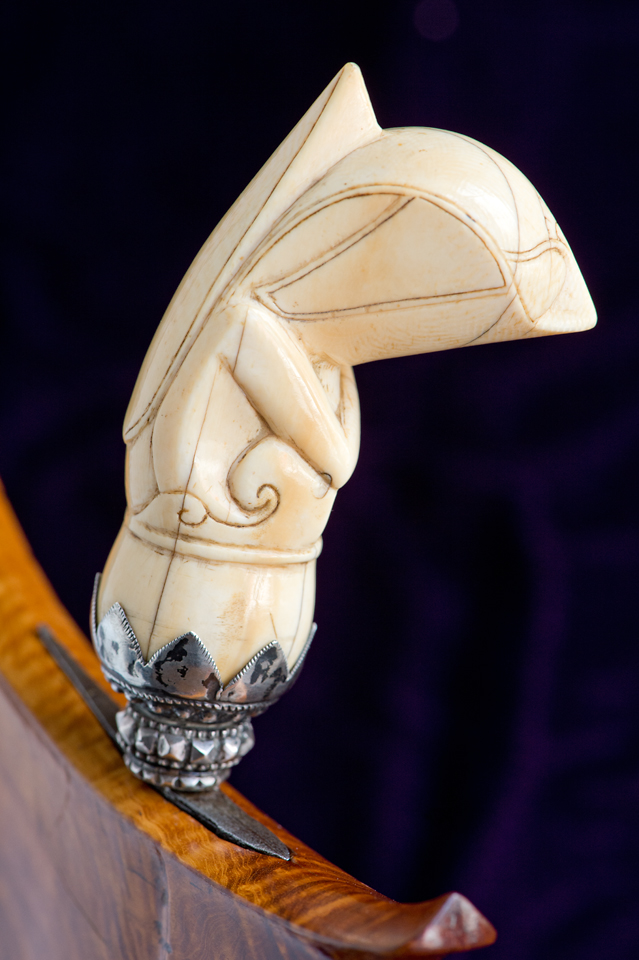

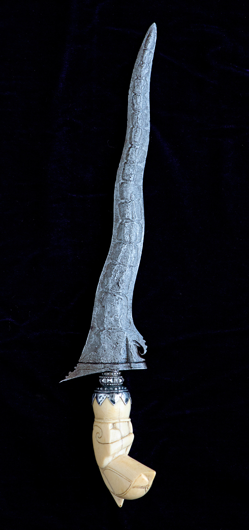

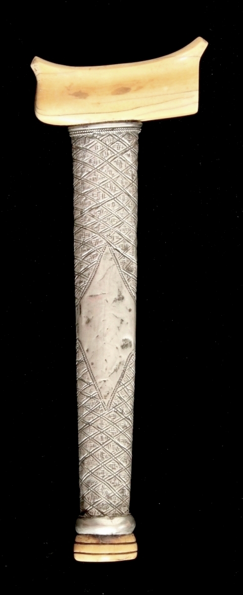

Well, it's been a little slow around these parts so i thought i might perk it up a bit by posting this keris selit. I have assumed this one is from the Peninsula, but perhaps someone can pinpoint its origins further.
Here's what i know. These small keris (patrem size) are generally carried tucked into the waistband, often as a secondary formal dress keris. The name "selit" or "sisip" which literally means "insert", as into the waistband.
The blade is just a bit over 8 inches long (about 20.5 cm)
I would love to hear comments about this keris and more information around the tradition of these small keris within the Malay culture as well as see some of your own if you have them. Thanks!

Just a question: is the blade Buginese?
Marius

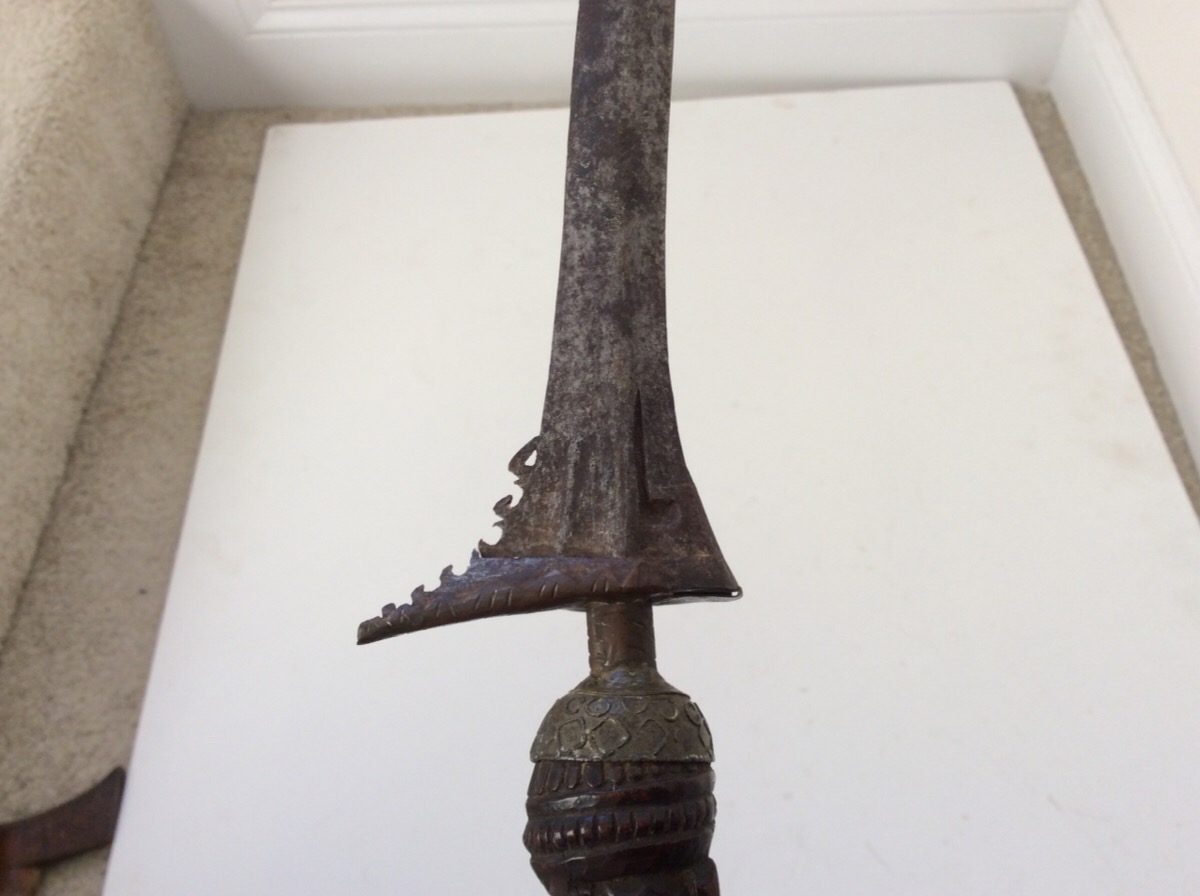

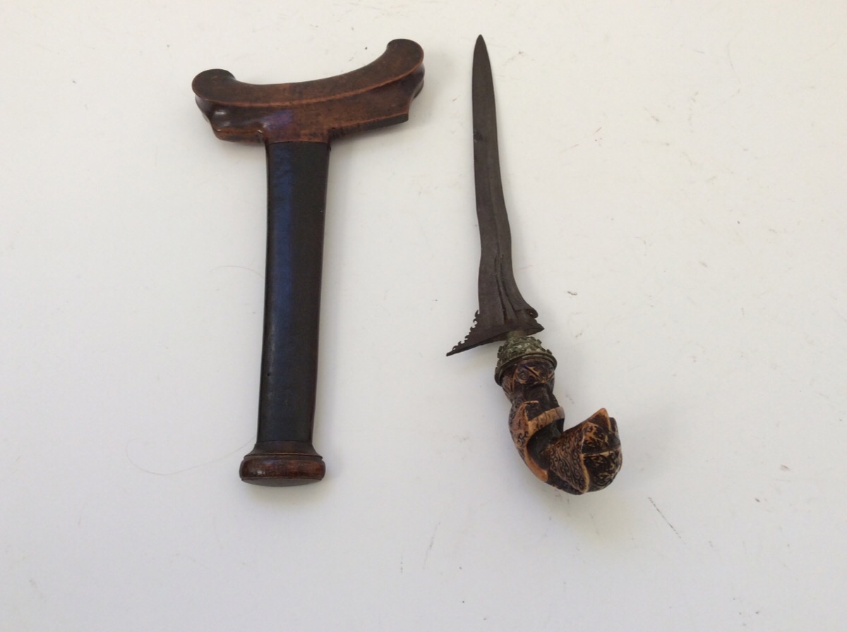

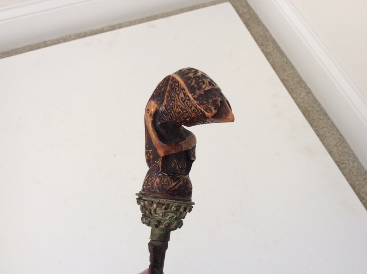

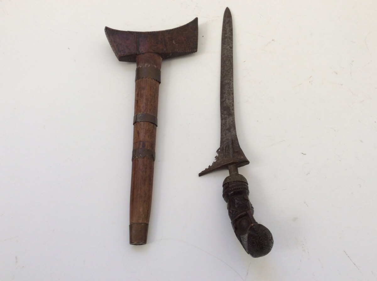

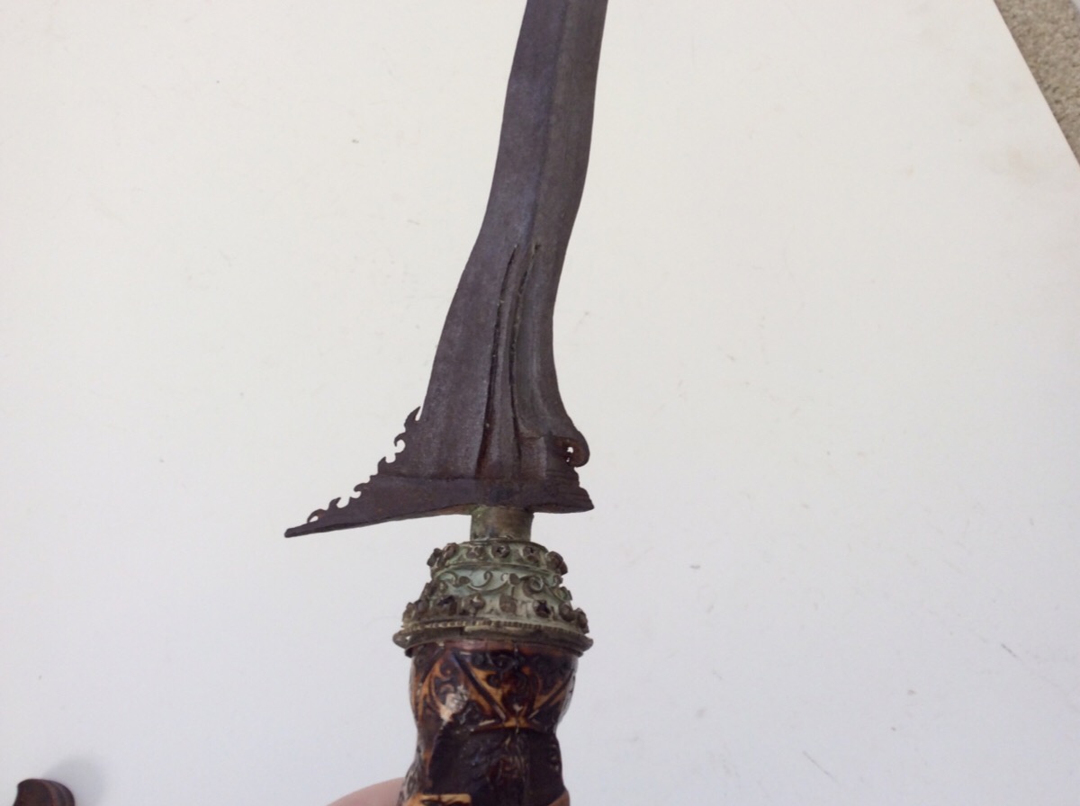

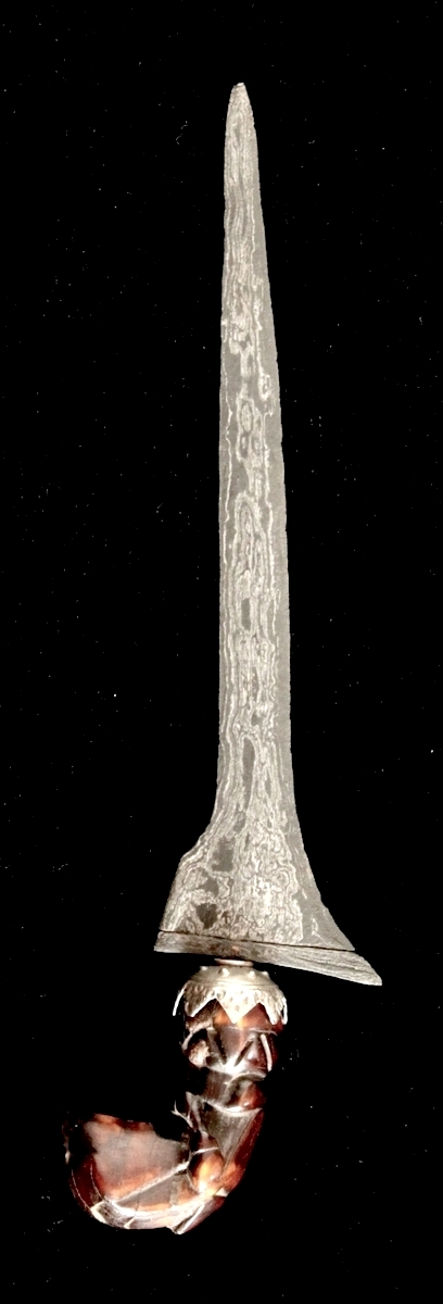

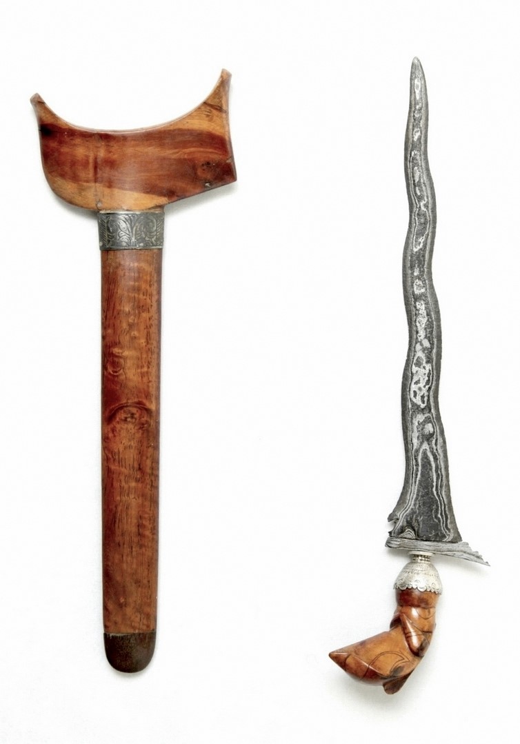

Nice specimen, I wonder whether the blade has been shortened a bit? (slanted at the tip).
I attach the pics of 2 small Malay krisses from my collection (already shown, sorry), the blades are 16 cm and 22.5 cm long respectively.

That's a very beautiful peninsula Malaysia keris selit. By the way, Peninsula malaysia people don't use the term keris patrem but just keris selit. It is usually worn by groom during wedding, when they use formal 'Malay busana'... Old traditional Malay attire. And also during any traditional events when Malay busana is worn.
Jean;
Your first keris is not from peninsula Malaysia, but I guess from Sumatra based on the hilt form. The second is not Malay too I believe. the blade is heavily stained (warangan) whereas malay blade is never waranged. The hilt of the second keris is Peninsula Malay hilt though.
I believe the blade was made somewhere on the Peninsula. That is not to say that it has no Bugis influence, but in identification i would not call this a Bugis blade per se.

I agree with Green on your first keris and i'm not sure that it is specifically intended to be keris selit. Perhaps someone knows more about the tradition of such small keris in Sumatra. I would imagine that dependent upon what part of the island one is on traditions vary. But i believe in certain areas patrems are known. Perhaps further north closer to the Peninsula keris selit are known, but on this i am not at all sure.

Hello Green,
I agree that the first kris is probably from Sumatra but not of a common type. I have used the word Malay in the broad sense so it is not equivalent to Malaysian.
Regarding the blade of the second kris, it was treated by warangan in Solo even if this is not traditional in Malaysia so you can't assess its origin based on this

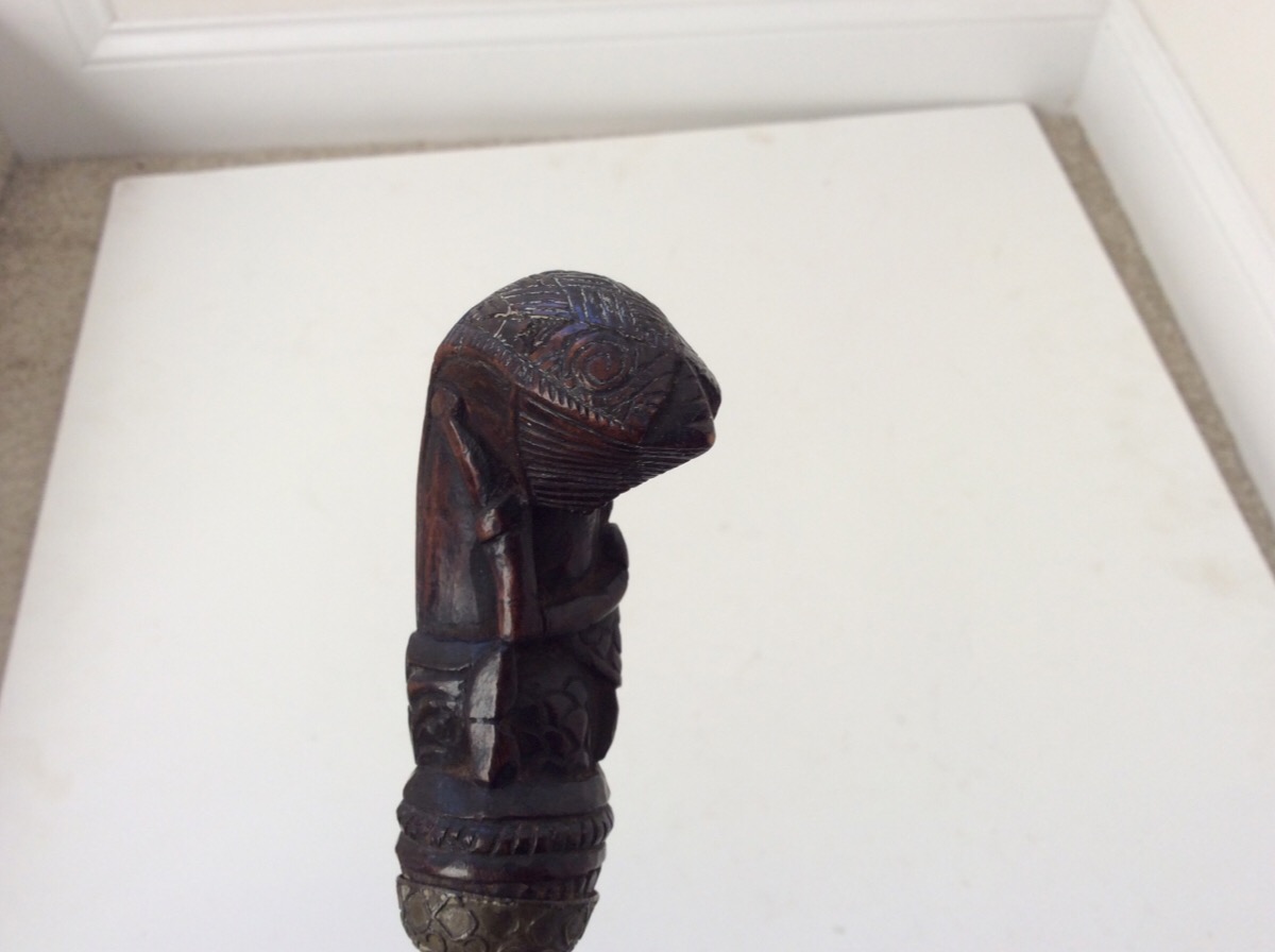

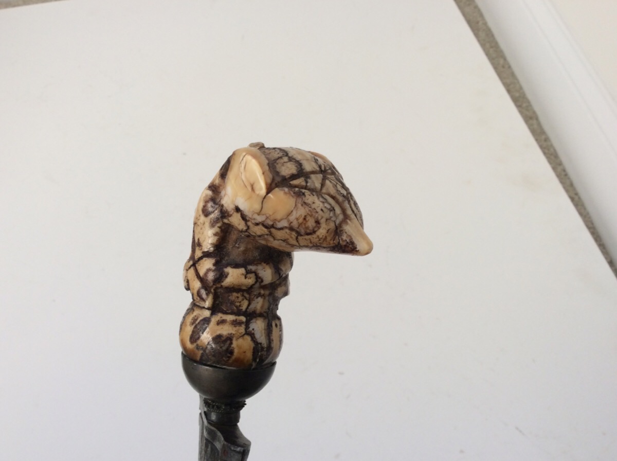

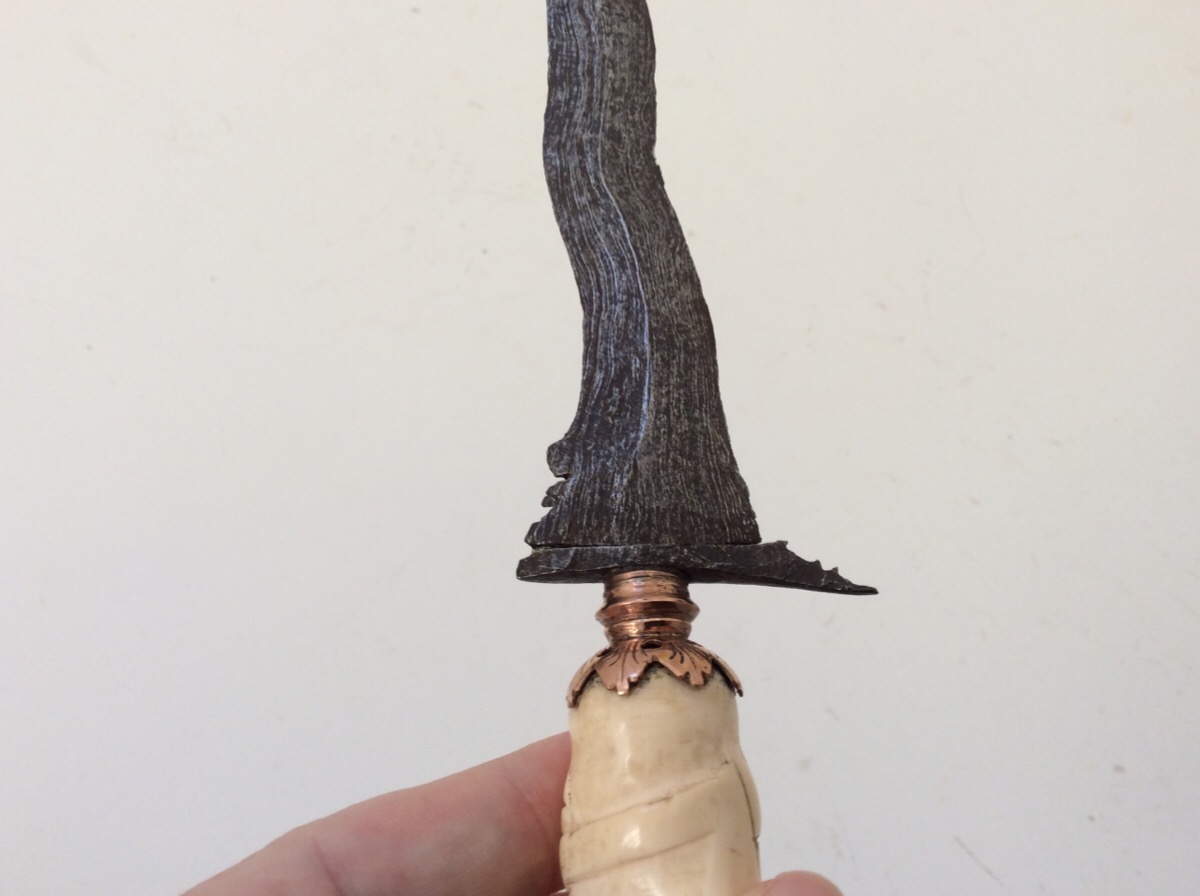

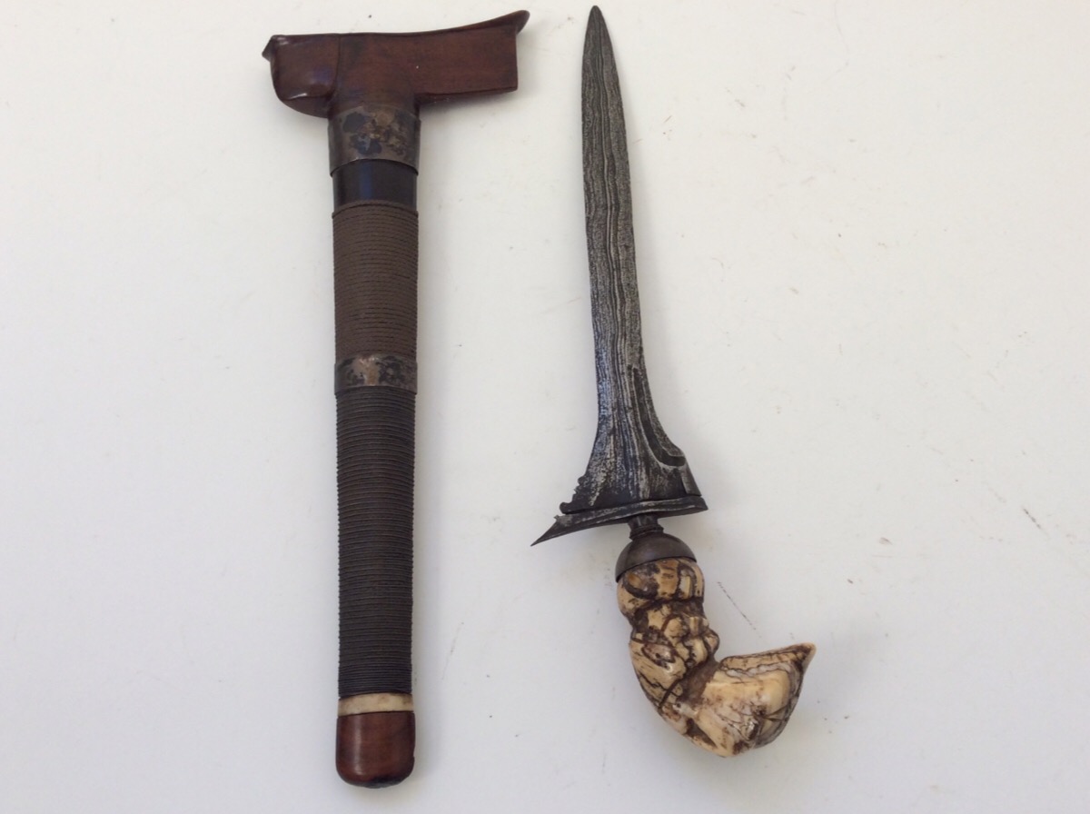

Since David asked to share examples I will share 4 from my collection.
Old 15th November 2017, 01:05 PM   #23
RSWORD
RSWORD's Avatar
Location: Greensboro, NC
Posts: 1,099
Example 2

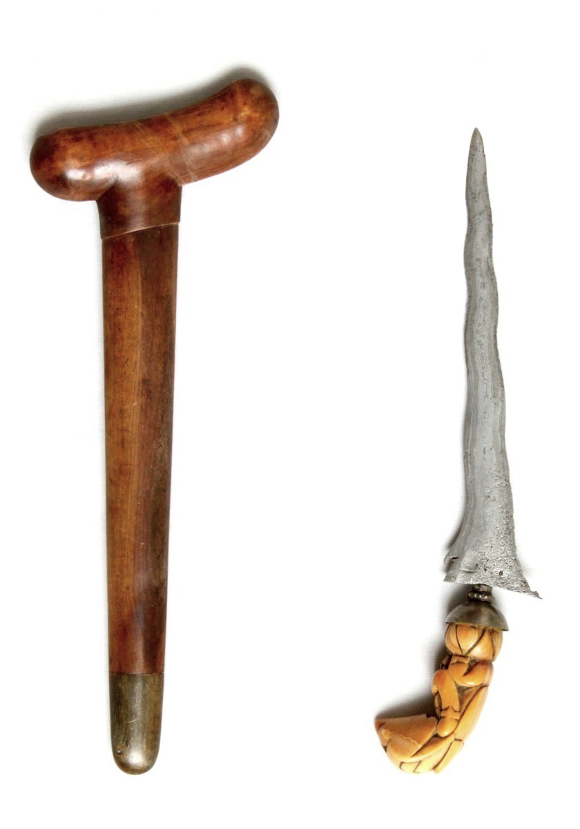

Old 15th November 2017, 01:06 PM   #24
RSWORD
RSWORD's Avatar
Posts: 1,099
Example 3

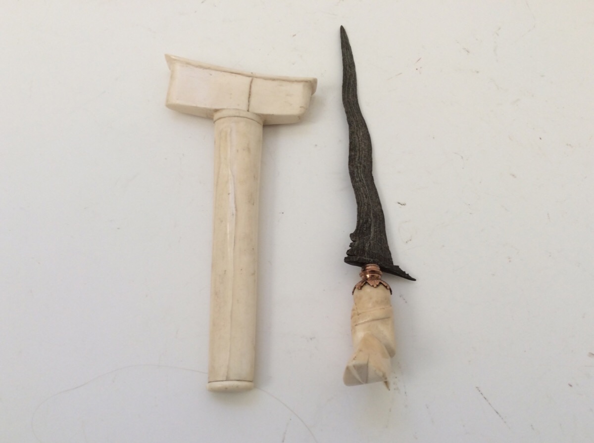

Old 15th November 2017, 01:07 PM   #25
RSWORD
RSWORD's Avatar
Posts: 1,099
Example 4. Comments welcomed on the 4. Thanks!
Hello Rick,
N° 1 is Minang for sure (not selit), and N° 3 & 4 look Sumatrese, see another small specimen of unclear origin but probably Sumatra also.

Thanks for adding Rick. I believe you example #2 might qualify as a keris selit. As Jean points out, perhaps not the others. There are small keris that serve different functions in various keris bearing cultures, but not all are selit.
Can you give us some blade lengths on these?
