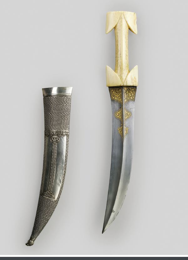

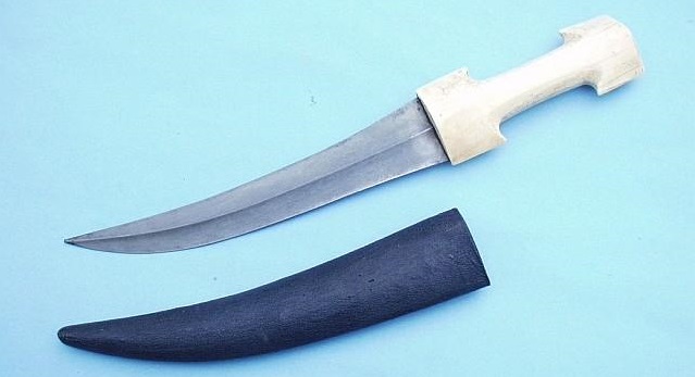

Default Origin of HANCER daggers

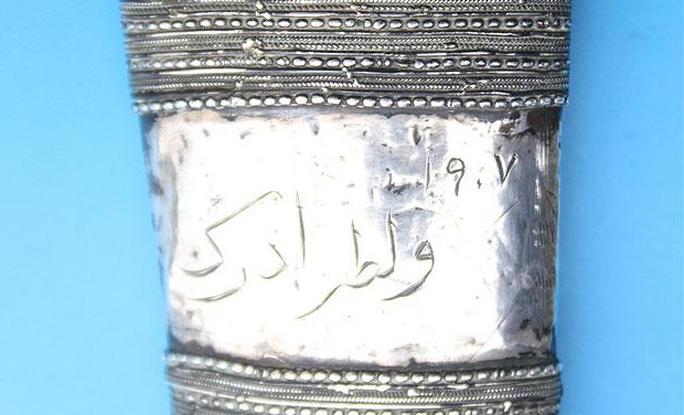

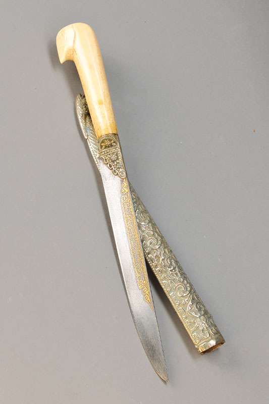

Here we have one that belonged to Osman Bey and was made in Damascus, Syria.
Now let us try to find more of the same kind with incriptions containing the place of origin, in the hope we can accurately locate more of them and eventually establish a pattern.

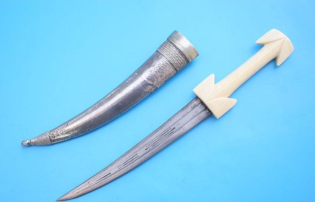

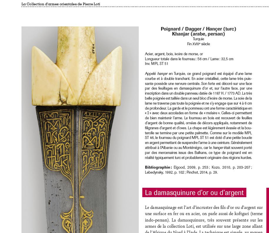

Posts: 1,918

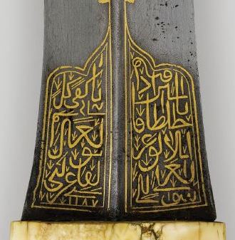

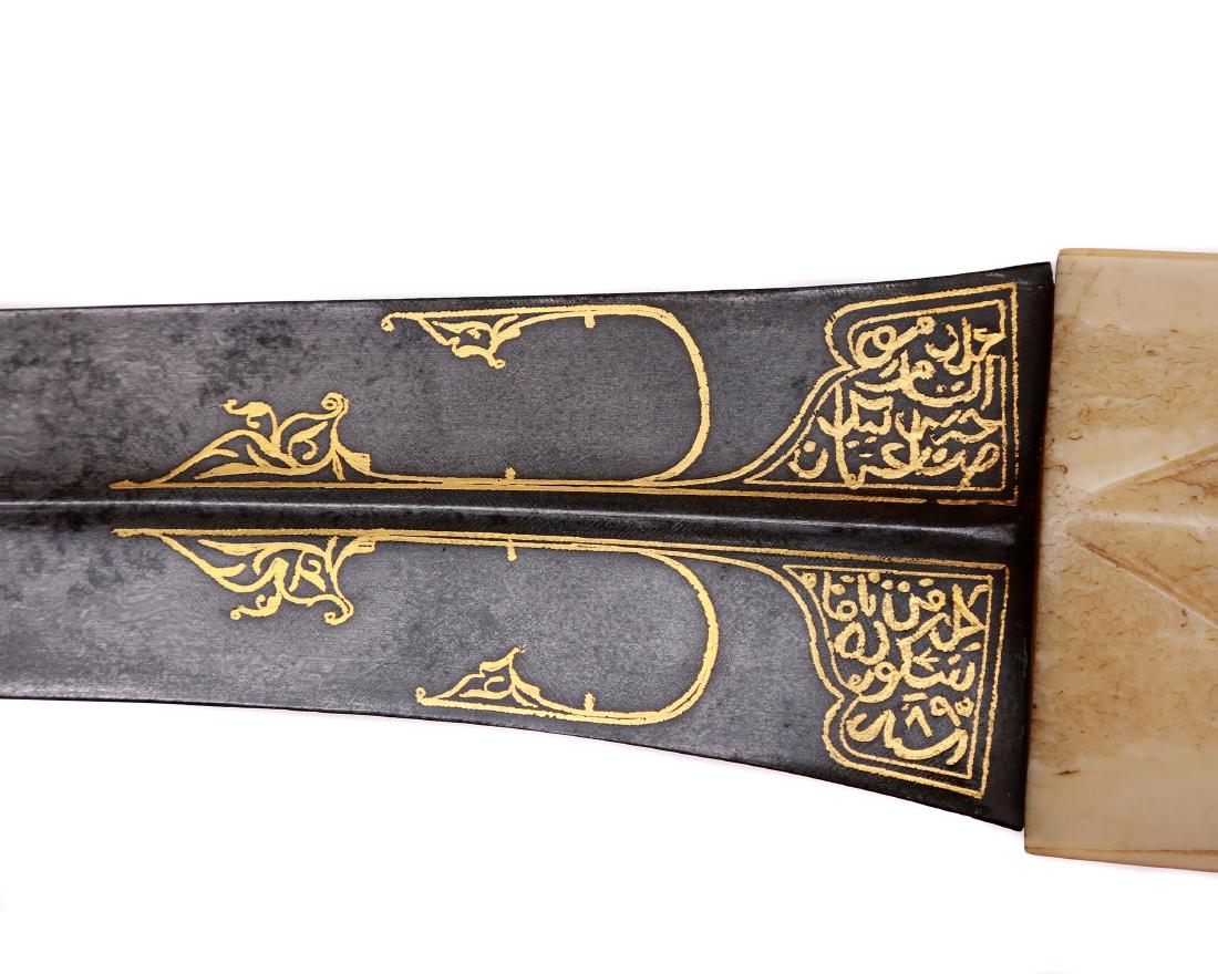

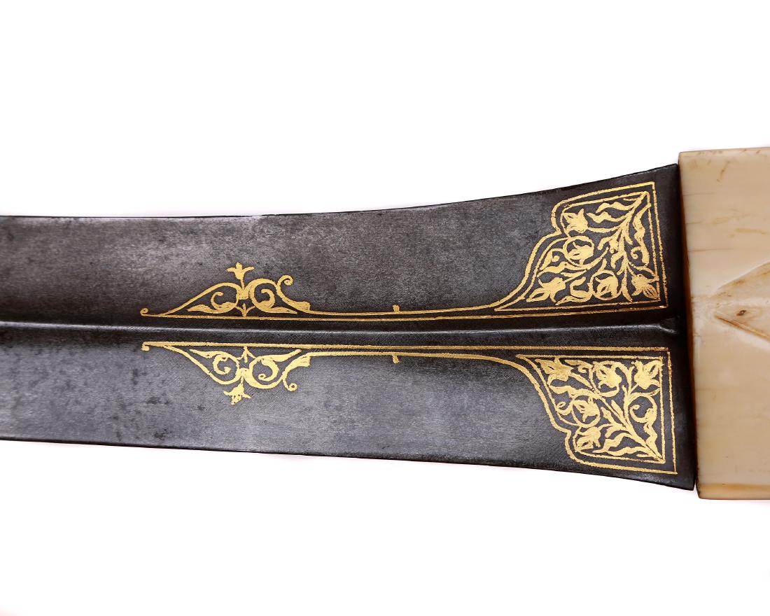

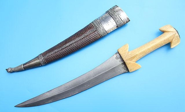

Here we have a second one attributed to Turkey and dated 1187 corresponding to 1773 AD.
Maybe Kwiatek will be kind enough to translate the text for us so we cand know where exactly does it come from...

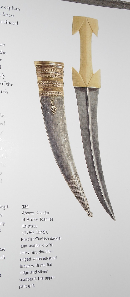

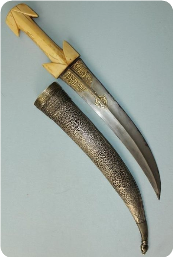

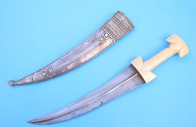

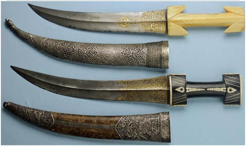

More of these, they are called by collectors and dealers "Albanian jambiya".
Old 21st March 2020, 10:59 PM   #6
Kubur
Kubur's Avatar
Posts: 2,145

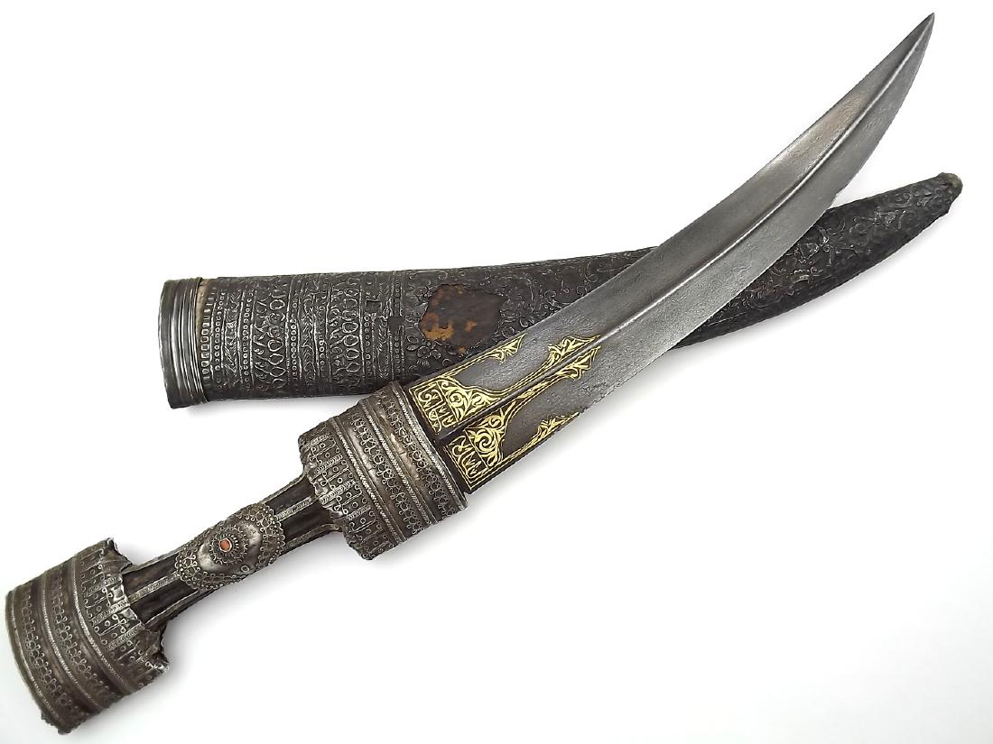

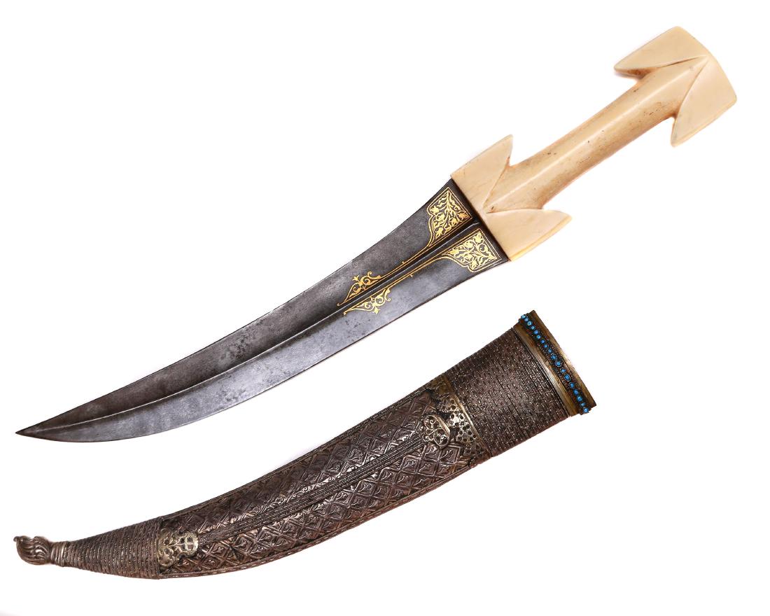

As you can see some of them have hilts more Kurdish in style...
To support Marius point and the link with Persian blades, I think the Kurds are the link: from today Turkey to Syria up to Iran...

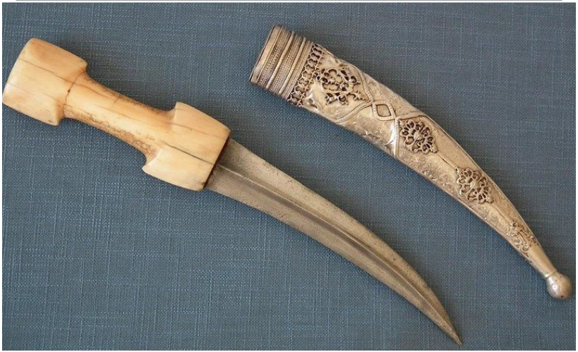

Some rich Kurds...

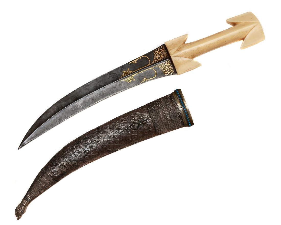

That's why I am inclined towards the Turkish origin of these daggers.
The two first daggers that you posted are often described as Baghdadi jambiya.
They are very similar to the Kurdish ones but with silver filigree fittings.
I might be wrong but it will be good to focus only on the first dagger that you posted as the shape is different from the others.
But I agree that they share many features.
Old 14th April 2020, 10:30 AM   #22
kwiatek
Join Date: May 2019
Posts: 156
Again, it is possible to make suggestions for individual words, but I do not think the inscription as a whole reads or that the person who made it knew what they were inscribing/copying. The date of 1187, however, is legible
kwiatek is offline   Reply With Quote

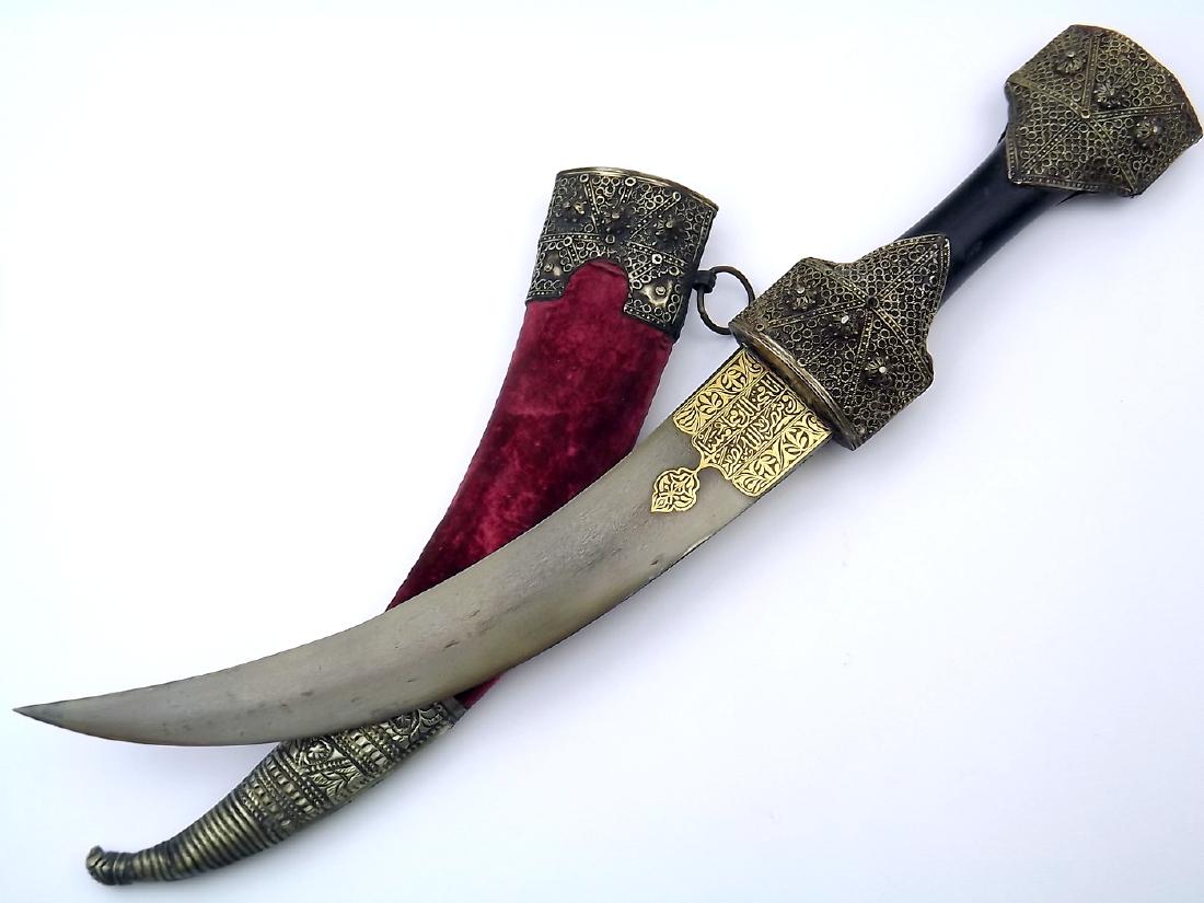

The one with the dark handle has a Turkish poetic inscription I've only ever seen on yataghans. Interesting piece

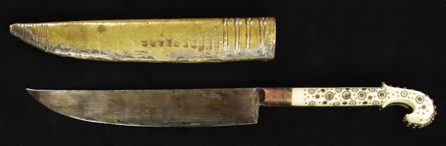

Default origin of the name Bıçak
Bıçak: knife EN[1] oldTR biç-/bıç- +gAk → biç- oldTR kınğırak (et bıçağı TR; meat knife EN). biçek/bıçak [ Divan-i Lugat-it Türk, 1070] Bel bıçağı, et bıçağı, kıyma bıçağı, kaymak bıçağı, pastırma bıçağı, börek bıçağı, bekçi bıçağı , kasap bıçağı. from oldTR[ Kaşgarî, Divan-i Lugati't-Türk, 1073] biçek: as-sikkīn [bıçak] (...) as-sayf [kılıç]; oldTR: [ Kutadgu Bilig, 1069] bıçaḳ tartma anda kötürme süŋük [bıçak çekme orda ve kemik taşıma oldTR bıçak/biçek kesme aleti oldTR *bıçġak < ETü bıç- +(g)Ak
Oldest source: biçek/bıçak "aynı anlamda" [Divan-i Lugat-it Türk (1070)]
The bichaq is a single-edged dagger of Turkish origin. It is widespread in areas controlled by the Ottoman Empire and its close neighbors.
The blade of this knife is either straight, holds a slight forward curve, like a short yataghan, or very rarely a backwards curve, like a jambiya.
This knife and others were made at the end of 19th century. They were often sold as souvenirs to officers of the Austro-Hungarian Empire who invaded Bosnia at the time. The principal centers of production were Sarajevo and Foca.
source of the above : costak.blogspot.com / date Friday, July 05, 2019
