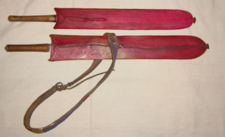

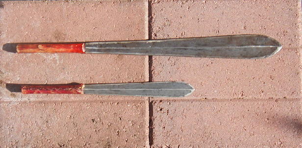

This specimen is an unusual seme due to the blade’s relatively short overall length of 13 1/2". The size suggests that this knife probably belonged to a younger uncircumcised Laiyok (youth) rather than a Moran. There is a photograph on an uncircumcised youth in Broken Spears with a very simmilar mini seme.
The dyed sheath is of the traditional Masai red and measures 9 ¾” long. This scabbard has the attributes of a larger transitional moran Seme with the winged mouth, wider belt loop, and metal disk fastener at the tip as well as Frankenstein stitching on the reverse. The metal disk seems to be glued in place with some sort of sap or wax adhesive.
Fullsize Moran Seme (top)
OAL-20 ¾”
Blade- 15 ¼”
Hilt-5 ¼”
Sheath-18”
Laiyok Seme:
Overall length- 13 ½”
Blade 8 ½”
Hilt- 5”
Sheath 9 ¾”

Nice "baby" knife, never see a small like this.
Here is mine with this inscription on the coin :"East africa & Uganda protectorates 1911" et "Georcivs V rexet ind : imp one cent". On the blade we can read :"Martindale, Birmingham, made in england” with a crocodile, “Regitered N° 1673”.

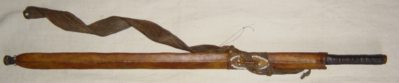

I think you will find that the red scabbard ones even with a midrib are a relatively modern adaptation. A picture of my older one.

What makes you think yours wasn't redder pre-patination? I've seen pretty old looking ones with remains of red dye in the rawhide; sometimes very faint remains. The association of red with Massai is an old thing. Another matter is that Massai do not, AFAIK traditionally make there own weapons (not s'posed to work iron), so I'm given to wonder about the relation or even identity of Massai weapons with neighboring peoples' the spears are certainly similar, and the swords bear a close resemblance to Watutsi ones (and a vague resemblance, unsurprisingly, to many African swords).

That's a good point Tom. Different peoples in the same region carry related weapons. Unfortunately all the photographs I have seen of warriors with the long type seme are in black and white and personally I cannot recall ever seeing one with a red stained scabbard. My own example has no trace of staining just being the natural tan of the hide. If someone can post a genuine older example with the modern red staining we are talking about, I will get a web cam and you can all watch me eat my hat or shoe or what ever?

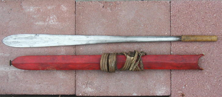

1921 coin dated old long style seme in a red scabbard.

I thought I would start with a shoe, quite nice if a little tough and a triffle bland however the wine was good.

Actually, though perhaps of similar age and size, I see two somewhat distinct styles here; one more "swolen", perhaps more shaft-and-bladeish, and also the horns of the sheath much bigger, offhand (no time.....); regional/tribal/etc?..........
Old 12th May 2006, 10:04 PM   #11
Posts: 5,997
I am glad you mention that Tom. I have stopped eating shoe as I still do not think we are in the same time span. These two have coins on the scabbard. The smaller one 1927 the one with the belt 192?
There are many differences if one looks hard, the belt for instance has been formed not just cut hide and the general patina of the whole thing. Chalk and cheese .
