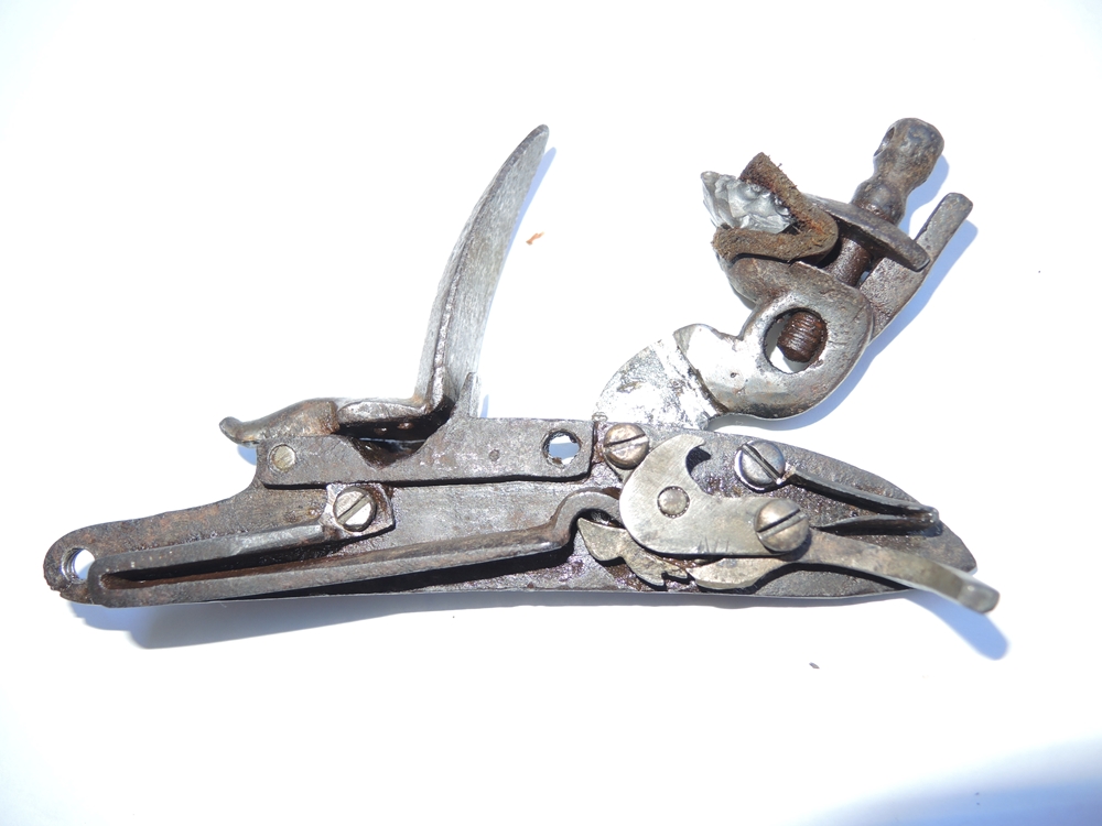

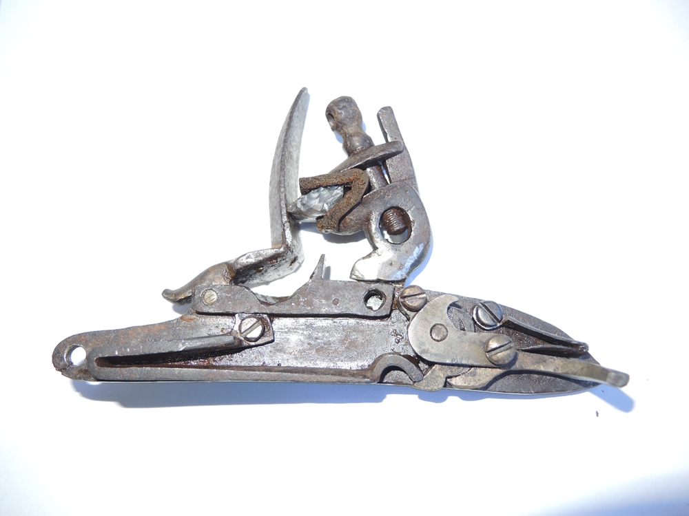

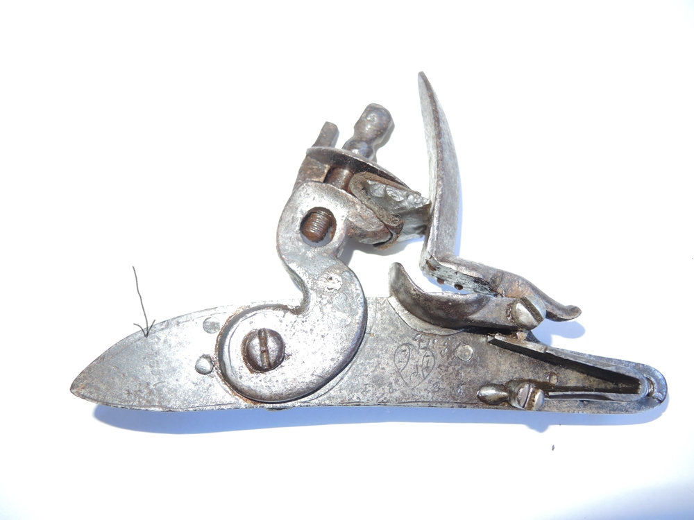

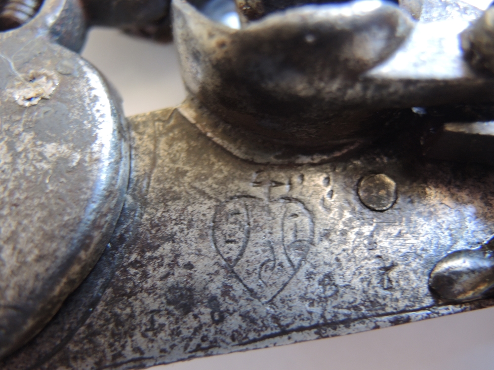

Can anyone please help with ID of this flintlock? It bears an early EIC mark and there is also a date which unfortunately is unreadable. It looks like ??57 but I can not be sure.
Any leads appreciated.

This one is easy it's is the East Indian company, English, earlier than the Lion's stamp.
Found on many Djezails rifles.

With no inspection or acceptance marks,(That I can see) and the cock and frizzen being a bit "off", and the tumbler not being an EIC type, I think it was maybe re-built on the sub-continent or altogether locally made.
The date also sounds a bit ominous, as it isn't a 1757 lock, and in 1857 the EIC was using percussion arms and had been for some time.
Also 1857 was the year of the Mutiny....
Sorry if this sounds a bit unwelcome!

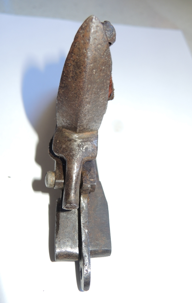

Unfortunately, this is a locally made lock. Likely Afghan made from a combination of surplus parts and locally made parts. The attempt at the EIC designation and date on the tail are both spurios. Curiously, the sear, sear spring, tumbler and plate look like it came from some type of European lock. But the hammer, frizzen, pan, and lockplate all look like local construction. Note the tapered width of the frizzen was never seen on European locks of any that I know of. But it does copy the frizzens seen on South Indian pistols.
Wish I had better news. However, if this lock came from an Afghan Jazail, it would make perfect sense.

With reference to the date, I did say that it is well worn and VERY hard to decipher. The ??57 is a pure guess from what I can see.

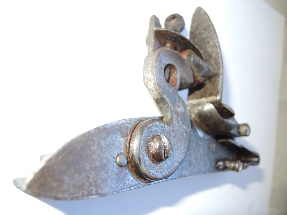

Yes this lock IS from a Jezail but the locally made locks that I have seen are generally not of the (better) quality of this one. This one has screw fittings rather than the peened over pegs of other locks.
Apart from comments about the lock itself I was hoping that someone could give a date range that this PARTICULAR "heart" striking was used.

The EIC always used a "Quartered Heart."
This one being a local copy could have been made between early 18 o00s and yesterday.

But if the mark is spurios, it could have simply been crudely copied at most any point in time. And was so common on these guns.
