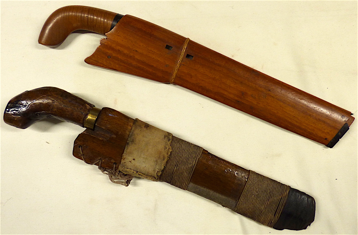

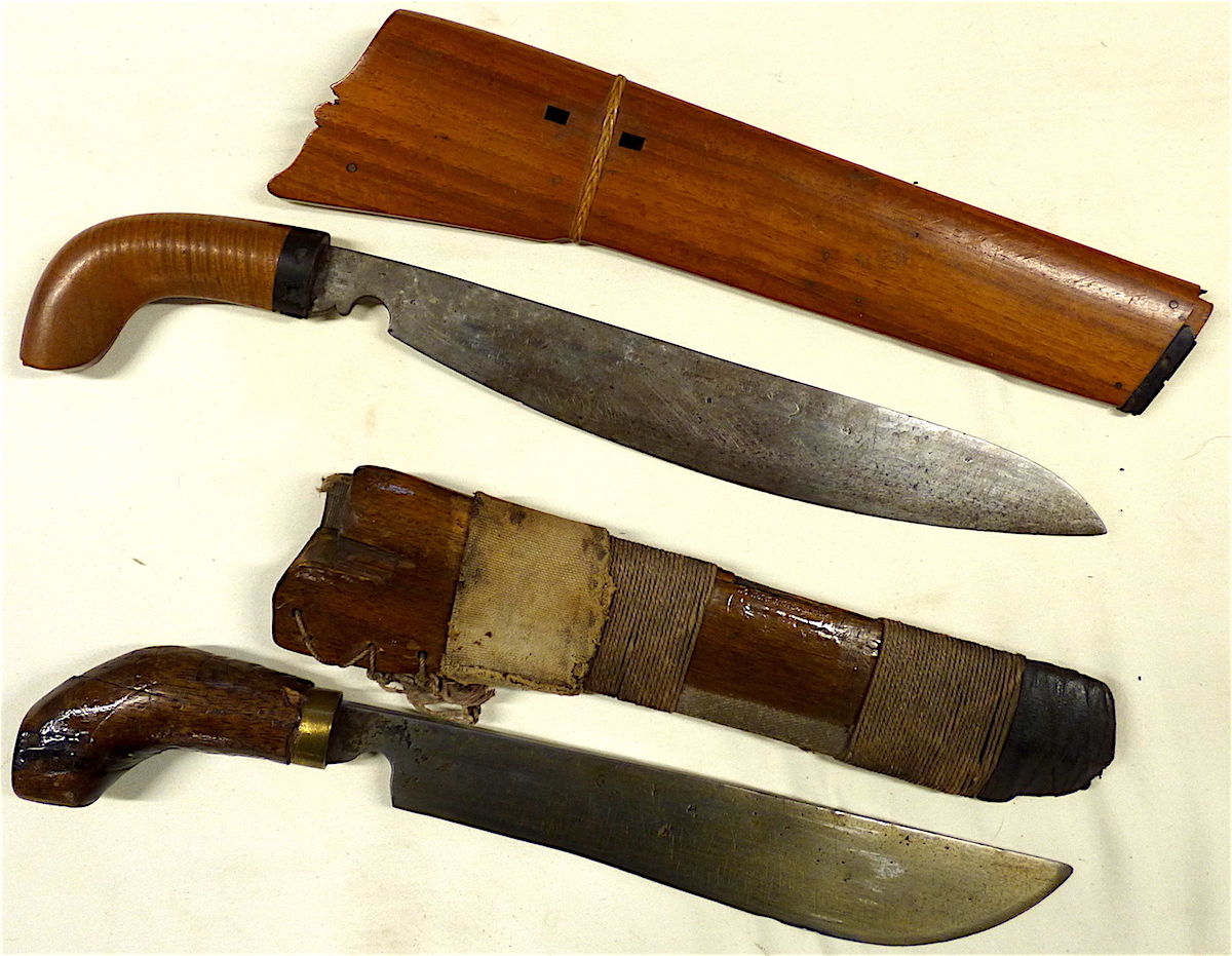

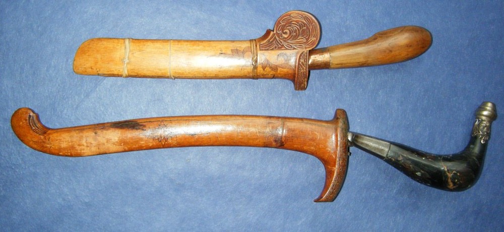

Here are two knives that resemble the description and line drawing of a Sulawesi bangkung in Albert van Zonneveld's book. The beaten up, lower example came from a GI who served in the Second World War and saw action in the Celebes.
This is very different from the Moro bangkung, being much smaller and more like a working knife, such as a small golok, rather than the Moro sword version.
Ian.
Two Sulawesi bangkung
Top example: Blade = 11 inches, OAL = 14 inches
Bottom example: Blade = 9.5 inches, OAL = 13 inches

Hi Ian,
I've ever thought that this are Malay goloks!?
Old 26th December 2017, 10:38 PM   #3
Posts: 7,416
I'm with you Detlef. I forgot about Zonneveld.
Old 26th December 2017, 11:02 PM   #4
Question
Hello Ian,
It does seem true that the word bangkung refers to somewhat medium-sized blades among the Bugis and other peoples from SW Sulawesi - I'm not sure if I really grasp the native definition(s) though? Could it possibly be a fairly broad/generic term resembling golok/bolo?
Like Detlef, I also hesitate to attribute these 2 examples to Sulawesi Selatan. Did this GI also "visit" other places throughout the archipelago, Ian?
It is possible that we do see some Bugis (in a wide sense) cultural influence here - it may be indirect though...

Hi Detlef:
The distinguishing features of the Sulawesi bangkung, as shown in van Zonneveld and the two examples above, appear to be the "finger notch" just in front of a very short, down-turned hilt. It is necessary for me to place my forefinger into the notch to hold the knife comfortably.
I do not recall any knives from Malaysia that have such a notch just below the hilt. If you are thinking of "Malay" in a more anthropolgical sense, then some of the knives from Sumba come to mind, as well as the Visayan plamingko and some Bugis badik that have similar notches or cut out areas in that position.

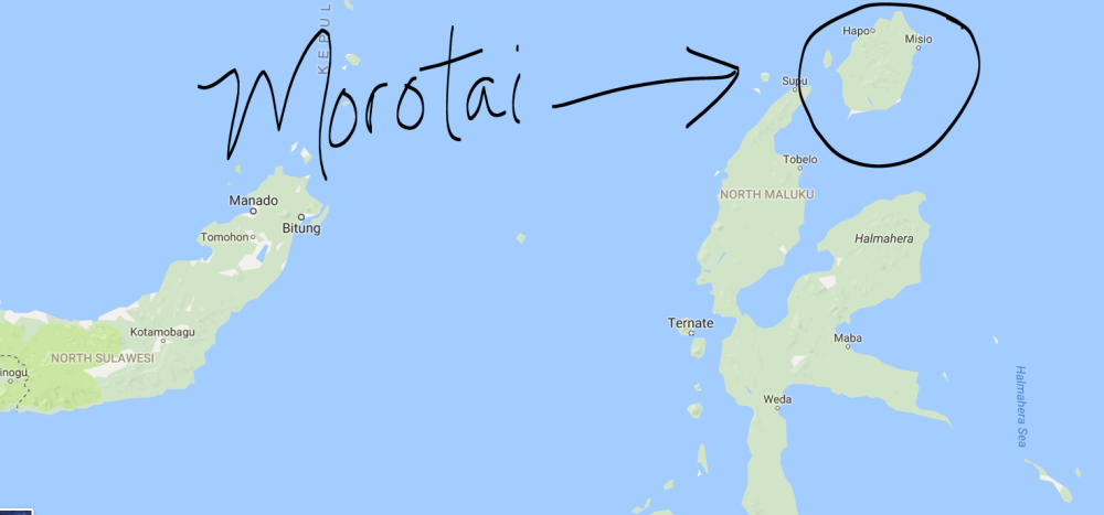

The gentleman who owned this knife served in the U.S. Army late in WW II. He enlisted in June, 1944 and saw action in the capture of Morotai (September 1944), a small island to the north-east of the Celebes, which served as a significant jumping off point for the invasion of the Philippines. He was later stationed in the Philippines after the Japanese surrender. He was discharged from the Army in 1946. He told me that he acquired the knife during his time on Morotai.
Hi Ian,

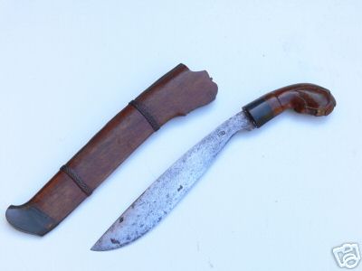

the finger notch is seen also by other short goloks and special by the short version "bedok" from Sunda so I am unsure if this could be called as distinguishing feature, see here: http://www.vikingsword.com/vb/showth...ighlight=golok
And we have only a drawing by Zonneveld.
Morotai is ethnologic the same like Halmahera and I have never heard about a great Bugis population over there, similar situation like on Halmahera which I know well. What you can find are a Javanese and Sundanese population.
And yes, I've meant Malay in the meaning of Malaysia and this for the scabbard form from your both examples.

Hello Ian,
Great, it's rare to have a reasonable provenance for ethnic blades!So, unless we discover any evidence to the contrary, I'm fine with accepting that your example was collected on Morotai during WW2.
As Detlef wrote, Morotai does not exactly belong to the Bugis sphere of influence - it's traditionally part of the Ternate Sultanate; this important sultanate's sphere of influence once extended over Maluku towards eastern Sulawesi but declined during the later colonial era; OTOH I'm not aware of any direct Sulawesi (much less Bugis) links nor trade with Morotai during the 20th century. Seems like more thorough research is needed here!

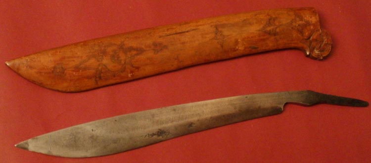

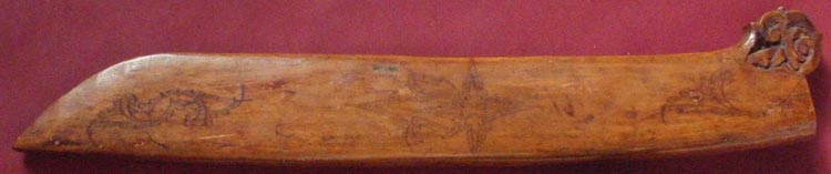

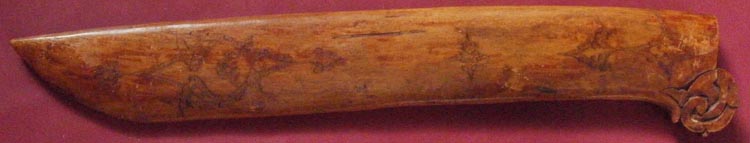

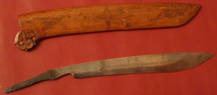

Hi All,
I picked up this knife a number of years ago. It doesn't have a hilt but does have a notch at the base of the blade. The designs on the sheath appear to have been made with pen and ink. There are designs on both sides of the sheath and the designs on one side differ from the designs on the other. Based on the designs, I had always suspected that the piece was peninsular Thai but after seeing this thread, I wonder if if it isn't a Sulawesi bankung. After all, the Bugis folks did get around. Blade (including tang) is 12" (30.5 cm) long.
Sincerely,
RobT

Hello Rob,
Thanks for posting this nice example! I've seen these from knife size to shortsword length with variable blade configurations.
This type is certainly Sumatran: I was going to post similar examples in a separate thread. The inked motifs on the scabbard of yours are of additional interest: This suggests a fairly northern origin! Could you please post close-ups to allow comparison with Aceh style motifs?

Hi All,
I will try to take better close-up photos of the sheath but it will need to wait till next weekend when I have enough light.
Sincerely,
RobT
