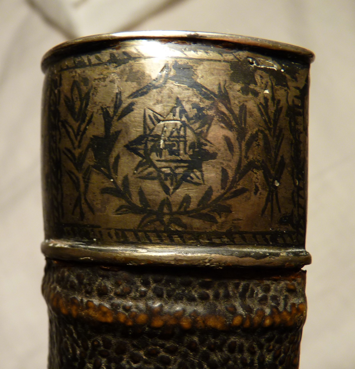

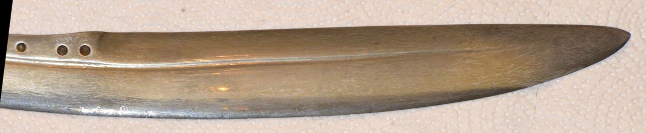

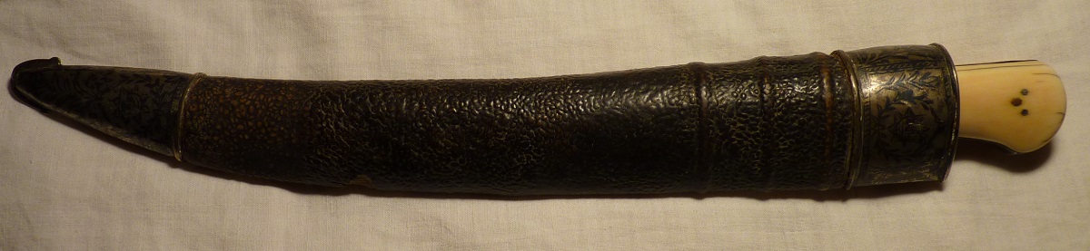

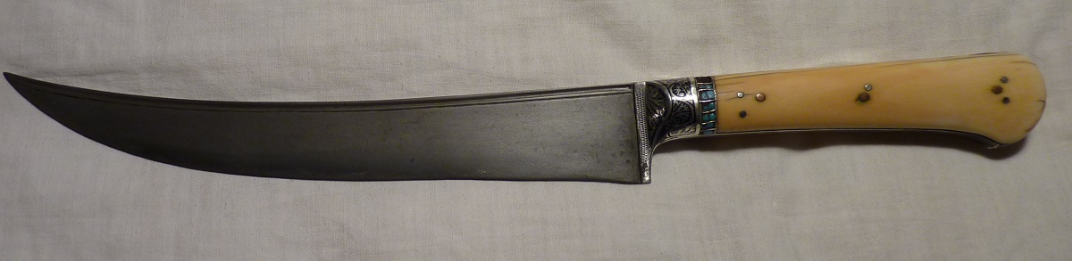

I have recently purchased this knife. Grip is ivory, blade looks like watered steel. The scabbard is leather with niello mounts. My resarch points towards it being from Uzbekistan, any comments on origin and age would be much appriciated.

It is indeed Uzbeki knife P’chak ( which means exactly what it is : a knife, Turkic dialect).
This variety with gradually narrowing blade and distinctly curved profile is usually generally referred to as “ old Bukhara” or “ old Khokhand” , and in Russian is usually called “ Afghanka” ( kind of feminine of Afghani).
The entire north of Afghanistan is populated mainly by Uzbeks and Tajiks, the latter being the second largest minority behind Pashtuns.
Please notice the nielloed coat of arms of Afghanistan, the Blue Mosque in Mazar -I- Sharif. This city is ~ 60% Tajik.
I think this P’chak actually comes from Afghanistan, made by an Uzbeki bladesmith for an Uzbeki owner.
Generally, the majority of Uzbeki knives have blades of two forms: Kaike, with the raised tip, and Tugri, with straight spine. The story goes that Tamerlane banned the manufacture of straight bladed variety to minimize their use as stabbing weapons.

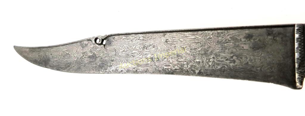

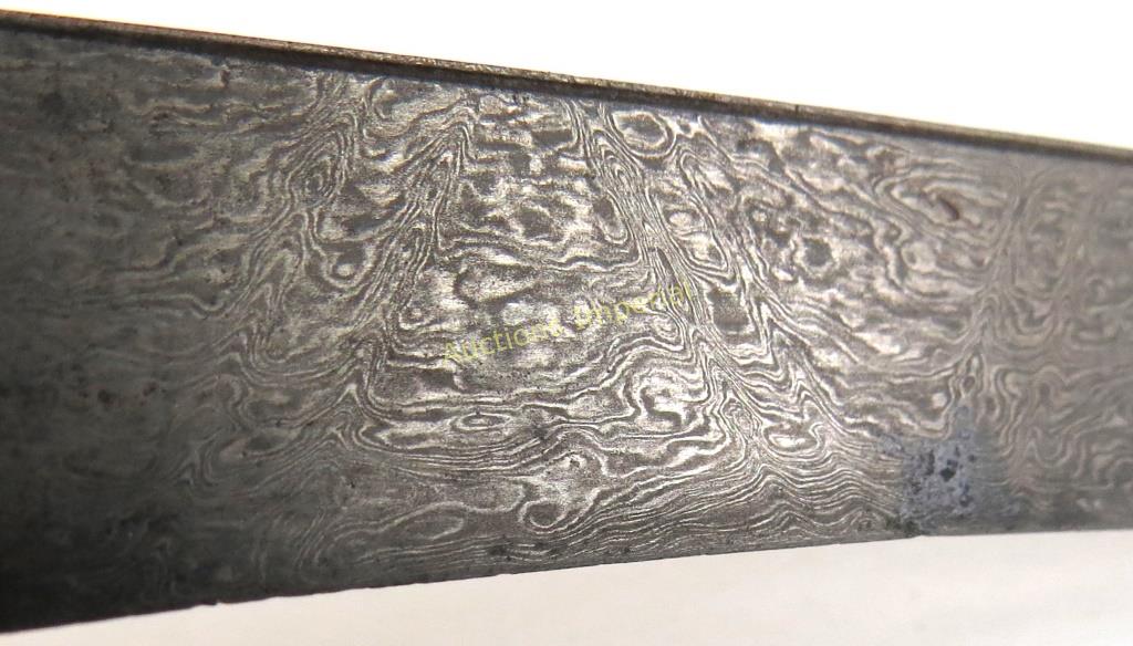

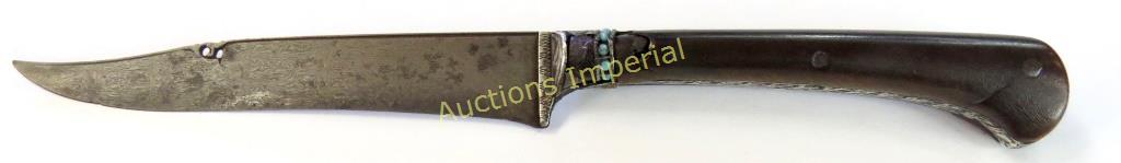

We had a very interesting Uzbek dagger from Bukhara in our last sale:
it is diminutive, probably made as a by-knife. The grips are rhino, the blade is pierced at the spine. But what is most unusual is the forging: it features a double-ladder step on one side and a zigzag double-ladder step on the other.

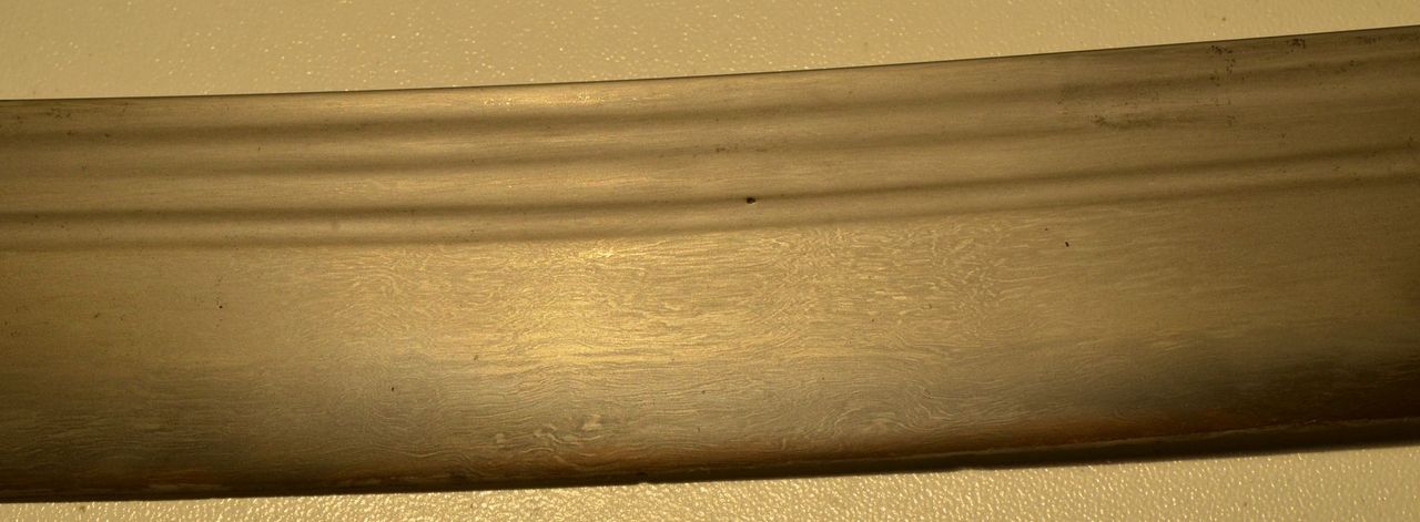

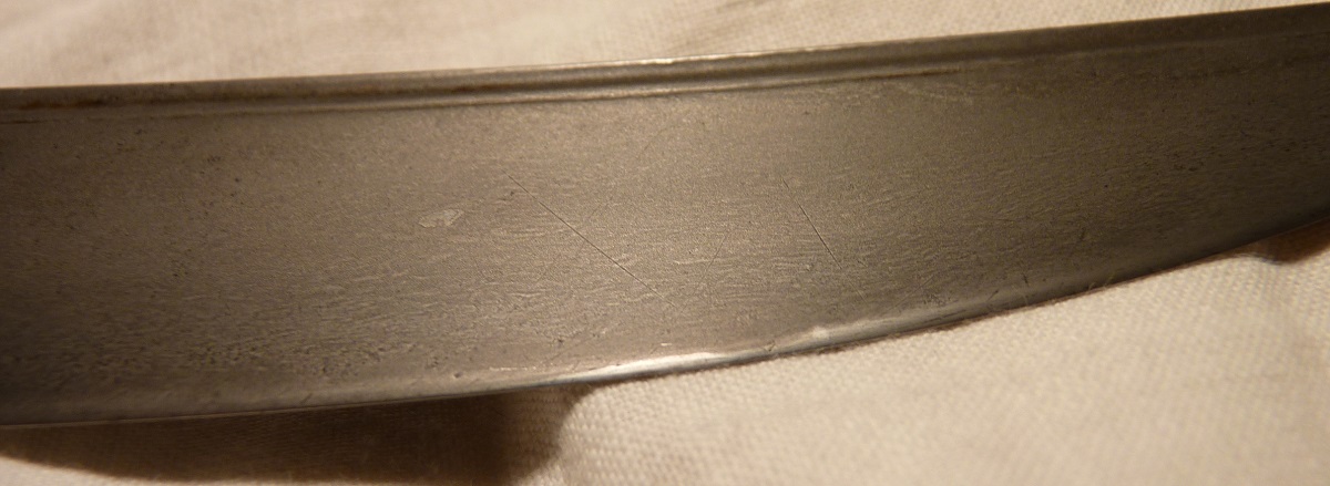

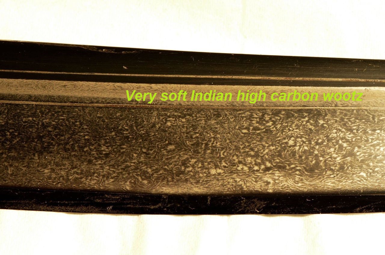

Here is a Kilij of the type, which you described, differential hardened, complex pattern on the sides of the sword but straight lines at the cutting edge.
Compared to my Indian wootz-tulwar, it is a difference between night and day, the Kilij would destroy the Tulwar within seconds. I can bend the Tulwar easily in the air between my hands, while the Kilij is too strong to straight out the blade over my knee.
BTW, the Tulwar with its ~2% carbon content is much easier to etch than the Kilij with ~1% carbon.
