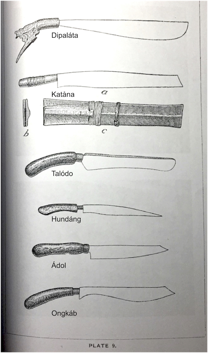

In a recent thread about "Negrito" knives and bolos we talked about some of the knives shown in a figure from Fox's article The Pinatubo Negrito (1947). Of particular note was the hundang and its distinctive wooden scabbard. This knife is a common weapon of the Negrito as well as a general utility knife.
Another recent thread provided information about the dipalata, a less common fighting knife used by the Negrito.
Another uncommon Negrito fighting knife is the katana, which is also pictured in Fox, figure 9 (see attached). The katana is a narrow bladed large knife/short sword with a distinctive blade profile and a tang set toward the back of the blade. The close similarity of the illustrated example of a katana in Fox and the more familiar Ilocano tabak is probably more than coincidental.
Although accomplished smiths, the Negritos have been a longstanding iron poor culture, with the result that they acquired iron and iron objects (including blades) from neighboring ethnic groups. This is mentioned specifically by Fox. It seems very likely that the Negrito katana is adapted from, and in some cases is actually, an Ilocano tabak.
To illustrate this more fully, two Ilocano tabak are shown below the figure from Fox. The two characteristically Ilocano hilts on these knives differ from the one illustrated by Fox, which is a more traditional Spanish-style three part hilt. It appears that the Negrito katana and the Ilocano tabak are essentially the same knife, and it is quite possible that the Negrito knives were tabak blades acquired from the neighboring Ilocano.

Could be Detlef. However, Fox has made one mistake in this figure and labeled the dipalata as a katana and vice versa. It is possible that he made another mistake about the scabbard for the katana--which looks from his drawing to be very similar to that of the hundang in the examples we have found.

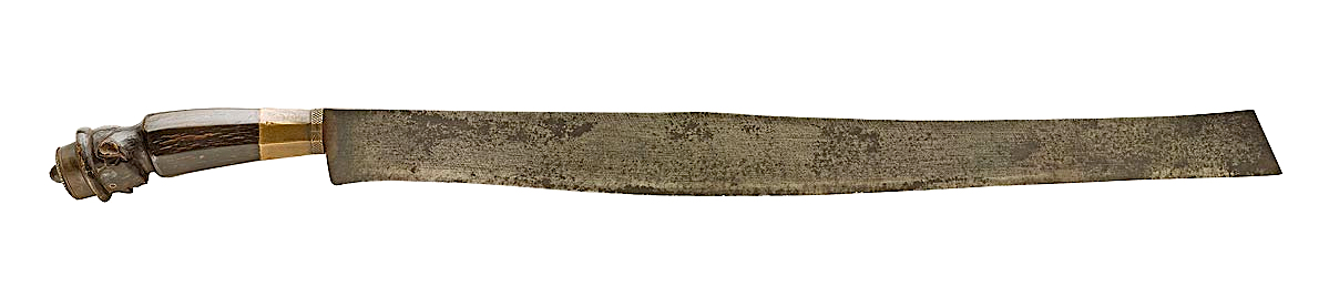

I was at a gun show here in Minnesota a couple of weeks ago and came across another example of this sword form. This one has a horn grip with brass ferrules, and the blade has the usual "Negrito katana" shape. The photograph shows the "as found" state of this one, with a heavily patinated blade. I would say probably mid-20th C. Could be Ilocano or Pampangan in manufacture--the hilt on this one looks more Tagalog than Ilocano in style.
Old 20th November 2017, 03:53 AM   #10
Posts: 7,415
For clarity sake, what for you makes the hilt more Tagalog than Ilocano?
