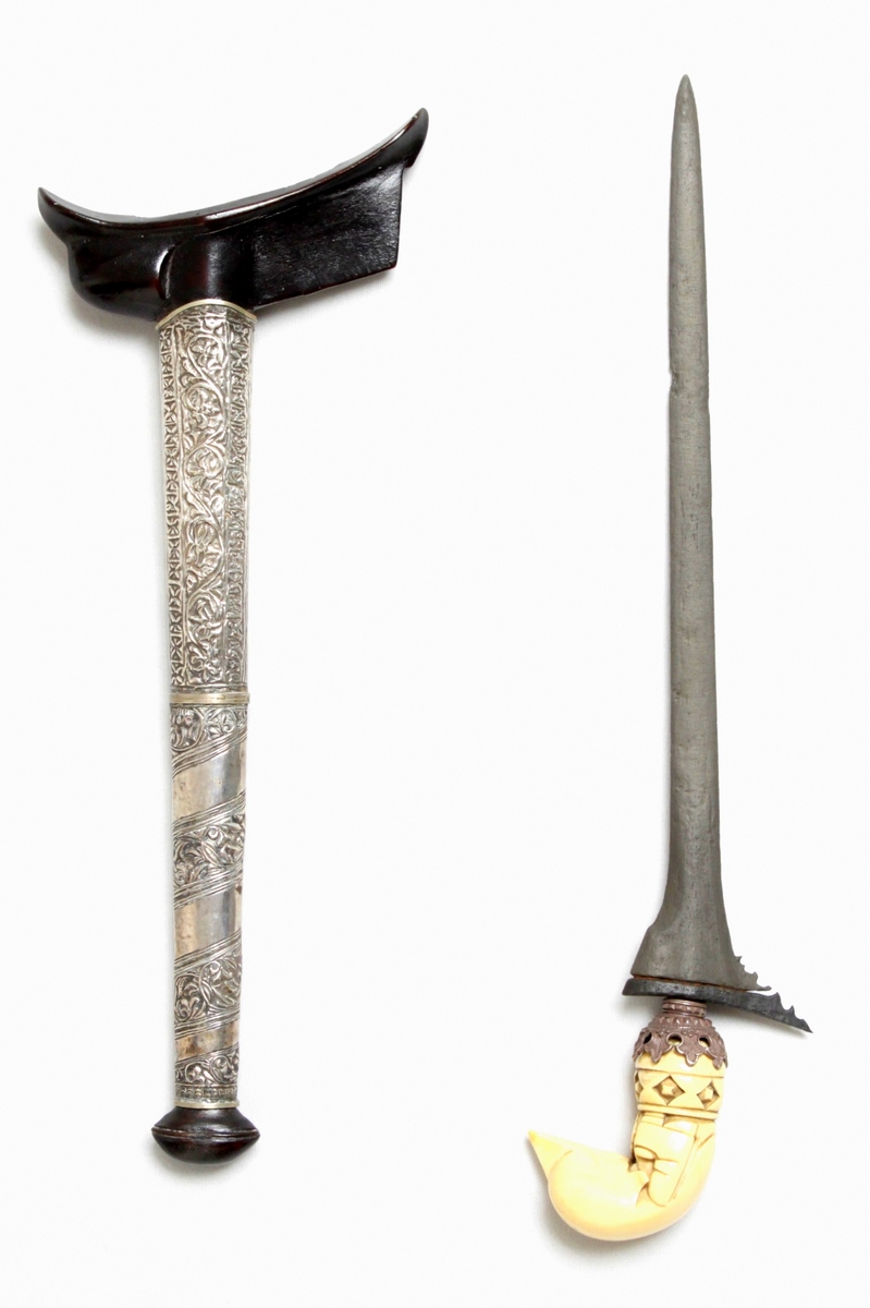

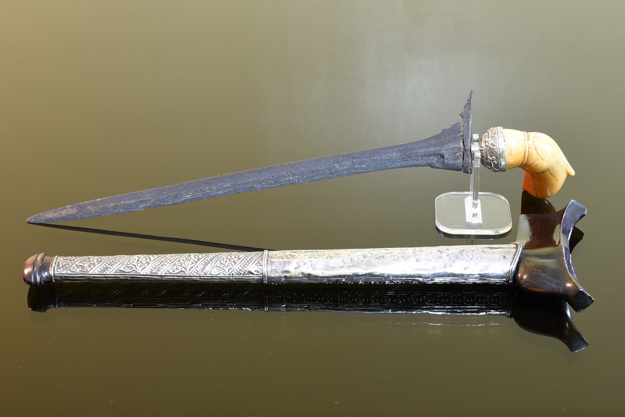

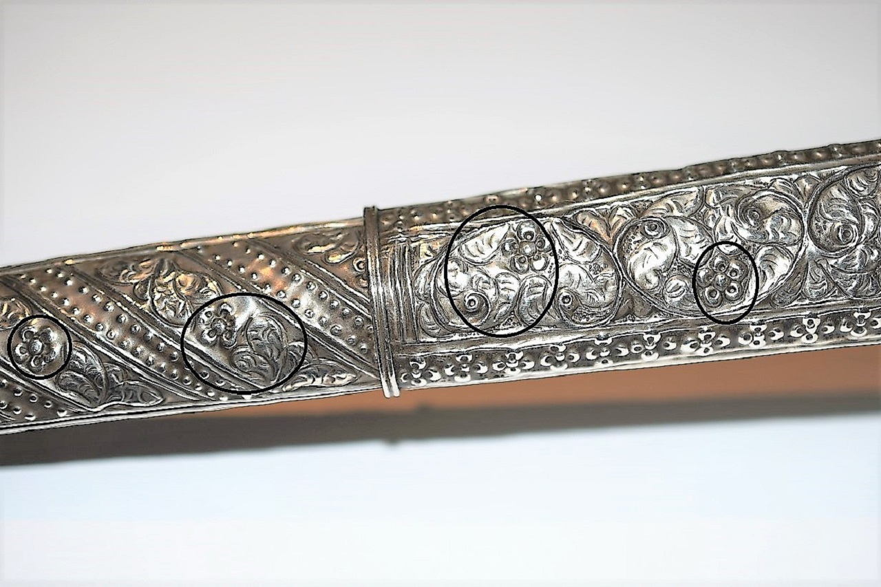

Hello! This is my keris. The blade is 31 cm long and 1.5 cm wide at the center. The hilt is some kind of ivory, the hilt cup and pendok are made of silver, and the sampir and buntut are made of horn. Is it Sumatran? Also, is it possible to tell its age based on the features?
According to the dealer, it was likely brought to the US at the turn of the 20th century.
Your insights would be greatly appreciated. Thank you.

Hello Fernando,
<snip>
Any more concrete evidence on its provenance in the US?
It's always tough to evaluate bits of info given by (many) dealers...
The blade is 31 cm long and 1.5 cm wide at the centre
This Bangkinang blade does look Sumatran, indeed. It has lost too many details to allow for a more critical appraisal though. If it has been cared for in a western collection for over 100 years, the blade could easily be from the 18th century; blades that came out of Indonesia more recently, can exhibit similar erosion and be much younger (including artificially aged new blades).

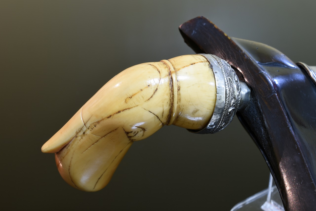

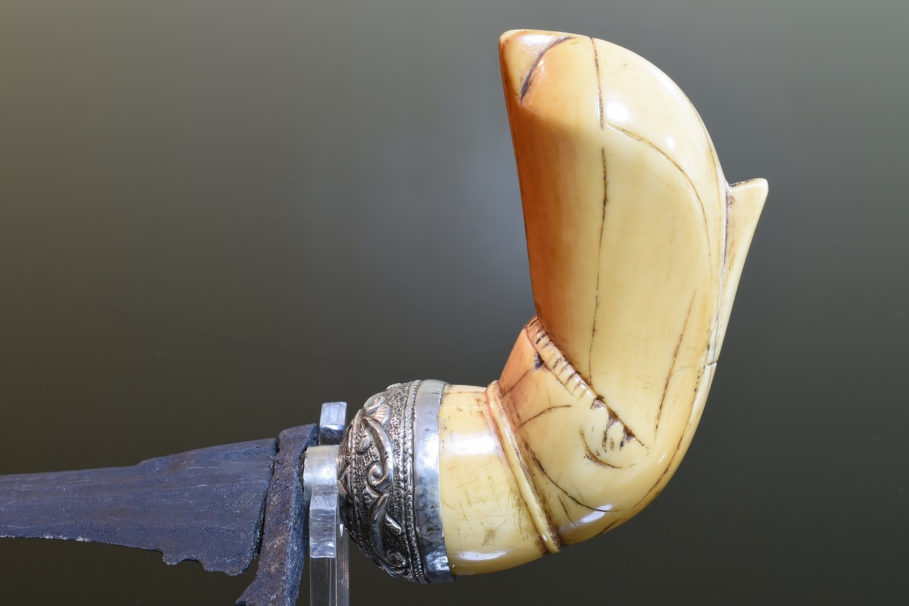

The hilt clearly is from Hippo ivory. The style is typical for south(west)ern Sulawesi ("Bugis"); it is also not rarely found with keris from several Sumatran regions. I know of no data whether these got crafted locally or traded from Sulawesi - probably a moot point with so many Bugis/Makassar expats and traders living there and heavily influencing the whole region.

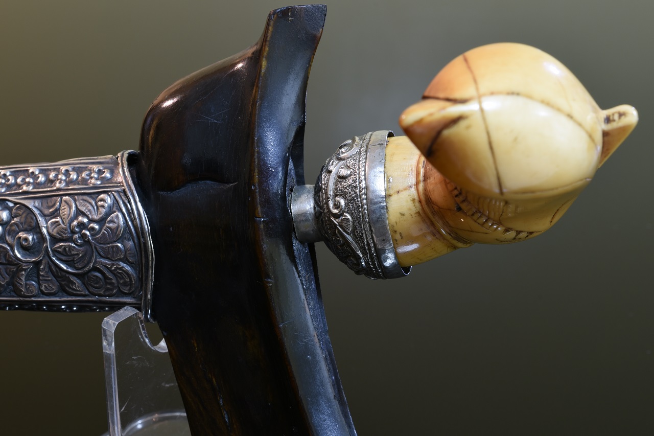

Both appear to be too wide: The pendokok/selut clearly is too large and was not crafted for this hilt; IMHO it also covers too much of the bungkul (rounded base of the hilt). An easy fix would be to ask a silversmith to turn the plain rim over (to the inside - this will make the rim less tall and diameter more narrow). It might be a shame to change a genuine pendokok if it really was antique; however, it does not appear to be a high-end example. The ensemble would look much better IMVHO...
In a similar vein, the upper part of the pendok appears to have a too wide opening for the base of the sampir and both probably were not crafted to suit each other.
I've seen similar buntut examples from the region. The sampir seems to have some age which could be consistent with it being antique; not surprisingly, it seems to be considerably younger than the blade. The fit is not terribly good - can you discern any hints that it wasn't made for this blade (wear, movement, etc.)?
I'm not convinced that this whole ensemble is original - however, keris bits and pieces have been swapped around for ages, especially on Sumatra with its many neighbouring cultures. Anyway, with a little effort, it probably can gain an even nicer look though!

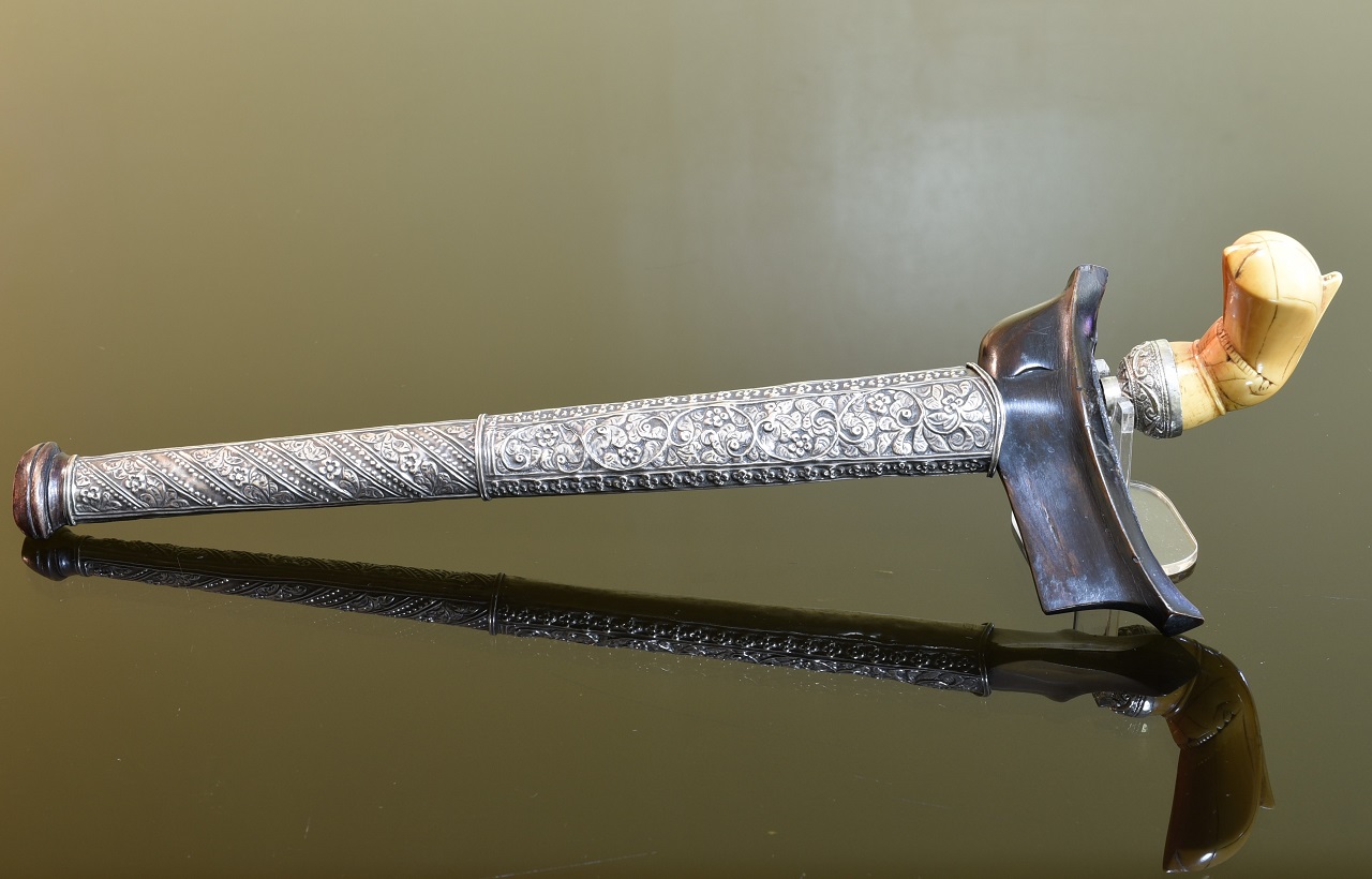

Thank you for your insights, Kai!
The sampir is currently detached which may account for the poor fit of the pendok in the picture. Also, the sampir seems to have been made for the keris for it follows the profile of the ganja and there is no movement when sheathed.
I'll put a little Elmer's glue on the sampir and post pictures soon.

Btw, I had the same impression of the pendokok when I saw it in pictures however, it really looks so much better in person.

I mostly agree with Kai on his assessment here. I think that you are probably right about the sarong having a better look once you have re-glued it together.
The blade seems to be at least 19th century and could very well be older.
As for the pendokok, while it might appear to be of a better quality in person it is still too large for this particular hilt and looks a bit odd. I would not, however, have a silversmith mess with it. Better, i believe, to simply find a new silver pendokok of good quality that fits properly.

Hello Fernando,
The opening seems too wide (and there also is an unusual "step" between the 2 parts of the pendok) - still, this might either point towards recycling of materials (which always was common practise) or less-than-perfect fitting (also not unheard of though more common with sub-average pieces).
The gonjo sinks in too deeply for a keris dressed in general Malay style and the pretty "steep" angle it sits inside also makes me believe the sampir may not have been carved for this blade. Of course, this may also result from the loose sampir...
I'm glad to hear that! If it really is old, it certainly should not be messed with.
Antique quality pendokok from silver are tough to find! It may be a better strategy to opt for a brass/bronze pendokok of generic Bugis style - should be much easier to find in the correct size...
Kai, i never said anything about replacing it with an antique quality silver pendokok. But one can find new ones of good quality fairly easily i believe.

True, David, if the current one proved to be not that old it wouldn't hurt to exchange it with a nicely fitting newer one...

Well, IMHO it wouldn't hurt either way. I'm not saying to throw the present pendokok away. Swapping out a better fitted piece does not do any damage to the ensemble in any way. If one feels at a later date that the "original" pendokok was more appropriate it can always be put back in place.

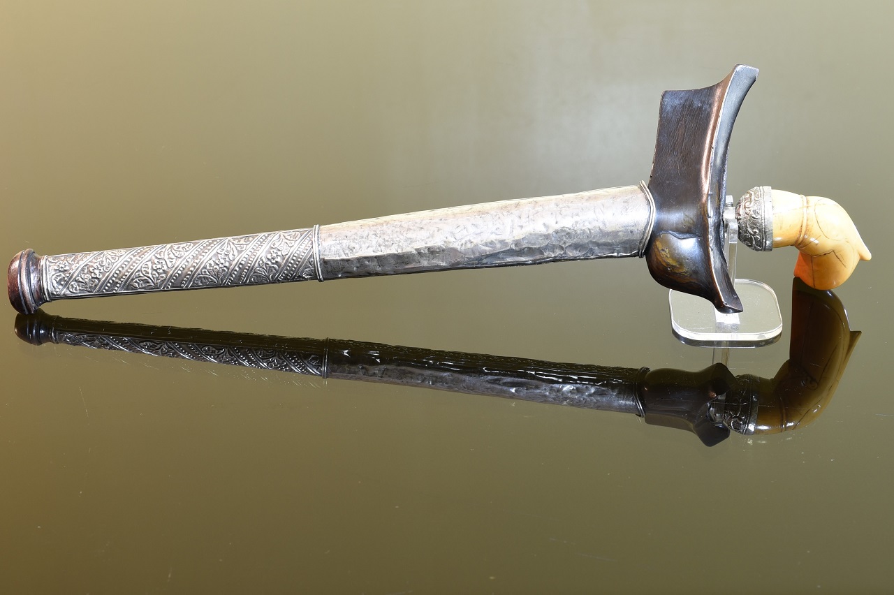

Thank you all for your comments. I appreciate the time you spared to share your observations and insights. I learned some more about the keris and culture from the discussion.

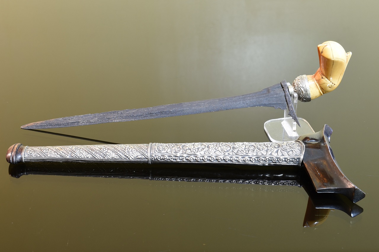

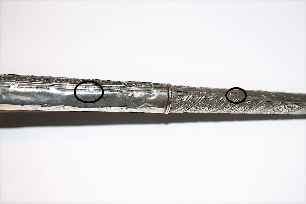

For now, I intend to leave this keris as found. It is unfortunate that there is little information on its provenance. I purchased it from a Massachusetts based antique dealer who said that, "it came out of a lot of knives with the majority of them being from the Philippines and came back from the Philippine American War of 1899-1902." I asked for additional information but have not received a reply.
Anyway, below are additional pictures. The first shows details of the sheath construction. In the second, I highlighted matching details of the upper and lower parts of the the pendok. The third and fourth are just additional front and back views. The last is a photo of a print showing a similar sheath (back view).

Frankly Fernando, if it were mine i would probably take the same path, even if i agree with Kai that the pendokok does not quite fit the hilt properly. As Alan points out, we do not live in a world of perfection. If it could be shown through provenance that this was a recent addition by the dealer i might think differently, but in the absence of further information i believe you have a reasonably nice example of an old Sumatran Anak Alang (or Bahari if it is actually shorter than i perceive).

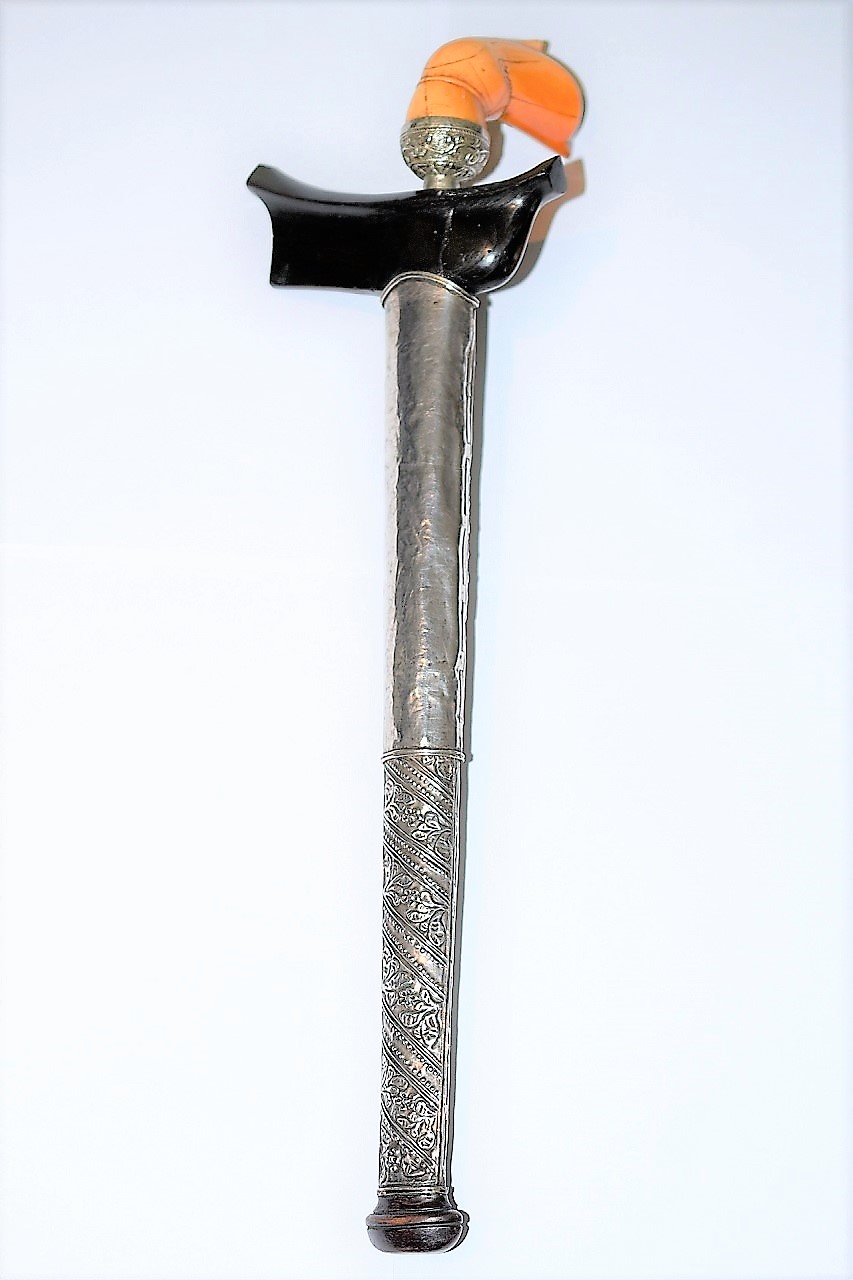

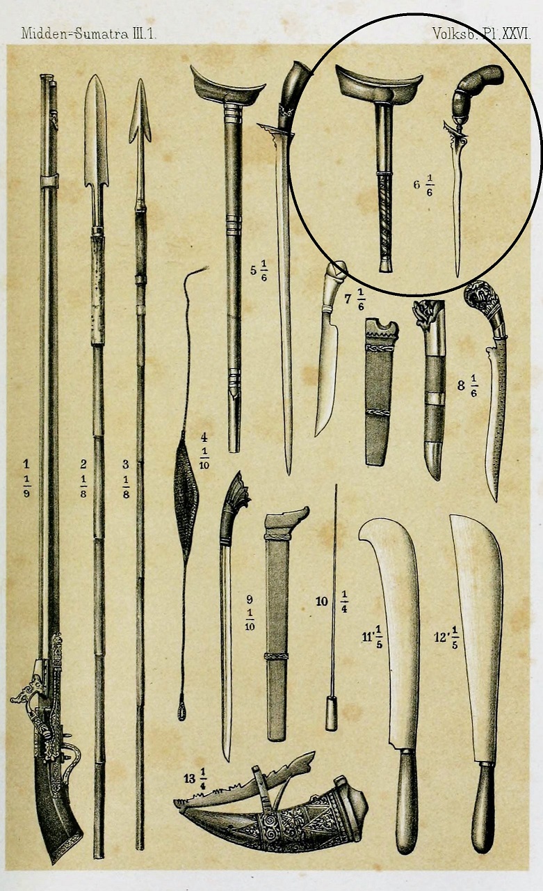

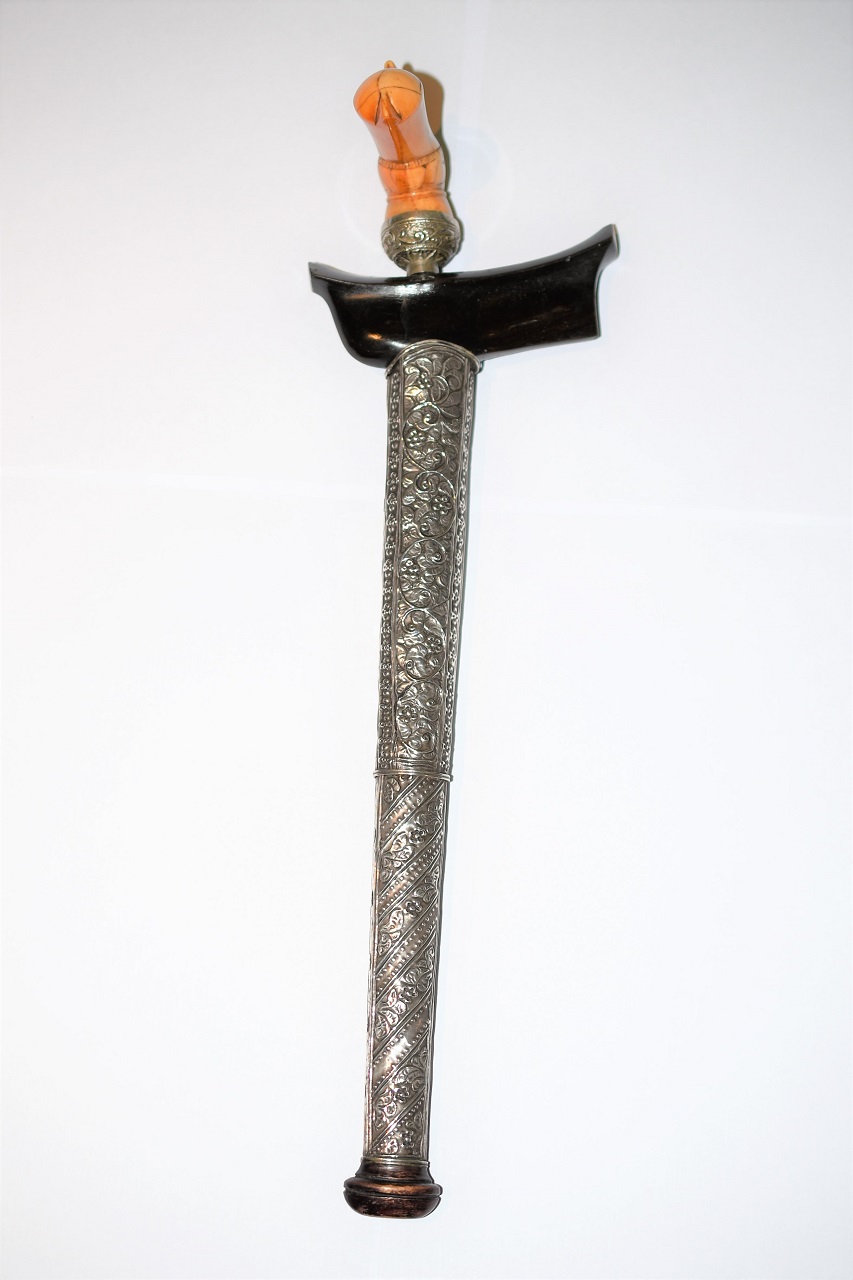

I don't think that your blade was artificially aged but it looks older than the dress (pendok and pendokok especially).
I attach a pic of a similar kris from my collection bought in Medan (North Sumatra) in 1996 and originally fitted with an ivory Bugis hilt.
