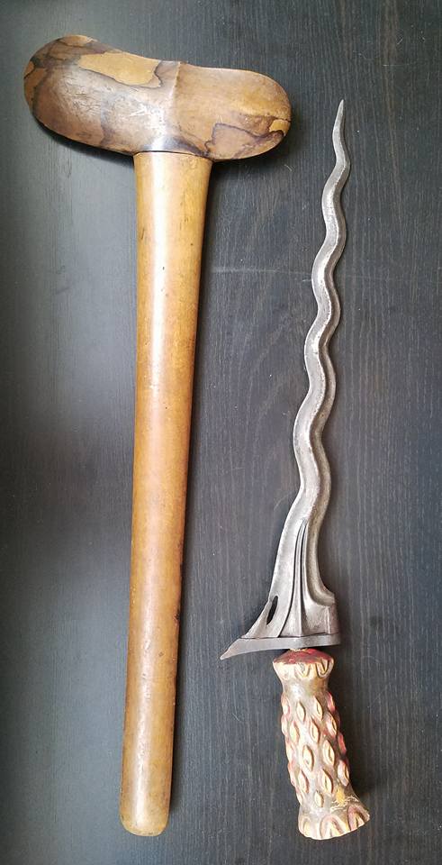

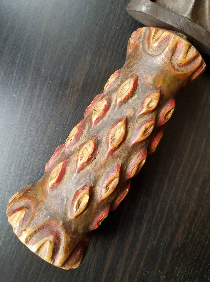

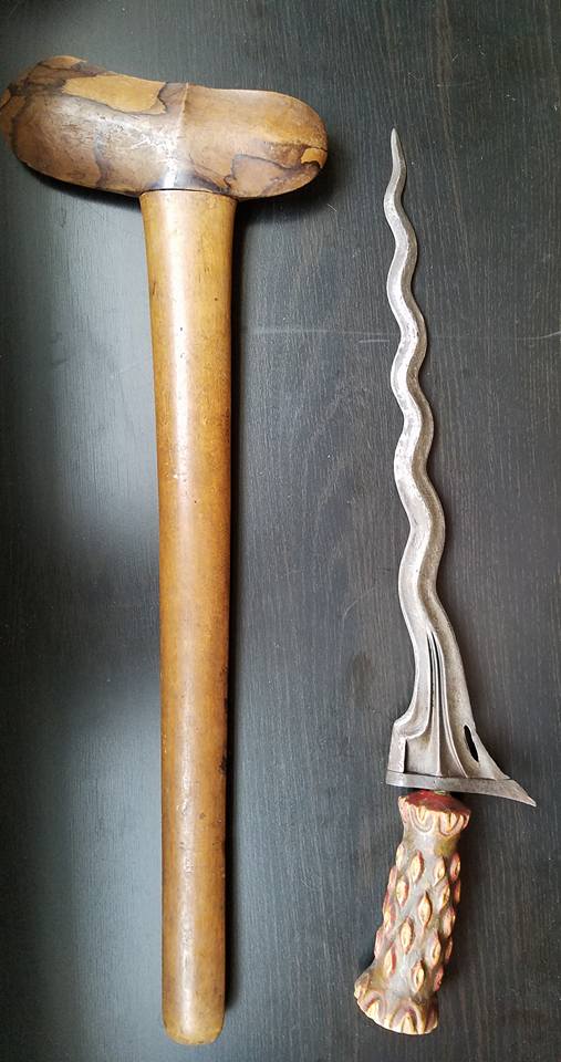

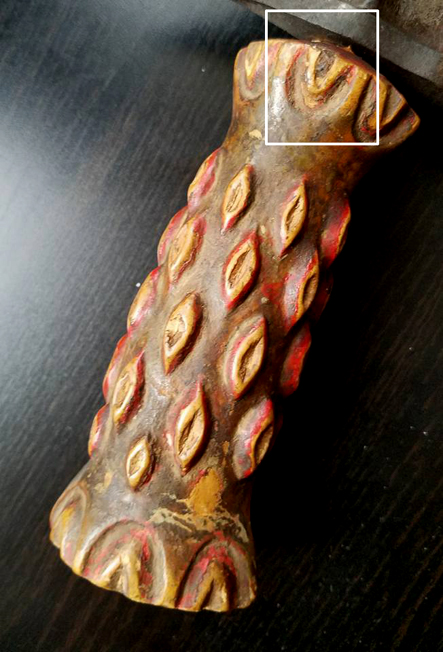

Hello All,
I've been meaning to post photos of this one for a while.I finally got around to taking some today.

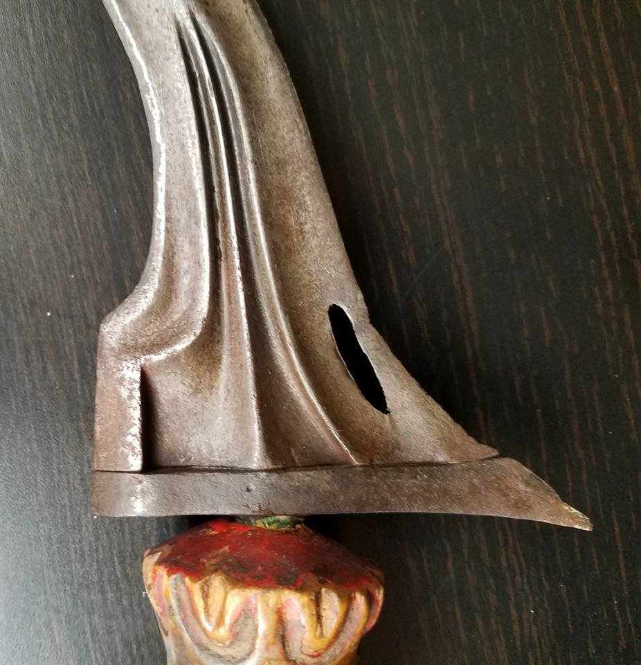

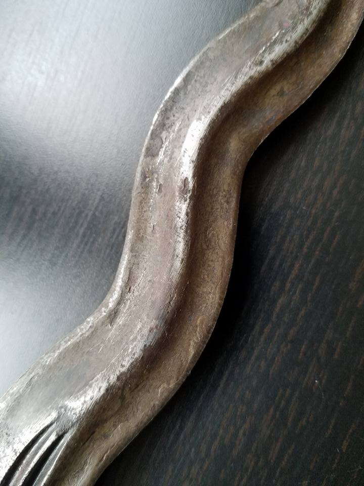

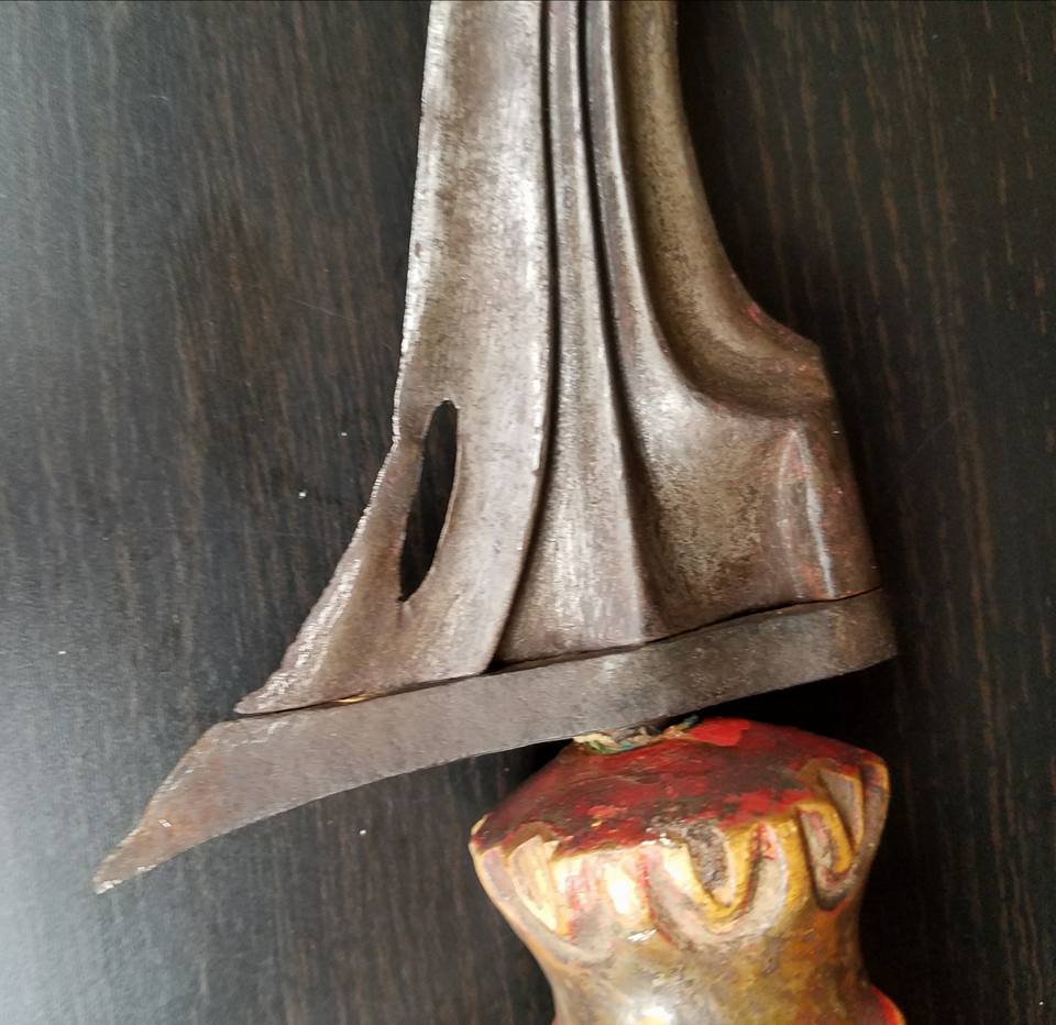

I suspect this Keris from Bali has some real age. A hole has been worn through, I suspect from repeated washings. I believe there's a superstition about holes like this, something about how if you gaze at something through the hole you're supposed to receive it. When I received it in the mail, I immediately looked at my kitchen. I'll let you decide what that says about me. Beyond this, the blade is thick and has well defined features.
I've only seen this style of hilt a handful of times. A similar one shows up on page 103 of Kris Gli Invincibili, and perhaps in another book (Maybe Frey, but I've not had much luck finding it). The below webpage says this style is "Cecanginan" and a search through the archives finds one posting. I suspect that the protrusions once had stones in them. One of them may have been shaved off.
http://old.blades.free.fr/keris/intr...kiran_bali.htm
And here
http://www.vikingsword.com/vb/showth...ght=Cecanginan
It could probably use a uwer. I actually had purchase one, but it got lost in the mail. Maybe it's a sign.
Anyway, what do people think? Any examples of similar hilt's I've missed?
As always I'm happy to hear any and all thoughts and opinions.
Thanks,
Leif

The hilt name is probably more correct given as "cenangan".
It is not usual for Balinese people to wash their keris, as is done in Jawa, periodically they polish them with powdered limestone, then restain with warangan. The hole in the wadidang would have been worn through, not eroded away.
Actually, the name "cenangan", and its variations don't make a lot of sense to me, because the part of a Balinese keris hilt that is normally gripped is called "cenang", that is to say, the part of the hilt between what we would call the pommel, and the swelling that prevents the hand slipping forward when wet with blood.
The Australian artist Donald Friend lived in Bali for an extended period, and during his stay there he collected a very large Balinese keris with one of these hilts. Eventually it finished up in an Australian collection.
That hole is not a "combong" (or complong, compong) it is just a hole, no special name.
A combong occurs in the actual body of the keris, normally where a weld joint has not come together, usually this is accidental, but the really highly valued combong is the one that has been intentionally made for talismanic effect.
A good combong is highly valued for its power in securing the affections of beautiful women, however, like any talisman, it only has an effect when you truly believe it will. Maybe all one needs is self confidence.

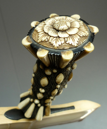

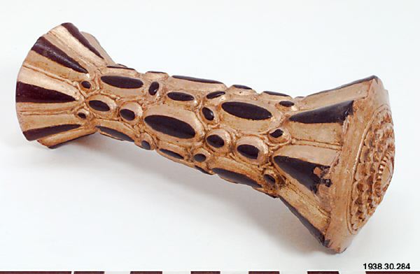

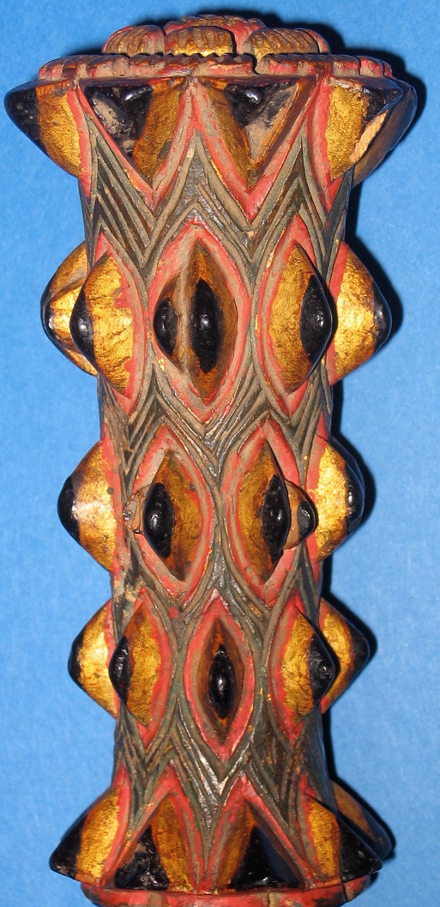

Leif, my very first keris was a rather old Javanese blade that had a hole worn through one of the sogokan. I also had a few people that identified this as "complong" but the truth of the matter is that true complong is as Alan described and not merely a hole worn through a blade from excessive age. It took be a little while before i understood that and currently in the keris world i believe there are many people who think these simple wear holes are complong. I believe this was probably started by dubious dealers who hoped to encourage sales on some of the more worn out items they had in stock. Unfortunately, like many misconceptions about keris in the marketplace, this one has gained some traction so i have encountered this misunderstanding of complong operating within numerous keris collecting communities.
About your Cecanginan hilt, i have attached a few more examples i found on the internet. I've chosen to use your spelling here not because i believe Alan is incorrect (i generally would defer to his opinion on such language issues), but simply because i could not find many hilts of this type using the "cenangan" spelling in my searches. It seems that you will find some with relatively smooth sides under that spelling, but not this specific bumpy version you show here.
I doubt that yours ever held stones in the little divots on your bumps. They don't look like settings to me and i don't think i've ever seen this form with stones set in the bumps before anyway.

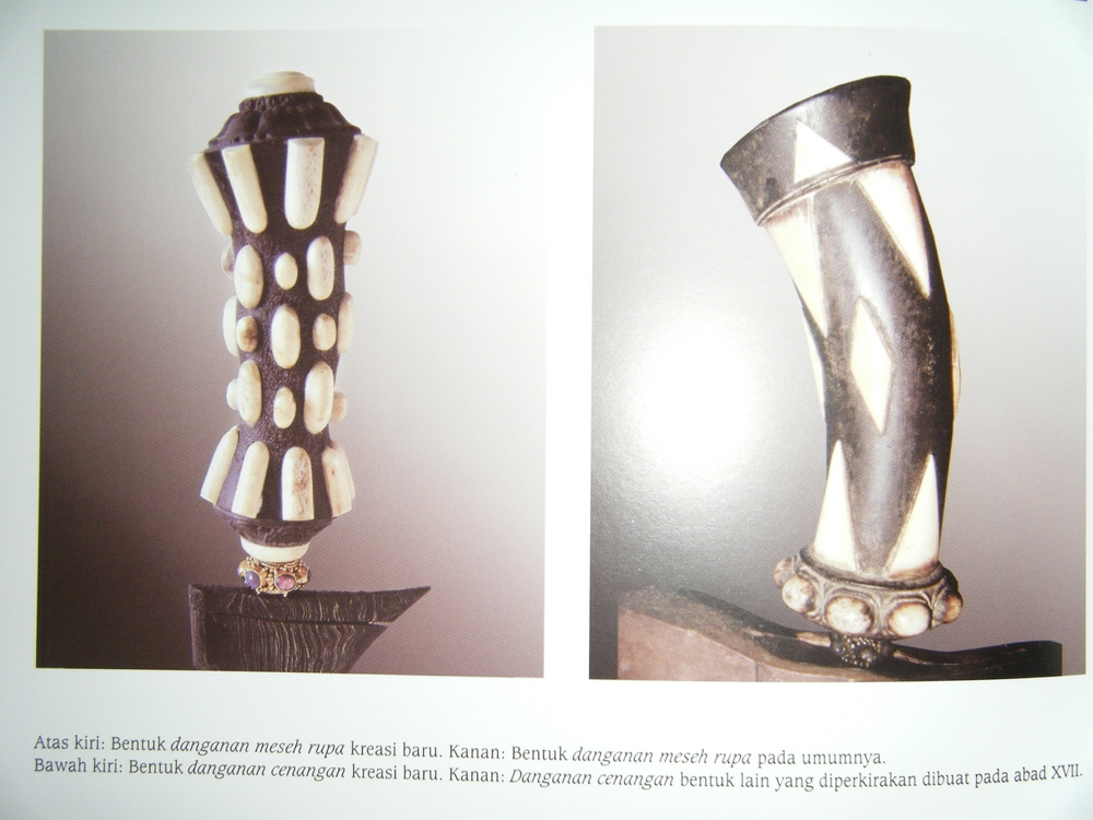

David, those pics you have posted are examples of old and new renditions of the same hilt style.
Once you get these little bumps you have the hilt style, the differences in spelling, or in pronunciation, do not indicate differences or shades of difference in the hilt style, its still the same hilt style, the only difference is in the way the informant gave the information.
Thanks Alan. I am completely aware of that. Leif asked for examples of similar hilts so i obliged.

Apart from the discussed name CENANGAN I have come across other (local) names as JAMPAKA - CAMPAKA - TJANGING - CANGIN - CANKRING - CECANGINAN - KAKI KUDA.
The last one is personally best known for this kind of handle.
But let's enjoy the beauty of it being inspired by nature: a thorny plant branch and a (lotus) flower on top.
The polychromic examples seems to be the oldest types.
Here are some others (the B/W are best known). Materials used can vary a lot.
The one with the whitish flower (seen from above) is from my one collection, others from the internet.
Leif: the little divots in the bumps could have had a filling as the square in the reproduced pic indicates.

Alan, you are as always a wealth of knowledge! Thank you both for clarifying on cenangan and on combong. You are an asset to this community.
Believe, especially when there are a number of believers, does have a certain power doesn't it? Whether in the very real placebo effect, or in how many fortunes are made or lost every day any stock market.
Thanks to both David and to Paul for providing more pics. Is it safe to say that this isn't a very common hilt style?

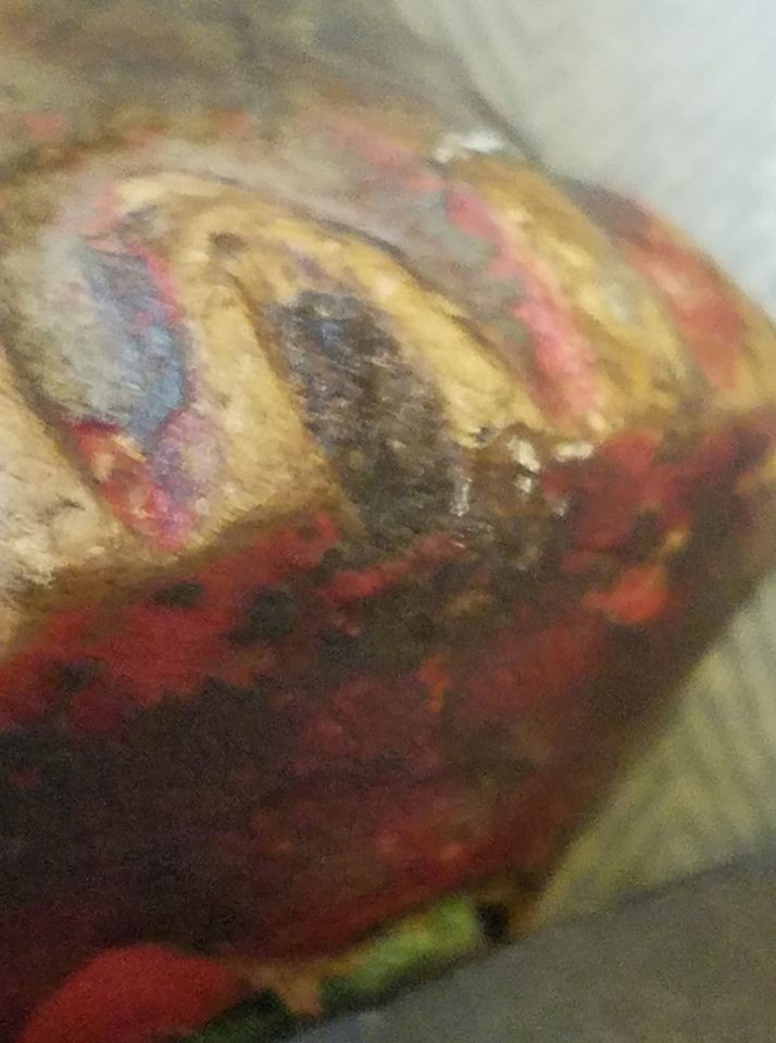

Paul, Yes! You're absolutely right! There is one with residual filling! I can't believe I missed this.

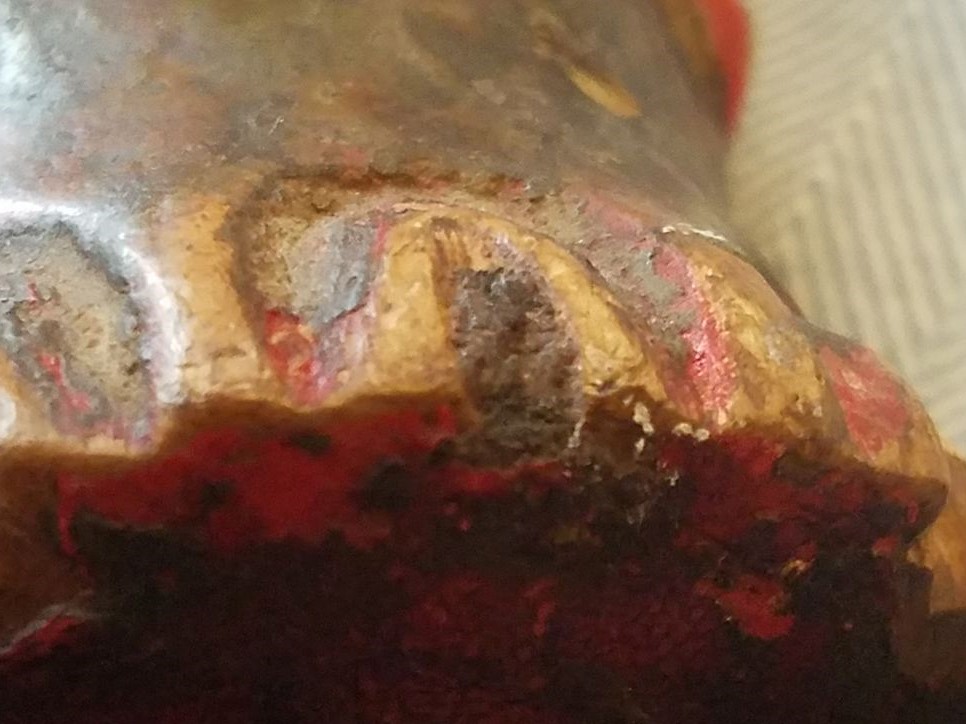

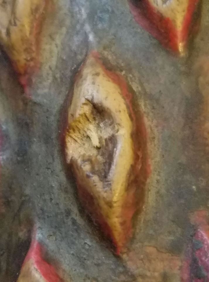

I tried to take a few close up photos of this, and a few others were there's residual filling. It looks a bit like a blackish? resin of some kind. Almost like a wax. A black filling would fit with the aesthetic of the other examples.
Anyone have any clue what it might be? I'm wondering it it's restorable.
Thanks!
Leif

I just found another example, one from Krisdisk, Page 5, Chapter 7. The full keris is on page 22
He says of it:
"A special variation of the wooden cylinder type is the Cecanginan/Danganan Tjanging hilt. Its name refers to Tjanging trunk, where the thorns have been chopped off. It may be a very old type of hilt as it seems to be mentioned in connection with Ken Arok ( first part of the 13th century)."
However, I'm given to understand that Jensen's words are to be taken with a grain of salt.
I wonder if the original aesthetic of mine was a bit like this, with the black tips.
Probably cutler's resin, at least from what can be seen in the older hilt. This mix should be much harder (after cooling down) than wax to take a polish and prove robust enough. If the remnants are wax-like it might be a later attempt to cosmetically fill the holes with hard wax as usual with antique furniture.

Balinese decorative art is all about effect. These indentations could have had anything inserted. Gemstones, even low grade ones I think would be unlikely, but glass, or scraps of gold foil would be quite likely.

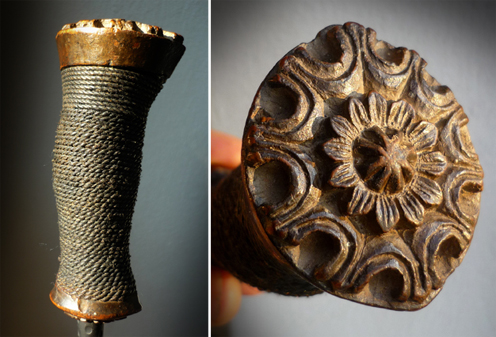

What's local...maybe skip that word and call it alternative names. Names given to it in different parts of Indonesian areas / islands.
Here another example in my collection, the one we all know wrapped around with cord (sometimes hair) but the flower on top makes it less common.
These are usually asociated with a walikat dress?
