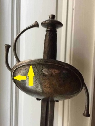

I would be grateful for any comments on this sword which looks like a Spanish espada de conchas although it was found in Italy. The sword’s overall length is 108cm, with the blade 91,5cm long and 2.5cm wide at the forte. The grip is covered in brown leather. The S-shaped quillons and knuckle guard have characteristic trumpet like ends, which is repeated on the pinhead shaped pommel. Both sides of the ricasso are stamped with a cartouche containing what appears to be a fleur-de-lis under a crown, which is supposedly the mark of Juan Martinez of Toledo. The sword is fairly plain but has a decorated guarda de polvo at the bottom of the conchas. The blade is fairly wide and flexible, with a rounded tip. It has a distinctive central fuller. Could it be a Solingen copy of a Toledo blade?

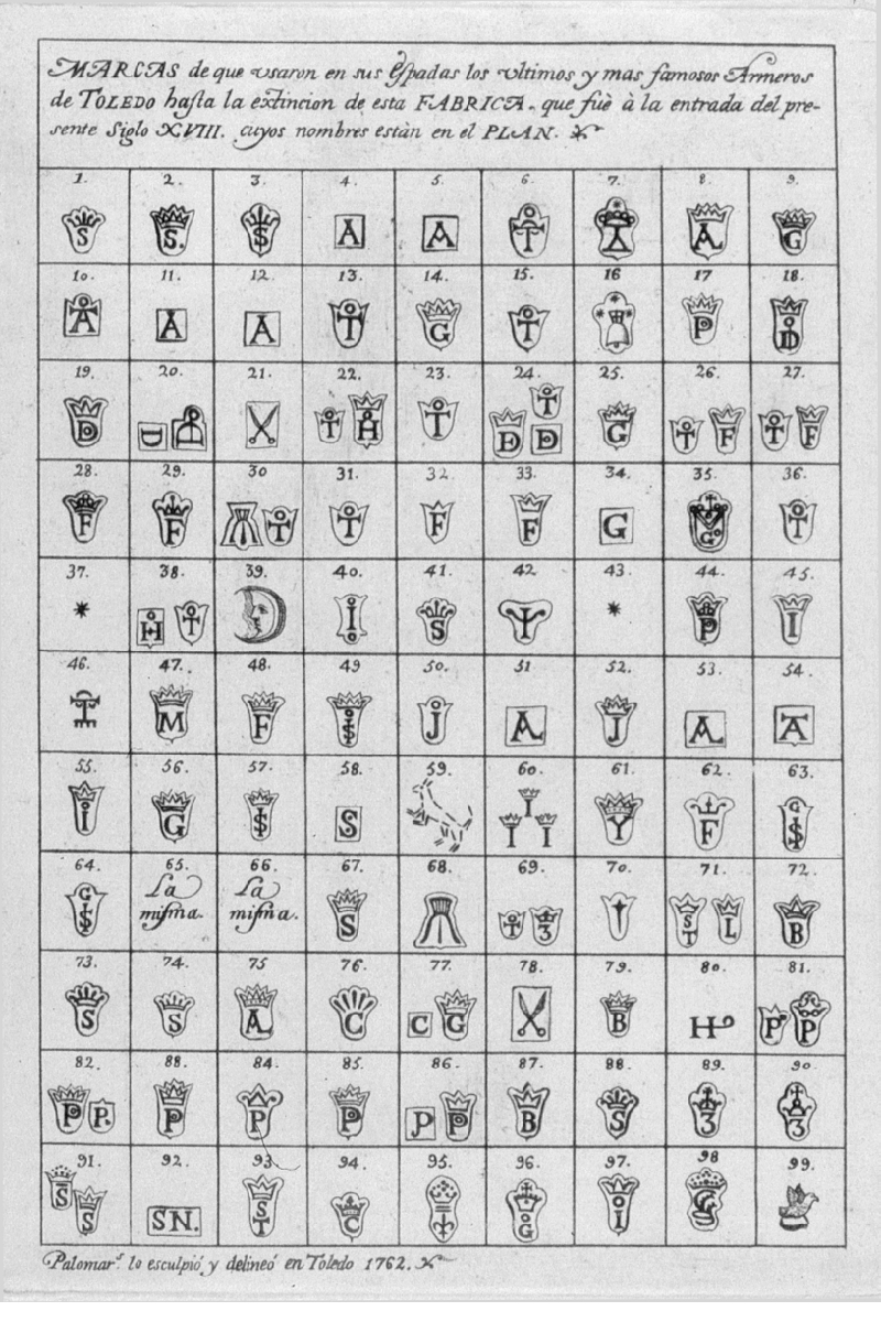

By the way, you certainly have a copy of the Palomares Nomina; a work on the marks and names of Toledo sword smiths ...

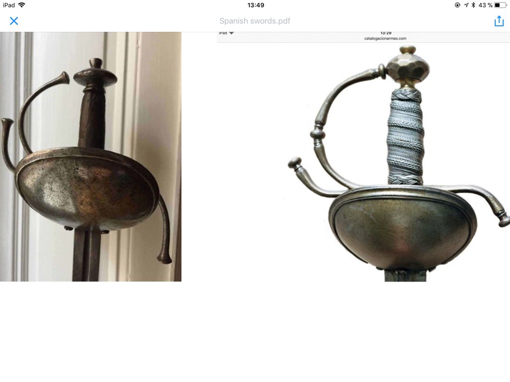

Same, but different?
Old 5th December 2017, 03:04 PM   #7
Both atypical, in any case. The example you selected from Calvó's work is mentioned as having details of extreme sumptuosity, brass guardapolvo engraved with trophees and all. Blade with faded inscription, with signs of being German.
Military swords of this model would have more simple features, with Royal initials in the blade.
On the other hand, your example would also be civilian, with its guardapolvo. You will also notice that its quillons have a much broader S shape. Could it be that neither hilt nor blade are Spanish ? .
And by the way, none of these swords have rapier features; why should they have ?

The style looks very Spanish to me, but the sword on the left might be slightly older (more bold curves)? The missing link to the Pappenheimer??

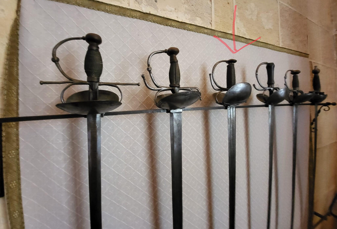

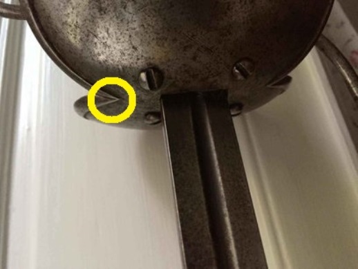

Spotted a sword in a pic (see below) with a similar hilt to mine. Third sword from the left. Picture taken in Alcazar de Segovia de los Reyes de Castilla.
Old 22nd January 2024, 08:16 PM   #10

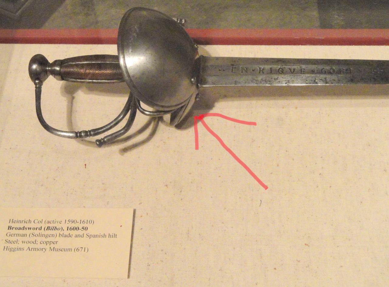

Is it my eyes or your hilt features (an attempt for) a 'rompe puntas' (sword point breaker) ?.´
Old 23rd January 2024, 07:55 AM   #11
Posts: 10,860
Brilliantly noted Fernando! a rompepuntas is completely atypical on a bilbo.
Perhaps something in the transitional netherworld?
Old 23rd January 2024, 09:45 AM   #12
Only while the 'real' rompe puntas has a plausible shape, formed around the traditional cup bowl, Victrix example bordering the accute angle shell guard doesnt seem so realistic; more assumably decorative ?
Don't beat me too hard but ... maybe not Spanish ? .

Yes probably more decorative. As stated in the first post, the sword was purchased from Italy so Naples (Spanish at the time) might be a reasonable assumption. At least two of the swords from the castle in Segovia have similar decorations on the shell. So does the sword below.

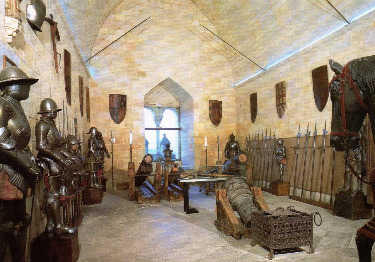

... And by the way, the Alcazar of Segovia is one in Spain i have never visited. This is a postcard sent by my daughter in 1999.

Wow that looks like my kind of place! The helmets on the left look quite interesting. Almost like those Roman gladiator helmets. So many places to see… I hope to finally make it to Graz to see the armoury there soon in the next few months. Fingers crossed.
