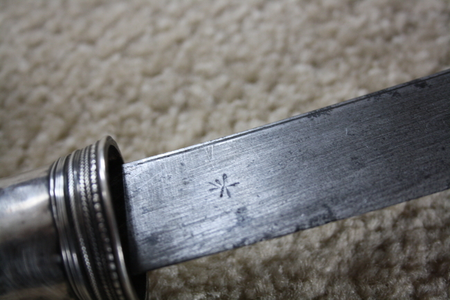

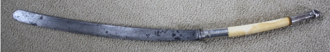

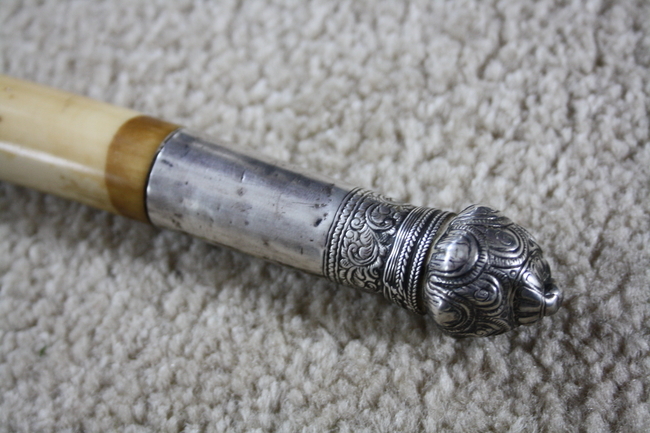

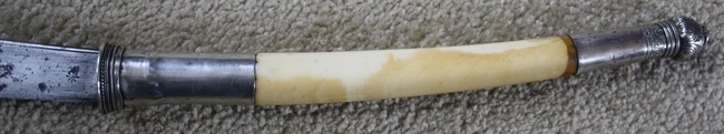

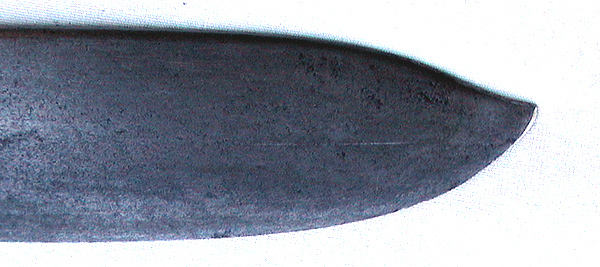

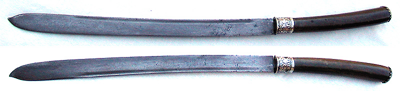

I have recently acquired this sword unfortunately it is missing the scabbard , I think its Burmese ,there is a mark on the blade maybe this will point to where it originates , I am a novice in this area and any info would be much appretiated
thanks
total length 84cm

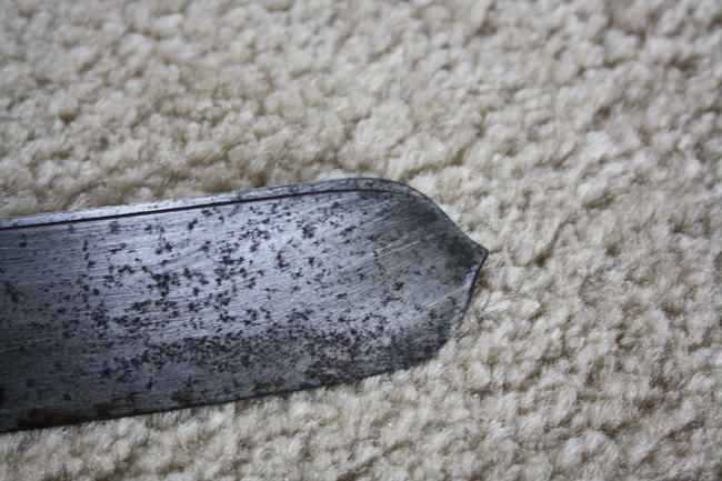

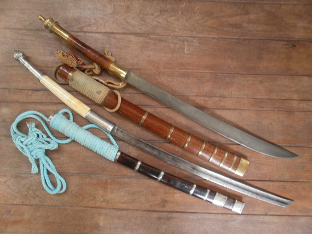

no, it's not a Burmese dha but a Lao daab, border Northern Thai. It has a Hua Bua tip. This Hua Bua tips are for pushing inside the arm of the enemy with which he hold his own sword so that he can't hold it anymore. The scabbard was a simple one like the one in the picture, both swords has been in possession of a good friend of mine. The mark on your sword was used by Laos, Northern Thai and Lanna daabs. Very nice sword by the way!

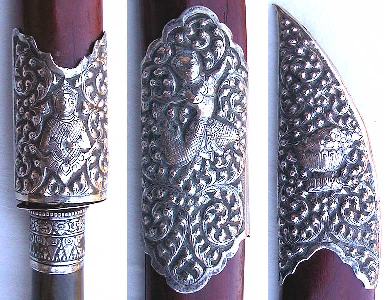

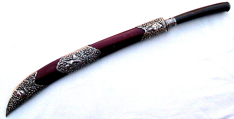

I agree with Detlef that your sword is N. Thai/Lao in origin and from the Rattanakosin period, maybe early to mid-19th C. I have a similar, hua bua tipped sword from the early Rattanakosin period (as dated from the silverwork on the scabbard)--pictures below. The hua bua tip is based on the shape of the lotus bud, and there are many variations. As you can see, the tip on mine is a little different from yours, but the purpose was similar. There are martial arts techniques that employed this tip to inflict a painful jab to the sword hand or arm of an opponent, temporarily distracting him and allowing a slashing blow to a more vital structure. These swords were intended mainly for close hand fighting, including indoors, and were sometimes used by bodyguards specifically trained in the use of this particular sword.
