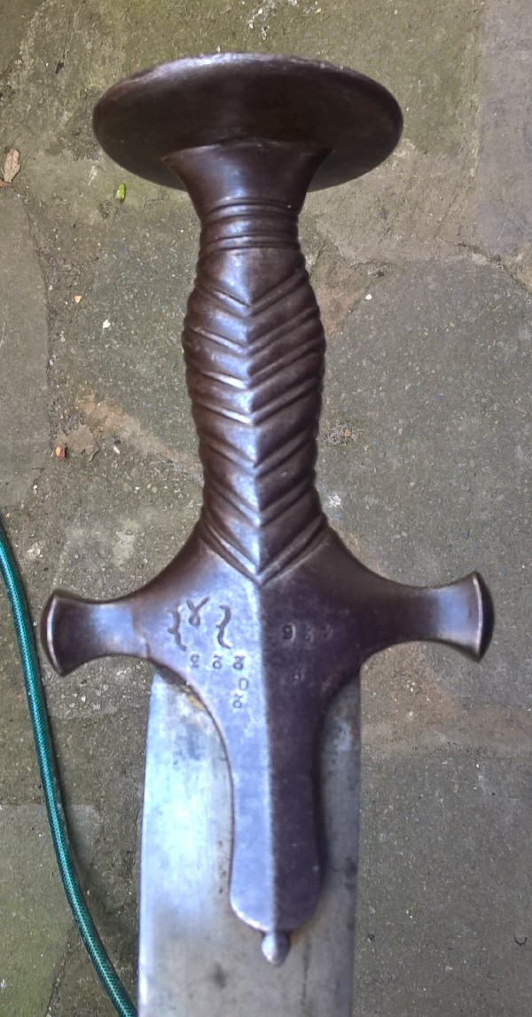

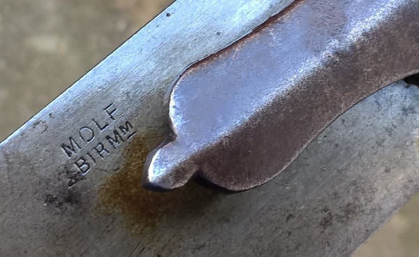

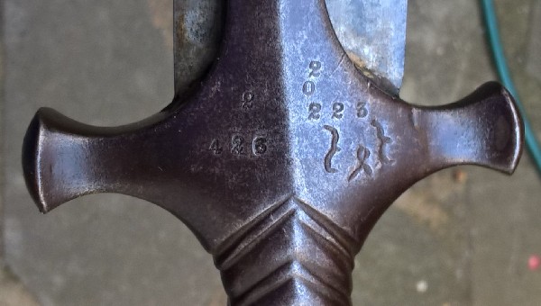

stenoyab
Posts: 43
The Mole tulwar I had has a steel hilt, with the loop on the dish.
As far as I'm aware this was the "All British" made tulwar, with blade marked to Mole.
I'm not sure if a brass hilted example would be a blade supplied to India and then hilted?.

BBJW
BBJW's Avatar
Join Date: Dec 2006
Location: Idaho, USA
Posts: 230
Default English Tulwar
I have a very plain Tulwar marked Mole that I was told was brought back to India when Raja Ajit Singh attended Queen Victoria's Diamond Jubilee in 1897. He went on a shopping trip while there and the Tulwars bought were likely just the blades and then the hilts put on in India.- bbjw
