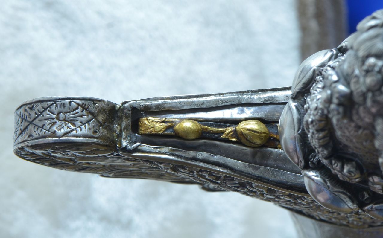

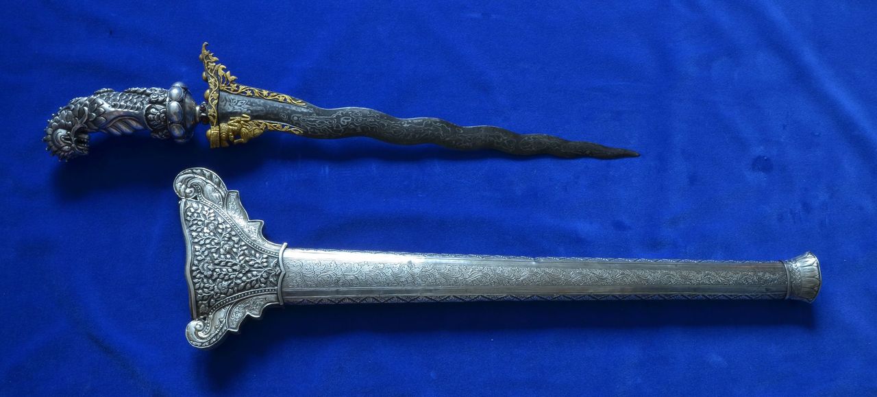

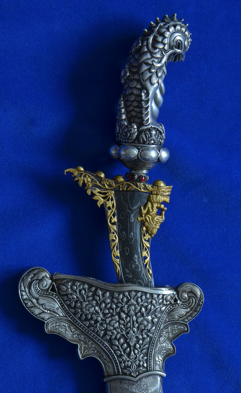

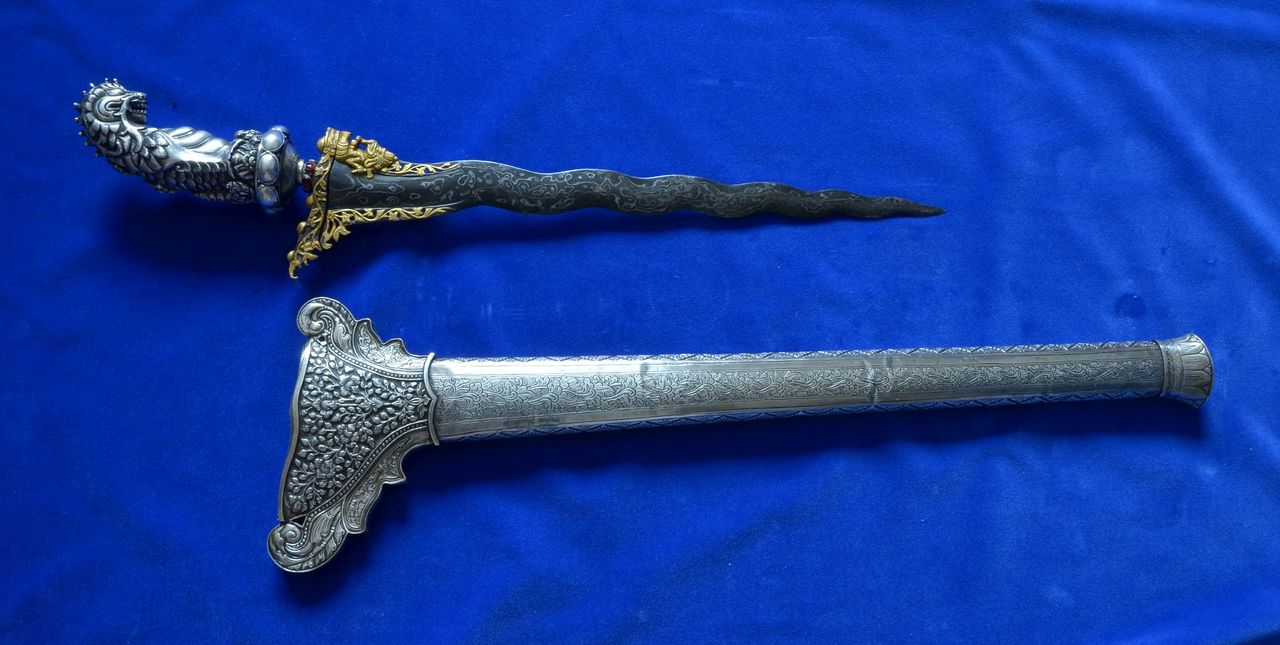

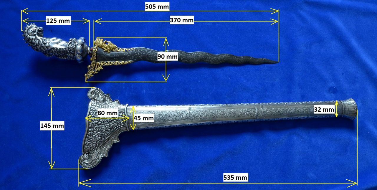

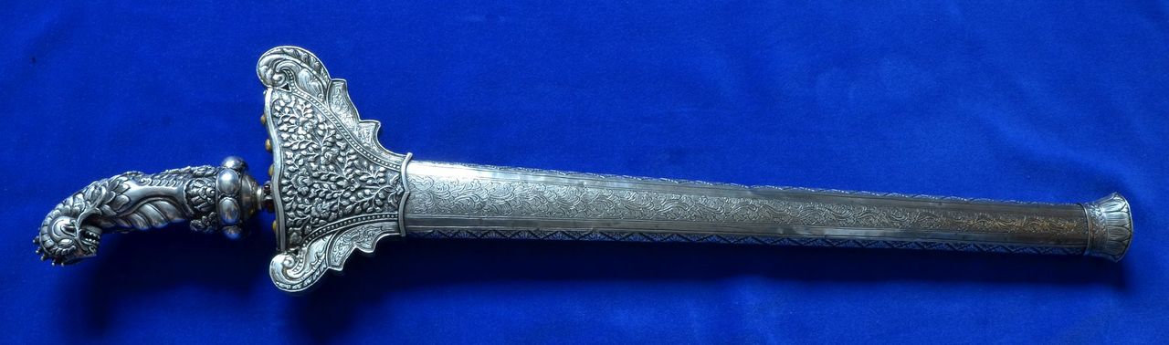

As promised, here is my Silver-Keris. I believe it is a Bali-Keris.
I don't wanna say too much, just listening to the opinions of other collectors.
What I can say is that hilt, scabbard and blade are of good quality. The golden layer on the blade is very thick, around 1/10 mm or more. Thick enough to hide some details of the figurine. Modern gold leaf is between 1/3000 (the thickest type) and 1/9000 mm thick. This means modern gold leaf is around 300 times thinner than this.
Now I'm really interessted, to read some opinions.
Best wishes,
Roland

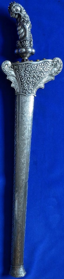

more objects of photography

Hello Roland,
Nice kris but not traditional Balinese IMO, especially the sandang walikat scabbard with added buntut.

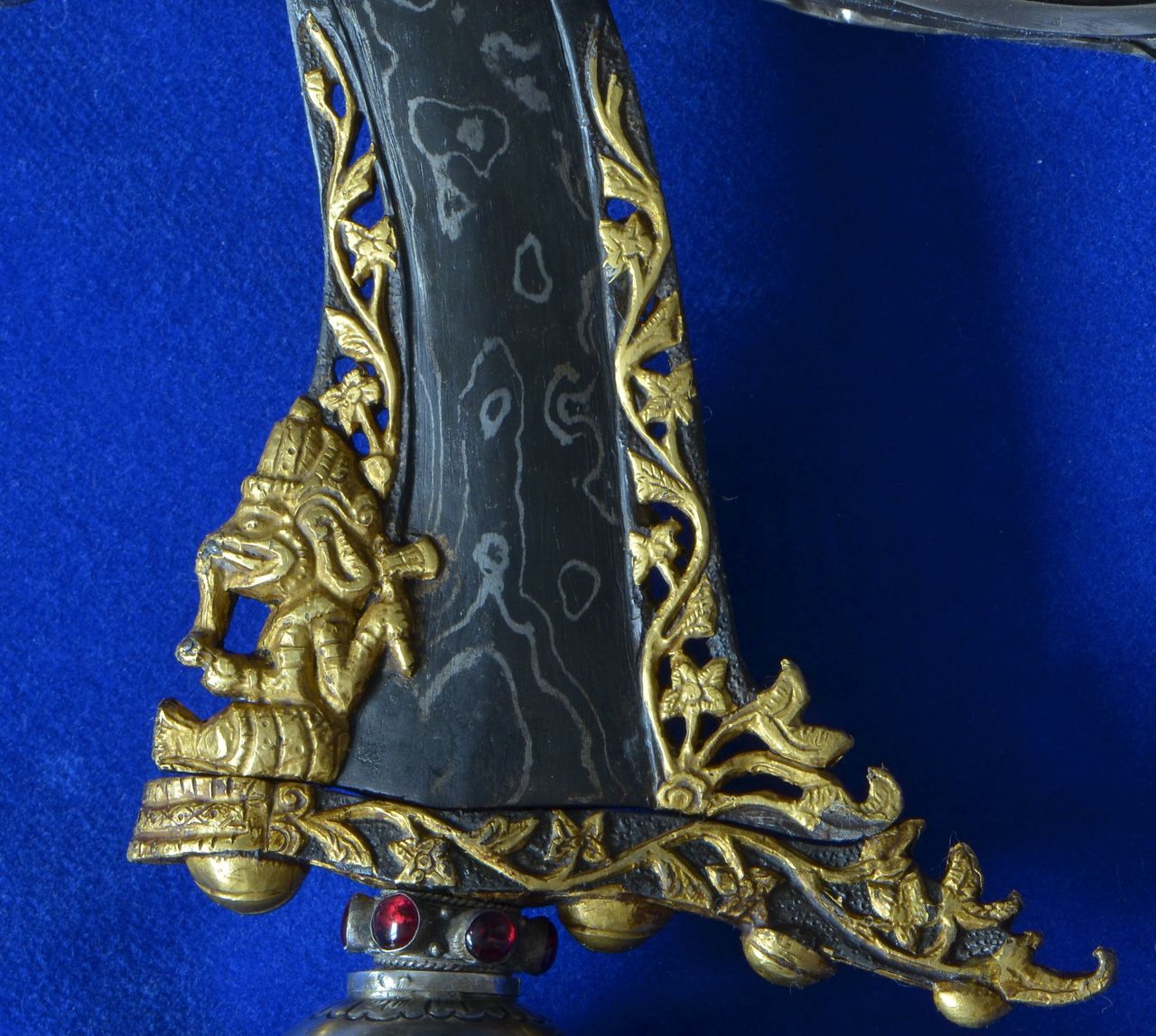

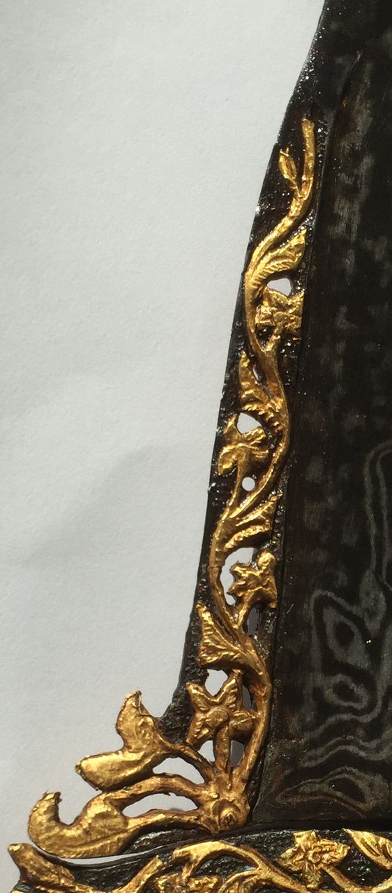

The kinatah technique does not use gold leaf.

Hello Roland,
I am probably one of the less knowledgeable people here, but to me, this keris looks fairly new.

I mean that kinatah is made from gold sheet (thicker than leaf). Yes, original kinatah blades are generally of high quality.

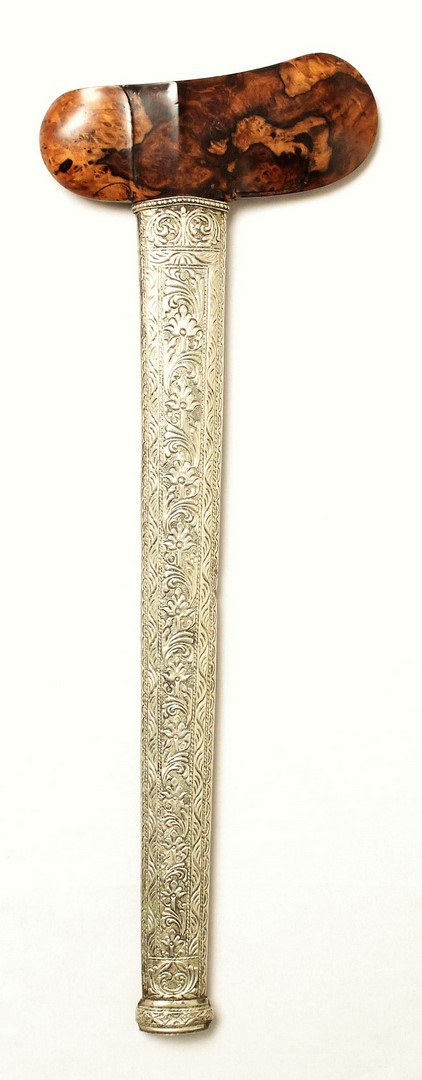

I am not at home so I can only show this pic of my pendok. Athough I see some similarities with the one from Roland (buntut), the style of floral engraving and silver quality are different indeed. I got this piece separately from the kris itself but it was fitted on another Bali/ Lombok scabbard. I would also place the origin of my piece to Lombok or Sumbawa (Bugis influence).

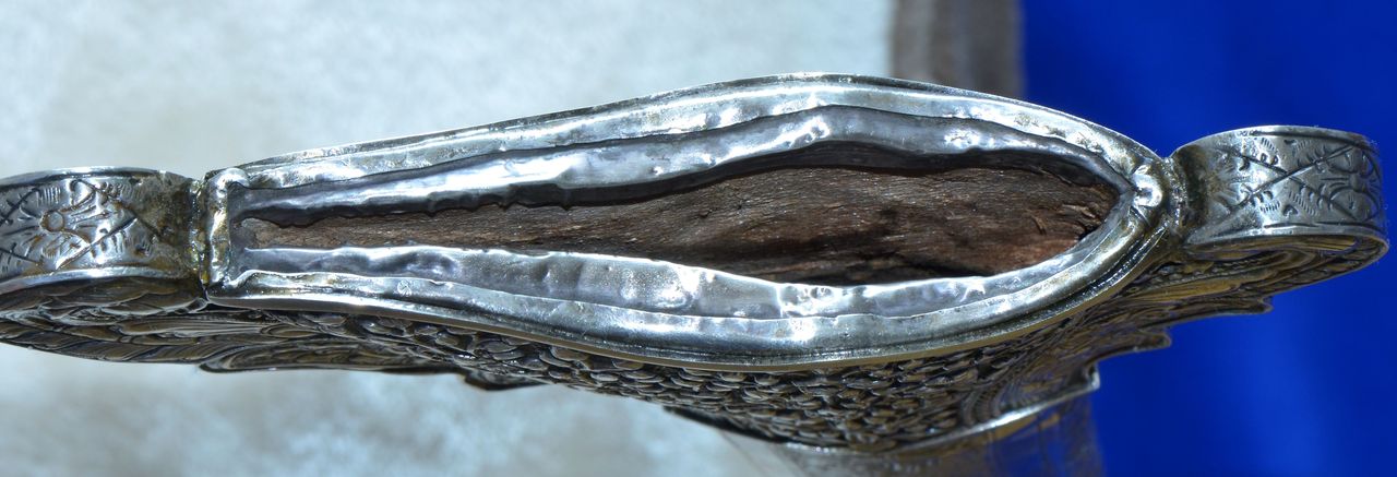

The pictures were made with a modern DSLR, the Nikon D7000 plus a high quality lens. Every picture has seen different automatic algorithms to increase the picture quality, without any possibility of influence by the user. The D7000 doesnt allow to use the raw-data. What I try to say is that pictures of old artifacts taken with a modern DSLR like this are always looks more modern than they are, always!

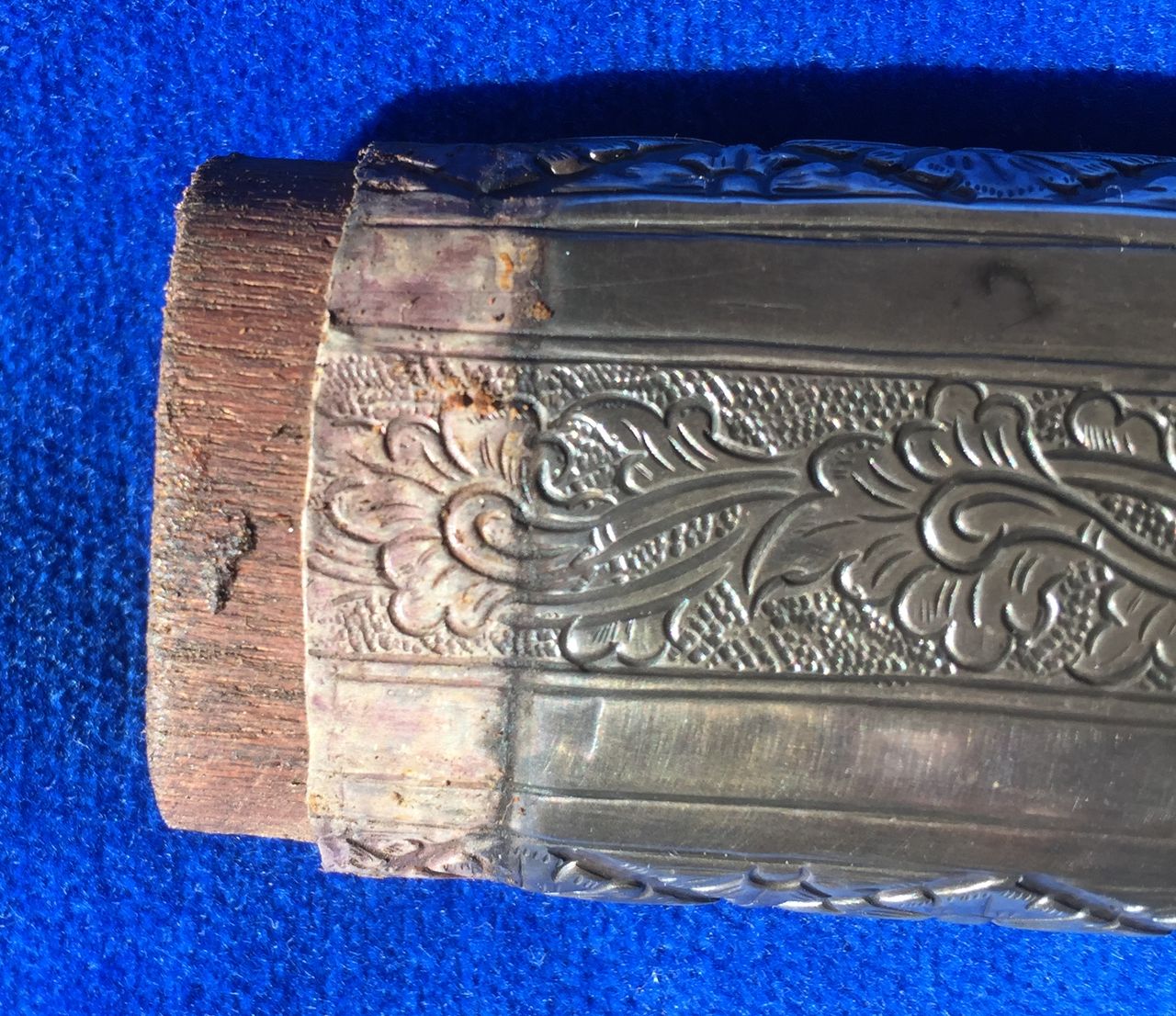

1: The scabbard of this Keris has been worn without any question with the typical signs of strain in the middle of the scabbard. Who was wearing such a big Kris ten years ago?
2: The blade itself has a mirror surface finish and a mild Waranga but there is corrosion everywhere and it takes some decades until a blade is corroded like this.

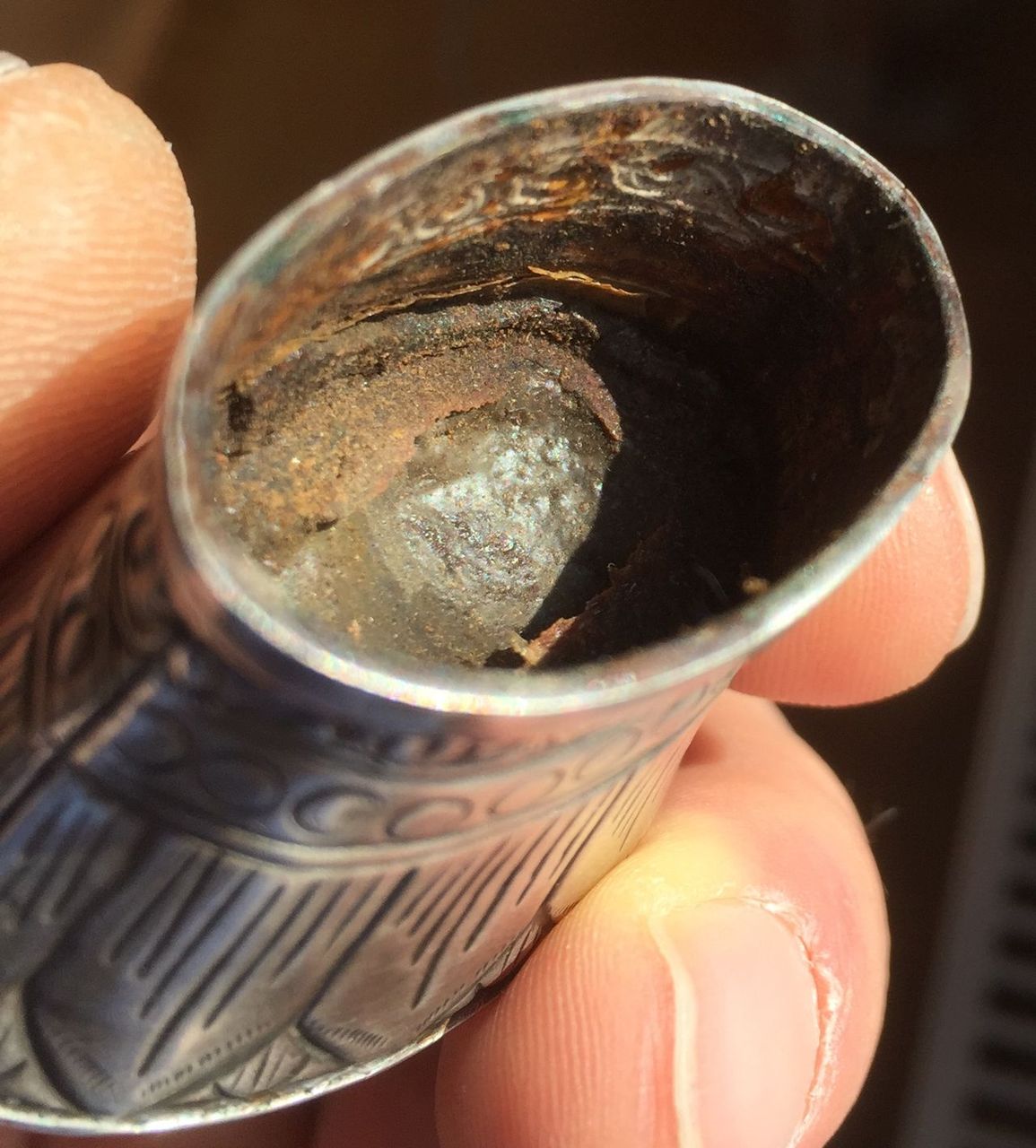

During the last cleaning the "foot" of the scabbard became loose and the resin inside the foot and also the wood from the core seem to be much older than 10 or 25 years.
If I see a artifact which is of unknown style to me, I would never judge the age of the piece by pictures. Especially if they are had been taken by an DSLR and if the artifact is made from gold or silver.
Without any question, this Keris is non traditional but this fact alone is no evidence for a recent production. What shall I say, my collection is full of unusual blades, I'm a kind of magnet for unusual artifacts

I do not wish to speculate about the age of this piece from the pics but would like to make the following observations:
. The silver color looks very clear, there is not much dark patina in the cavities which is typical of old silver artefacts. The silver quality seems excellent.
. I don't see much corrosion on the blade but some artificial pitting made by punching on the ganja and the pudak sategal on the sides of the blade around the kinatah.
. The kinatah fully covers the Ganesha figure but around the axe which he holds in one of his left hands there is a trace of gluing or welding which could indicate that the figure was added later.
. From my observations the "studs" on top of the ganja seem to be a recent javanese fashion.
. I have some quite recent silver krisses in which the wood core appears old and dry as this one.

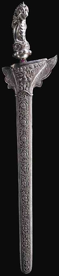

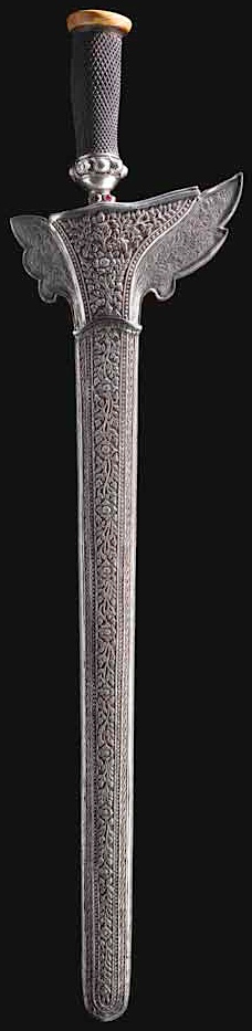

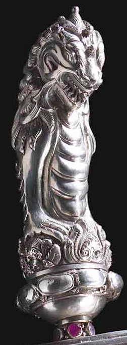

I guess we all agree that these 2 hilts are of the same style.
Still, I'd be very cautious of any claims like same maker/workshop/school - successful designs tend to get copied very quickly!
My best guess would be that this non-traditional hilt reflects the European influence during the first half of the 20th century (up to Indonesian independence) in Bali (or, possibly less likely, Lombok). I can't rule out a Madurese origin nor Kota Gede work though.
Photo credits: left hand pic cropped from the catalog of the IFICAH exhibition (Weihrauch & al. 2015), copyright Günther Heckmann (IFICAH); right hand pic from Roland (post #1).

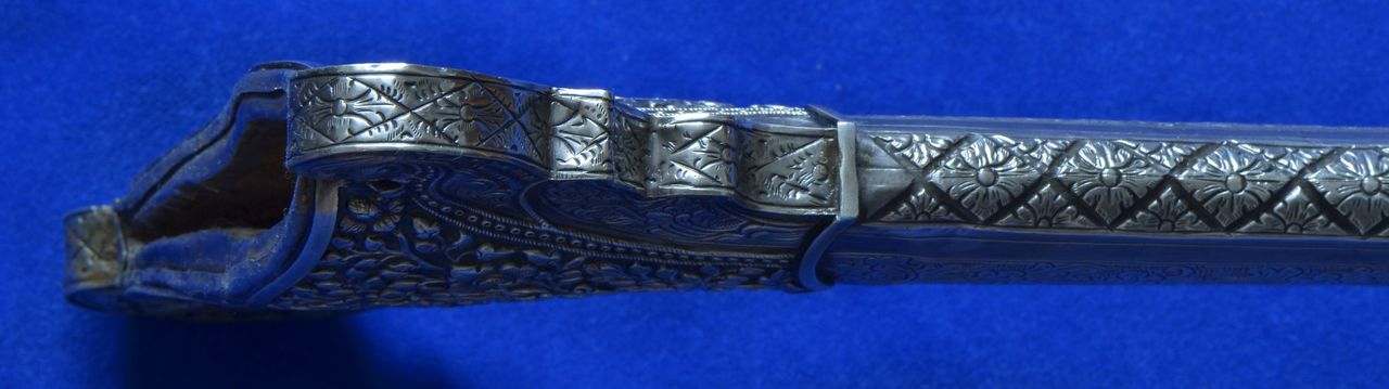

The scabbard is certainly interesting and with 3 examples we have established an pattern...
Note that Roland's example has the tips curled inside while in the 2 examples from the IFICAH exhibition they are pointing outside. Moreover, the carved motifs of all 3 examples are very different!
Any hints for the buntut being a repair for a broken scabbard tip in your piece, Roland?
I'm not convinced that Jean's pendok has any relationship with these 3 discussed here. (Thanks for adding the pic!)
Photo credits: left from Roland (post #1); middle & right hand pic cropped from the catalog of the IFICAH exhibition (Weihrauch & al. 2015), copyright Günther Heckmann.

While i will not speculate on the age of this piece at the moment i will make a few observations.
Firstly i would like to comment on your statements here Roland because as a professional photographer for 35 years who has worked with modern digital cameras (all Nikon) for almost 15 years your above remarks make absolutely no sense to me. I am familiar with the D7000 and it does indeed allow the use of RAW data. You have photographed a quality item with a fairly high quality camera. You did a technically accurate job and shot in reasonably good light producing sharp and detailed photographs that reveal both the craftsmanship and the wear. But i can think of no reason why the equipment itself would make your keris look newer than it does in person.
But even in hand we must be careful assessing age based solely on the appearance of wear and the over all condition of the piece. We know, for instance, that there are early examples of keris in European collections that have the appearance of being made yesterday. We must look carefully at the type of techniques that were applied to the crafting. Can we detect modern tools used? We must study the style of the embellishments. Does this appear to be an older style of kinatah? Can we recognize if this application and style of gold is distinctly Balinese or Javanese? Can we provide any other examples to support that opinion?
In trying to identify the origins of the blade, Marius thinks it looks Javanese? Is this a pamor that we are likely to see on a Javanese blade? What about the dhapur?
Lastly, could you add the dimensions of the keris to this discussion, both blade and sheath. The blade is obviously much shorter than the sheath. Thanks!

More pictures and the measurements.
I hope that the Keris is still interesting and that I can add more good pics for the discussion.
The piece which I call "foot" was solid in place. It became loose recently, after I tried out a new cleaning method with sweet almond oil, which is very thin. The wooden core looks old. Even the the red wax-resin-mixture (?) doesnt looks new to me. And not to forget it was hermetically closed before I was using the almond oil.
The scabbard is full of small dents and one large one from which I think it could be caused by bending stress, the typically markings.
The piercing in the area above the greneng were made with great effort, not just simple drillings.
The Ganesha-figure is an integral part of the blade, no upgrade.
Really hard to say what it is. One possible old background could be, that it was made for the dutch VOC as a present for proved soldiers.
Roland
p.s. all pictures are untouched, I reduced the size only.

Hello Alan,
the IFICAH exhibition has been mentioned a couple of times.
I do not have the hardcopy book that went with this exhibition
The link in my post #17 gives you access to the full book (PDF file).
were the keris in this exhibition accompanied by reliable provenance?
Well, the short answer is probably no - unless you define reliable (and possibly provenance... ).
The keris in the exhibition were loans from private collections and there is no provenance stated for the 2 keris shown in this thread; however, most specimens in famous museum collections don't have any reasonable provenance either.
I assume the accompanying descriptions were done by Achim Weihrauch, Adni Aljunied, and Udo Kloubert. Certainly many keris in museum collections have not been studied in depth by experts accepted by any of the senior keris people from the land of Jawa (and if so they probably won't agree with each other either !).
Thus, I guess we have to live with what we have. The authors' estimates resonates with our discussion here: "Earlier 20th century, maybe end of 19th century." [As mentioned, I'd tend towards a later date.]
I guess, some pointers from you would not hurt though, Alan!
