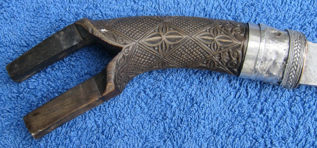

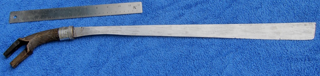

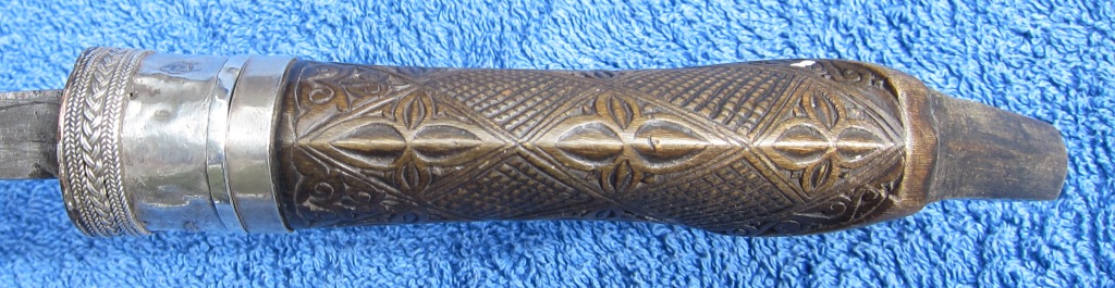

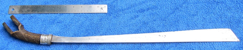

Not had one of these before. See A van Z page 23.
Amanremu with hulu baba buya.
Length is 72 cm with a 57 cm blade.
Hilt is carved horn. Ferrule is silver with traces of removed decoration in gold / suassa.
Look at the thickness of the blade near the hilt. Just about 13cm or 1/2 inch.
It is a very heavy blade.
Any comment welcome
Roy

Hi
To me the Y, horns were covered with silver sheet, it's too simple and too plain for me...
But it's not my field...
Kubur
Old 31st July 2017, 03:01 PM   #3
Hello Roy,
very nice Amanremu you got there! So it's a Alas, Gayo or Karo sword. What a shame that the suassa (I think) pieces missing. Like Kubur write, it could be possible that the both horns of the hilt has been once covered with silver/suassa. Not necessary but by a piece with suassa very good possible.

Posts: 6,441
It's nice to see one of these handles that is not cracked.
Probably hidden on the underside...
Actually, I tend to be very suspicious if there is no crack; this seems to be a genuine antique though!
Karo and Pakpak examples seem to be on the shorter side.
The large ones like this are probably Gayo (while well-provenanced examples from Alas remain elusive).

Hello Kubur,
Yes, most certainly silver sheet with suasa trim.
(Quite susceptible to wear & tear; not all examples seem to originally had this decoration though.)
Old 31st July 2017, 04:25 PM   #8
Hello Roy,
Nice acquisition! These long and heavy examples most likely originate from the central/southern Gayo regions; currently I can't exclude an Alas origin while (western) Karo hilts usually show slight differences.

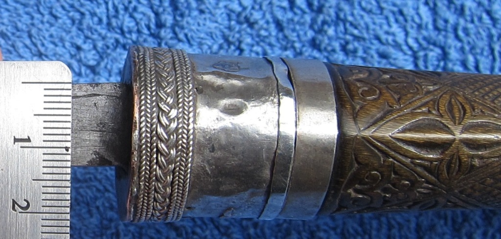

Possibly repairs rather than missing decor? Those 3 ferrule bands are unusual - maybe evidence of later repairs, too.

I still think that something has been removed from the ferrule.
It is possible that this has been repaired at some time, looking at photos of others on the interwebb does show my hilt to be somewhat unusual.
Quite possible that there was silver on the horns. Not possible to tell now.
I have been collecting S.E Asian since the late 70's and this is first time I have owned one of these. I have quite a few other Sumatran swords so although not rare, they are not common in the UK.
This one is comparatively rare in my opinion.
Roy

Hello Roy,
Could you post some close-ups?
I believe, the ridges at the base of the "jaws" are an indication of a former metal cover.
It certainly is one of the rarer swords. While the UK did not had much colonial stakes in the area, there were avid collectors. Thus, I've seen offerings from the UK as well as elsewhere (globally). Obviously, it always depends on where you shop and how much you're willing to pay.

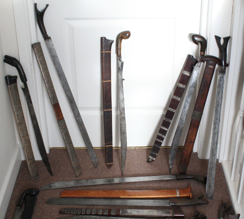

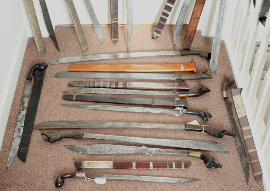

My other Sumatran swords.
Cheers
Roy

Old 2nd August 2017, 09:07 PM   #15
Great collection of North Sumatra swords!
Old 3rd August 2017, 08:22 AM   #16
colin henshaw
Join Date: Jan 2008
Posts: 1,435
A fine collection Roy, congratulations !
