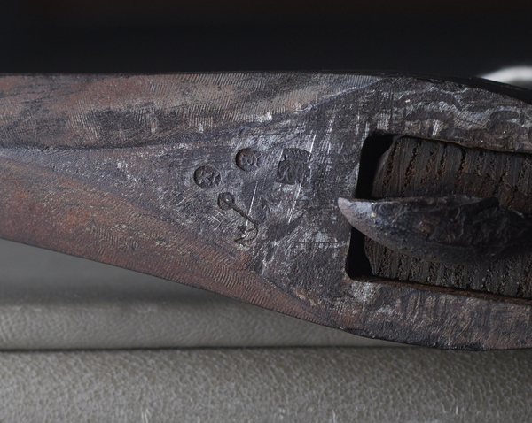

Hi can anyone help identify these markings.
There are two stamps an M surmounted by a crown and a B surmounted by a crown, both in ovals. These probably indicate that the axe was made in France but for which country?
There is a large crown with initials below and a grappling hook possibly signifying a navy.
The markings are on the top of a boarding axe.
Any thoughts greatly appreciated.
Regards, CC.
That stamp looks British to me.

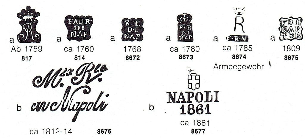

There is a bigger marking with a ligated "FR" under a crown. This is IMHO the mark of the "Fabricca Reale di Napoli", the Royal Factory of Naples in Italy.

The marking "B" could be a controlmark of Michele Battista who worked as "Capo Maestro" in the factory of Naples together between 1770 and 1780 with G. Morelli, whose mark might be the "M".

The owner of the axe has supplied a drawing tracing the letters as best they can see. Either R S or R F, is their best guess. The four marks are all contained within an area of approx 17mm square so they are all small.
Any thoughts anyone on a crown over RS or RF?

Here are the marks used at the Klingenthal arms factory
corrado26

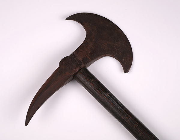

I would be more amazed with the fact that, its head looking like the real thing, has no langets fixing it to the handle ... or is this a common feature, CC ? .

Yes you are absolutely right, langets would be very much normal for a boarding axe. The owner - a museum in the US - are sure it is a replacement handle and I think the langets are just missing.
I have not yet been able to identify this type of axe. I know of five of this style and they are always described as French but I have always had doubts about this.
Of the two I have measurements for: the blade to point is 10 ¼ and 10 ¾ inches and blade tip to tip 6 ¼ and 5 ¾ respectively.
They all have in common the wide head with very long down curving spike, big crescent shaped blade, short inset langets with rounded heads where they protrude and long handles.
The handle on two (I think with original handles) is round in the lower part but is shaped into 4 sided with 4 facets at the top – this allows the langets to be inset into a flat surface.
Only one held by a collector in Maine has any marking and that is a barely visible anchor.
I'm hoping that the markings on this one may lead to a pattern for a particular State.

...The owner - a museum in the US - are sure it is a replacement handle and I think the langets are just missing...
I thought of that; even originally suggested it in my post but then ... i hesitated

I forgot to say Capt. Mark found a very similar one a few weeks ago - remember this:
http://www.vikingsword.com/vb/showthread.php?t=22838
The owner sent me more pictures and it has the inset short langets, so I think it has the original handle but the spike is longer and more curved.

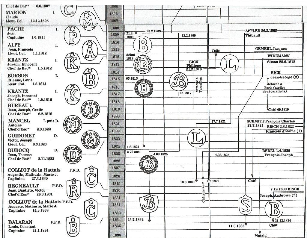

I have been looking hard and I can find examples of an R or an R and F entwined beneath a crown indicating manufacturer at Fabricca Reale di Napoli.
This is the link - http://www.klingenthal.fr/marquages_coulaux.htm - to the stamps of the Klingenthal inspectors after the loss of the government contracts - it is stated as not so accurate as the government records. There is a crowned B and a crowned M that may have been working together around 1850/1860 - the dates are not precise. The M has a three point crown similar to the one shown on the axe. I would like to discount these to be certain that the axe was made in Naples.
Does your copy of the NEUE STÖCKEL show images of the stamps for that I could use for comparison?
Regards CC.

From the very unclear foto that you have shown at the beginning of this post I thought that this stamp could be the sign "FR" of the "Fabricca Reale di Napoli". But the bigger foto showed that the mark shows the letter RS or RF. This and the crown above the letters cannot be the mark od Naples factory.

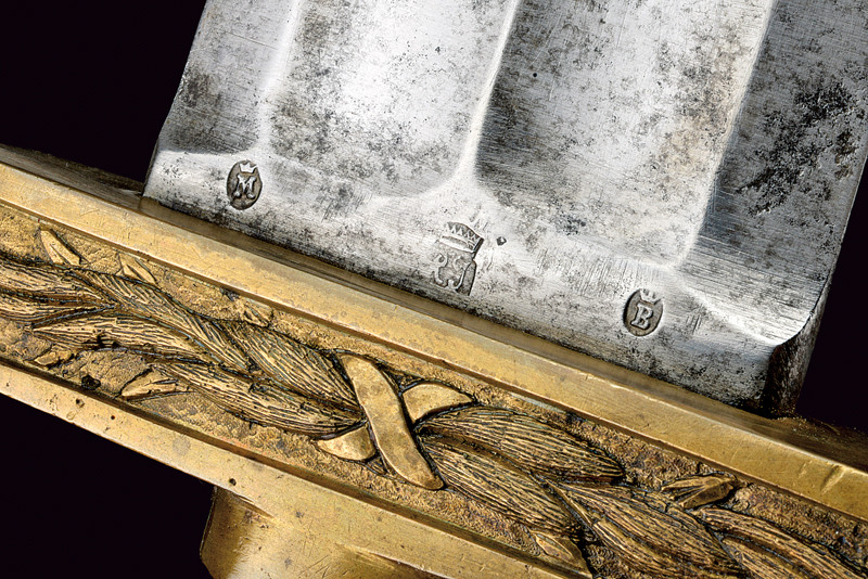

Success!
A collector on a sister forum posted a link to this gladius type sword with identical markings.
The larger crown over the RI indicates Regno d'Italia/ Royaume d'Italie. This indicates the Kingdom of Italy which was set up by Napoleon who made himself the king. It only existed as a state from 1805 to 1814. So it dates the axe nicely.
Less definite:
The axe was probably made by the armourer Paolo Landi which was a private company manufacturing arms for the state, in Brescia (which still has an arms industry today - including Berretta), east of Milan.
The inspector's marks of the M and B under a crown are associated with this firm at this time.
During this period they made weapons to the French pattern and there are examples of cavalry sabres, infantry briquettes and even sapper axes that are almost identical to those made in France.
According to Wiki roughly 200,000 troops from the Kingdom of Italy fought in Napoleon’s army during that decade.
So a French axe made in Italy or an Italian axe - this remains to be decided.
Considering the above manufacture of French type swords, it would tend to indicate the former, but on the other hand the anchor of the French naval acceptance is well known and the grapnel type shown on this axe is very different from that.
Regards, CC
