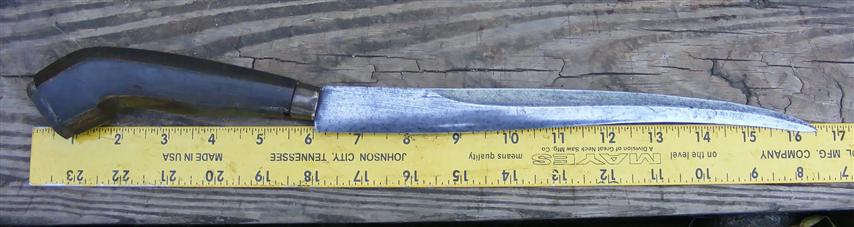

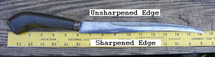

Possibly longer, maybe that might explain this piece. Original thread located here; http://www.vikingsword.com/vb/showthread.php?t=18717

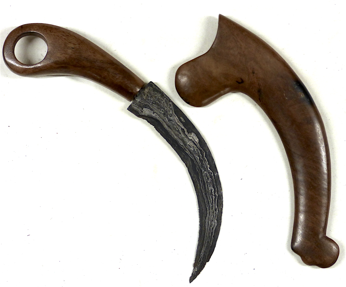

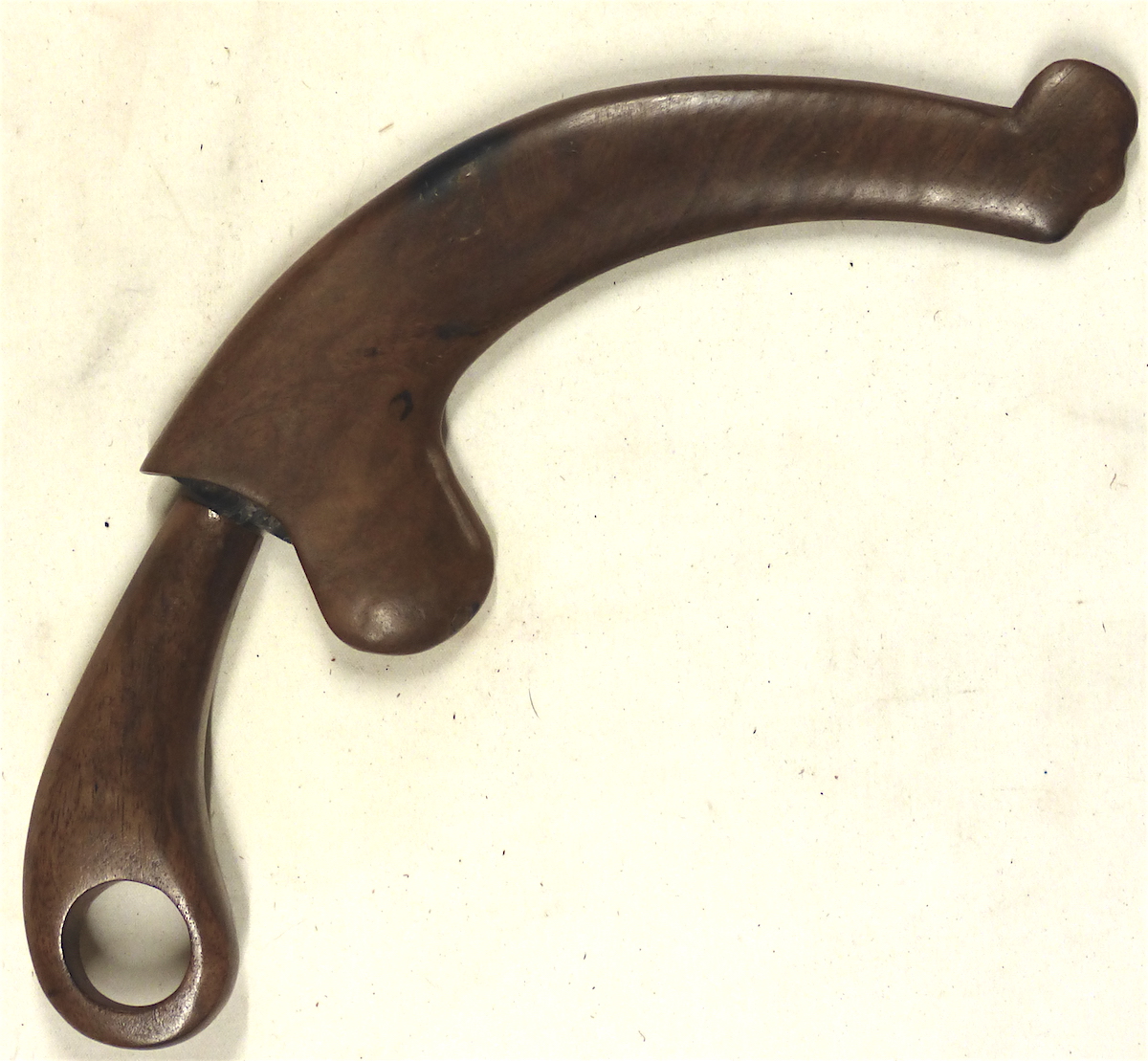

I have never seen an old karambit in the Philippines, and I have asked several long time dealers in Manila if they have seen one. The answer has always been that the karambit is not a Filipino weapon--it is only used in Sumatra, Java and the Celebes.

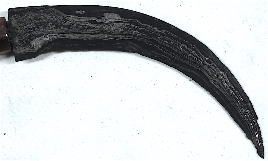

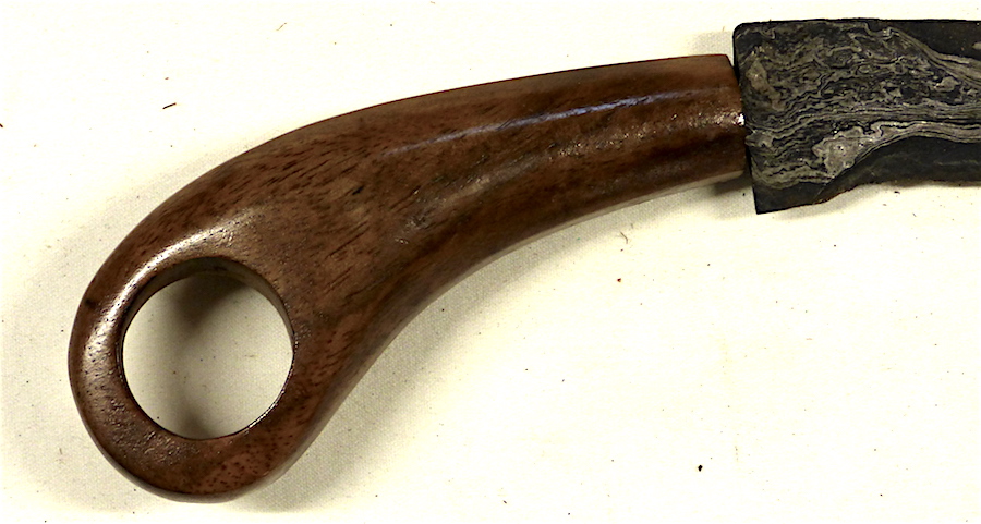

I don't have an example of the modern ones that can occasionally be found in the Philippines. I do have this old one that I think is from Java--collected in Jakarta in 1968. It has rather a nice little pamor blade.
