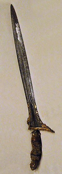

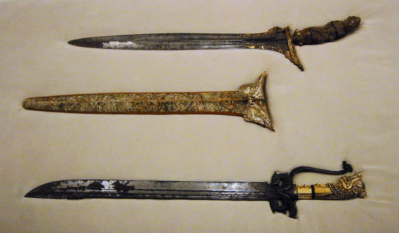

Hasekura Tsunenaga was a Japanese samurai and diplomat who was born in 1571 and died in 1622.
He undertook diplomatic missions to the Americas, Europe, and the Philippine Islands.
He returned from his mission the the Philippines in 1620, and amongst the things he brought with him was a keris from the Indies, that is, Indonesia.
That keris can now be found in the Sendai City Museum in Japan.
Here is a picture of the keris brought to Japan in 1620 by Hasekura Tsunenaga.
Old 2nd August 2010, 12:54 PM   #2
Posts: 7,302
That's interesting. Too bad we don't have some better images.

Here two interesting links, which are an absolute must:
http://en.wikipedia.org/wiki/Date_Masamune - about the famous daimyo of Sendai, one of the Japans christian daimyos, who sent this ambassy;
http://en.wikipedia.org/wiki/Hasekura_Tsunenaga
About Sendai Keris: it isn't clear, where exactly it was obtained. There are also a hypothesis, it was given to Tsunenaga in Spain (by Spanish king) or in Rome (by pope). Philppines is just another hypothesis.
Clear is, that such a weapon must be given by a very high rang person as a status symbol.
The most interesting thing, besides the keris himself (a magnificient keris with perfect details and early stile kinatah, also a figural hilt) is the sheath, where on atasan a symbol, which seems to be a christian one, is depicted, together with alas-alasan motifs on the gandar.
Somewhat better pictures are to be find in Jensen's Krisdisk.

Maybe this photo will help.
ADDED: Actually, nw that i look more closely, this is the same photo which Alan cropped just to show the keris....but at least it is a bit larger.

Very interesting thing is, the blade of this most early Kastane seems to be an imported one, there should be an european monogram on it.
Old 2nd August 2010, 11:42 PM   #8
Posts: 7,255
Please accept my apologies for posting such inadequate images.
I find that I am unable to understand almost anything about a keris unless it is in a vertical orientation, rather than a horizontal orientation, in fact when I want to really look at a keris I download the image and change the orientation to that shown in this post.
Hopefully these images will be a little more useful.

The hilt looks most interesting! I've seen something similar of recent manufacture, and I dismissed it as a newish design. According to the dealer, the hilt came from north coast of Java.
Old 3rd August 2010, 09:07 PM   #10
Gustav
Join Date: Jun 2009
Posts: 1,346
The hilt is much more finer as it seems on the pictures.

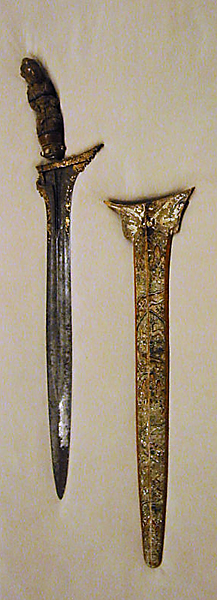

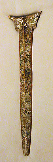

Time to bump a worthy thread. Can anyone say anything about the sheath?

Well, this really deserves more attention, yet there is a problem with adequate online pictures, with available material a discussion here seems to be impossible. Slightly better pictures of sheath and blade, good pictures of hilt and description are to be find in Jensen's Krisdisk, chapter 7 (Bali), pages 31-33.

PERHAPS THE DESIGN ON THE SCABBARD IS ONE OF THE BATIK DESIGNS. THESE DESIGNS IN BATIK AND PUA AND OTHER FABRICS HAVE A LOT OF DIFFERENT MEANINGS JUST AS PARMOR DOES. I WONDER IF THE HANDLE IS CARVED TO REPRESENT A JAPANESE GOD FIGURE PERHAPS QUAN YIN. THAT WOULD BE APPROPRIATE FOR A GIFT TO THE JAPANESE RULER. IT NO DOUBT WAS MADE ESPECIALLY FOR THAT PURPOSE UNLESS IT WAS AN OLD ONE AT THE TIME .I SUSPECT IT WAS SPECIALLY MADE FOR THE PRESENTATION AS AT THE TIME GIVING SOMEONE SOMETHING OLD WAS OFTEN LOOKED ON UNFAVORABLY. THE ANTIQUE IDEA WAS NOT YET BORN AND OLD STUFF CONSIDERED LESS VALUABLE. JUST CONJUCTURE AS USUAL
I ESPECIALLY LIKE THIS FORM OF BLADE AND ONE OF MY FAVORITE PHILIPPINE OR MALAY KRIS HAS THIS FORM OF BLADE. IT IS A KRIS AND LARGE SO DOSEN'T FIT INTO THIS KERIS FORUM OR I WOULD DO A POST , THERE IS ONE IN THE OLD ARCHIVES ON IT. UNFORTUNATELY NO ONE COULD PIN IT DOWN.

Would love to have had even bigger pictures to tell if the scabbard has gold on it for sure and what quality of work. Same for the rest of the piece, especially since it is rare to have such an old piece like this with documented provenance going back that far.
Still thanks for posting this Alan.
Also I wonder if this was indicative of the size of blade back then, getting smaller in Indonesia as time progressed and larger in the Philippines.....

The sheath is painted. There exist three or four such old sheaths with painted alas-alasan motifs. Painting is done very spontaneously, the depicted animals are well characterized.
Old 17th February 2011, 03:50 AM   #16
Posts: 7,415
Thank you - I now see it as gloss and not metal shine. Helpful.

Jose, these white stains are places, where ground coat is visible.
The sheath is made from one piece of wood, gandar iras, like all sheaths, which can be traced back to the first half of 17. cent. Gambar is unfortunately broken (the wright side).

Regarding hilt and selut, there probably are some mysterious things. For such high quality keris and sheath the match of hilt and selut is very bad. Selut is clearly to small for the hilt (which must be very huge, even compared to keris), this selut is the only one of this type I have seen with such an early provenance, and looks, how can I say it, modern designed compared to the rest.

I am a little hesitant to enter this conversation when so little about the origin of this keris is know and the photos are so bad. Where do people believe this keris is originally from. From what i can see, to my eyes it looks a little Balinese. Certainly the hilt form, though a bit different from later styles, looks that way due to the type of selut and figurative hilt. Also what appeas to be two fullers reaching down most of the blade is a common feature on Bali blades. If indeed we are looking at a keris that has been unchanged since it's collection in the early 1600s i'm not sure that we can really say without a full understanding of the origins of this keris whether of not this is a proper ensemble or not.
And Barry, if it was collected in the Philippines it may well be something pick up in travel, not a formal royal presentation, because this clearly is not of the Philipinnes. Given that scenerio it would be unlikely that the hilt was made specially for the Japanese ruler. It may well have had some age at the time.
If the diplomat had made his way to Bali or Jawa to receive this then the story might be different. But i doubt that they would create a hilt depicting a Japanese deity for this. Certainly figurative hilts like this were being created in Bali at that time.

In Tropenmuseum there is (much younger) Balinese keris of somewhat similar appearance (picture borrowed from Maurice). I suppose, such feature as this selut is not known in Java.
I think, we can accept hilt and selut as a bad fit, becouse selut is not covering bungkul.
It is clear, that gambar is being repainted with a symbol, which could be regarded as a christian one. With some certainity the repainting is done in the same style as alas-alasan on gandar, some colours are the same, some differ.
I am not sure if we can call this keris a pick up, becouse it is a really high quality keris and Hasekura Tsunenaga was a diplomat on official mission. After beeing in Spain and Rome he stayed for two years in Manila before returning to Japan. It is a speculation, nothing about this part of his voyage is known, yet I don't think he was staying in this town all the time, and his staying there before the fulfilment of his mission should have some reason.

Well Gustav, it certain does appear to be a keris of court quality, yet there does not seem to be any evidence that this diplomat met with members of the Balinese (or Javanese if this is of that origin) members of court. Perhaps not a "pick-up" as a tourist might gather, but also not a gift directly for it's point of origin as far as i can tell.

Can someone also explain to be what the supposed Christian symbol is that appears on the sarong. I can not see any such thing in the photos presented.

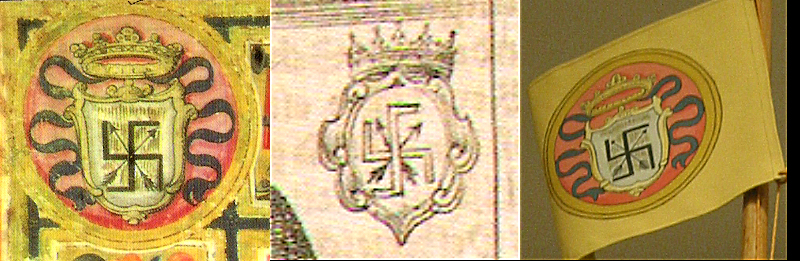

Well David, for the speculative oppinion, this keris has been presented to Hasekura Tsunenaga in Manila, there are points:
1) this is a high quality keris; such keris is not only a weapon, it is a status symbol;
2) he was not an ordinary man, he was a diplomat;
3) there is a symbol, which could be regarded as christian, and he, he's family and he's family servants in next generation were christians.
For speculative oppinion, he just obtained this keris, there are points:
1) we don't know about he's contacts with high ranked persons from Bali or Java;
2) the symbol could be painted on his request after obtaining keris in Manila.
You should consider, there is also a possibility, actually also a speculative oppinion, this keris was presented to Hasekura Tsunenaga in Madrid, where he met Philip III and become a christian, or in Rome by Pope, to demonstrate him the religios and political christian influence in South East Asia. You just should bear in mind, also the kastane has a marking on it, which could be regarded as christian.
Regarding the symbol, there is a red bleeding heart, pierced by two arrows, beeing hold by two white dows. I was also curios about this symbol and searched for it. I found a religious order, founded in France at the beginning of 17 cent., which has an emblem of bleeding heart, pierced with two arrows. It has not interested me anymore, so I forget the name of the founder and order. Important for me was, I have an evidence of such symbols in christian emblematic of this time.
The most interesting - abowe the heart there are two eyes with eyebrows, and style how they are painted is Javanese-Balinese.
As I wrote, the symbol appears to be done in the same region where the alas-alasan was done, yet there is no absolute certainity about it.
The ansver on some questions would probably give a chemical analysis of the colours, comparing the paint on Gandar and Gambar. Absolutely clear is, here in Keris Warung Kopi we will not come to any solvings of the many problems regarding this most interesting keris, when even some better quality depictions are problem.

Posts: 1,346
David, just the first two lines in my last post were adressed to you. I thought, the rest is speaking for itself for somebody, who follows this discussion with smallest interest and attention. I wrote it just becouse you mentioned in the post before the initial reason: Barry's speculation on the hilt. This was what I could say about it.
There is a clear connection with the coat of arms of Hasekura Tsunenaga for sure. Yet in he's coat of arms the arrows are pointed upwards, otherwise, when pierced through heart (in christian symbolism), downwards. Actually this is the symbol of Teresa of Avila, who was exaltated to patroness of Spain at 1617 (Hasekura was baptisised and most probably got his coat of arms at 1615).
Actually he was leaving Spain in June 1617, so the 1616 on the map from wikipedia is a mistake.
As for the oppinion of an expert, I think, we can doubt it or to believe it, his oppinion has more weight then ours. Moreover, he was able to examine the keris in Sendai City Museum.
The possibility entire painting was done outside of Bali or Java is very, very small. The style of painting on sunggingan from Vienna (before 1608) is very similar (also W. Martowikrido mentions this). I have not seen till now better pictures of the third old sunggingan with alas-alasan in Munich, which is also in a good state of preservation.
