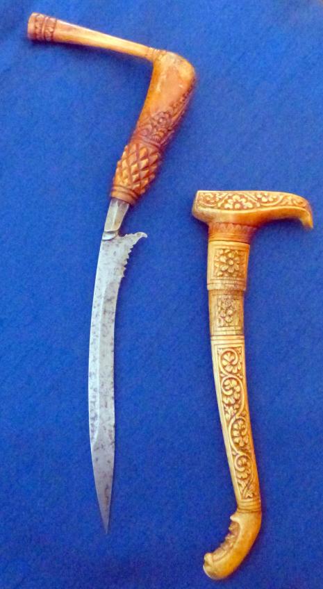

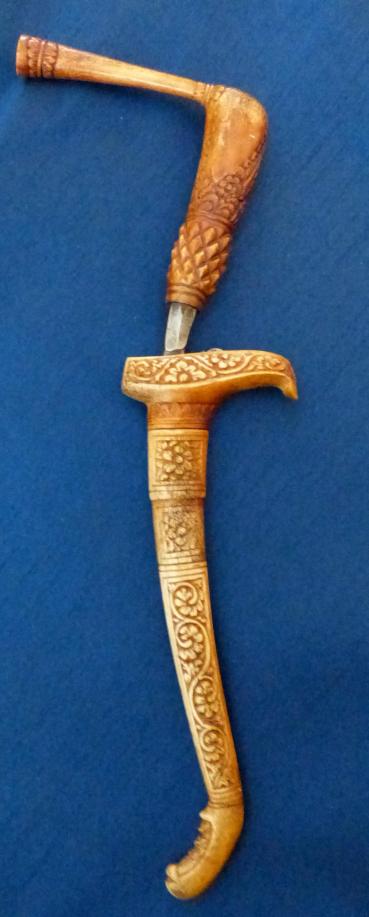

I just aquired a few new blades and among them is the rencong in the photos. Both, hilt and scabbard, appear to be made of bone and the blade, while strong blade is integral with the bolster. The blade was obviously heavily corroded and roughly cleaned so I cannot discern any traces of lamination.
Total length in scabbard is 37 cm (14.6").
Blade length is 17.5 cm (6.9").
Any comments will be welcomed!

Hello Marius,
This is a later example, probably from the second half of the 20th century.
The blade is reasonably done but shows the flow of lines and details of, say, the post-WW2 period.
The hilt and scabbard show more differences compared to antique examples. The floral decoration seems more of a general Malay style and I'm not convinced these were crafted in Aceh. There was (and still is) quite a local Chinese/Malay industry in Medan producing old-looking pieces for the curio market.

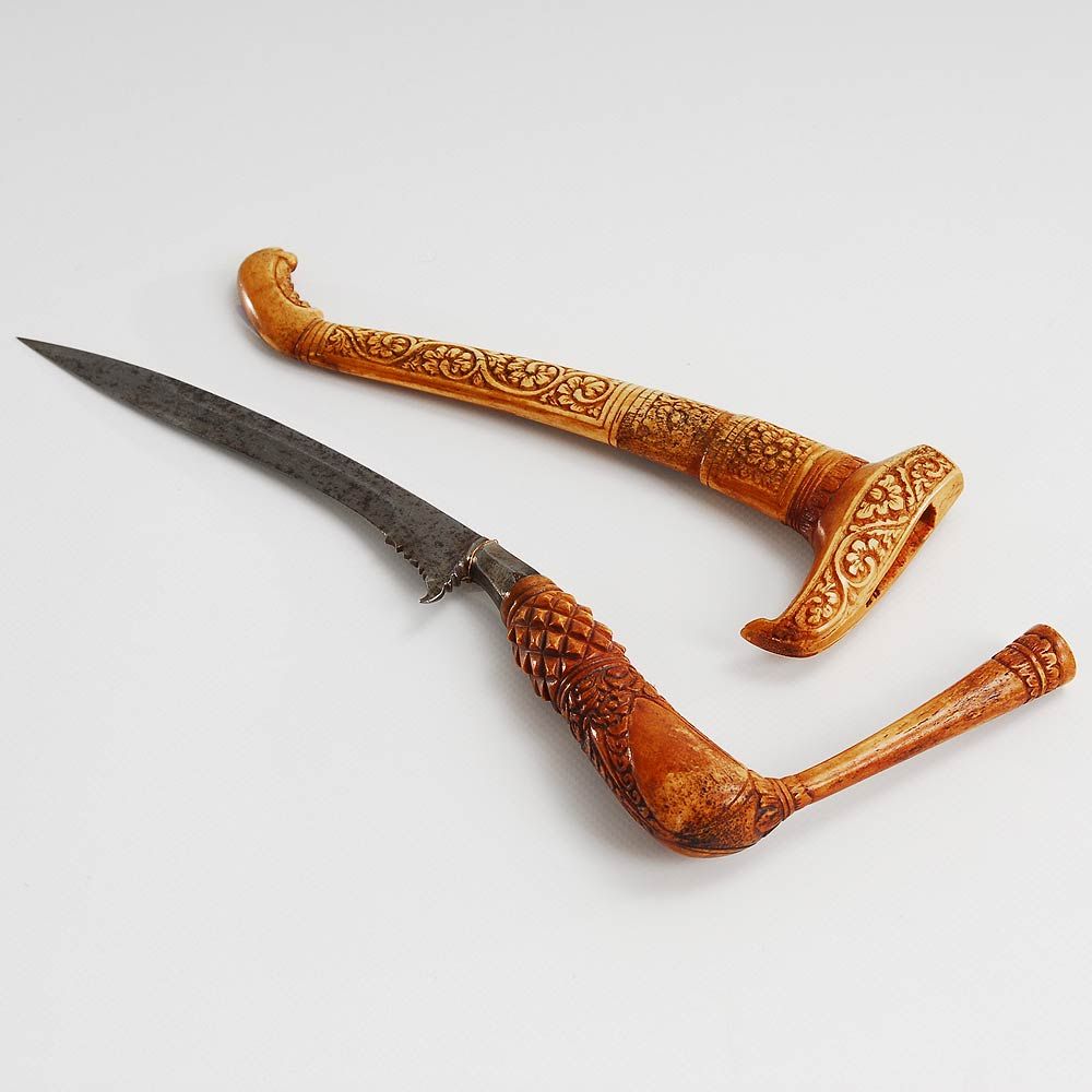

is this the original picture from the auction? When it is I think that it is older as before suggested.
Old 25th July 2017, 01:32 PM   #7

Hello Detlef,
Yes, that is it! The original photo from the auction house.

Hello Marius,
I disagree with the others, I think that the receng in question is pre WWII. And sorry, the auction picture is more meaningful. The statement from the auction house (1920) seems to be a good guess IMVHO.
Old 26th July 2017, 12:29 PM   #9
Post
Hello Detlef,
Thanks for adding the pic!
The auction house didn't gave any support for their estimate - with them confounding horn and bone, I don't see any reason to put much trust in their descriptions...

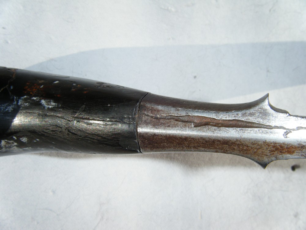

The blade is quite nicely done, indeed. However, it does show the flow of lines and details of later rencong; also note the forging flaws at the bolster. It may predate WW2 a bit - however, much more important is that it does appear to be made by an Aceh bladesmith.

I also don't put any trust in descriptions from auction houses but sometimes they have a reason for the age guess, would be worth to call them and ask for any background knowledge they may have. I was going with the patination the blade show at the auction house picture.

The duru seuke as well as the taku rungiet and the other features at the bolster are traditionally done; only the shape of the blade and the "greneng" are of a clearly modern style which took a while to develop in Aceh: first the quality of the rencong deteriorated and then the stylistic changes set in during the first half of the 20th century.
I'm quite positive that the blade is Aceh workmanship; the blades which I suspect to be made by other cultures are those gruesome examples with wax resist etching in pseudo-Arabic "calligraphy"...
The forging flaws you can find also by antique blades, see attached picture from one of my pieces
Definitely. If we exclude those which may have become visible upon continued corrosion, major flaws are really rare though.
