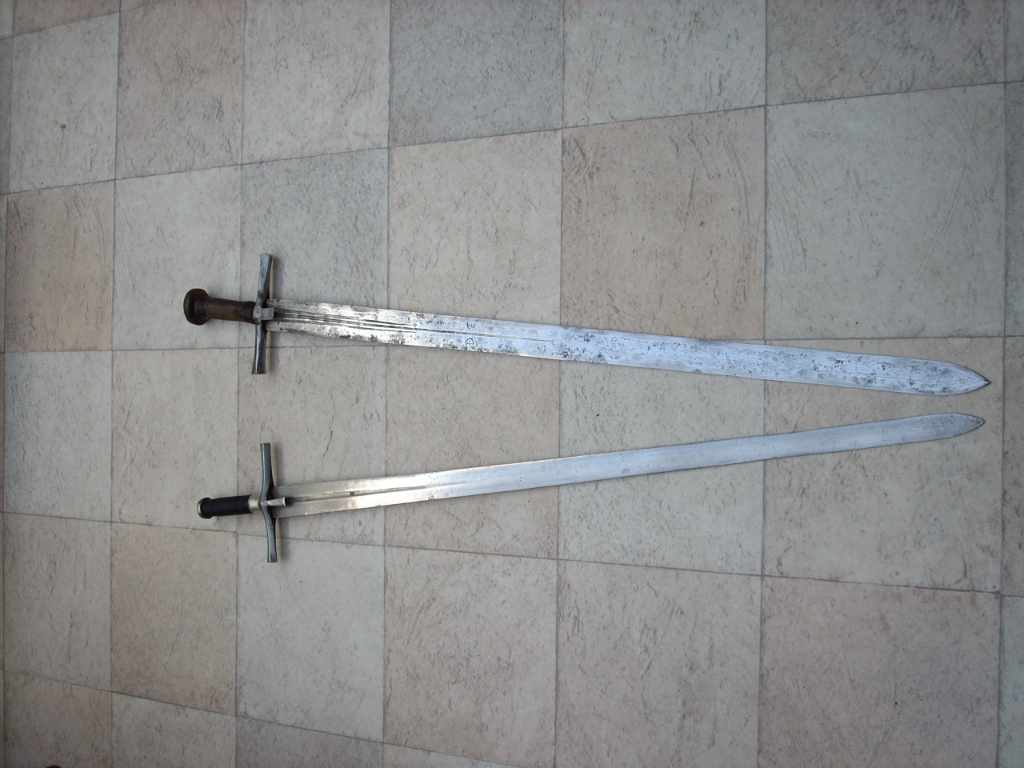

Default Help required to identify a strange stamp on a Kaskara blade
Hello Everyone,

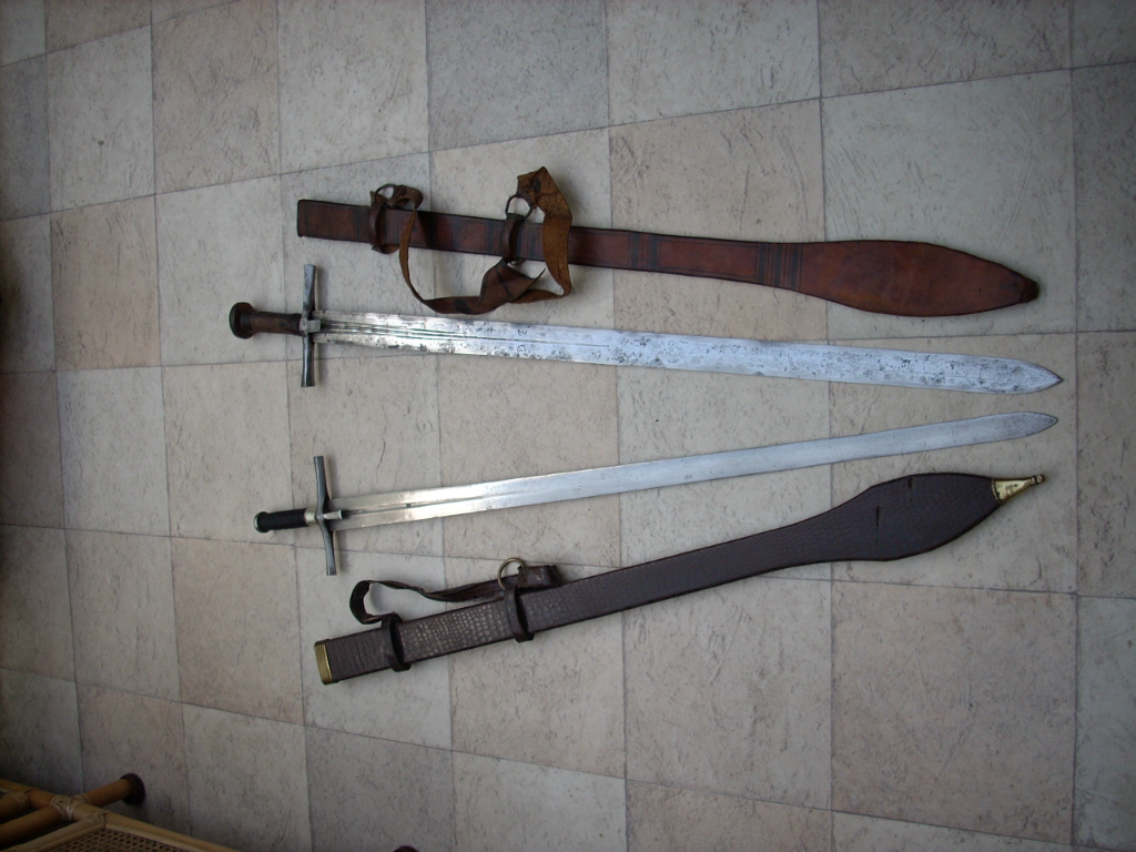

I have two very ordinary Kaskaras in my collection. The first one I believe to be completely original having a leather scabbard and wooden leather bound hilt with leather disc pommel and iron crossgaurd with two languets one of which has a piece broken off. The 36.75 ins double edged blade has three narrow, shallow fullers for a short distance changing to a single central fuller about which are stamped back to back crescent moon marks.
Having read through the various excellent threads on blade marks I believe that on this sword they are talismanic stamped by a local smith, I also believe that the blade is African made but if possible I would welcome confirmation or otherwise.
The second sword has had its hilt rebound with cord and a replacement steel pommel disc. The scabbard is also a replacement, this work being done about twenty or so years ago. The 35.75 ins double edged blade is slightly more narrow than the first one and has a single central fuller on each side for a short distance. This fuller is wider, deeper and better formed than those on the first sword. On one side, in the centre of the fuller, is a strange stamp mark, I cant make out what it represents, a frog, a turtle I don't know. I have searched through the above mentioned threads together with internet searches but just cant place it. I am hoping that someone will recognize it and also confirm whether or not the blade is African made or European. Both blades are quite springy.
Thank you.
Miguel

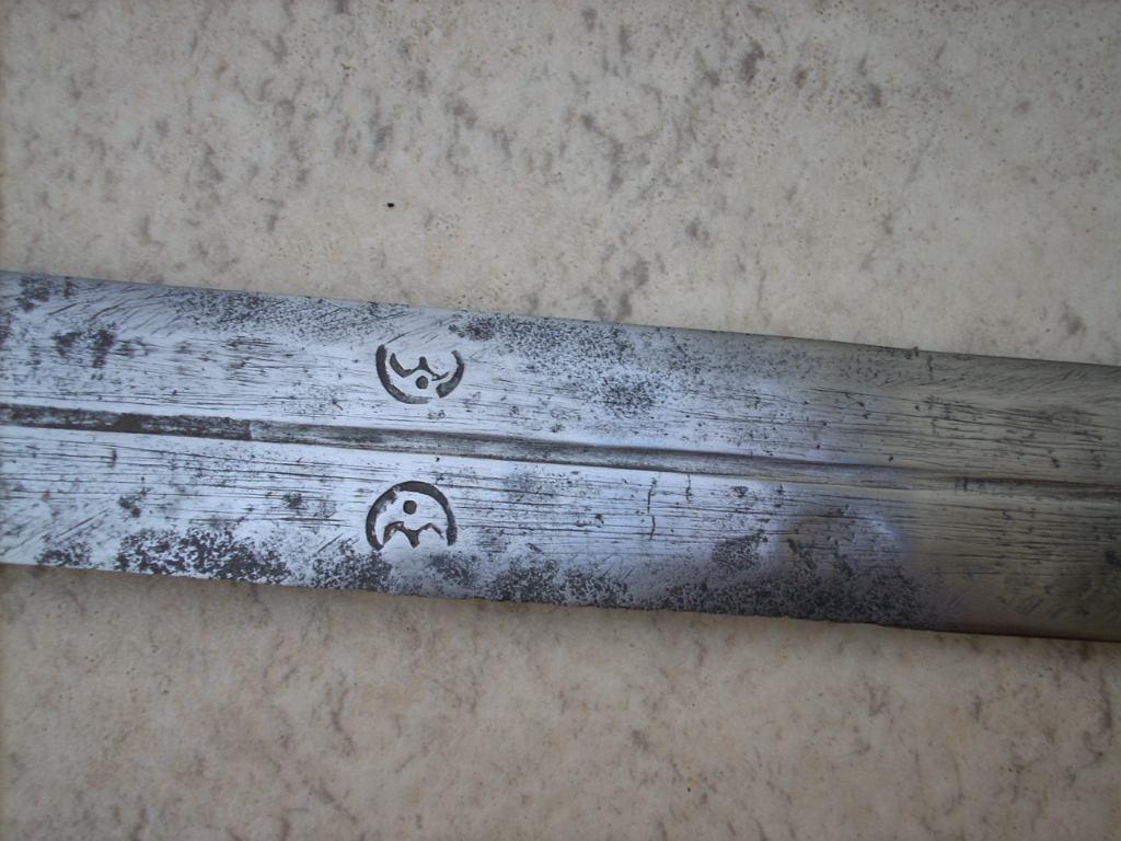

I think the mark on the top sword is a maker's mark. It's a take off from the Man in the Moon face on some German blades. Various sword smiths in Kassala, Sudan mark their blades with variations circles, curves lines and dots. Your mark might be a rendition of the Arabic number 40 or Arbane. A Kassala smith named Awad Adam had a similar mark but with a complete circle with the arbane inside. A similar close rendition was used by Hassan Shaykh Idris. I could hardly tell the difference, but the smith community was aware of subtle differences. Date would be mid to late 20th Cent.

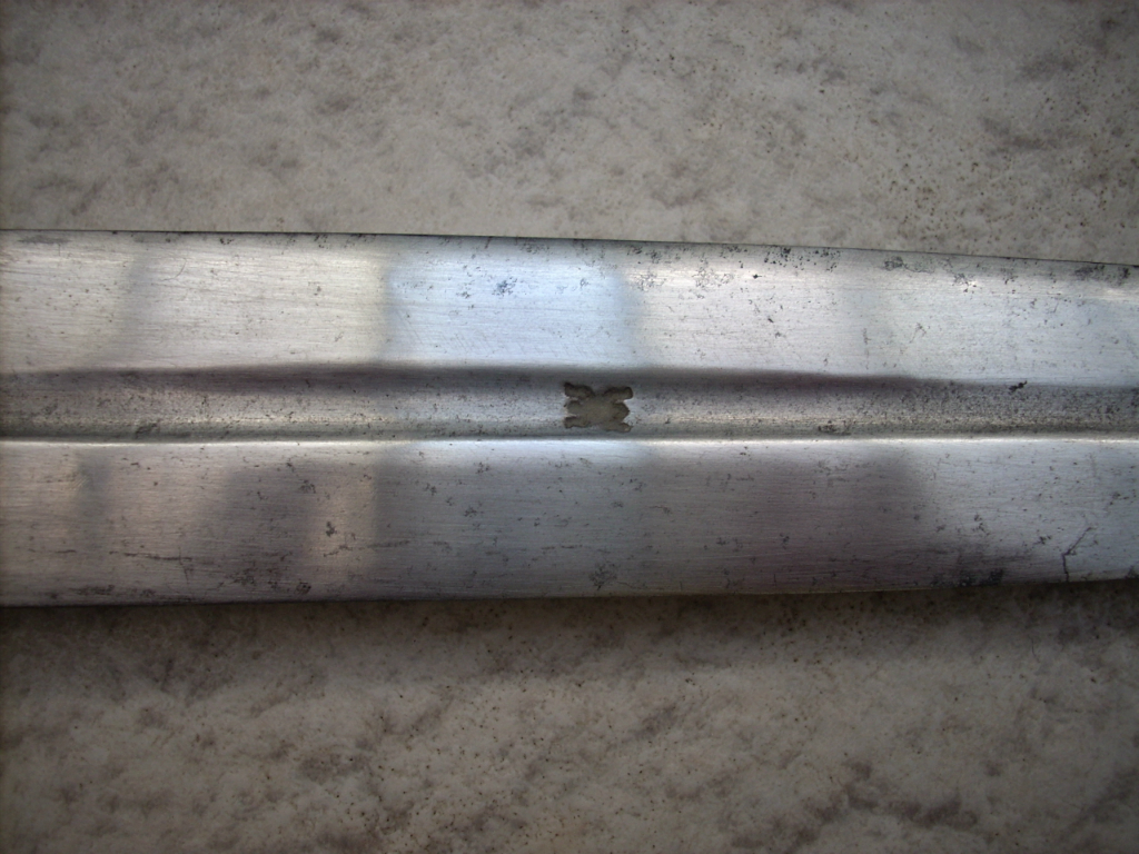

The second blade is probably European trade blade. The mark looks like it might be a spider, but I can't identify it.

Salaams Edster ~ Amazing linkage you make to the moon being actually arbine .. in arabic ..40. Which it does seem to be!!(Each moon is identically struck and clearly says 40 in each case) However, the numbering does appear to be highly stylised... The new moon phase is commonly seen as Talismanic in Arabia generally ... but I thought it was a copied in from European moons seen on Toledo and Solingen swords but not as I understand an actual makers mark. It would follow that in the European sense moon strikes were a mark of quality. The 40 configuration is a new one on me! thus very interesting.
The other mark seems to be Peter Cull's Fly Mark which may indicate a European trade blade for Africa.

Thanks for referencing the seminal thread started by Jim. It lays the historic basis for later Sudanese smiths to tie, adapt and identify their work with a reference to quality and the Crescent Moon's symbolism in Islam. My guess is the Crescent Moon's design elements when adapted with a little imagination looks like 40 in Arabic numerals. I see nothing significant in the number 40 as such.

Thank you guys for bringing these in, and we have learned a great deal since these earlier discussions. Ed's fantastic field work in Kassala actually predated the key work by Reed ("A Kaskara from Darfur", JAAS, 1987) as he was there in 1984.
I recall discussions with Ed in 2010, and it was noted that these modern interpretations of the 'dukari' moons did seem to represent the Arabic '4' and '0' =40, however it was never clear why that number was chosen. Perhaps simply because the moon 'device' was seen as those numbers in a 'Rohrshach' kind of perspective.
It seems that the duality of the paired moons were seen from early blade examples from Germany, and the crescent moon, important in native folk religion and traditional symbolism was adopted by native artisans. The smiths were considered to be in league with magic powers, and these symbolized magic imbued in the blades, seemingly mostly from Hausa context.
Clearly these notions and devices were transmitted to the east and into the traditions of the later swordsmiths in Kassala and perhaps other locations.
It is interesting that other images such as squiggle marks, letter P in an arc and others also were stamped in blades in this same paired configuration.
Some of the 'dukari' of later make are badly degenerated from worn stamps and often the stamps are not matched.
With the second sword, the singular stamp in the fuller is what is better known as a 'twig' mark, often seen quite early in Italian blades, in threes or sometimes single (Wallace Coll. Mann, 1962, A576, German 1600) but later adopted in German blades. Apparently these may have also been placed inside 'sickle' marks as well, but these may have been Styrian.
These were at times regarded as 'marca mosca' (=the fly) and this may have caused them to be construed by native artisans as the dexterity of the fly signified that skill in a warrior in combat.
One of these is seen in the blade of the 'Sword of Kanta' ("Nigerian Panoply", Bivar) a Nigerian regalia sword. The image shape also resembles the Berber letter 'yaz' which symbolizes 'free man'.

Salaams Ed, The number 40 (arbyn) is not only a magic number/Talisman but comes hyper supercharged as an absolutely powerful indicator since it takes pride of place in the Holy Quran in one special verse extolling the nature of life and how life should be inspired...in which incredibly for a number it is deliberately mentioned three times. I am not a religious scholar and cannot give an exact meaning nor can I offer advice as to the often hidden invocation but here is the passage for reference~
Quote"
Rasool Allah, the true and truly inspired said, "(The matter of the Creation of) a human being is put together in the womb of the mother in forty days, and then he becomes a clot of thick blood for a similar period, and then a piece of flesh for a similar period. Then Allah sends an angel who is ordered to write four things. He is ordered to write down his (i.e. the new creature's) deeds, his livelihood, his (date of) death, and whether he will be blessed or wretched (in religion). Then the soul is breathed into him. So, a man amongst you may do (good deeds till there is only a cubit between him and Paradise and then what has been written for him decides his behaviour and he starts doing (evil) deeds characteristic of the people of the (Hell) Fire. And similarly a man amongst you may do (evil) deeds till there is only a cubit between him and the (Hell) Fire, and then what has been written for him decides his behaviour, and he starts doing deeds characteristic of the people of Paradise."Unquote.
The point is that Forty is mentioned 3 times and is thus a powerful Talismanic number. I think it could mean that with this sword good deeds may be done according to the script above. The blade is thus protected by the entire verse above by the inclusion of the moon shaped stylistic number forty.
The inclusion of the word forty in stylised arabic secretly inscribed as a Moon defines the Talisman as different from the European Moon which is a mark placed in Toledo and Solingen schools of swordmaking to denote blade quality. The Islamic Moon (although it may have originally been copied onto some African blades and there are many examples where the moon is more rudimentary perhaps done by uneducated African swordmakers or owners) is completely different being purely a Talisman. The Moon in Islamic lands is revered whereas the European Moon carries no religious connotation for Muslims...though there is a religious link in European Moons as a device illustrating anti Papal leanings in some quarters in Europe...and as already described also as a mark of blade excellence...in fact some are illustrated as Funny Face Moons which are hardly likely to be struck by Islamic forge masters..thus there is a distinct difference in the form.

D. #2 Above where it is noted by Ed. Your mark might be a rendition of the Arabic number 40 or Arbane. A Kassala smith named Awad Adam had a similar mark but with a complete circle with the arbane inside. A similar close rendition was used by Hassan Shaykh Idris.

Excellent analysis, Ibrahiim! The combination of a quality and a talismanic effect is a powerful symbol. Thus the individual smith "signed" his work that he incorporated these qualities into the blade. That provides a much deeper meaning.
Miguel, I assume that the various smiths shared available punches to create their own version of the 40 as their individual signature. I've noticed the use of different sized/profiled punches to make the marks and could assume that the blade (or a set of similarly marked blades) was made at different place and/or time. If we had enough data it may be possible to better show blade provenance based on the physical qualities of the different maker's marks we encounter.
Ed
Hello Ed, Thank you very much for your prompt and very interesting reply I never attributed the mark on the top sword as a makers mark I always attributed these marks on Kaskara blades to be Talismanic and I would never have associated them with the number 40, not knowing Arabic, just shows my ignorance of this subject. Did you notice that the moon at the top was thinner than the moon at the bottom? I wonder if two different stamps were used or if the moon stamp comprises of one stamp with the outer ring and one with the face which would lead t the difference if the stamper was careless?
I could not see a spider in the stamp on the second sword until you mentioned it I just don't know what it is. I thought the blade may be a European trade blade as the steel looks to be better quality than the top sword. Thanks again for your reply you've given me something to think about.
